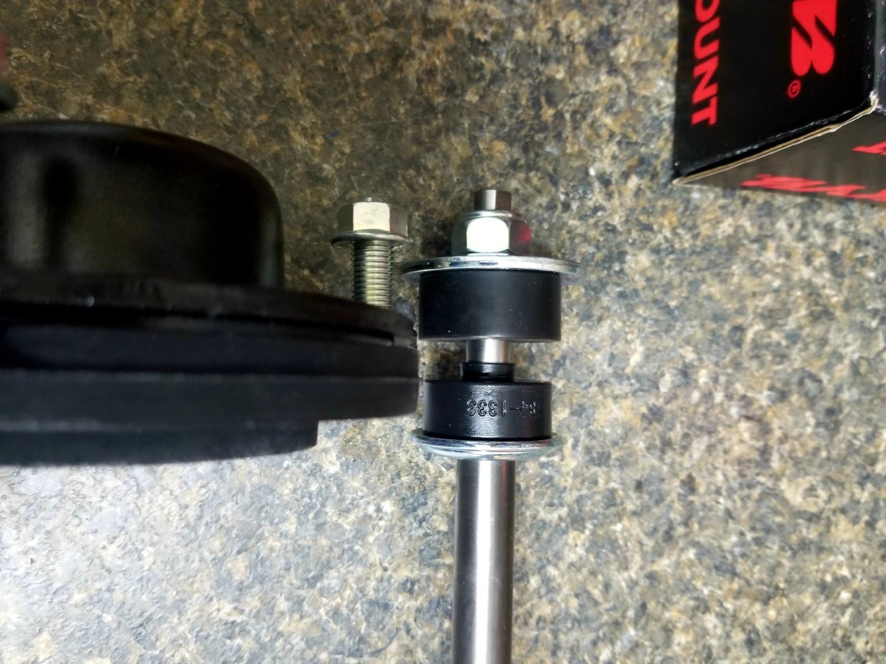

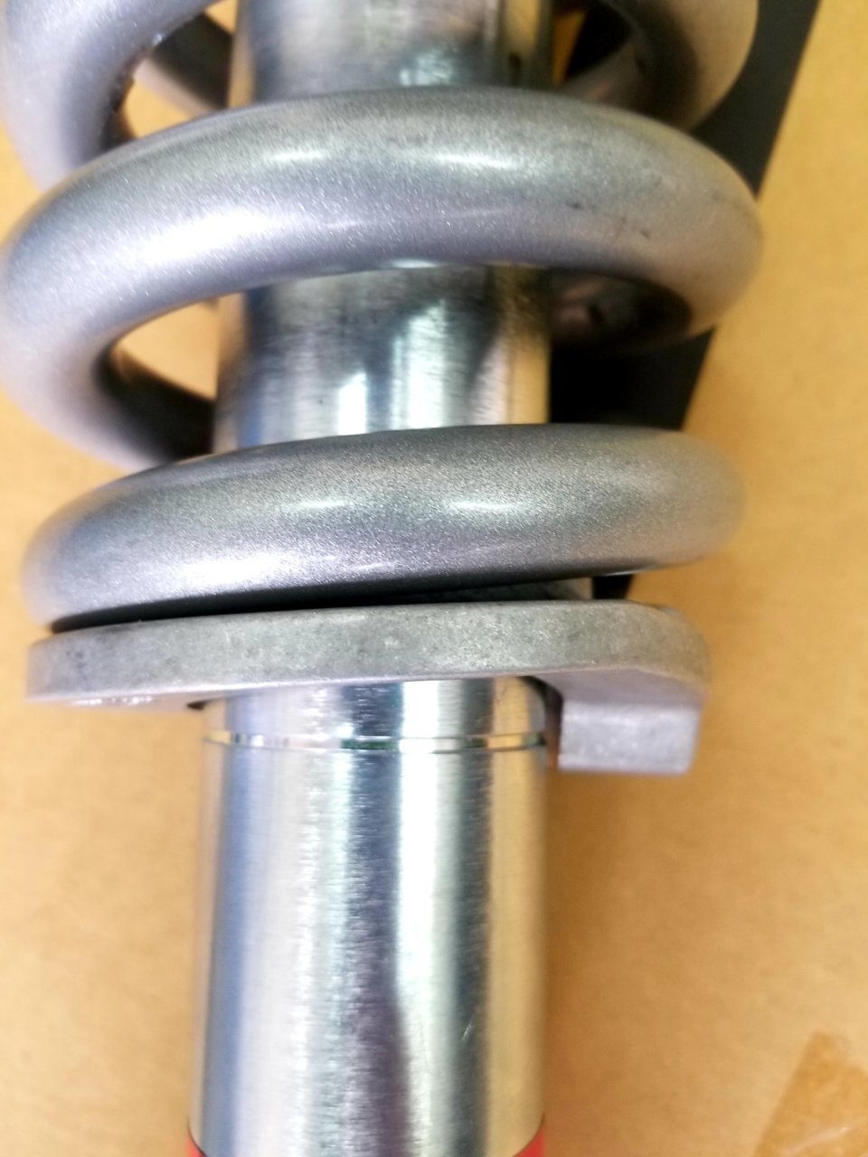

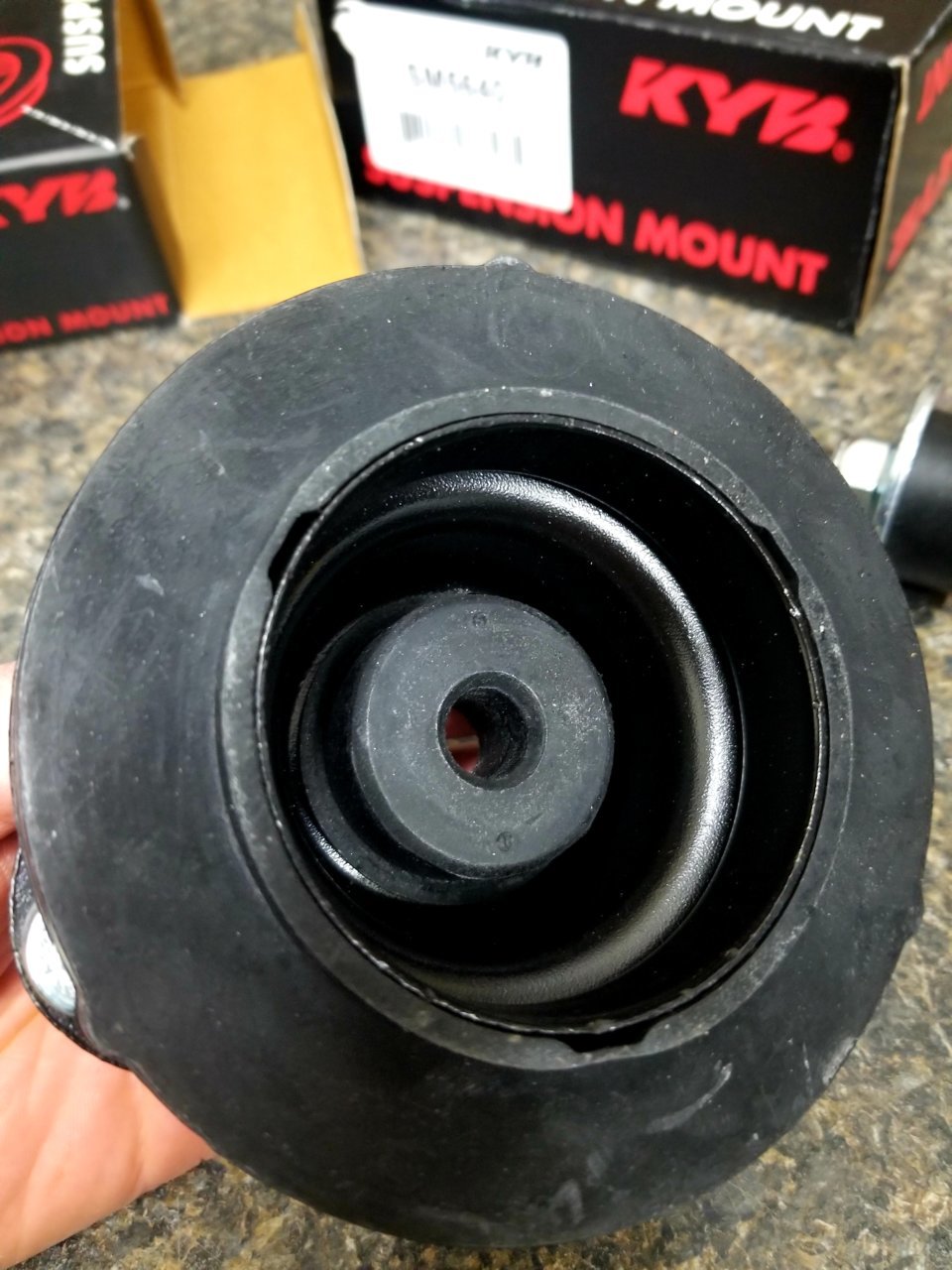

    Just a few questions about the front assembly. I snapped a few pictures for reference.
    Should I remove the bushing out of the new kyb mount and use the eibach one?
    And snap ring adjustment... should I buy some snap ring pliers? Or just a flat head screwdriver to get it over the lip and push it up?

    Not sure about the bushing but if you want to move the snap ring just use a pair of pliers. Move one of the opening ends up and then the other. Move the back middle of the clip up if needed.

    stock fronts are interchangeable w mod to bushings or just swap them. stock t4r rear shocks are shorter. im sure you could make them fit but would you want to or worth the hassle

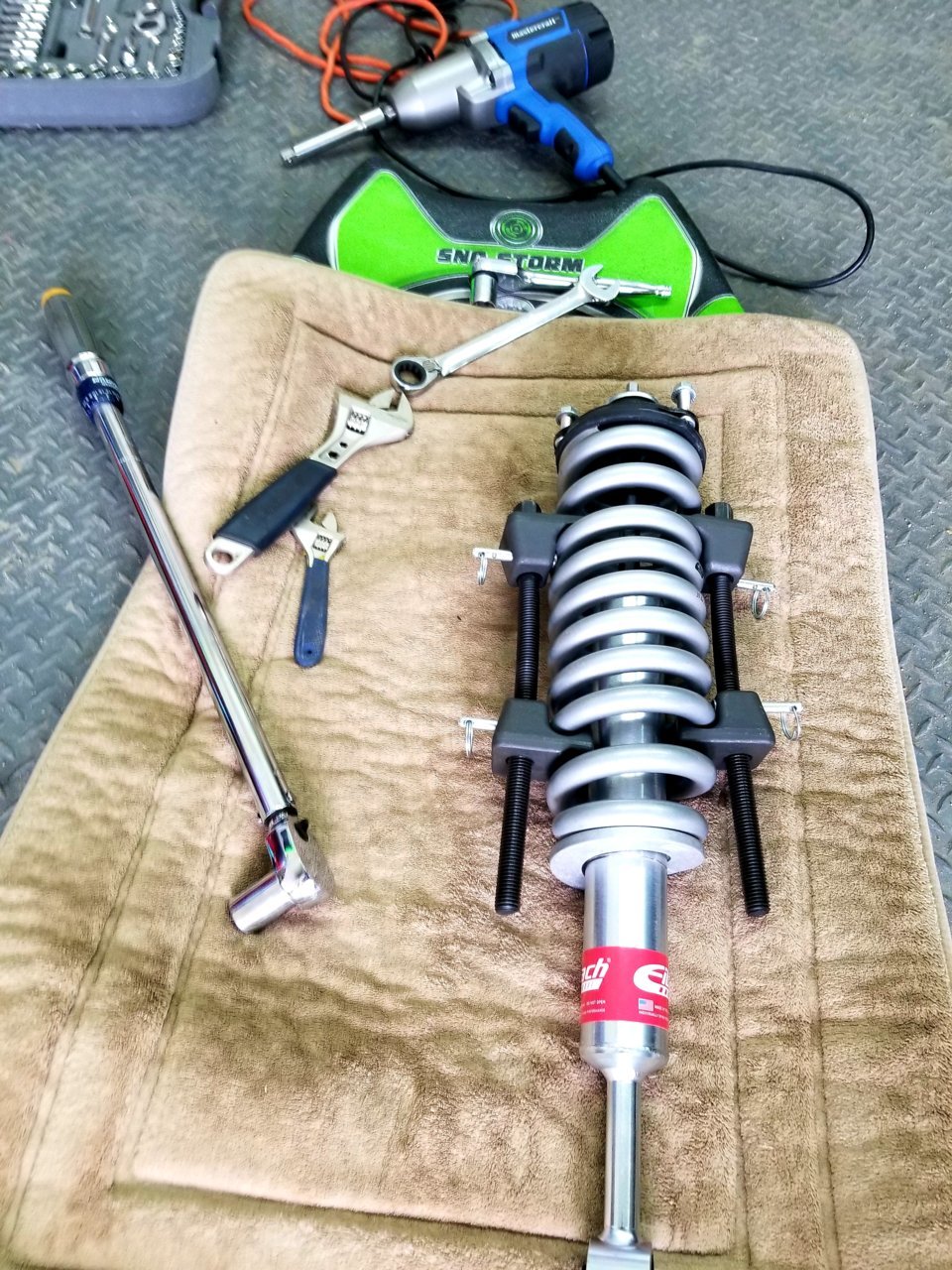

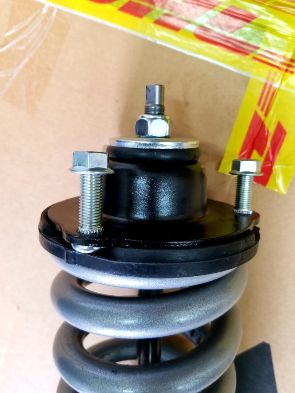

    Shock assembly went down today, pretty straight forward process, set at the middle clip. Can anyone chime in on the top bushing compression..... looks super squished... I'm assuming once the weight of the truck is applied that top bushing will settle down. Also does anyone know the torque for the center nut... or can see how many threats are showing above the nut.

    I tightened mine down that much, possibly another thread or two.

    Did the bushing decompress a bit now that it's on the truck?

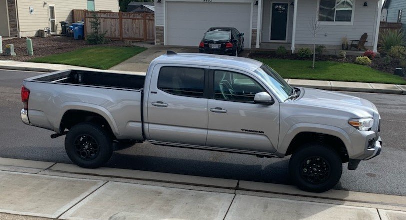

    Just finished installing my Eibach pro springs on Bilstein 5100s, used the 2nd clip to get about 2.5" of lift up front. Paired with 5100s in the rear and a wulf AAL for 2" in the rear.
    Love the look. Almost level, with a little rake.
