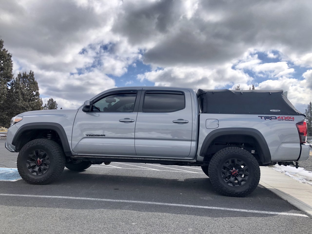

    I just run the wheelers 1.5 AAL. I also have sumo springs when I really load it down. My base extra load is a snugtop shell, bed mat and tool box, so probably 150-200 lbs. Takes quite a bit more than that to make it squat. Eibachs are on first clip up front so I have a little rake. I also have a SSO bumper and winch so the first clip only netted me about 1.5 inches, but that was all I was looking for

    Sick truck. Epic pic. Nice job

    This is the middle notch front and a 2" wheelers aal in the rear. The front middle notch gives about 2.5-2.75" of lift. I think to keep the rake you need the 1.5-2" lift in the rear
