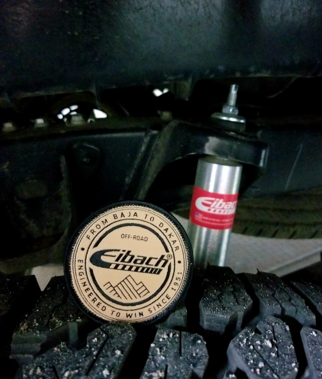

    Got my patch! Thank you Ryan

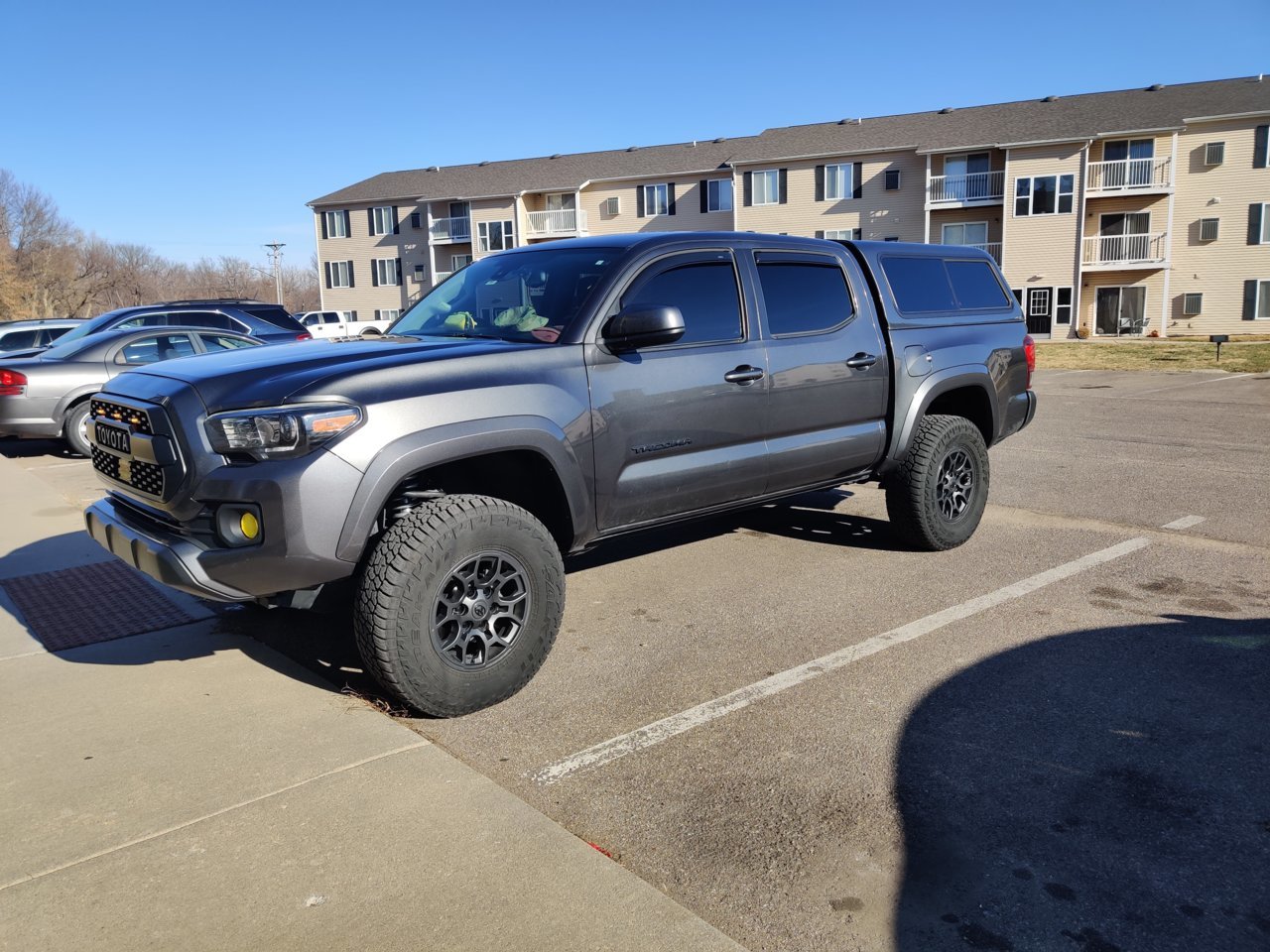

    Your truck looks perfect. Exactly what i'm going for with my SR5 with those same rims.. Couple questions... are your fronts set at the bottom notch? Did you leave your overload spring in the rear? And what size are your tires? Thanks.

    Thank you! I plan on adding a roof rack for the cab and shell, and possibly having a swing out tire carrier in the rear. To be honest I can't for the life of me remember what notch I set it too LOL. Overload spring is still in and tire size is 265/75/16R

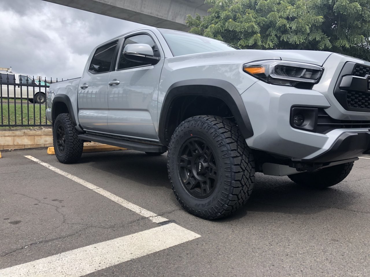

    Finally got my lift on
    Bottom setting and wheelers 1.5” aal in the rear
    Has slight rake but I tow so I don’t mind. Also have 1/4” lean spacer drivers side. ride is great! Had ome springs in my last Tacoma and these are no where near as stiff as the ome.
    alignment came on great with stock uca

    Looks perfect. How much lift did the front get?? Currently have 5100+ pro lift Springs on the way.

    I got 2” up front. The driver side was 1/2” lower pre lift so with the lean spaced it evened it out with the passenger side.
    my aal is sitting alittle high. The aal is supposed to be 1.5” with overload. I’m close to 2” with that aal. I expect the aal to settle alittle over time after towing my boat.
    My truck has about 1” rake slightly less than stock but it doesn’t bother me as I tow a 19 foot boat on a tandem axle trailer so it will sag on the back.
    no diff drop and only did the cb drop. My cv fins look great.

    Layperson here, is that good? What notch setting did you use? Tire size? Diff drop, carrier bearing drop, swap out the needle bearing?

    I went with the bottom notch - if I want a level truck the middle notch would be ideal. No diff drop but did the cb drop and did not change the needle bearing . I’m gonna just run it as is unless the bearing gives me problems. Almost all the guys I talked to here never did change out the needle bearing so I’ll only do it unless I have to.
    Tire size is 265 70 17 duratracs
