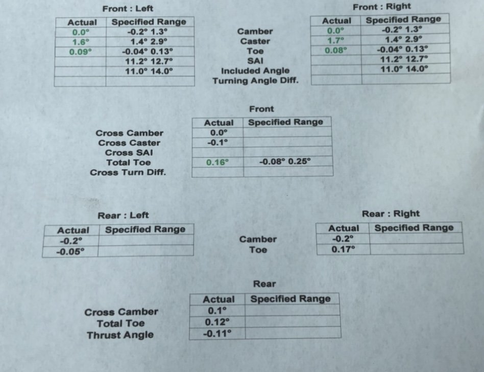

    Which shop did you get your alignment done?

    Island brake and alignment in Aiea
    I heard a lot of good things about them esp with alignments

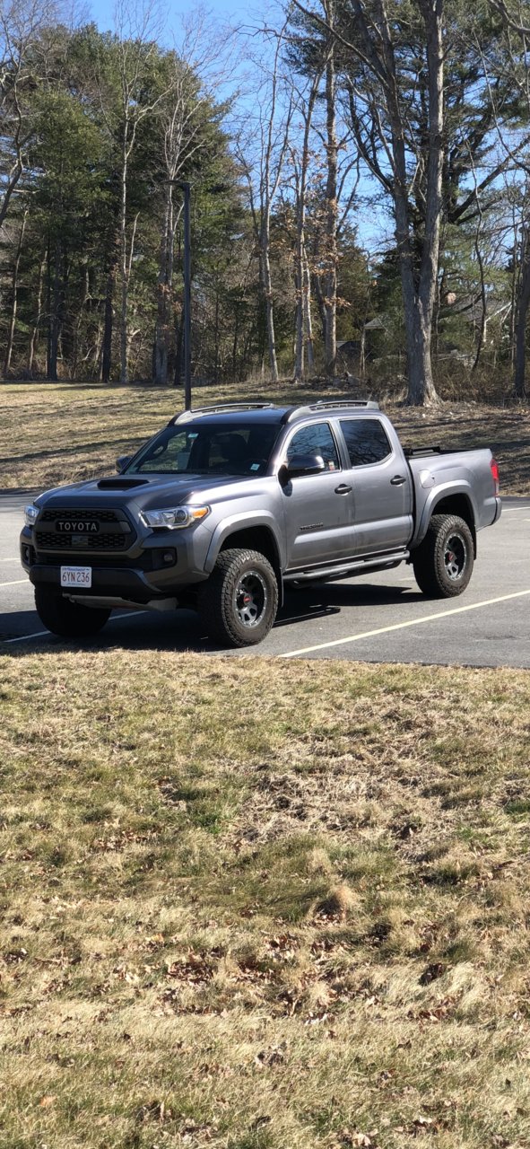

    Bottom setting, 1/4” spacer on driver’s side, wheelers 1.5 AAL with overload out. With the 1/4” spacer I got exactly 2” up front on passenger and driver side, and 1.5” in the back on both sides. I’ll need new tires this summer and am leaning towards 285’s

    Looks good mate. What you got on there now 265/70R17 perhaps? Did you do anything else in conjunction with the lift, like any of the CB drops, or shims or anything?

    Thanks! They’re 265/70/16. So still stock size. No shims, no fb drop, but I did get the vibrations so I did the ECGS bushing

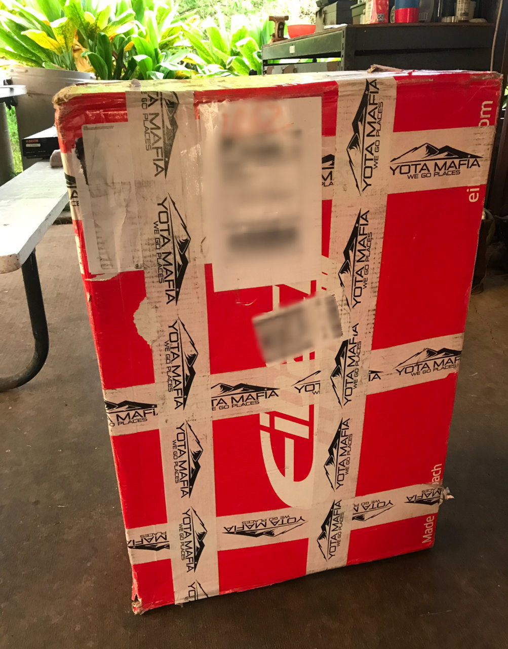

    Mine finally came in. Can’t wait to install

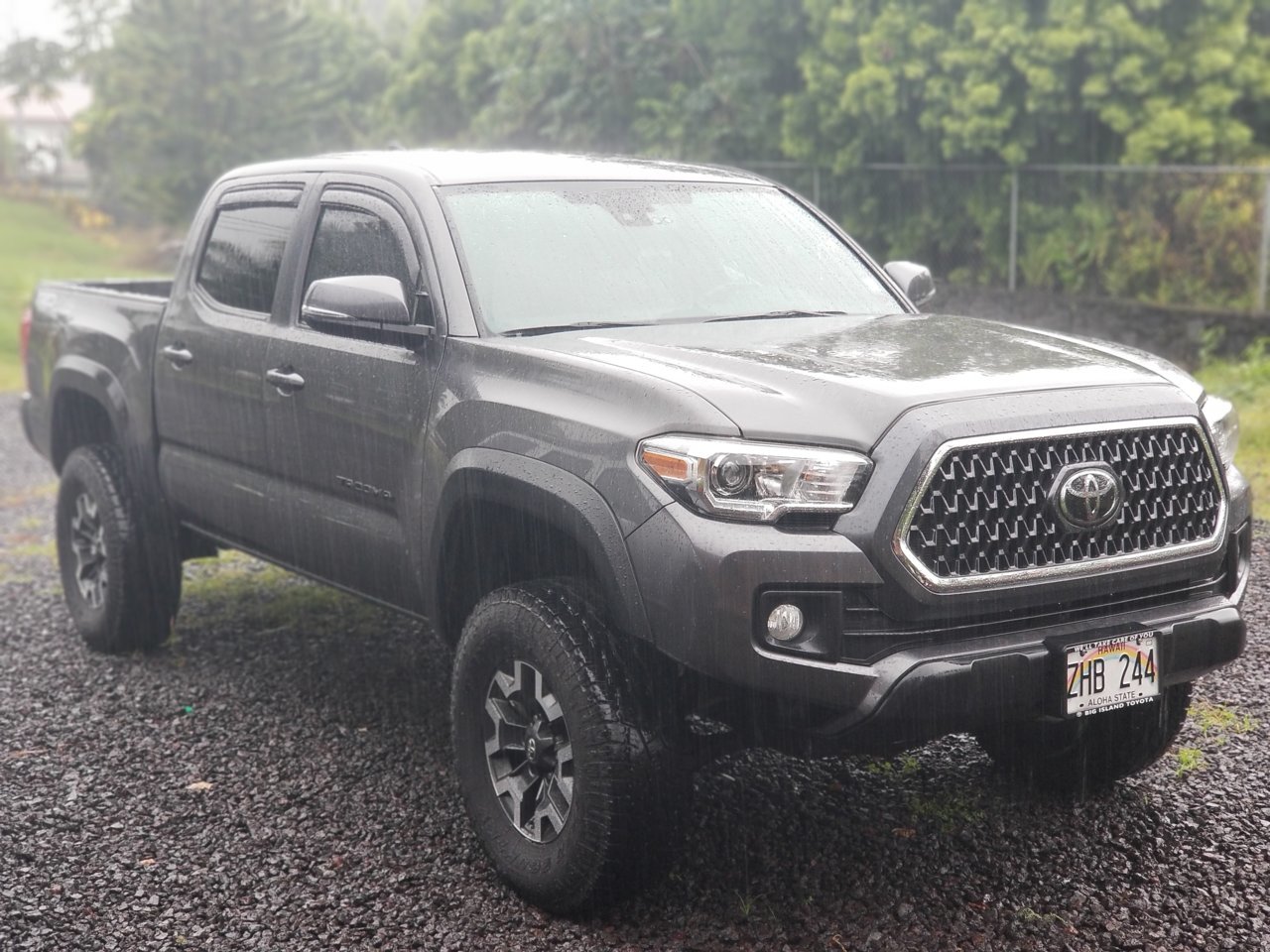

    Bottom notch, 1/4" spacer on driver's side, 1.5" AAL, stock UCA's, 265/75/16 Tires.

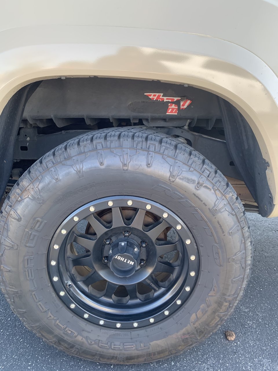

    Spotted in corona!

    Get that man a new sticker!
