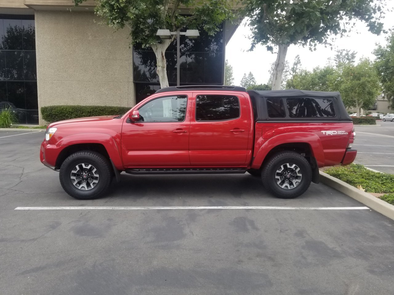

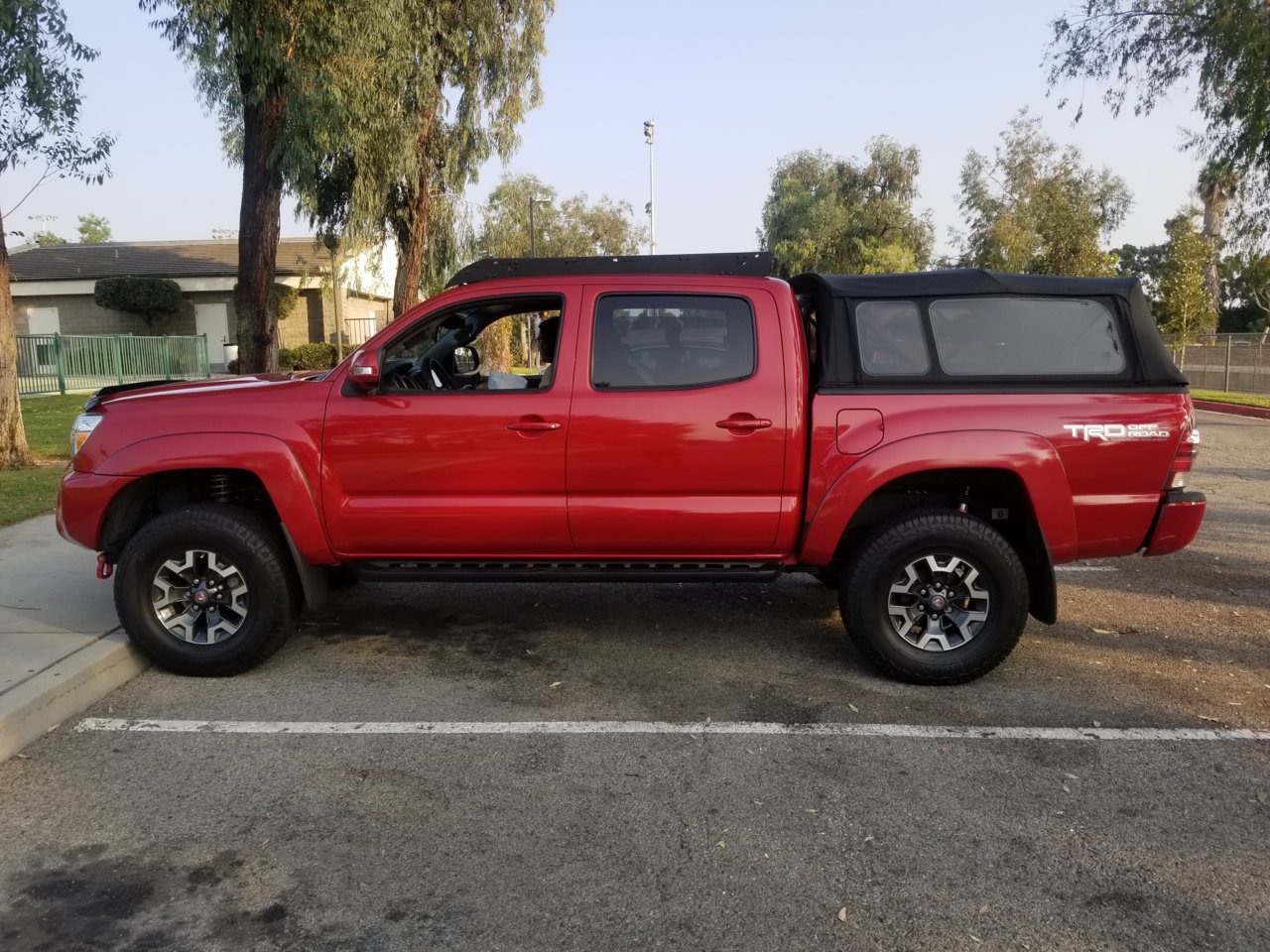

    UPDATE for anyone thinking about going through the same route since not many have these on their 2nd gen.
    Here's an update on Eibach Pro Lift Kit. Been on for 2 weeks now and rides a lot better than my previous set up of 3rd gen suspension.
    Front is set on the first clip 2.5in lift and rear I went with Wulf aal and gave a little over 2.0in lift with overload on.
    Previous setup was 3rd gen suspension with a headstrong 1/4 front spacer and toytec 0.5 flat shim. So it was 1.5in front and 1in rear.
    Here's a before and after pic

    looks great. I'd like to hear more about the ride difference from the 3rd gen suspension to the Eibach kit. Were you mainly after a higher lift or was the 3rd gen suspension riding terrible?

    Stiffer for sure but I like it a lot more compared to the 3rd gen suspension. I was going for a higher lift. I really like the small lift from the 3rd gen and the ride quality but after hanging out on this website for too long it really made me like the look of a higher lift.
