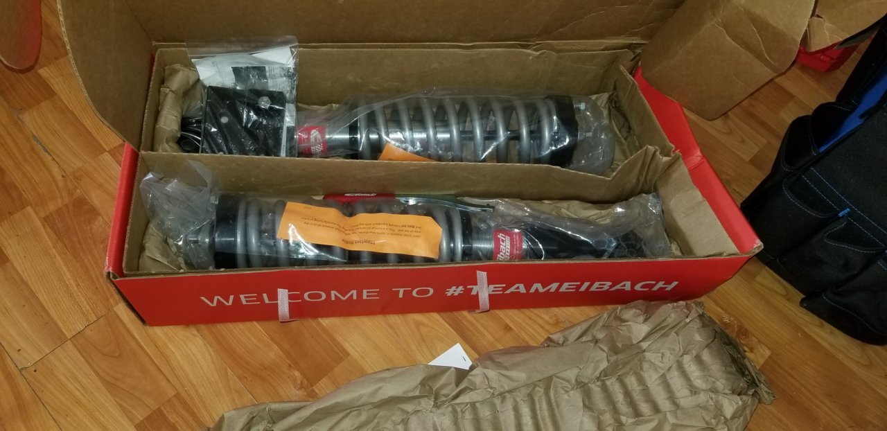

    They're here! And boy are they heavy. Got them with the rear shocks too.
    Now I just need to decide what kind of rear lift I need. Anyone have a recommendation?20210703_171828.jpg

    Do I need a rear lift? Or is it optional.
    Sorry to butt in the convo. But I'm having trouble deciding what to put in my rear after I get the shocks on.

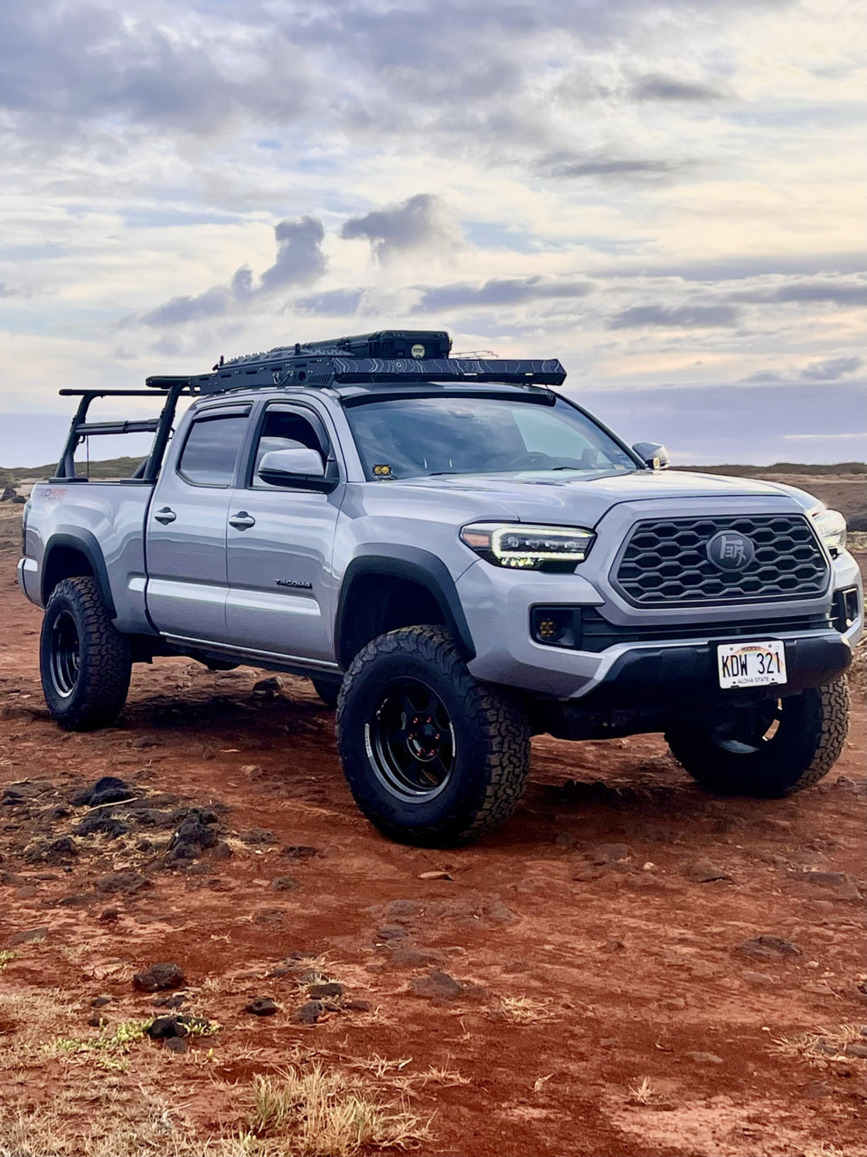

    Just installed my Eibach stage 2s on the front. I have Fox 2.0s on the back. Ride is firm without being harsh or jarring. Also installed SPC UCAs at the same time. Liking the setup so far. 38286F21-983D-42A0-9002-644B9F792EB0.jpg

    What size tires and rims
  13. Jul 5, 2021 at 5:50 PM
    #493
    kauai cement taco
    kauai cement taco Member
    Jun 25, 2020
    #332554
    14
    Aaron
    2019 TRD off-road
    17x8.5 -10 offset 285/70 17 tires

    No worries man, rear lift is optional. I ran w/ Stage 2 for quite some time before I finally added my Headstrong AAL :thumbsup:
    Depends on your needs, budget, etc... rear block or AAL will be your best route for a lift in the rear

    Loving that pattern on your upTop wind deflector :thumbsup:
    oh and the TEs too :rofl::D

    Oh wow, so I dont actually need an aal or block right away? That's sweet.
    I would get a block but I could also wait and get a AAL. Is there a "science" to getting the correct aal? I was looking into the icon aal but I'm open to other options.

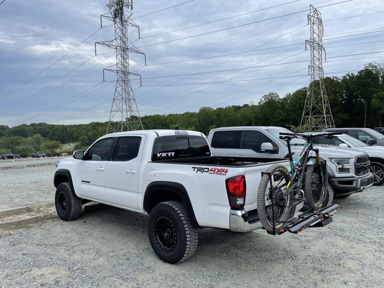

    Good shot I got of the truck tonight after riding. Tropical storm Elsa was rolling in this evening.
