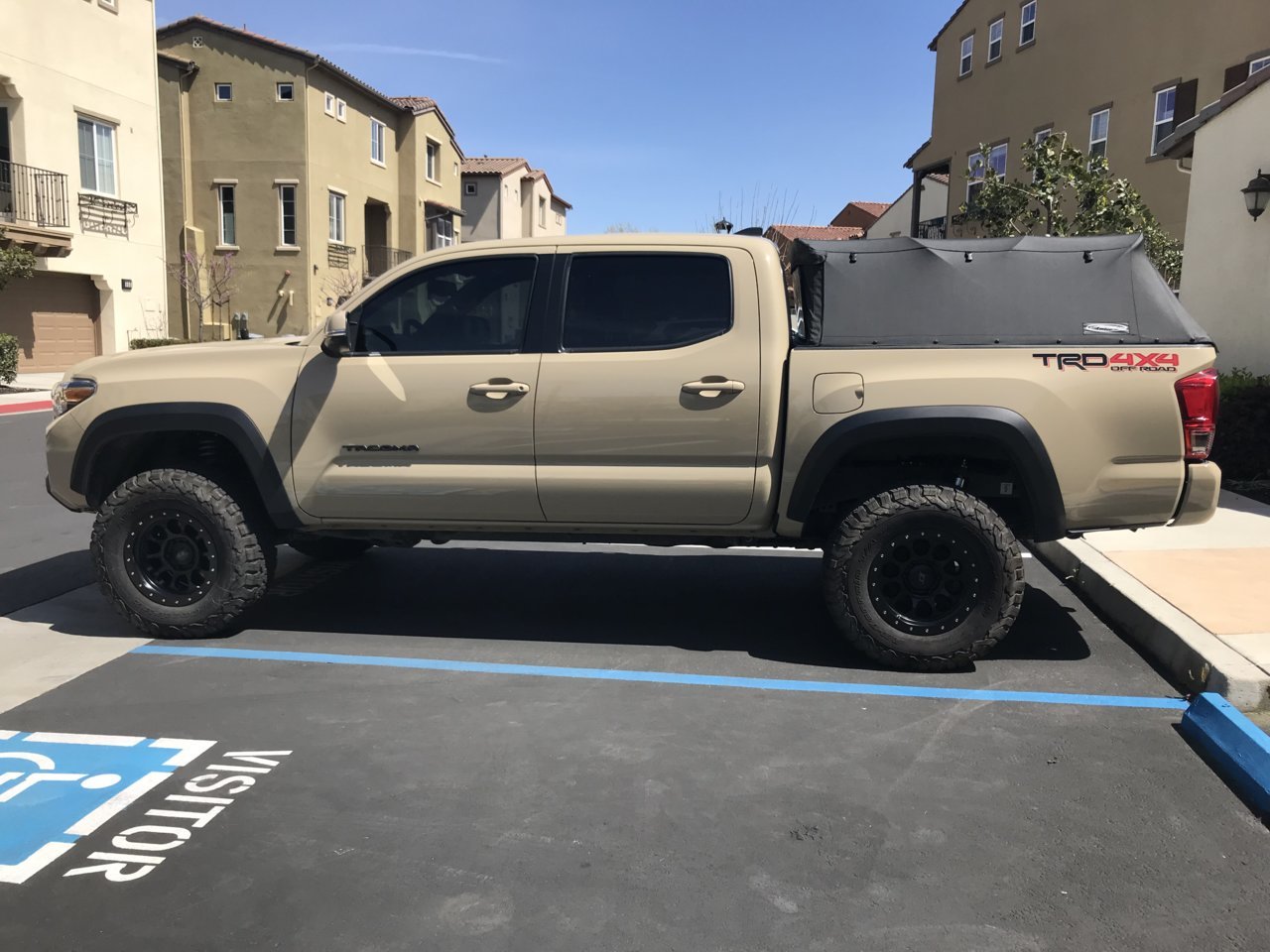

    What did you use to lift the rear?

    First sentence says "wheeler's 3 leaf AAL"...

    I meant to ask if it was 1.5” or 2” AAL used in rear.

    Hey bro , did you leave the overload spring on? Love the stance on it , planning on doing something like that , also how you like them so far ?

    No overload springs. I like the significantly more then the OEM Bilsteins. They are on par with a 5100 setup. Not magic but very good for a budget suspension option. If I did it again I would spend a little more and do 6112/5160 combo.
