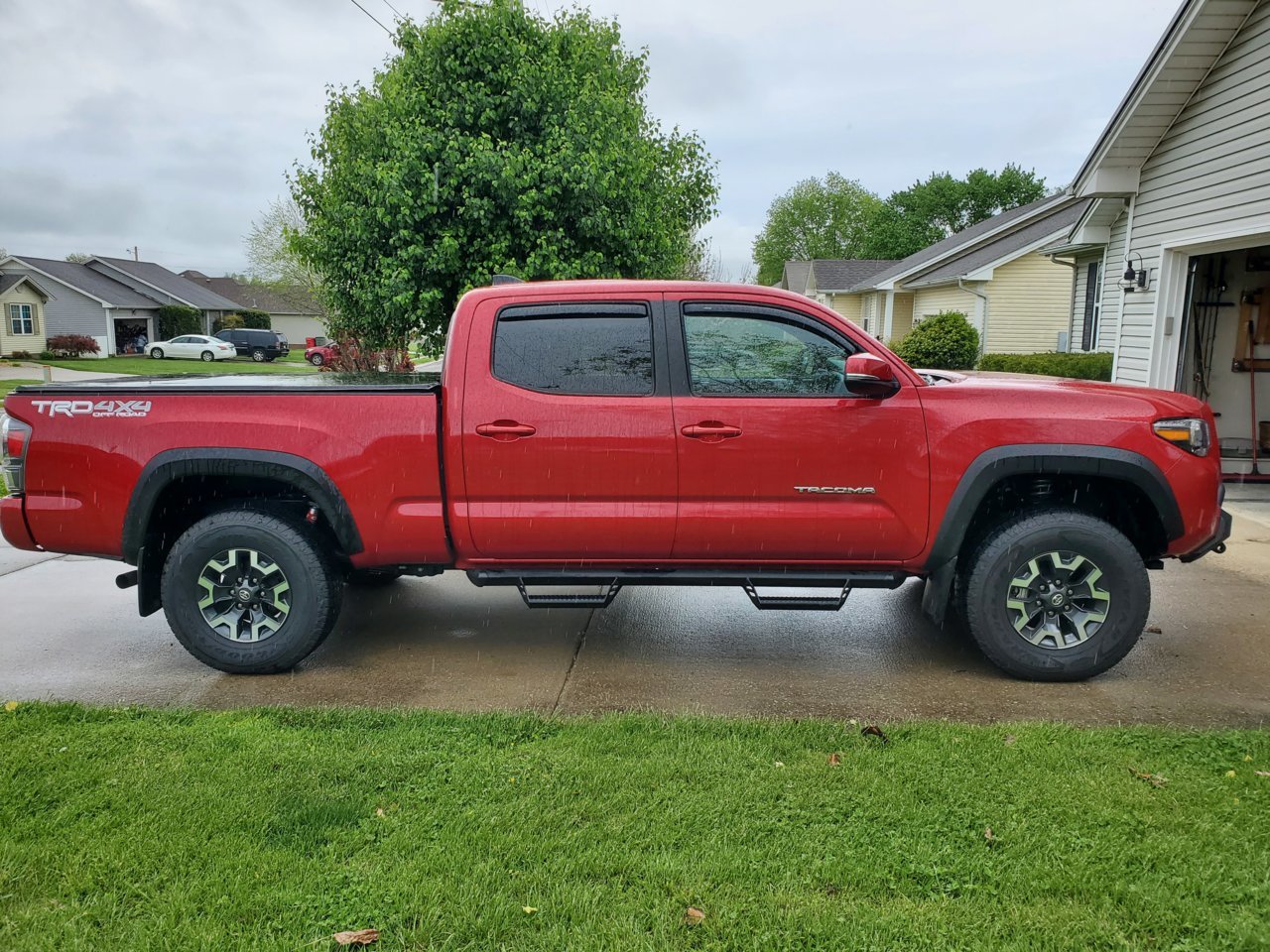

    Installed this lift this morning. Pretty easy overall, took about 4 hours. I used the lowest clip location which netted me right at 2" of lift in the front. This with the bumper and winch install has my truck nearly perfectly level. Drivers side front is about 1/4" lower than the passenger side. It was this way prior to the lift so not a result of the lift. I will need to look into this further. Pretty happy with how it turned out. Thanks to everyone for their direction on this!

    Drove about 40 miles today and all seems good. Alignment and tires tomorrow.

    Alignment was completed Wednesday. Rides and handles great.

    Driver side is lower because of battery, gas tank on that side. AKA the taco lean. Spacer would help

    Stock for both.

    I found several old posts on here that said the same thing. It is only 1/4" so I may just leave it as is for now.

    Did you have to install the differential drop kit for this lift?

    I did not.

    After letting things settle I ended up almost 1/2" lower on the drivers side front. Added a 1/4" spacer now it is level all the way around.
