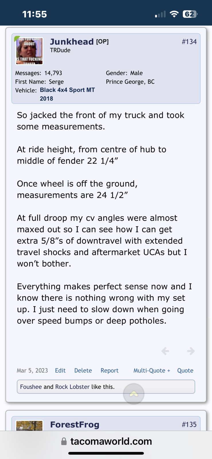

    Sand_In_My_Taco
    Sand_In_My_Taco [OP] Well-Known Member

    I just checked again, and I'm barely hitting 25 at full droop.
    You appear to have an extra 1/2 inch of down travel, which means that these coilovers may be "short" 1/4 inch.
    I wonder if the issue with these coilovers is just that they are too short or something.
    @Speedfreak do you think you have time to jack your front end up and measure fender-center hub, and see how much downtravel you have?

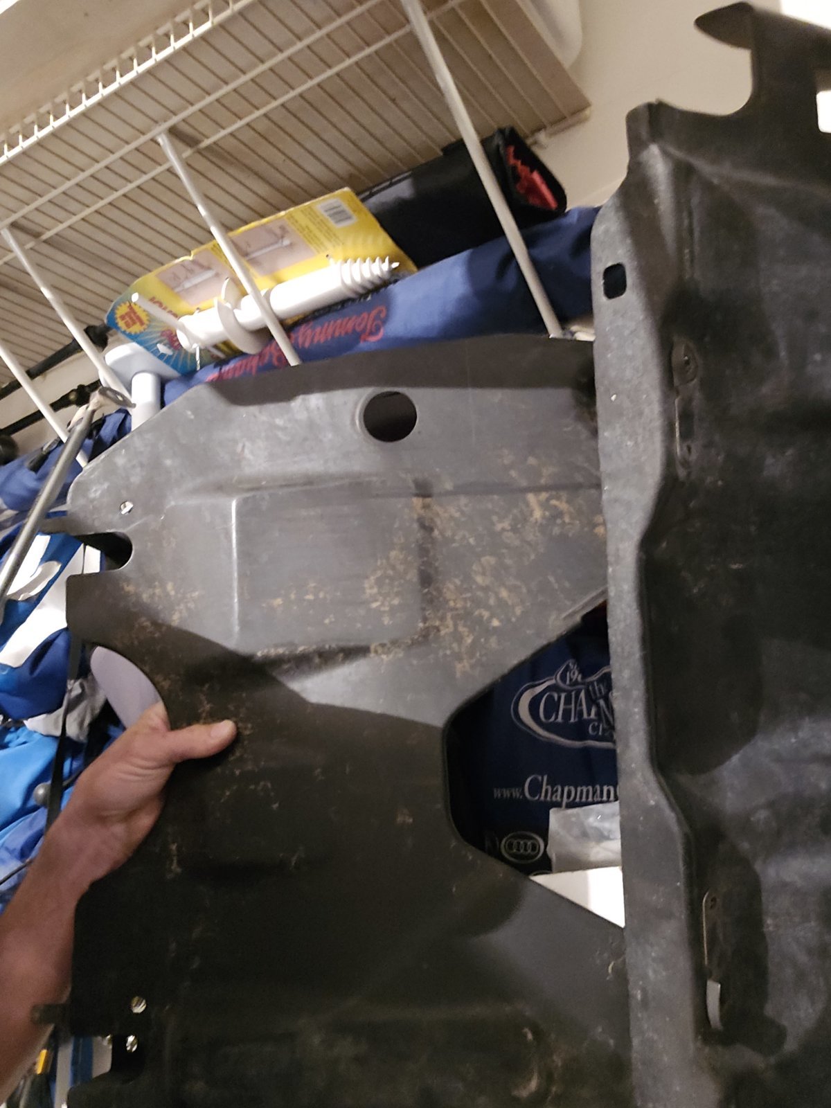

    I had a lesser clicking going over nasty speed bumps with the stock skidplates on, be it physical interference, torsional pull, or vibration amplification. The 2 parts are basically sheet metal down there. Once gone, so did some noise.

    I have removed both skids
    Retorqued UCA/LCA
    Removed sway
    Swapped to full shoulder shock bolt
    Replaced brake pads
    Spacers are pretty cheap, so I'm looking for a 1/4 to 1/2 thick spacer ~for science~

    My OME nitro chargers are not long travel. I’ve only got 2 1/4” of downtravel. Wish the guy at the shop mentioned that. If I got 5100s, my downtravel would have been ~3”.

    Can you quickly jack the front of your truck off the ground and measure fender-center hub?
    Or anyone really xD
    It would be quite funny if the issue with these coilovers is the travel length.
