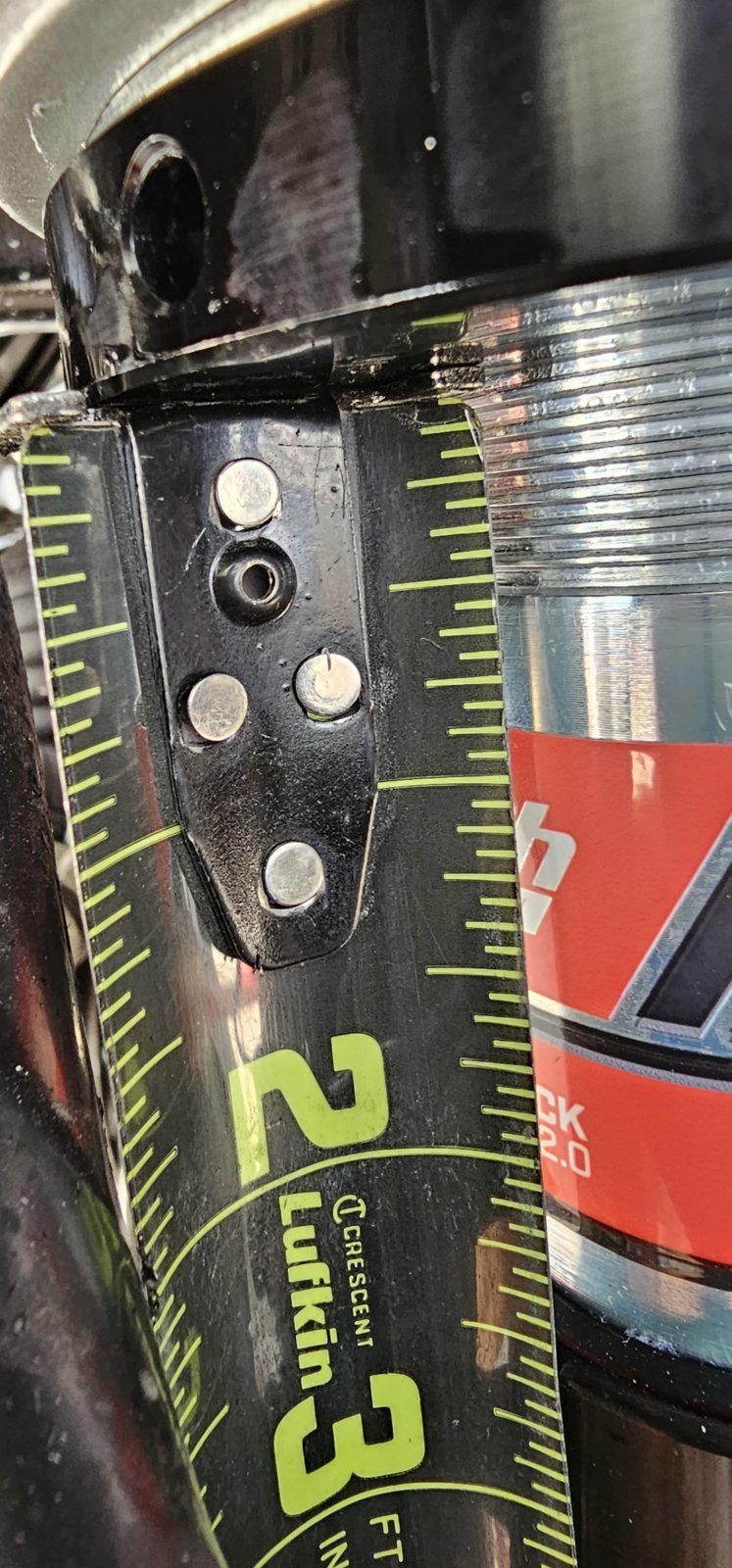

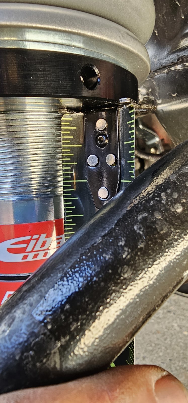

    Just measured mine,
    21 1/2 at ride height and 24 3/4 full droop.
    When I installed these I took out about 5/8" of preload.
    Out of the box
    As currently installed
    I read about the clunking issue before I got these and for awhile I thought mine wasn't affected. I haven't driven it very hard but did hit a section of whoops at an orv park hard enough I thought would it would clunk if it was ever going to but it never happened, thought I was good to go. About 3 months later on a small trail I hit a water bar hard enough to toss the front end up sharply and heard the clunk for the first time and was able to reproduce it repeatedly.

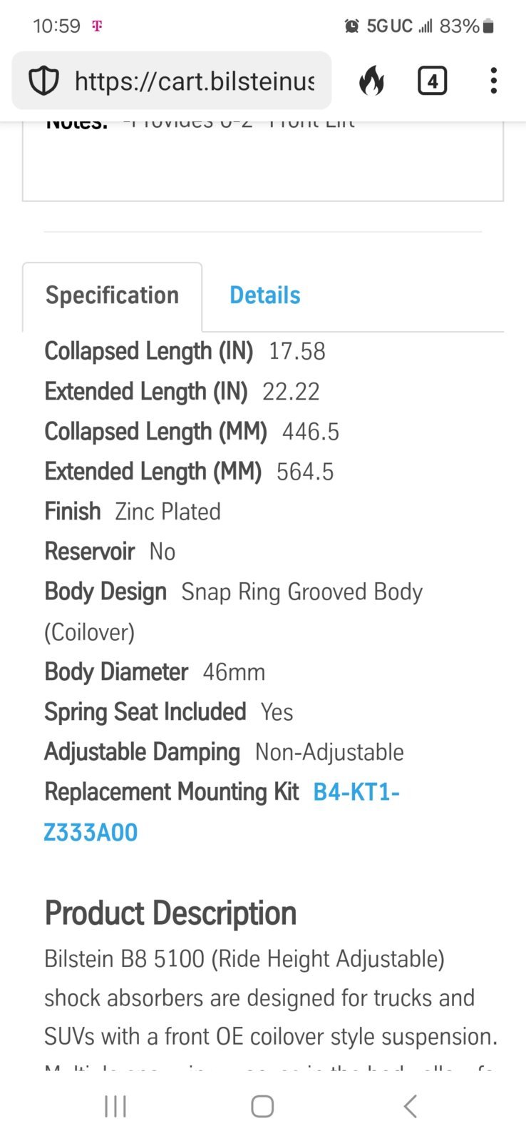

    You know the Bilstein 5100 specs are good. As long as yours are 1/2" or more shorter extended length, you will succeed. Nothing to lose really if no other options, go for it man.

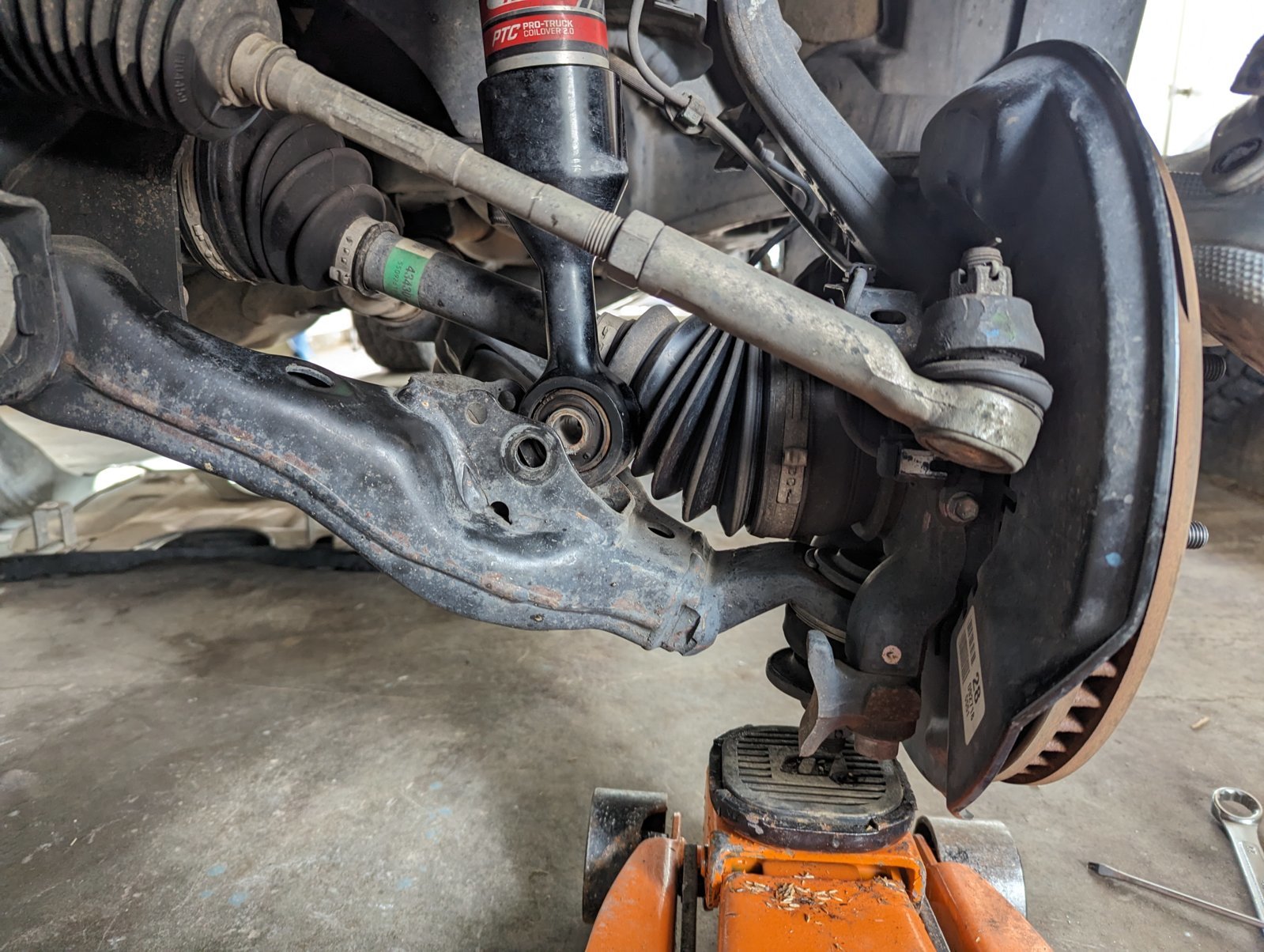

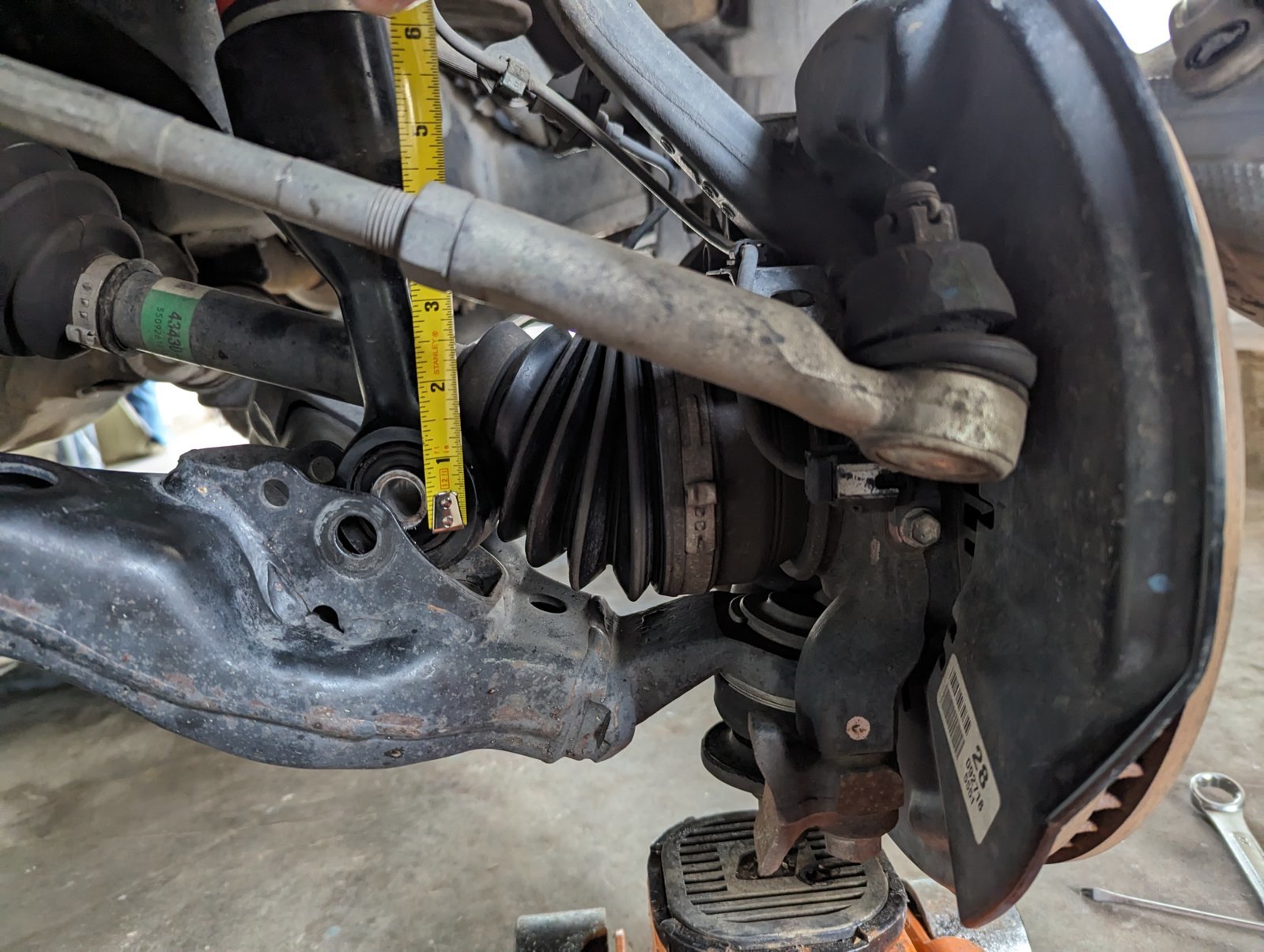

    Coilovers measurements
    ~22 Full droop on truck
    20 1/4 As compressed as I could get it, jack won't go higher. Need a block.
    Removed lower bolt, I can push the hub down about another 1/4-1/2 inch before it stops, it does "rebound" back up tho.
    Going to find a block and update compressed #. Since the IFS is limited by coilovers in my instance, I should be fine to install a block above the coilover.
    Pics are as it rests, and pressing down on the hub.

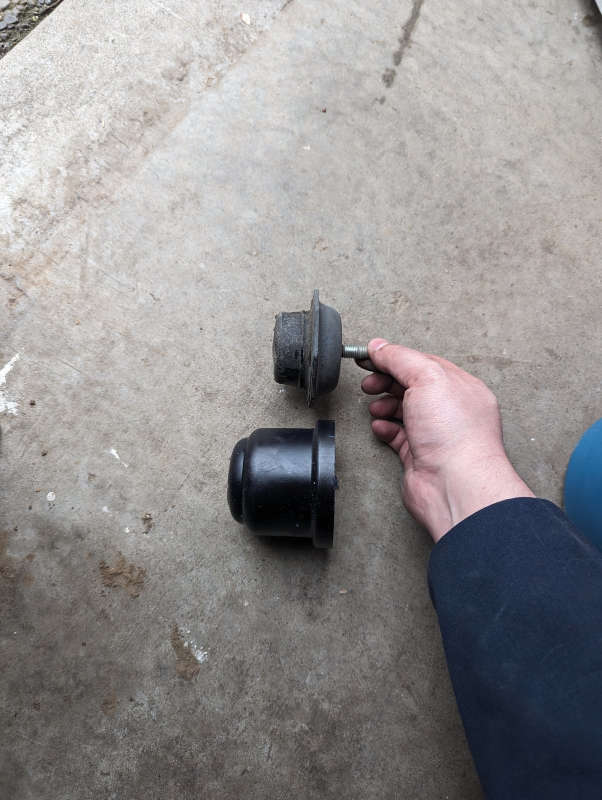

  20. Mar 23, 2024 at 11:59 AM
    #60
    Sand_In_My_Taco
    Sand_In_My_Taco [OP] Well-Known Member
    Jan 26, 2020
    #317328
    734
    NOR*CAL
    2025 1794 Tundra TRD-OR

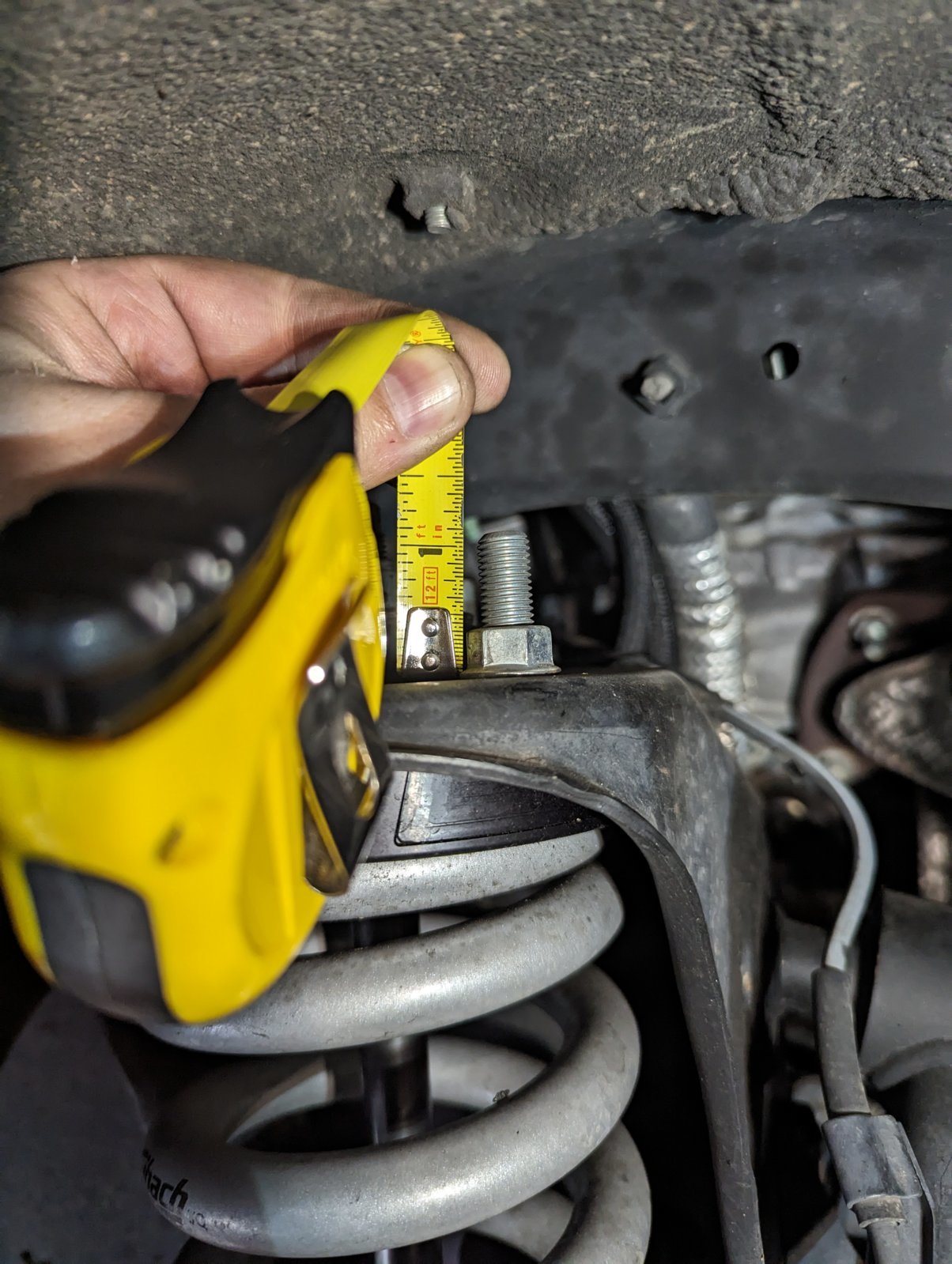

    Installed SuperBumps while I was down there.
    Measured spacers to ensure proper size, looks like they are 3/8 and not 1/2.
    This is fine, as it's in-between both sizes. I'm fine with that.
    Breaking for lunch then I'll compress/make decision on installing spacer/lowering coilovers.
    Also checked how much thread I have available on the coilovers, should be fine I believe.
