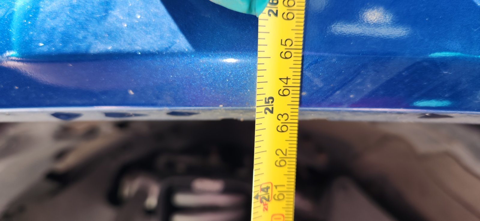

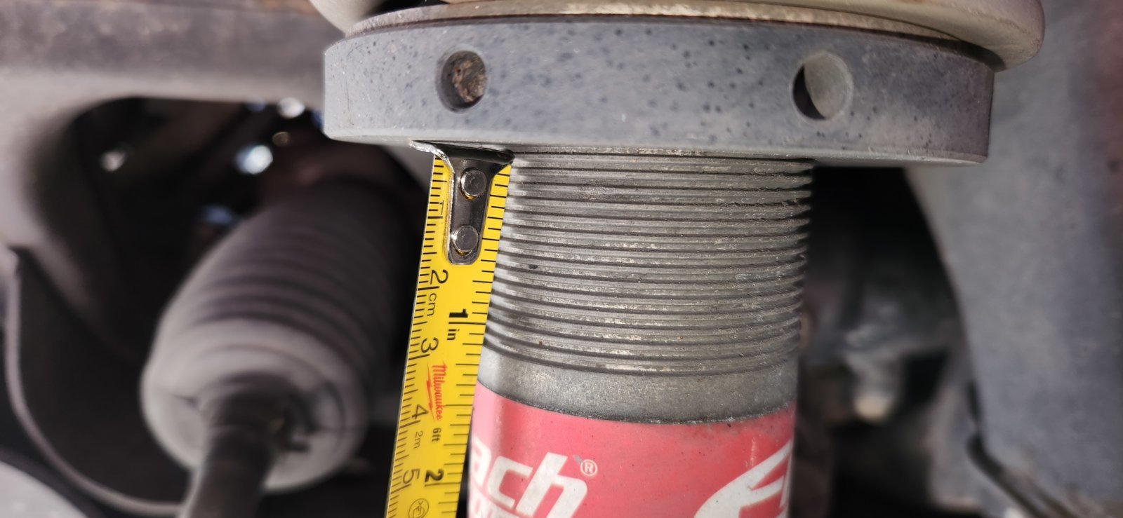

    Got out today with some sunny weather. I measure right on 25 inches from the centre line of hub to the fender at full drop out. And I have approximately 1 1/4" of thread between the bottom of the threads and the bottom of the adjustment nut.

    Essentially what I was at.
    What's your center hub-fender?

    Centre of hub to fender is 25 inches.

    *While the vehicle is on the ground

    Was this measurment taken after it came down from the jack, or after it had been driven around and the spring settle. Anytime you jack the truck up (front end), it will initially sit about an inch taller until you drive it and let it settle.
    25" is like 4" in the front of a 3rd gen. Its too much. Make sure you are measuring on level ground and not bending the tapemeasure too.
    Unless u meant at droop, then disregard
