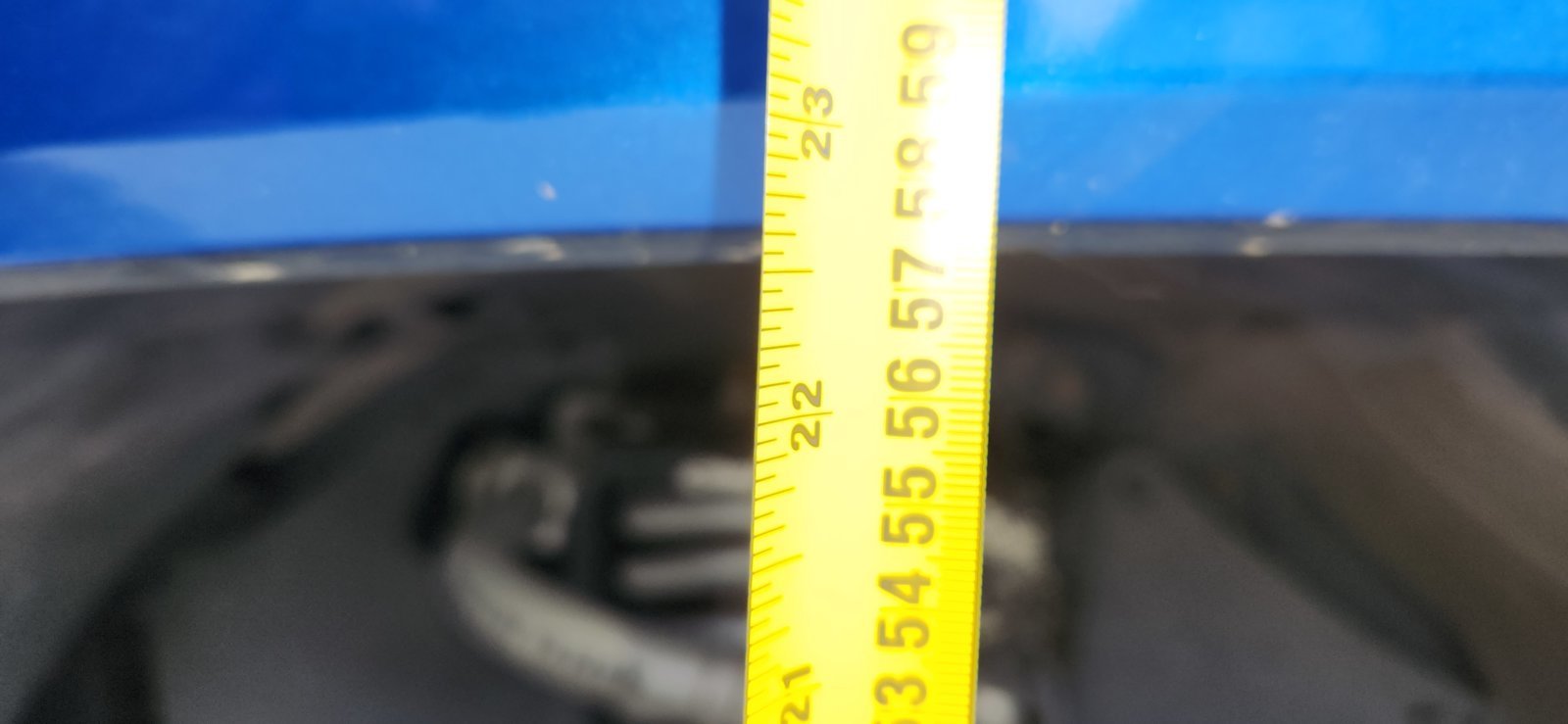

    :anonymous: sorry... 22 1/2 hub centre to fender on the ground. :D

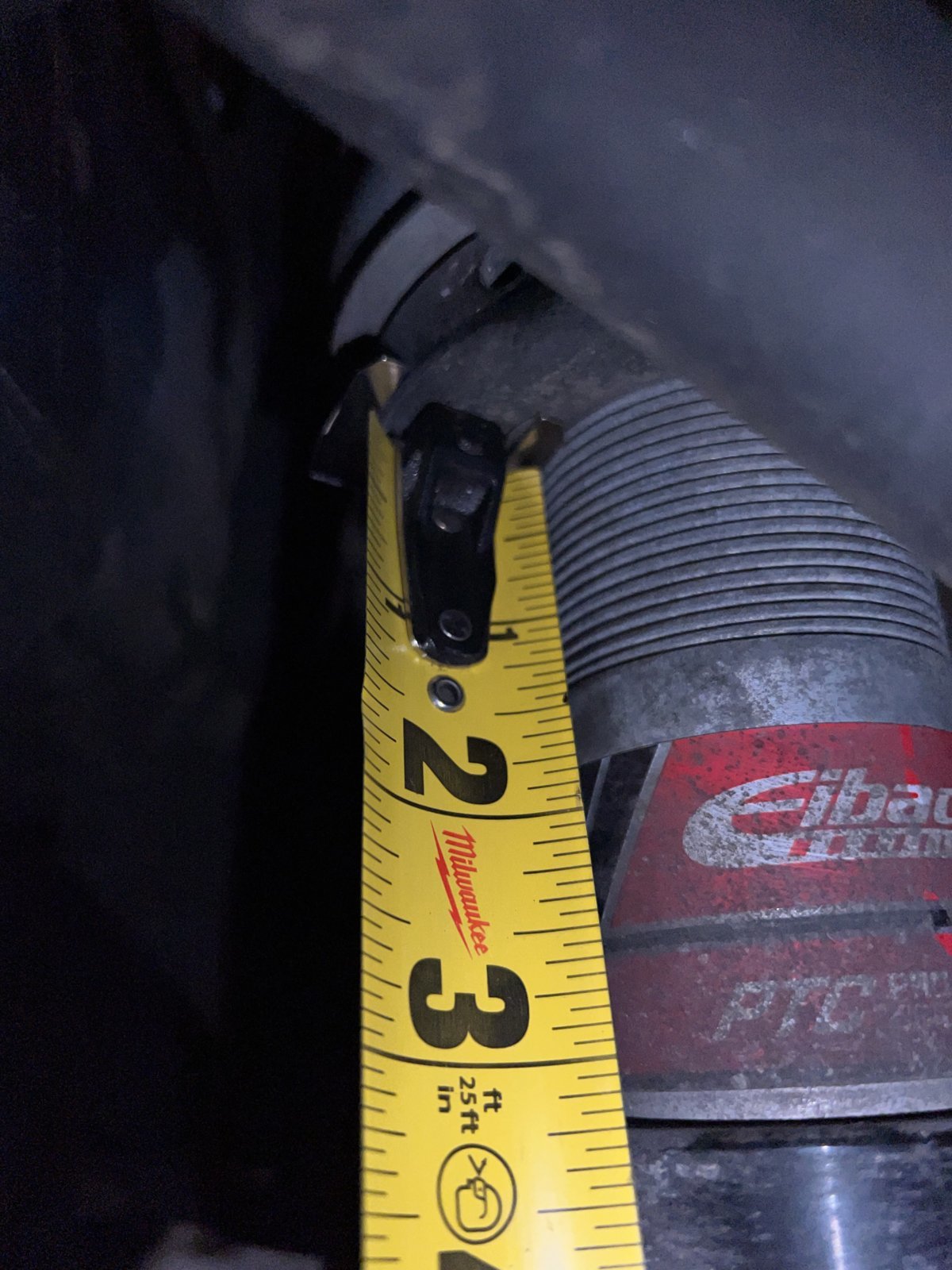

    For whatever reason I never think I'm going to get fully into a project and next thing I know, there's parts and tools scattered all over the garage. :rofl:So I always forget to measure ride height before I mess with anything, going to have to write myself a little note on my toolbox for next time.
    I ordered that same one you used, the "1/2" in one that's a bit closer to 3/8 in when measured.
    Currently I'm now 22.5in center of hub to fender, I honestly don't know where I was stock but I'm guessing I'm about 1.25in higher than stock, I've got a slim front bumper and a winch now. You can see my threads showing at the bottom of the shock is about 1 7/16. Ride height is good now after these, 1/2in rake.

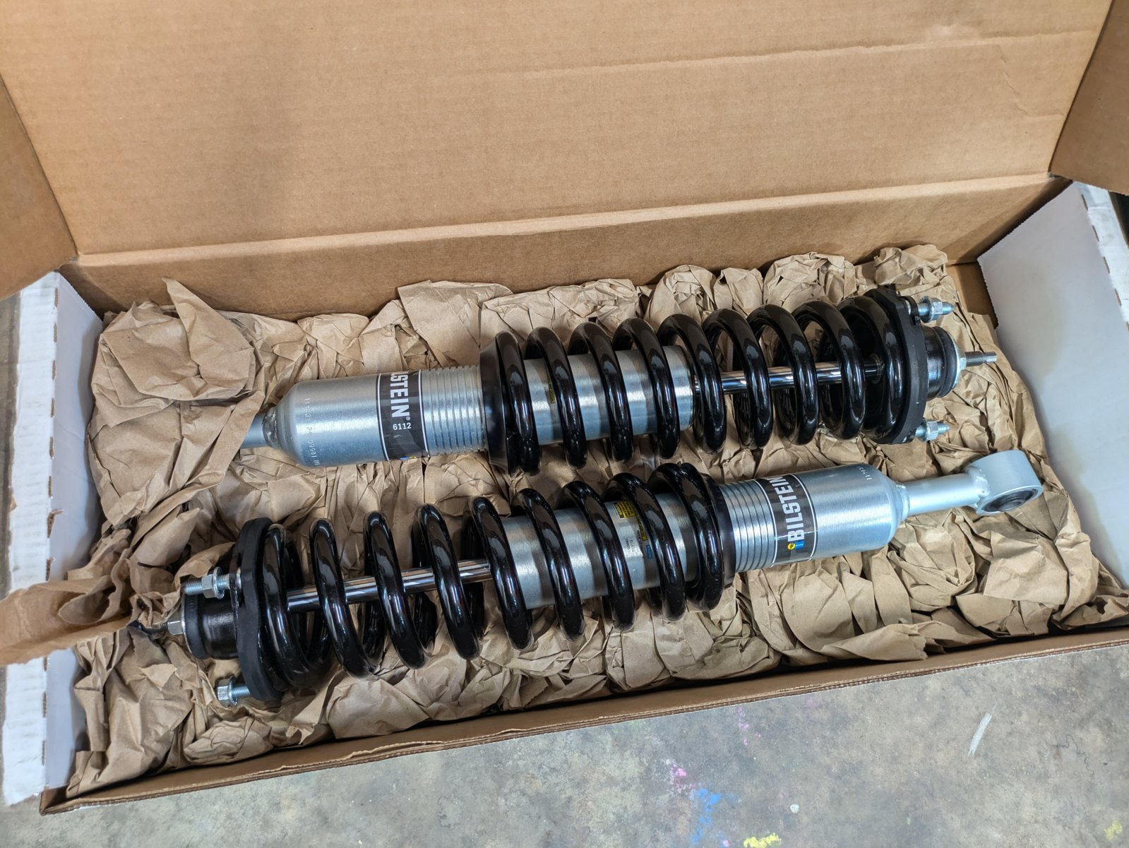

    Finished the install.
    Rides like a dream, no more clunk!
