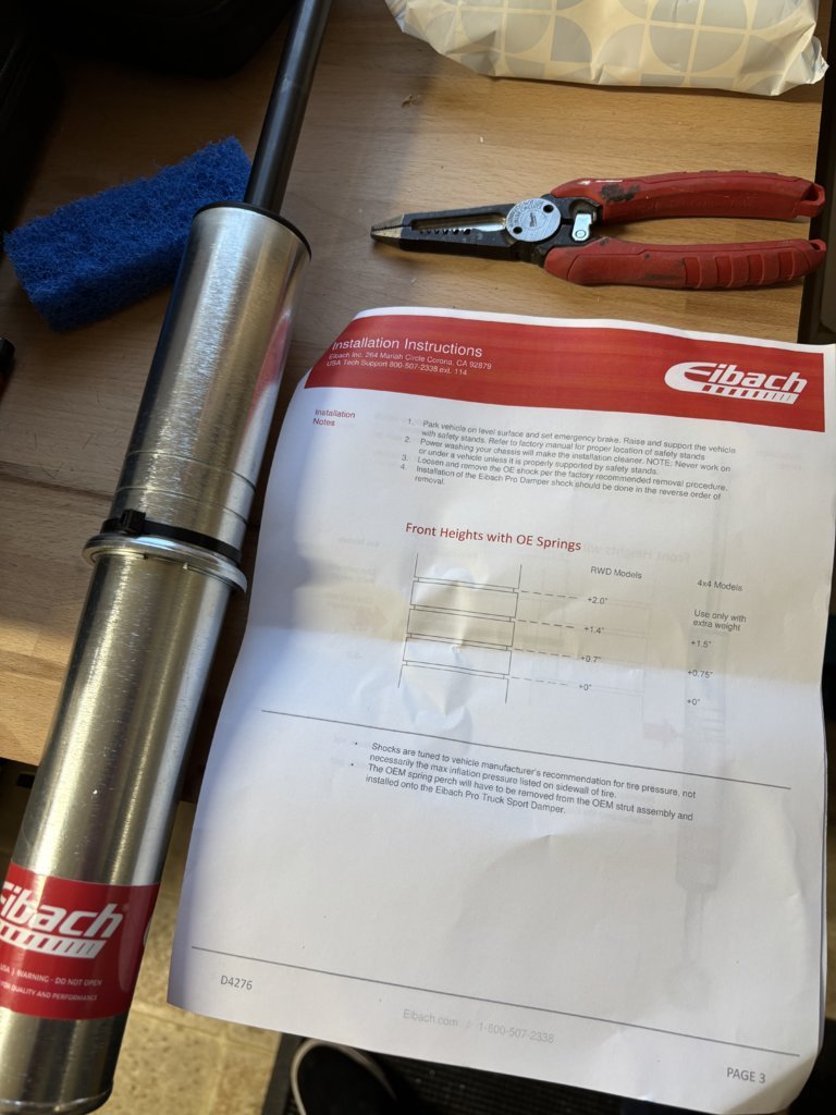

  12. Jan 8, 2025 at 6:09 PM

    Nice. You going to leave it on the lowest ring, or bump it up one? 3/4" seems about right, and shouldn't affect the ride drastically.

    Just got them bitches on. I got it set at the 3rd 1.75” notch. Taking it for a little spin before I get an alignment.
    A few notes…
    The bump stop is inside bottom of the top plate.
    On all these new TGNF frames, you want to loosen all bolts on the sway bar, BOTH sides… It’s a lot easier to work on.

    Fresh of the alignment rack.. It drives like a bilstein 5100, which is not a surprise. Glad I did the 3rd notch. Tires are 285/70/17 rubitreks on method 17x8 +25mm
    Prob gonna change suspension again in the summer. These little shocks can’t handle extra weight and I’ve been eyeing the C4 bumpers
