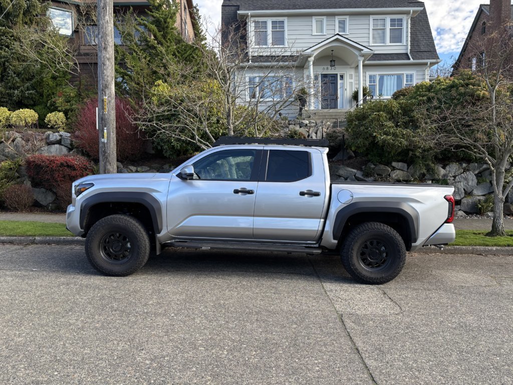

    have any pics of the truck with the front in the tallest position?
    you still have rake & as stated, rear is loaded...
    dont be afraid if the front is a fuzz higher than the rear, it will look great...
    These trucks & their height angles are tricky...
    Even if the front was higher than the back...
    If you look at it from the rear looking forward, the rear will still look higher...
    Thats why I state a little compensation isn't going to ruin the look...
    You need at least 2.5" to level these trucks.

    Per included instructions. Top clip is for added weight suspension.
    … I installed it on the 3rd notch. So,
    No I do not have pics of the truck in top clip.
    I think it looks great at 3rd clip. It raises it about 1.5” I’d say. The rear does compress a little with my 300lb decked system, it probably squats almost an inch.
    Not even I’d say.
    Damn I really regret not buying the rear resi shocks.

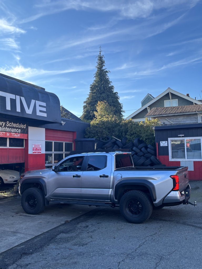

    Sorry I’m parked on a hill in this pic

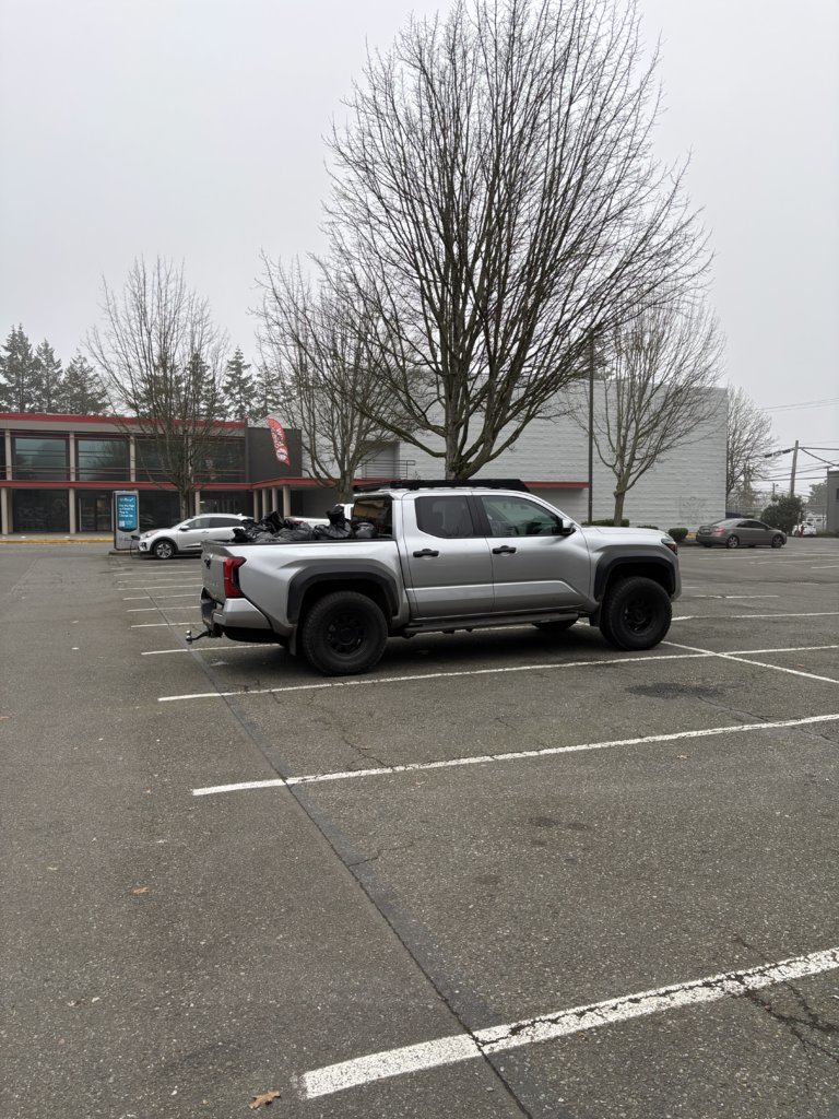

    This is decked drawers, prob 100lbs of tools, and a 1/4 yard of gravel on the stock rear with timbren bump stops. It rides like ass and hits the stops on anything in the road.

    I’m retarded man… I’m gonna order the higher rated rear springs (500lbs - 1” rear lift).
    If I had to do it all over, I’d get the rear resi shocks and the rear springs and some jba uca
