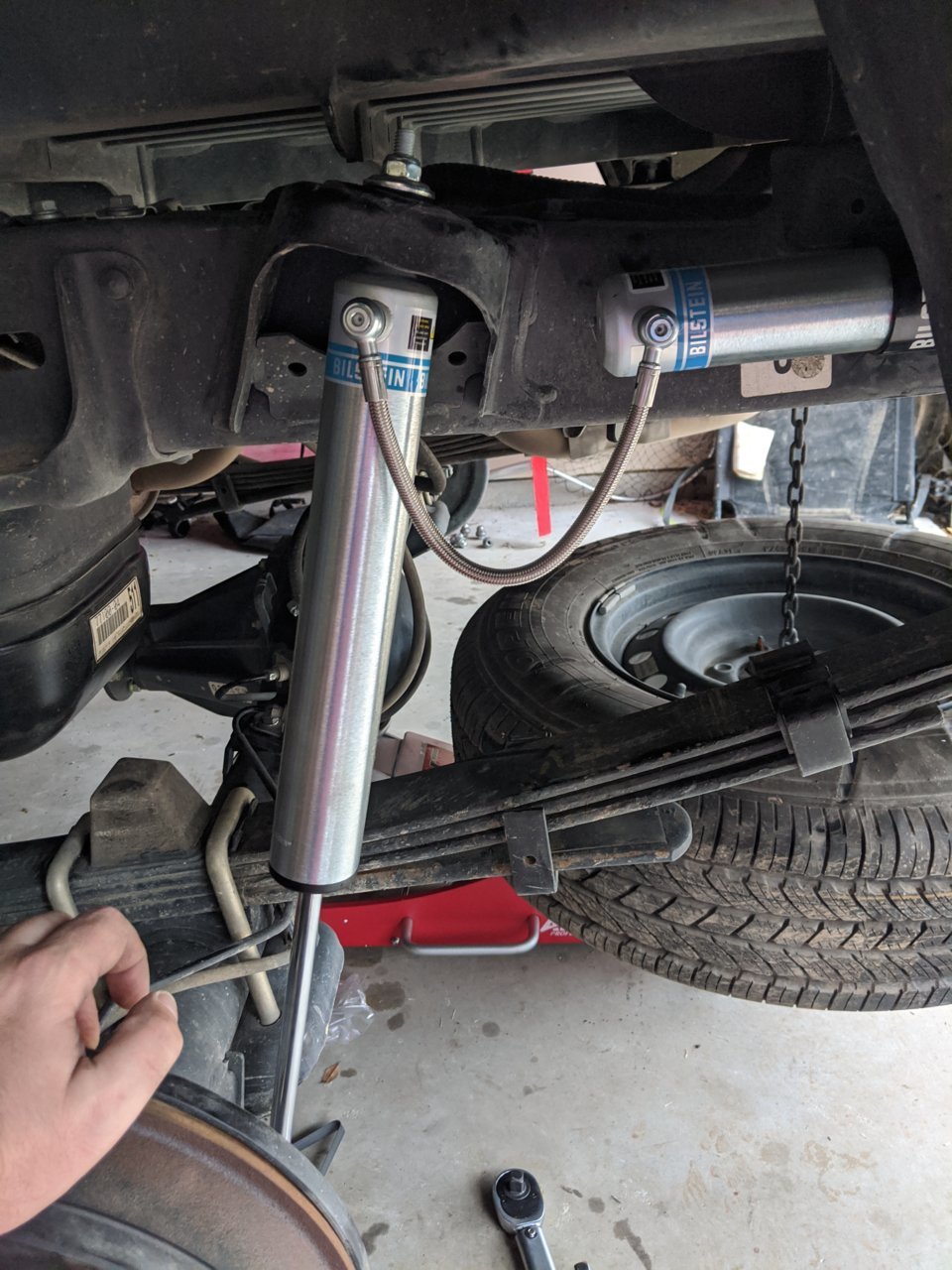

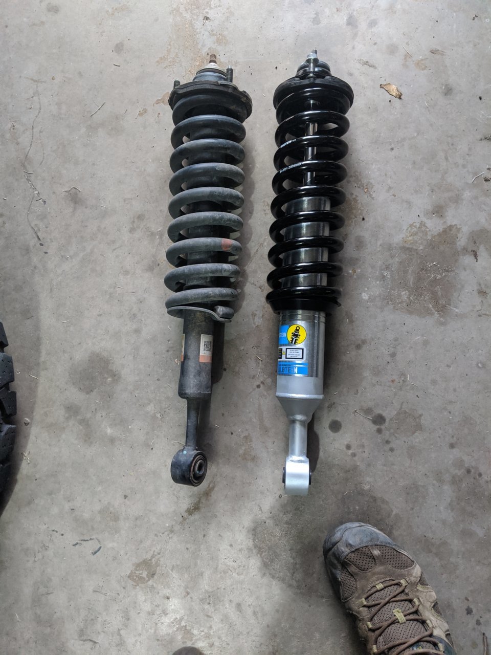

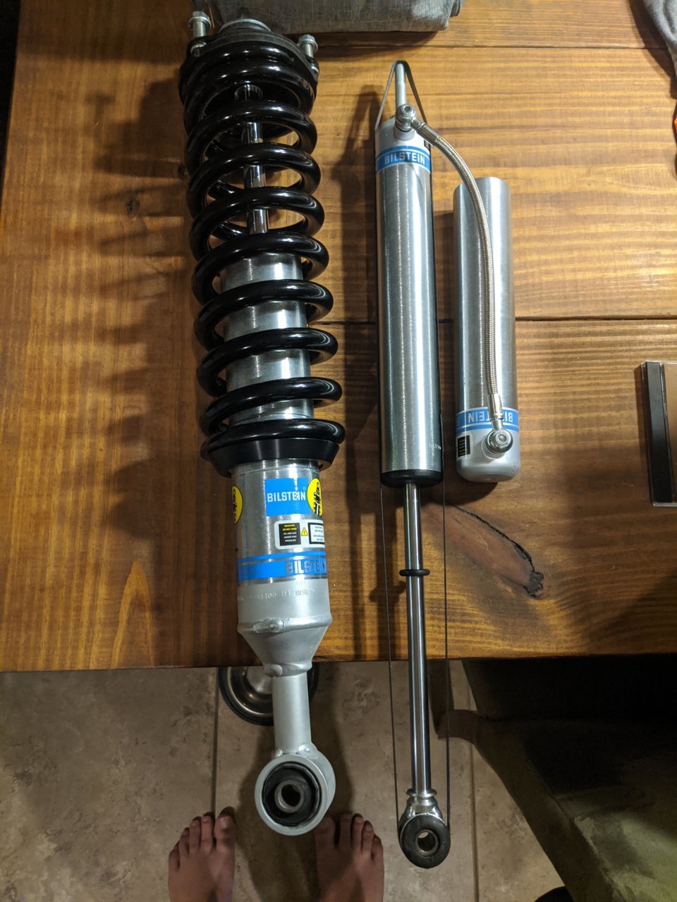

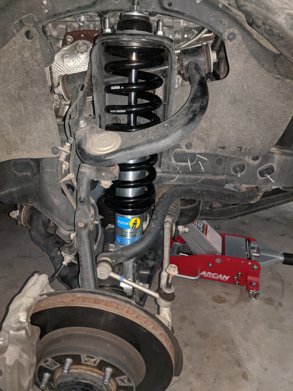

    I was going back and forth on this for a while and decided I would spend a little more to do it right and went 6112/5160 and I love it. Icon rear AAL as well through Rouge-offroad, spend the $130 and have them pre-assemble so you get all the new top hat gear and saves you from having to deal with death trap spring compressors:
    https://www.rogue-offroad.com/product-p/tacostage3.htm
    For reference this is the top notch setting 6/6 with the driver side spacer to help with the lean and the icon AAL in the back.
