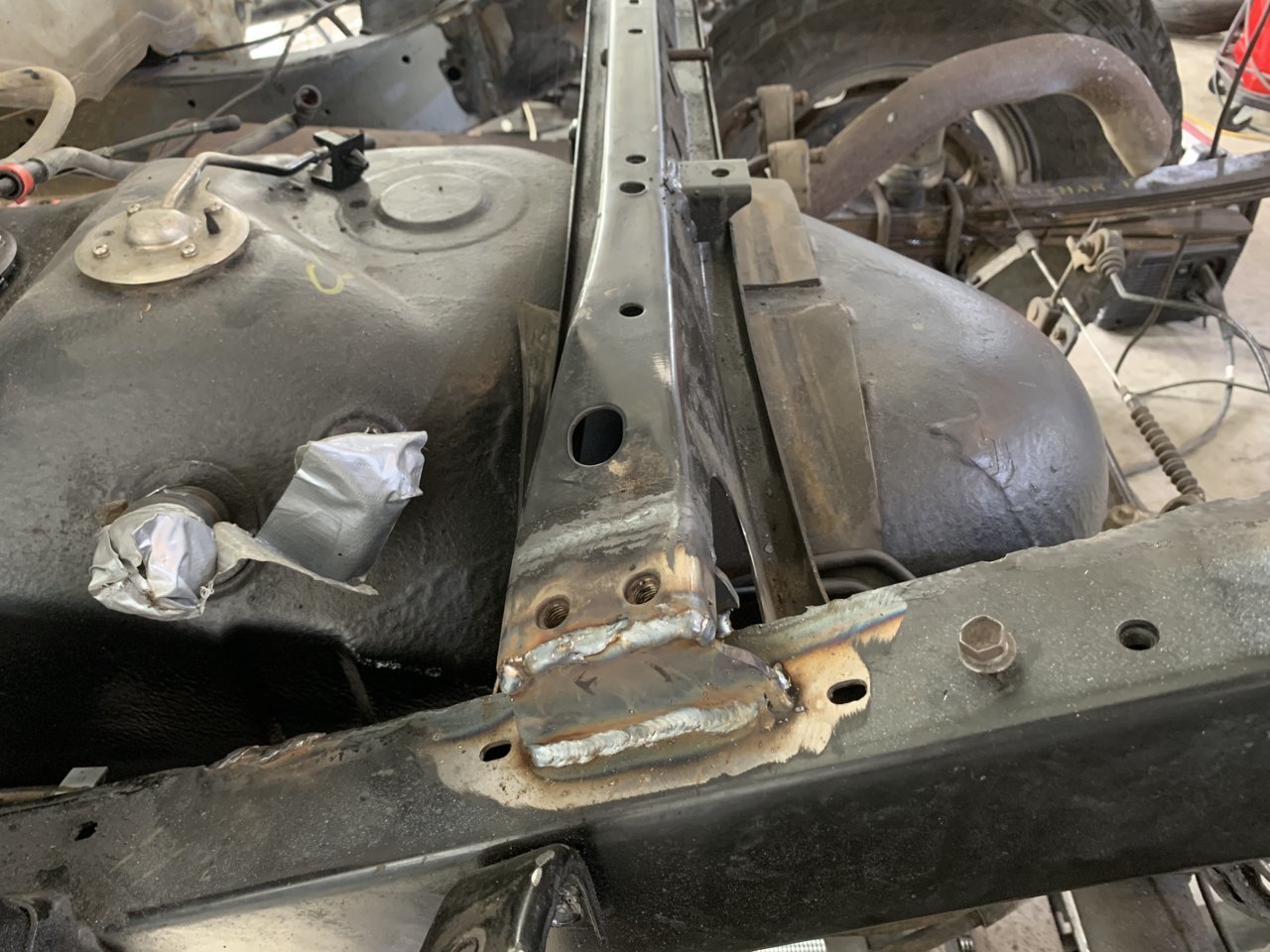

    Same - I think boxing is preferable to plating the outside.
    I’m thinking about how I can incorporate a frame plate into that section if the crossmember is cut to frame ID...
    I tapped the passenger side forward an driver rearward until the top cleared, then went up with passenger side for more angle. I also removed the strap across the bottom.
    It’ll come out. :)

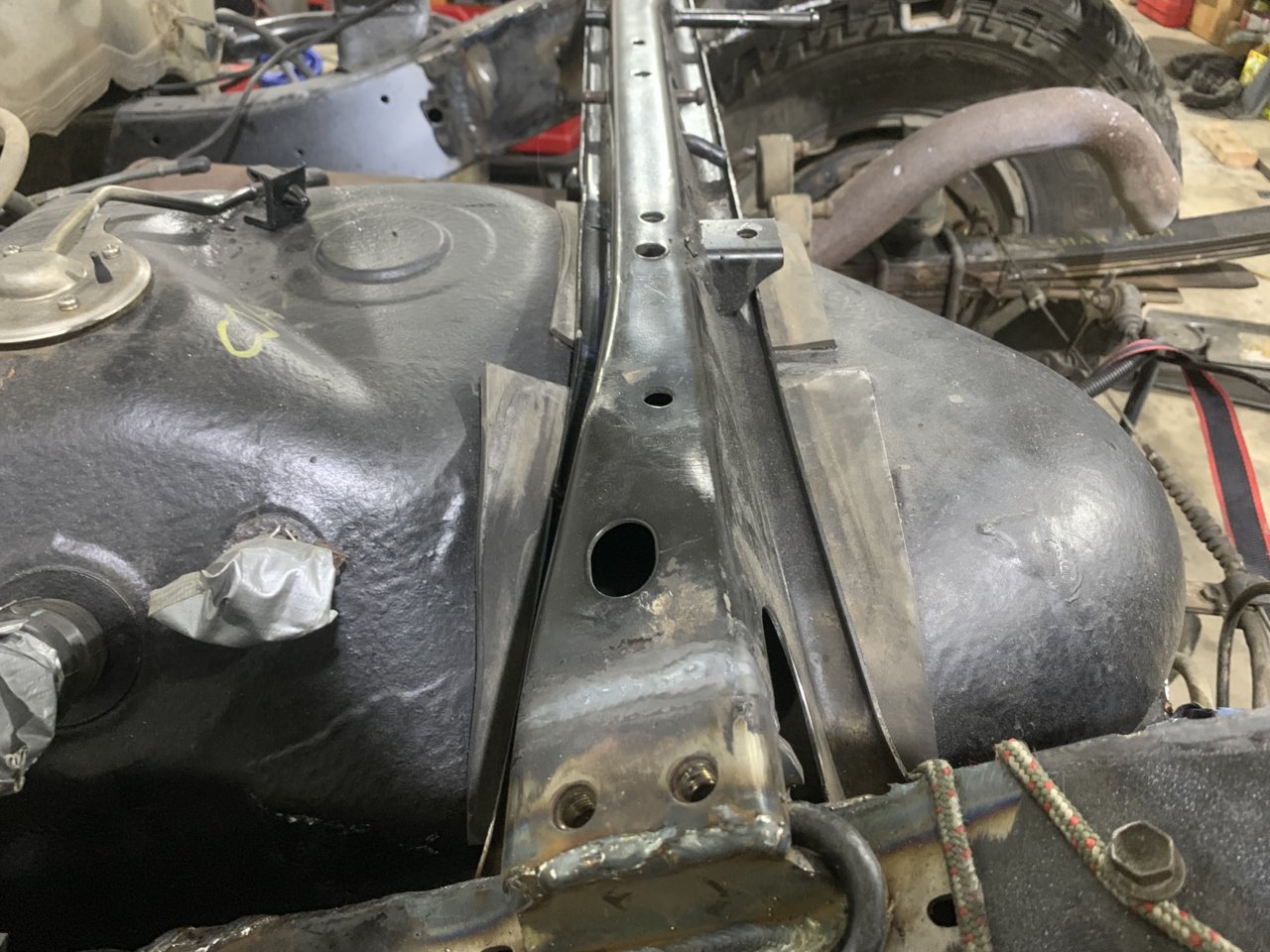

    You haven’t been able to test this with the tank yet right? So the issue I ran into when going up 2” is that if you go straight up 2”, because of the angle of the frame you are actually moving the gas tank forward at least an inch (possibly more). So if you are using the current locations of the frame I would make it so the crossmember can get moved back an inch or so and only 1 and 3/4” tall (still nets a 2” raise) but that’s based off my redneck math. Anything beyond that I call on @jubei. Since I already burned my crossmember in I had to do some work attempting to move the front crossmember up more (part of which I needed to cut into the gas tank mount) as well as notch and smash the tank crossmember.
    Tests yesterday:
    And tests with my adjustments today:
    jubei and ToyRyd04 like this.

    I went straight up perpendicular to the horizon, not the perpendicular to the frame (which throws it forward.)
    Should be good to go; I pick up my cut & bent pieces next week, then on to sliders.
