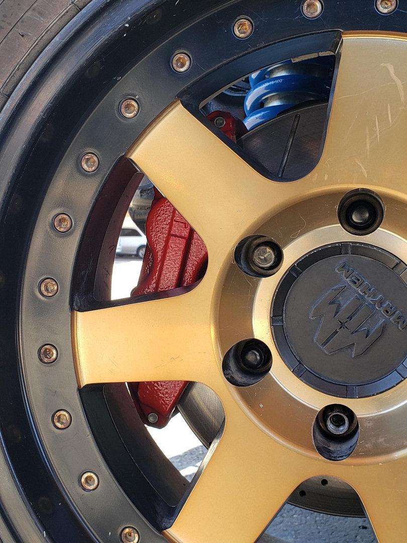

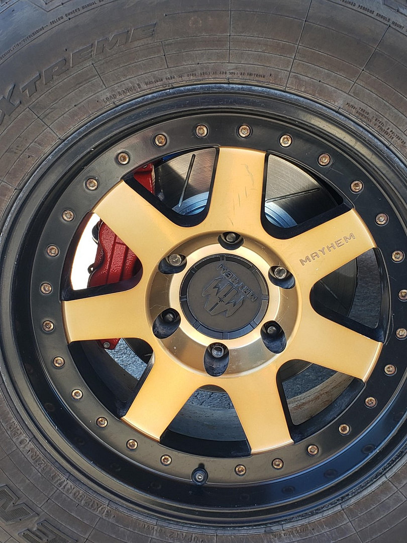

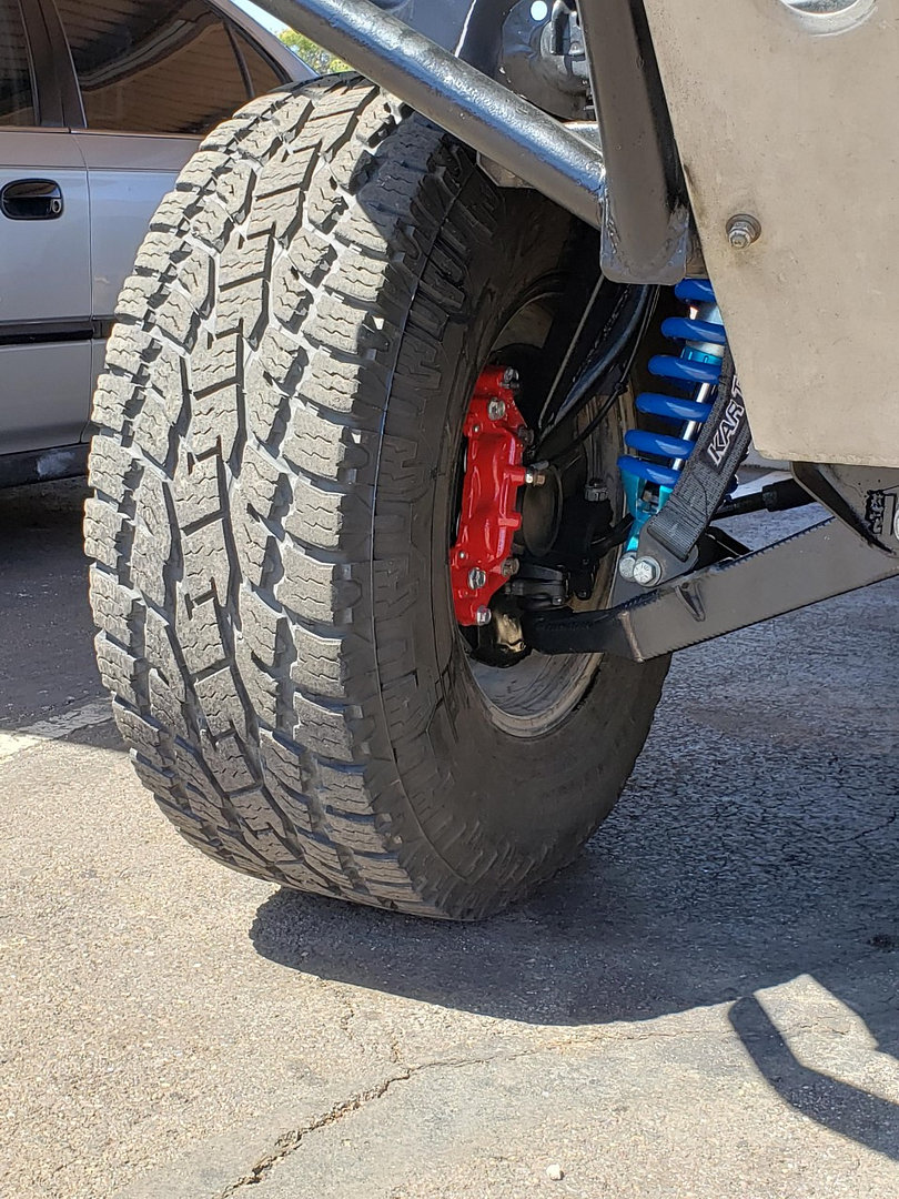

    So I got the brakes done today. Definitely need to figure out if there's still air in there or the pedal is wayyyyyyyyyyyy softer now. I can't see how it could be this soft. I don't have any more air coming out of the bleeder when it's cracked but when I have the one man bleeder setup on the drums the zip tie can't get my clear plastic tube tight enough and when I press the brakes, fluid is coming out of the hose at the bleeder. I guess it's possible I'm letting a little air back in because of that. I had to stop for the day and get cleaned up. Pry going to go buy some more brake fluid tomorrow and try bleeding a little more/better.
    Good news is the front passenger caliper's pistons actuated and seated the pads right against the rotor as they should be. My idle is so insanely high right now it's stupid. Bleeding the brakes this fucking thing was running at like 18, 1900... Shit is driving me nuts.

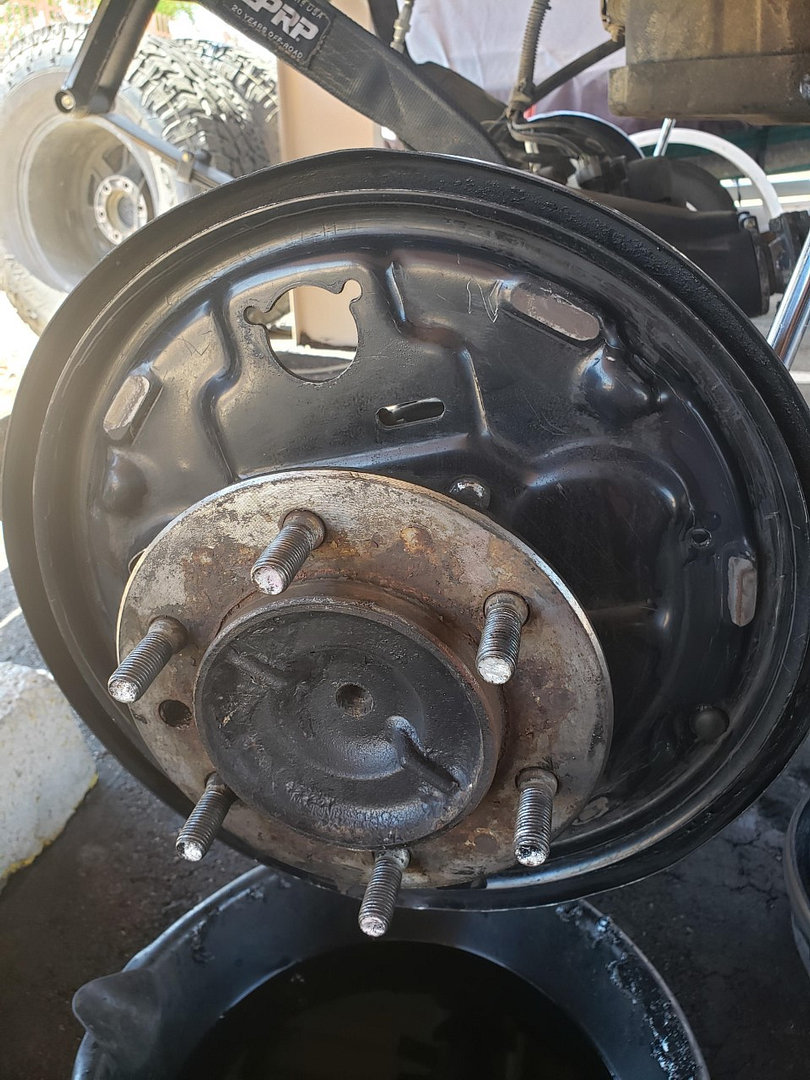

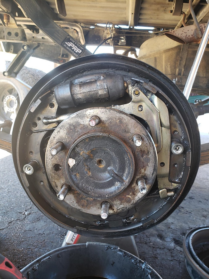

    How many licks does it take to get to the center of the Tootsie DRUM?! 5 cans of brake cleaner and a 10 pack of shop towels...

    Went out there today and re-bled the brakes for the 69th time. No improvement and absolutely NO AIR. Pedal is definitely softer. Took the truck to get washed and get IN n OUT... Approximately 6 mile drive. Washed it, never got out and then straight on to In n Out. While waiting in the 15-20 minute drive-through only line my TRANS TEMP kept climbing and climbing, finally getting up to around 290 before I pulled out into the parking lot and put the truck in P to eat. While in P the truck is idling at 15-1600... The water pump is obviously spinning faster so while in P the trans temp fell to 245 by the time I was done eating (5 minutes). It fell another 10 degree over the drive back home but still upward of 225-230. The high idle has the truck pushing through the converter at idle. I think this has to be why my trans temp is getting so high. We noticed the same exact thing on our EASTER DAY CAMPING RESURRECTION fail before the truck DNF'd. In the two years now that I've been using the OBD2 blutooth Torque Pro app the only times my trans temp would get above 200 is when we're towing the jet ski 3.5 hours down to Mexico. The trans temp when towing usually is between 190-220 with a high of 240. I have never seen my truck trans temp past 190-ish city driving.
    Other note: Brake pedal is soft but the truck stops and the brakes almost lock up. Definitely more stopping power. Parking brake not working however. Not sure if I need to turn the adjusters more... it feels like the pads are slightly touching the drums so not sure. Alignment is off and I don't feel like dealing with it like I have twice now in the last year or so. Just going to pay the $60 and take it to the alignment shop tomorrow. Hopefully they can look at the brakes too and let me know what they think.

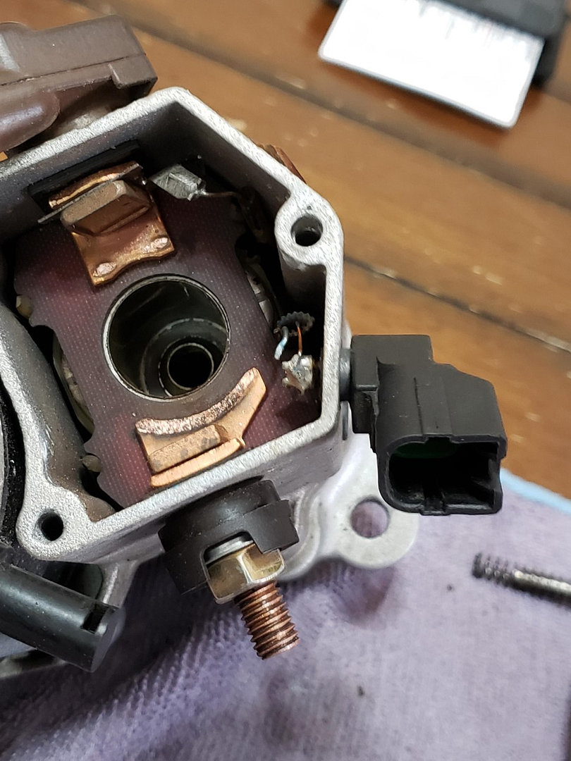

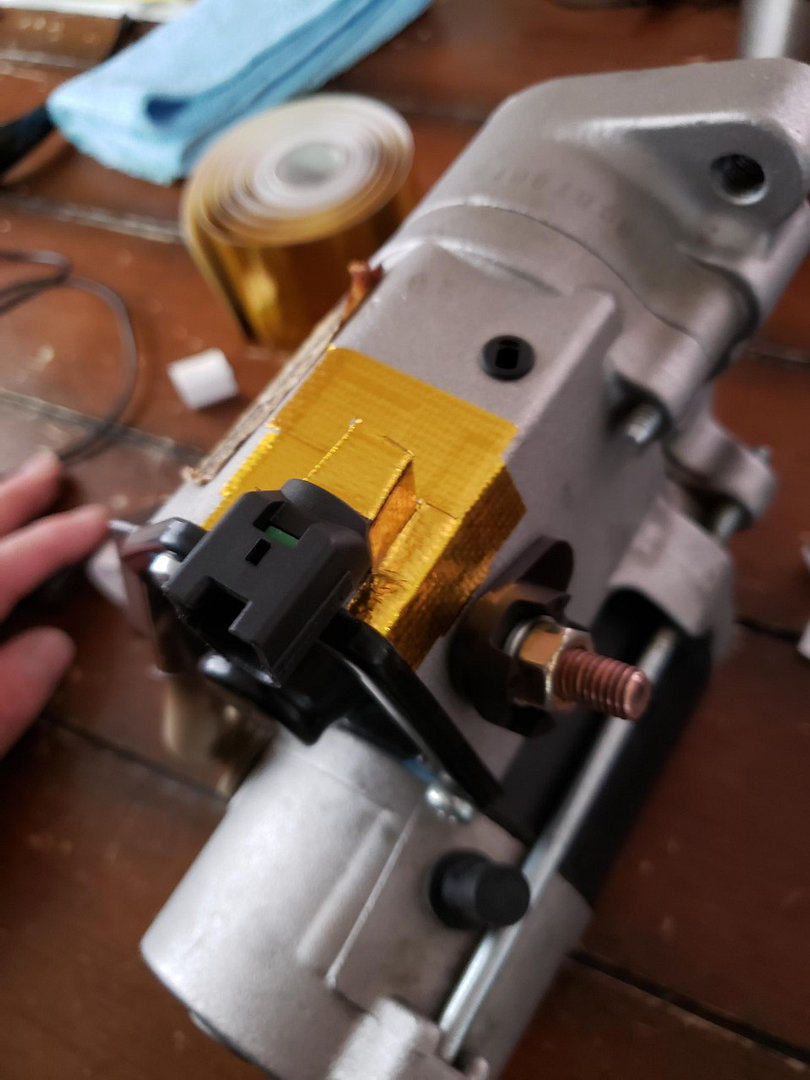

    WELP! I'd say there's my intermittent OPEN. Fucking AUTOZONE starters... this is complete bullshit! This is what has been fucking me?!
    LukeCC and Dalandser like this.

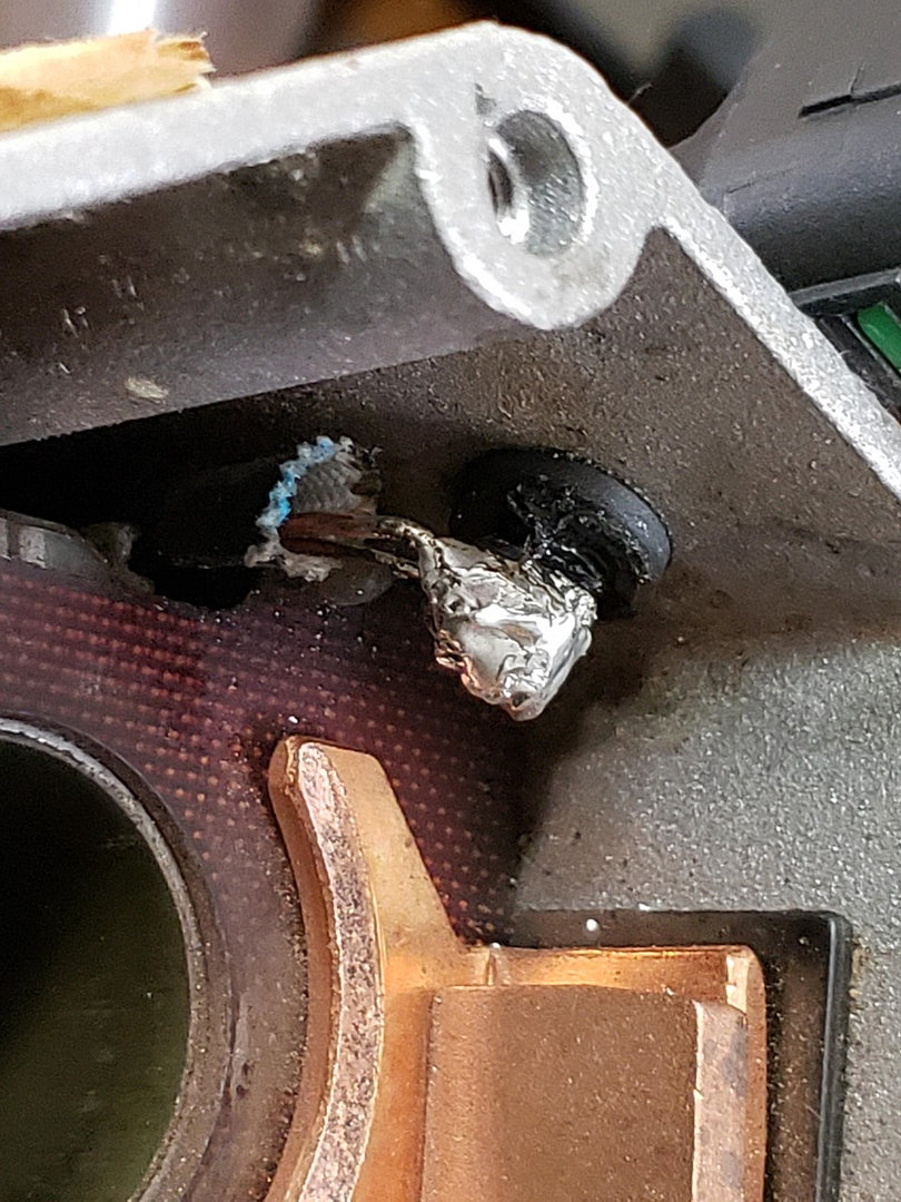

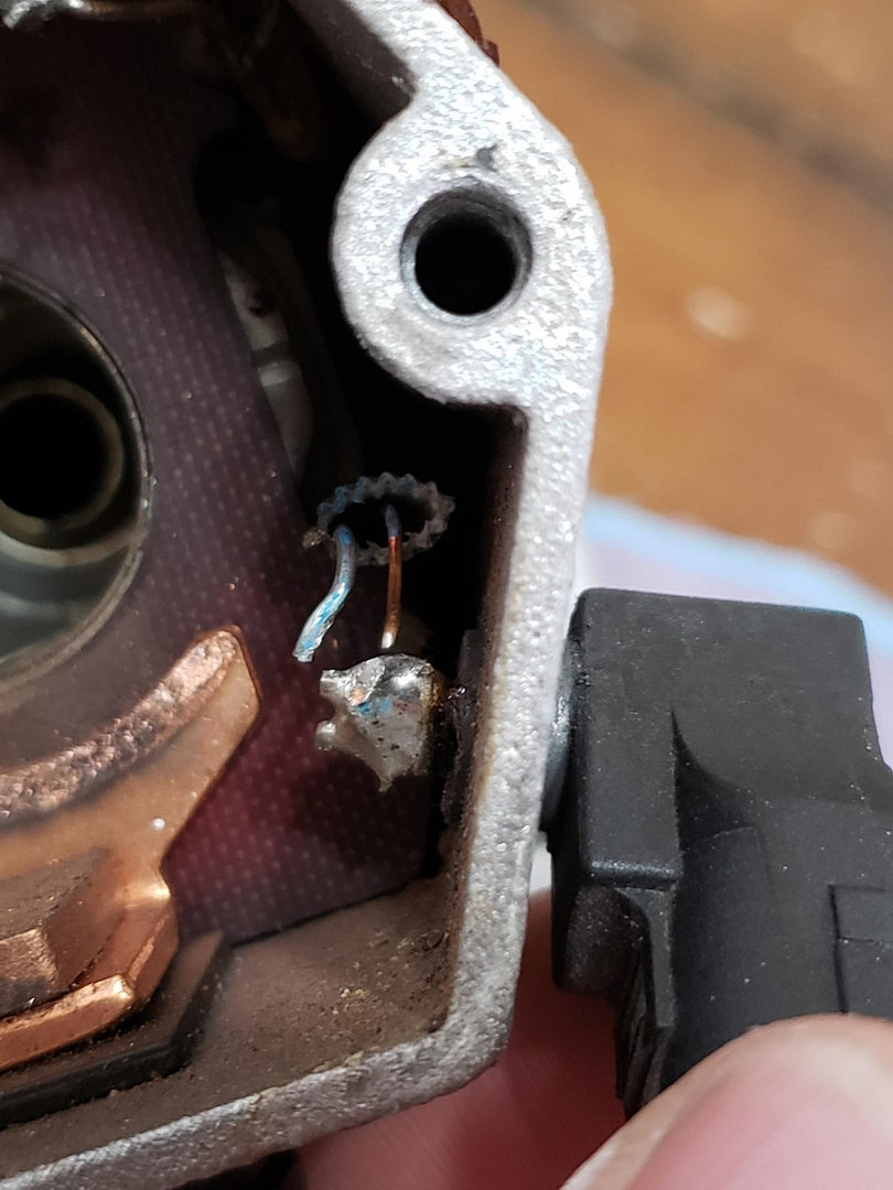

    This is all because the truck would start and run but first time you turn it off, no restart. No crank no nothing. I had been fucking with the neutral safety switch for the last 3 days and was absolutely convinced it was that. This morning I went out there and was putting pressure on the starter signal wire at that connection while I pressed the remote start button for the 2 way pager alarm and it starts right up. You let the "free" meaning, not touching it but it's still plugged in, nothing. I knew that connector felt way too loose, too much play side to side. Well now we know why. What a fucking joke.
    I don't know if I should just solder this myself or go get a new one for free. Who's to say the new one doesn't do the same thing?!

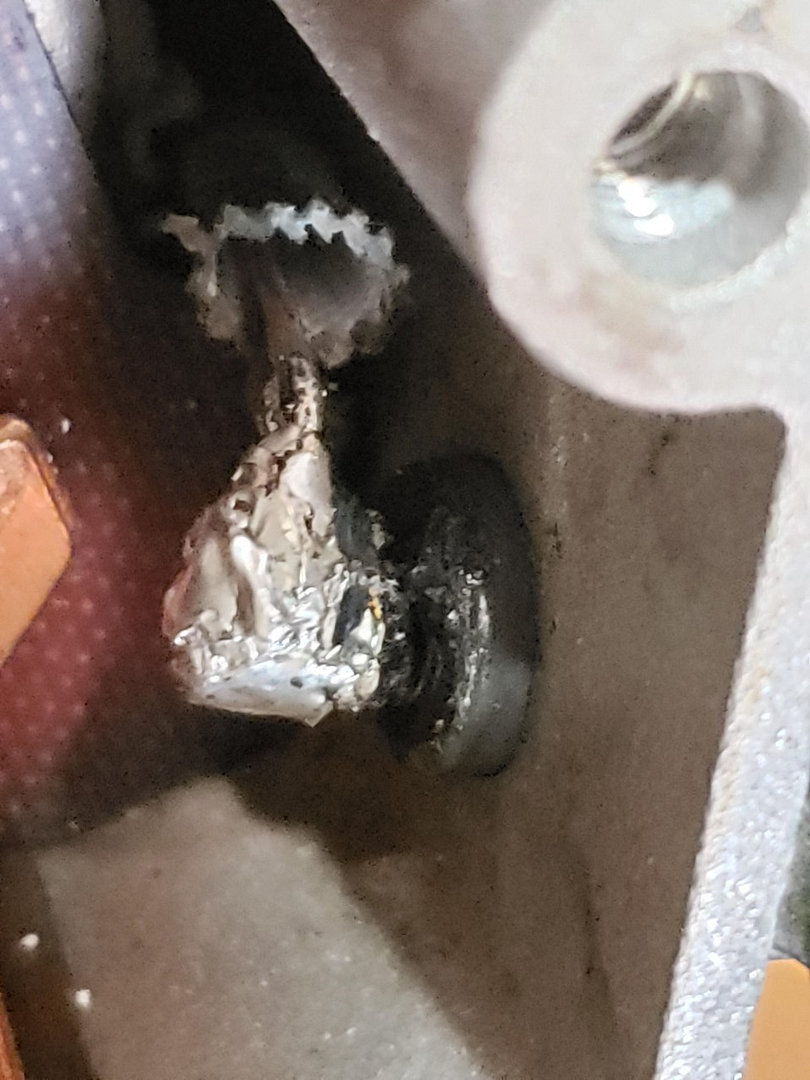

    Decided to solder it because this starter was only 4 months old from Autozone. It's super stout now. Got the original solder so hot that it pooled into the new solder puddle to create one big lump of solder. Put some heat tape on the outside just to keep the side to side play at a minimum. I'm sure it will come off but for install it was good to have. Tried to be super careful putting it up in there. I can't believe that connector doesn't have something securing it in place... If it turns a quarter of a turn at all to either side I would bet that the copper inside has been compromised. Thank god I finally found this because it was getting super annoying.
    To reiterate through all the bullshit above.
    The no crank, no start nothing ended up being an INTERMITTENT OPEN inside the starter at the 12v signal wire connector where BLACK/WHITE enters starter from STA RELAY. This was NOT an alarm, neutral safety or wiring issue.

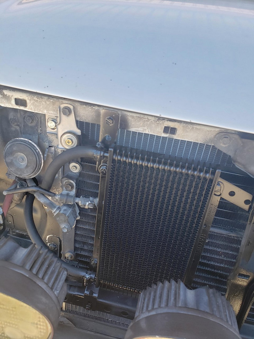

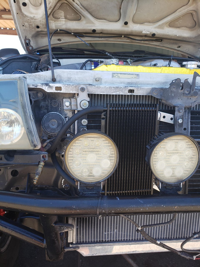

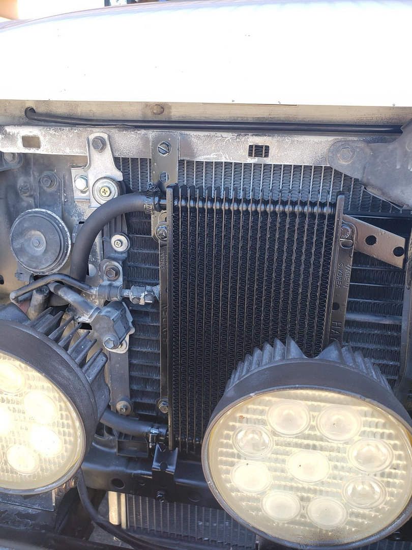

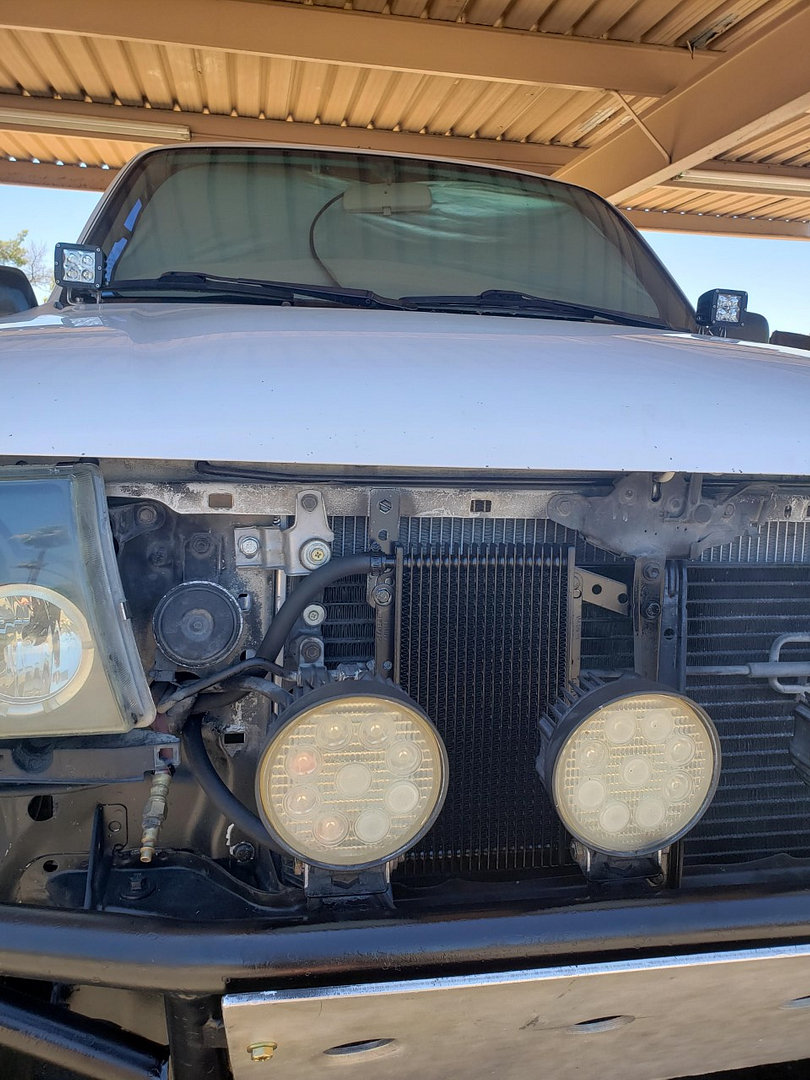

    Finally got some trans maintenance done. Ordered the wrong trans filter. Apparently the A340E 2wd and 4wd filters are different. I was absolutely embarrassed to see how disgusting the fluid was. There was a thick sludge covering the mesh filter and bottom of the pan. There was only 3 out of the 4 magnets in the pan so someone has been in there before I owned the truck. I feel like the biggest douche bag for saying that I have NEVER dropped the pan on this trans in the 12 years that I've owned it. I put the new filter in and used the included rubber gasket so I don't ever have to scrape FIP gasket off again.
    I decided to throw a trans cooler on there as well while I was doing the new fluid/filter. Purchased the smaller Hayden 11"x7.5" cooler without fan. Ran it inline with the champion 3 row. Filled up fluid to correct level so I don't puke all over the under belly per my last few fluid changes LOL. The truck shifts like absolute butter now out of P into R or D. Driving shifts are butter like they always have been. Fluid temps in a 45 minute test drive never got above 220 and that was only because I was in an IN n Out drive through for 12 minutes. Sustained airflow through the grill and this thing is sustained around 195 now.
    My only concern that I had is how well it would do with the fluid warm (190) then have it in D for a period of 10 minutes or more IE long drive through wait or border wait/stopped traffic. I knew that it would start to heat up with prolonged stop and go or just plain stopped with truck in D without a fan. In the spot that I have it mounted currently I think I'd have to cut out the inside of the plastic grill to have enough space to mount a small 7" pusher fan. After I hit 220 in the drive through, pulling out and minutes later on the freeway the temp had already fallen to 190'ish. Right around 205 by the time I was putting the truck in P back at the CRIBO.
    Overview: Trans temp is now good with airflow. Parked with the truck in P, trans temp falls to 185 or so. Parked with truck in D and the temp does still slowly go up albeit I bet it takes twice the amount of time to climb to 220 now. Problem I see is if you're in stop and go to where you can't keep putting it in P then you'd pry want a pusher fan.
    Going to look into a small pusher fan. Otherwise, my TRANS TEMP CONCERN is now marked as RESOLVED. If I had to guess, combo of filter EXTREMELY clogged and horrible fluid condition. Trans cooler is definitely MONEY WITH AIRFLOW.... NO AIRFLOW and I think it needs a pusher fan.
    Still have a little higher than normal IDLE as well but jury still out on what is causing that issue. It's reasonable enough to drive but still annoying. 1250rpm cold start, 1350 when it's warm, 1500-1900 when you put the truck in P after driving it (BUTTERFLY VARIENCE) Back to 1350-1450 if you BLIP the throttle real aggressive to 4 or 5k and let off suddenly it falls back to a reasonable 1350 but still annoyingly high.
