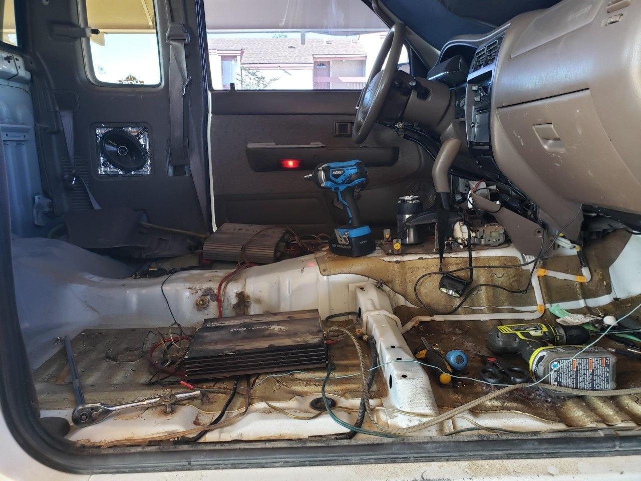

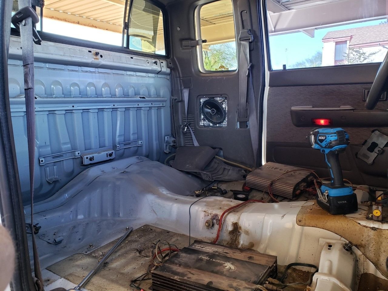

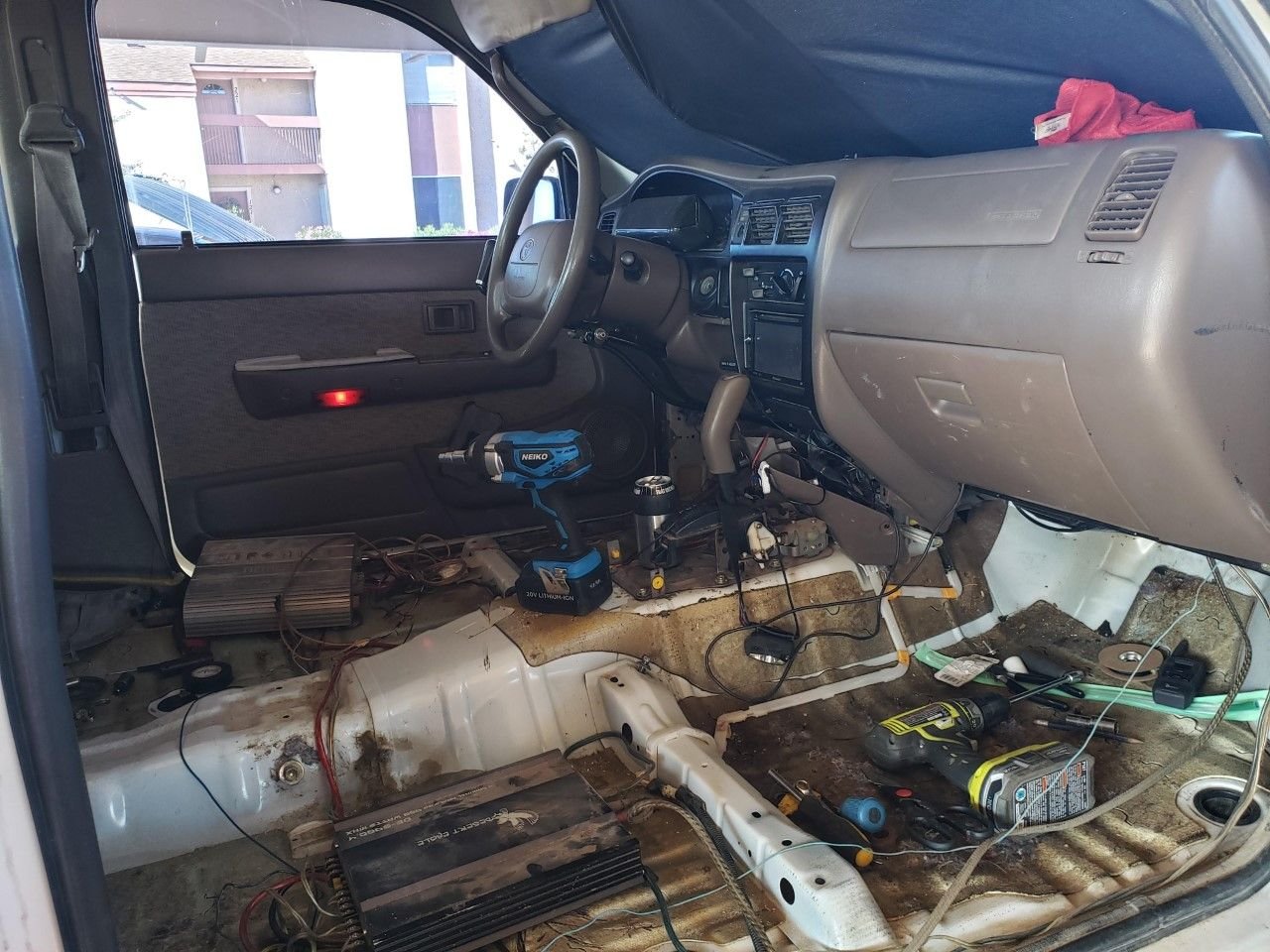

    I couldn't stand the carpet any longer. Too long to clean up after Mexico. I also wanted to make a platform in the rear ext cab space with incorporated down fire sub box. The one I had in there was huge and took up all the space behind the driver seat. I want to make that space more useable. Now that I have it almost completely gutted except the dash I think I should sack up and do the cage now so it's not twice as much work. I also bought new fixed back fiberglass bucket seats off of Ebay. We'll see how they do. I couldn't afford PRP right now and I can't stand these reclining chinese racing seats that I put in there 3 or 4 years ago. I really didn't want to go back to the stock Toyota seat either. Now that I have new seats I should just do the cage now. I actually got a fabrication job a couple of months ago. My boss, the owner of Diamond Lead Reels and Premier Patio and Design/Premier Powder Coat has all the essential tools to get the job done and already said I can use the shop whenever I want. I never bought a 1 3/4 die for the bender I bought years ago which sucks but I can't spend $290 right now on a die. If I had one I could have already had the B pillar hoop done.

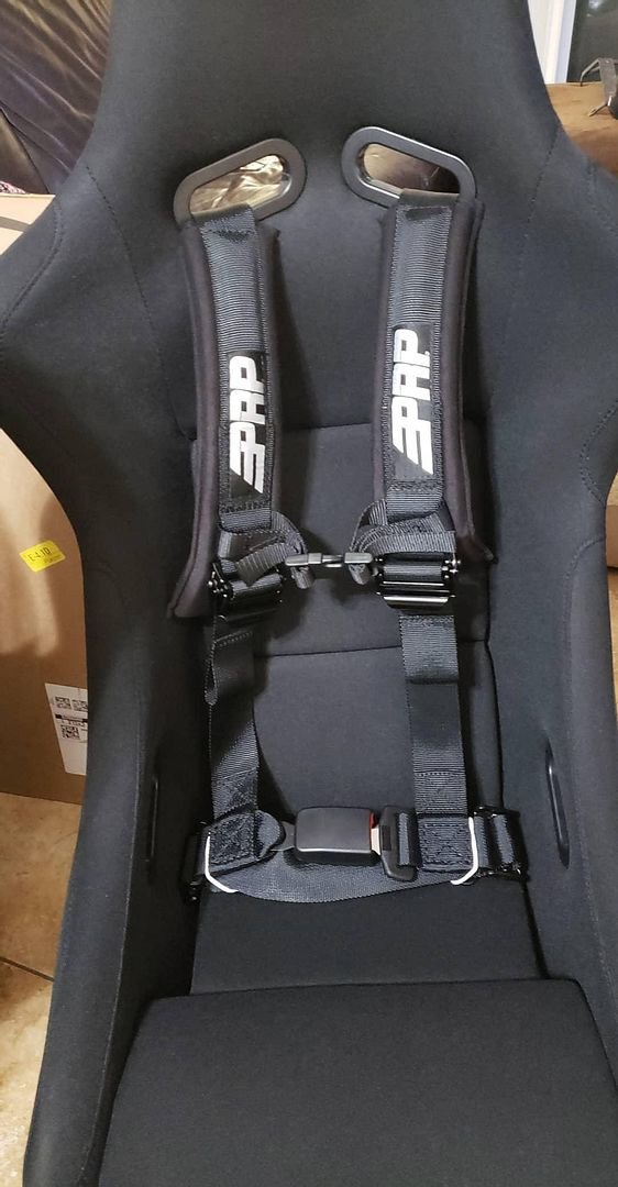

    Got my seats in 3 days from Cali off of Ebay. Overall impression is you get what you pay for. They are decent though. I temporarily retrofitted the steel frames I already had from the old seats that I got with that purchase years ago. That was about the only good thing that happened with that purchase is the seller coincidentally had Toyota Tacoma seat brackets that he threw in for free. When I do the cage I will do away with these brackets and mount the seats to the cage. Until then I wanted to still be able to drive the truck right up until I do the cage. The seats are a world of difference over those shitty reclining racing seats from Ebay OMG. You are definitely secure in the seat now. I've gone around some corners at 40 late night when nobody is on the road and it's amazing how much more planted in the seat you are in these vs stock or shitty reclining buckets. No upper seat movement now, no creeking noises, no feeling like the seat is ready to break in half. Flying over some of the best speed bumps I can find in the area it's simply amazing how solid it feels now. The only thing that I don't like is there is a tiny bit of play in the sliders which is the only downside so far. The butt and back padding is decent enough but outside of those areas it's just a thin layer of foam between the fabric and supposed fiberglass backing. I think if it really was a problem or something that I don't like in the future it can be dealt with. The seat cover comes off and I feel there is a little room still left under the cover to add an additional layer of padding. That's in the areas not directly in contact with the body at all times, so like behind the head, shoulders, side bolstering. My GF sat in them and said better but then got up and said I'm buying us PRP because she gets cost plus 10 through her work but she's bipolar. When she's in a good mood and likes the truck she says shit like that and then when she's pissed at me and or I break the truck she says I'm not buying shit for this thing and tells me to sell it. LOL WOMEN!!!! FUCK EM FEED EM AND FREE EM is what a pimp once told me. Obviously I didn't listen... She did bring me home some PRP 4.2 harnesses though...

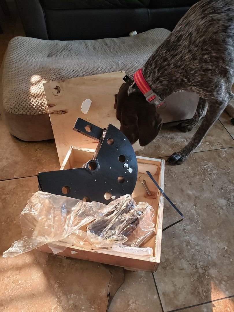

    FINALLY!!! FUCKEX just delivered my die!!! YEWWWWWWWWWWWWWWWW!!!
    GSP APPROVED!!!
