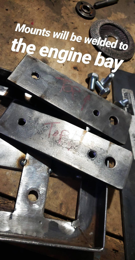

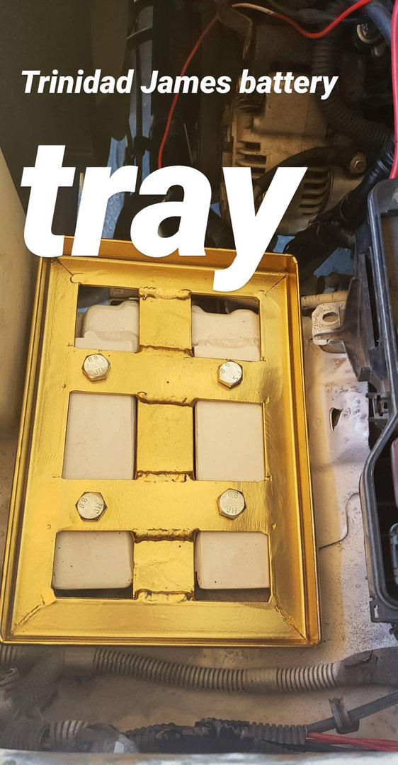

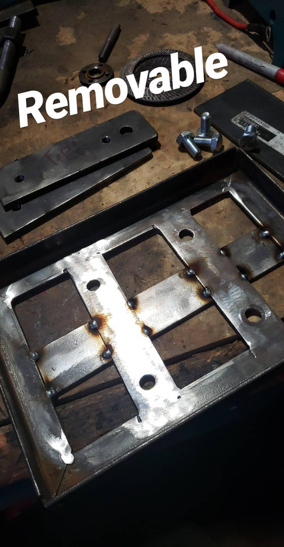

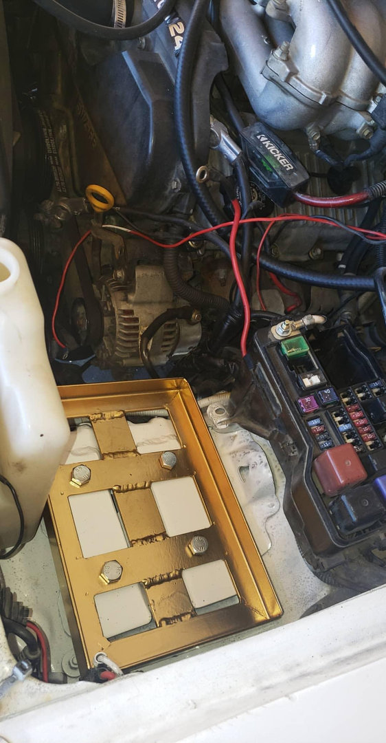

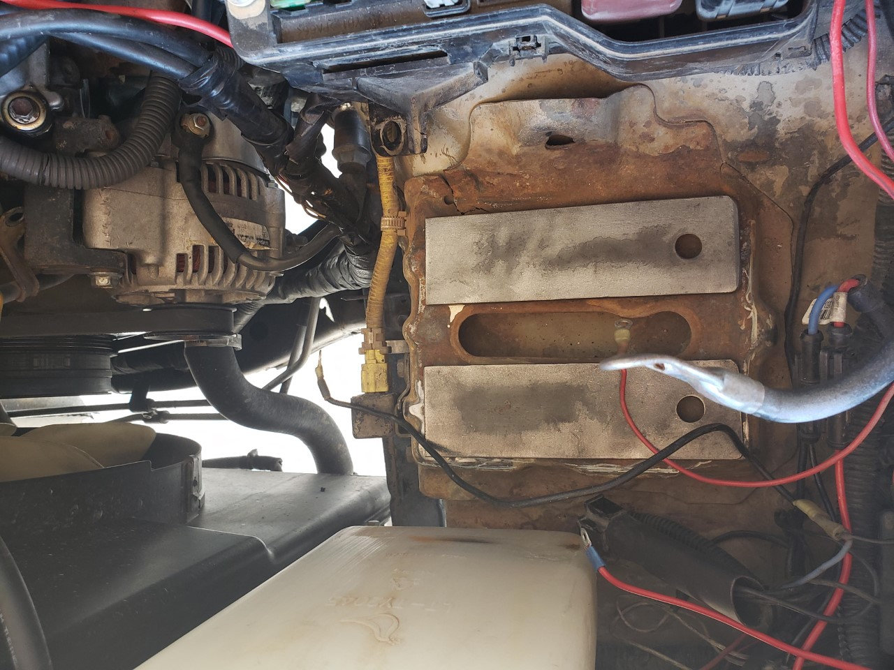

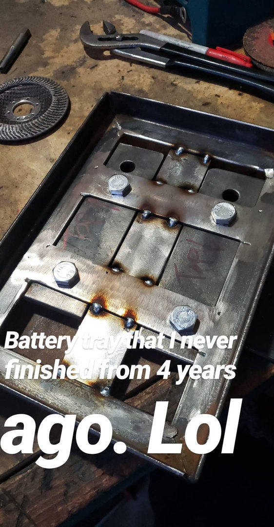

    Almost forgot, included in the last 5 days of fun I also made a battery tray that actually fixes to the truck. I made the initial bottom out of 4 sides of angle iron about 4 years ago but never thought of a way to fasten it to the truck. While we were in Mexico at the beginning of the month we were having fuses blow all day because the battery tray was sliding around and had worn through to some copper on the main power for the fuse box. Decided that now would be a good time to fix this for good and never have to worry about getting stranded again because of blown fuses.
    Took the initial design and added some bracing which also acts as the connection between the tray and the engine bay. We'll see how long this holds before the battery completely rips the shitty Toyota sheet metal away from the engine bay.
    The holes on the right side of the mounts were already there. Just reused some 1/4" scrap I had in the pile. Decided to fill those holes as a rosett weld.

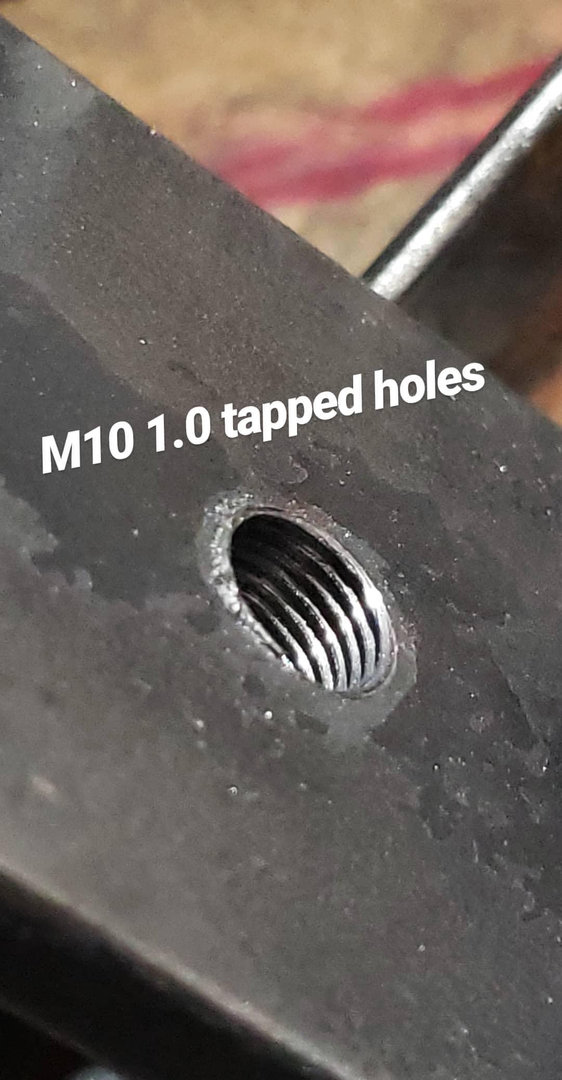

    Drilled and tapped holes
    GOLD ALL ON MY WATCH, GOLD ALL ON MY BATTERY BOX, wait huh?! Shout out Trinidad James!
    I didn't take a picture of the rest of it installed but you get the idea. The top bar is GOLD too. 2" x 3/16 flat bar.
    Shit is in there TIGHT AND RIGHT!

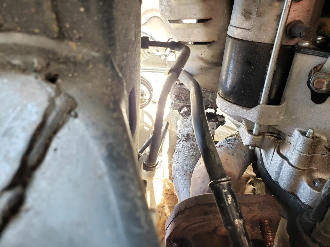

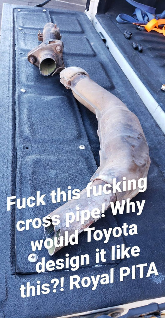

    Went down south to ol mechico a week ago to do some kayak fishing. I had the kayak and fishing gear in the bed the whole time so I never got a chance to drive the truck. Monday night it was time to head home. Right before we got on the highway the massive pile of shit that is my Y pipe/crossover decided to give out again for the 100th time in the last two years. The pipe cracked and sheared all the way through right before the flange to the downpipe from the passenger side mani. I was never able to get the crossover out of the truck. My mechanic said he tried although now I doubt he ever tried, with no luck. I was able to blind weld this piece of shit about 2/3 away around. Zero chance of getting the mig nozzle up in there. For the rest of the way around on the back side and as double sealer I put that JB High Temp 2000 degree cement shit on there. I pry have put $100 worth of that shit on there over the last 2 years... Anyways, boom. Thing gives out all the way right before we get on the highway. Open header for 220 miles, 3.5 hours of just huffing carbon dioxide and listening to that open header. Fuck me. I told my girlfriend as we were driving home that I was cutting this shit off as soon as we got home. I really had no idea what I was going to do. I thought maybe I could fab some headers but the gods must have been looking down on me because low and behold, I found a used set of Doug Thorley headers on OfferUp for cheap.99.
    They were supposed to have arrived today but I guess something got fucked up with USPS. Won't be here until tomorrow now. I can't wait to try this almost impossible task that I've read about on the forums. I got everything off today. Pry going to heat wrap these headers because they look pretty used unless the seller's picture blew johnson.

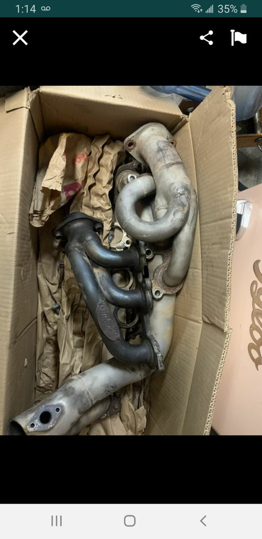

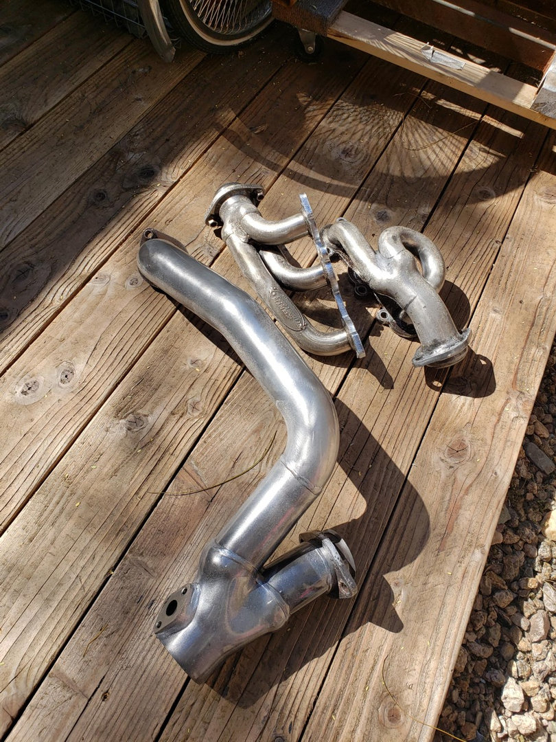

    Shout out to the isolators and survivors! This has been a weird week and a half. I got the used headers cleaned up as good as possible. Welded a few cracks. Side note about these headers: Is this shit really made from 16 gauge mild steel?! There were little cracks developing at the collectors. I dont know how they could have gotten to the inside of those tubes with how tight the collector is on these things and doing an Google search reveled others have had DT headers crack in the same exact spot. Anyways, For $130 shipped I had to take them. Still going to be way better than a straight header!!! LOLLLLLLLLLLL Got them cleaned, welded, cleaned again and painted with a high temp clear coat that specifically states that it bonds to bare metal. Baked them according to the directions at two different intervals, 250 and 400 degrees for 30 minutes. The clear coat certainly appears to have bonded. Only time will tell. Better than what they looked like IMHO. I was going to wrap them until I read that will increase likelihood of cracking. Don't want anymore cracking or header issues so elected to go with clear coat and send it.
    Waiting for some new studs that should be here Thursday. Aside from that, I'm having the hardest time finding the correct DONUT GASKET for the collectors. I know that ID is 2'' and OD is 2.75" but honestly can't find anything with those dimensions. Can anyone lead me in the right direction?
    Also, will the cat inlet take a 2.5" pipe or does it need to stay 2.25"? The inlet on the cat is 2.75". I'm going to have to weld on an extension below the O2 bung on the y pipe as the previous owner cut it right there. It also looks like the O2 bung on the new y pipe will be too far away, higher up the pipe then the stock Toyota one... I might cut the 2.25" pipe with stock O2 location and use that as my connector...

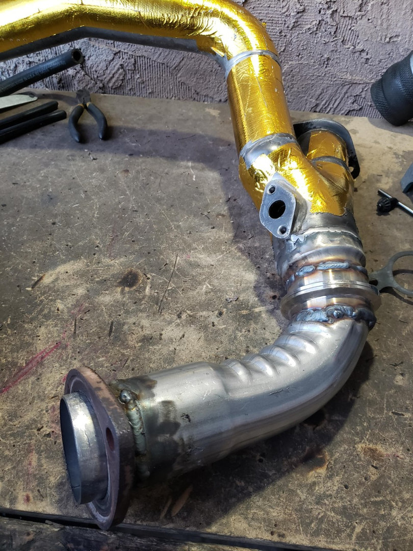

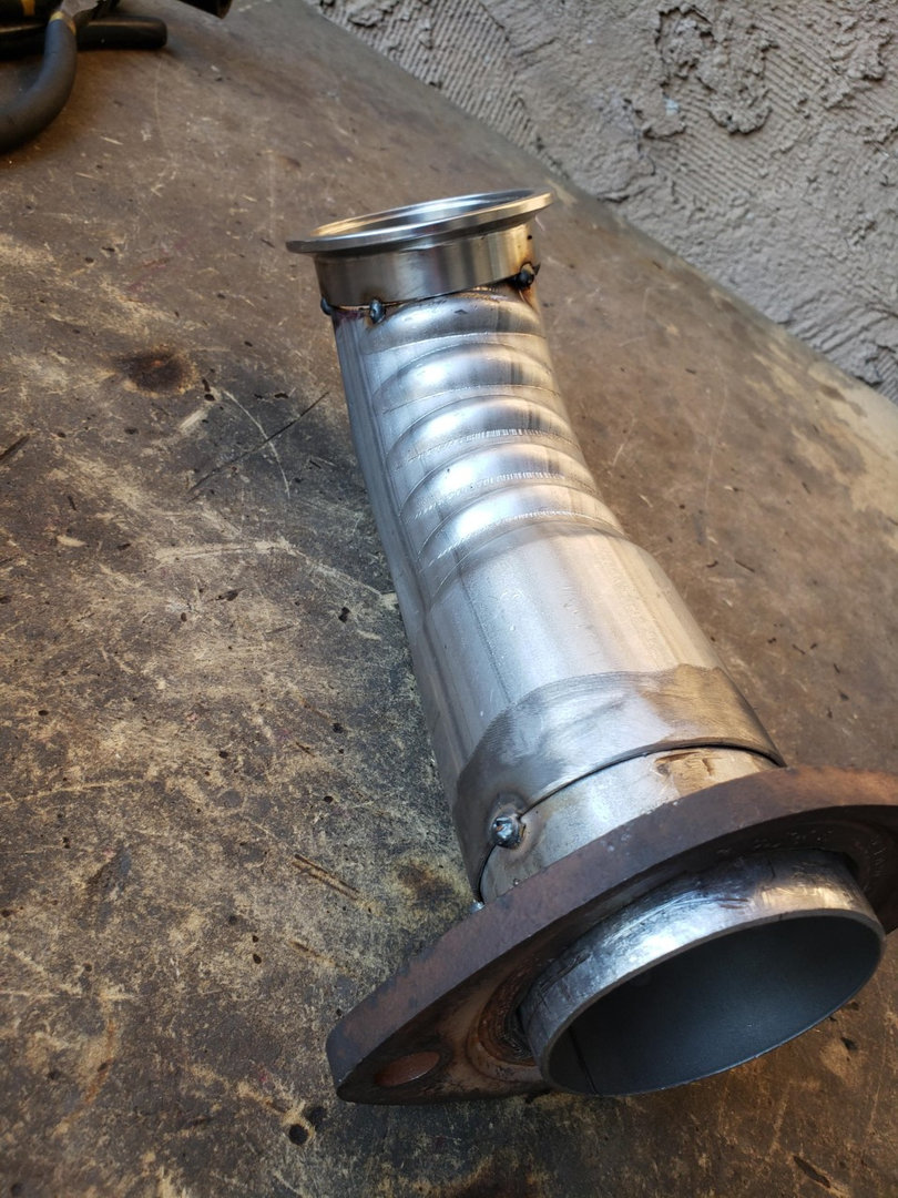

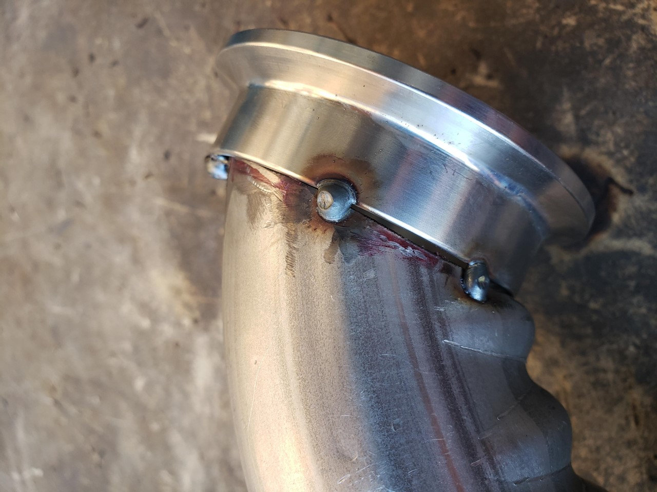

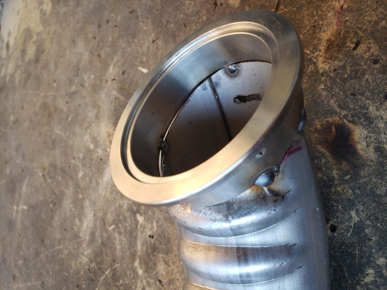

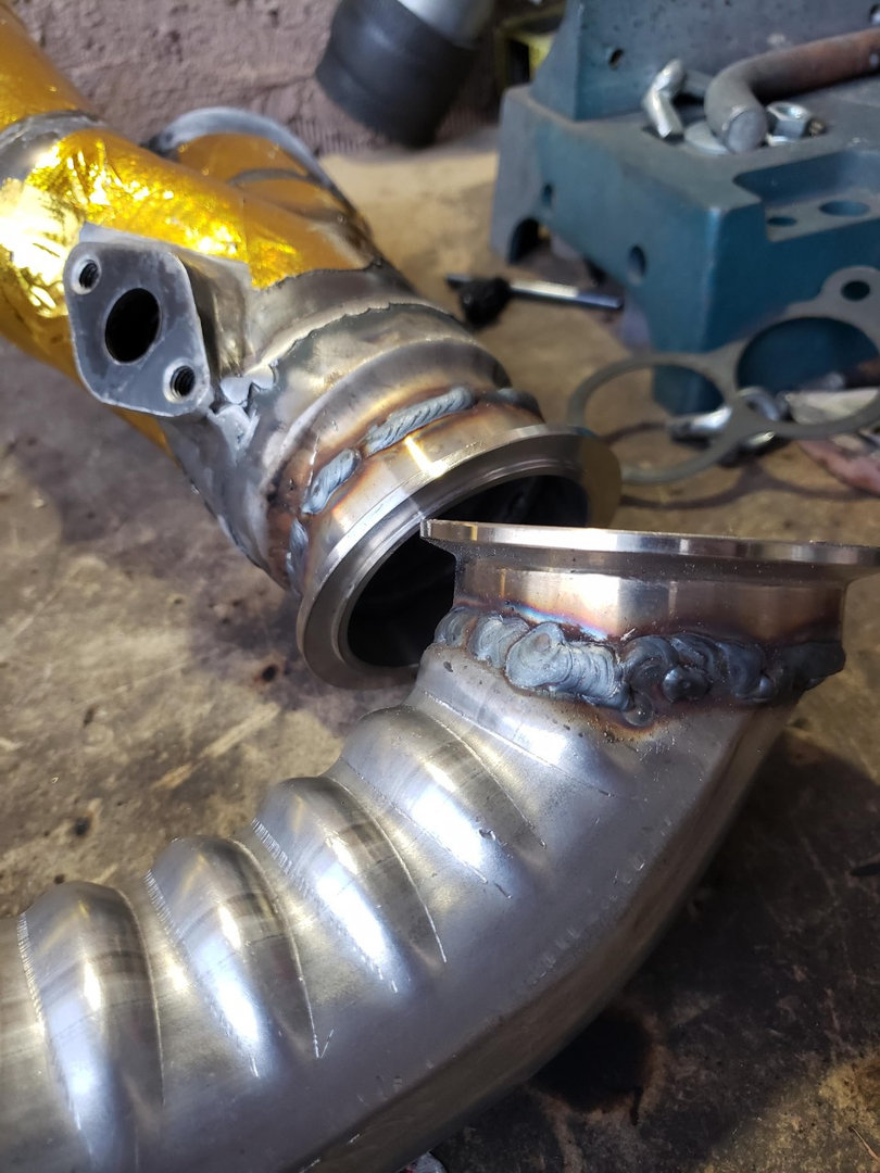

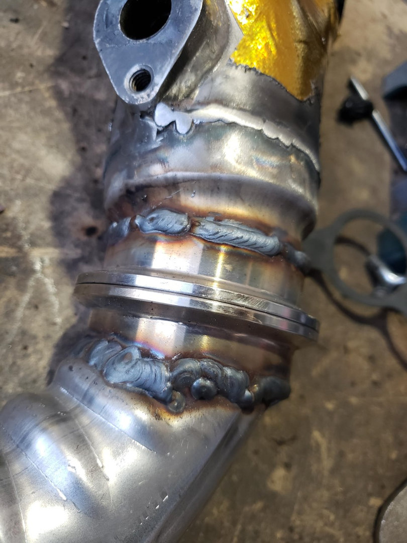

    I've been getting closer to wrapping this header project up. Had to make an extension from the bottom of the Y pipe to the CAT. Got a 3" ID to 2.5" neckdown from the y pipe. I purchased a 2.5" stainless v band and welded that onto the bottom of the reducer. The connector piece I made is 2.5" 45 degree bend and I hogged out the factory 2 bolt cat flange to be re-used from 2.25" to 2.5" using a dremel and carbide bit. The other v band flange was welded directly to the 45 pipe. The original pipe that goes in to the cat is 2.25" but I wanted everything to be 2.5. I didn't want the exhaust to be restricted down another 1/4" from the bottom of the y pipe to the cat so that is why I went to 2.5" and had to hog out the 2 bolt flange to re-use it. Definitely super happy I used a V band flange. It was cheap and ended up welding really well.
    The reason you HAVE to make this section removable is if you ever intend to remove the Y pipe for whatever reason in the future it wouldn't be able to come out if you weld the extension part to the bottom of the Y pipe. Ask me how I figured that out. All in all, I think it's going to serve it's purpose. The welds look like shit but I've never really welded 16 gauge or anything this thin. Tried turning up the wire feed to increase puddle and kept the heat as low as it would go. Never had any burn through but just couldn't get the weld puddle to look good. O well. As long as they don't leak that's all I care about! They are $100 Doug Thorely headers. WTF do I care as long as they don't leak we are GUCCI.

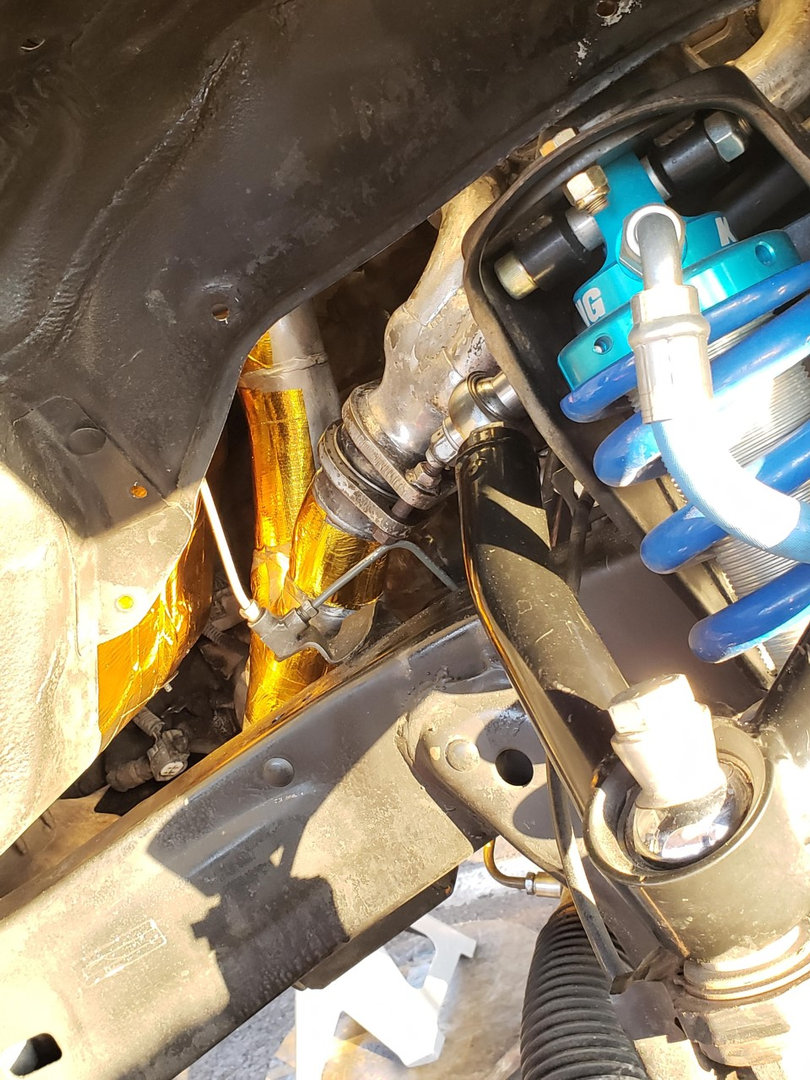

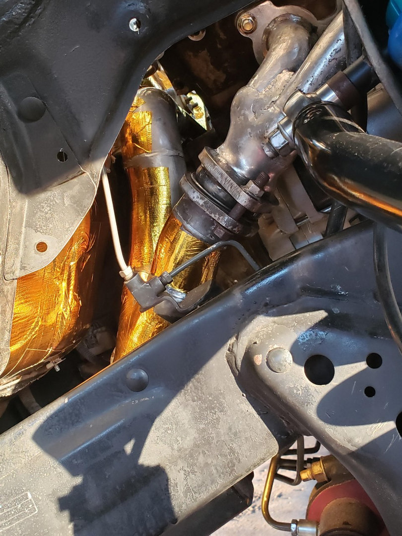

    Phx, AZ
    1st Gen
    Solo Motorsports 3.5 with heimed tubular uppers, Total Chaos spindle gusset, King 8" CO, Glassworks 3'' front glass, tube bumper, 4 25w 1000L Bumper LED, 2 Rigid Pod lights, 35" Toyo Open Country AT, Fiberworx 3'' Bedsides, Deaver F55, Custom 9" Shackle, Bilstein 7100 14" 2.0 smooth body w/resi
    I knew the gold foil tape was going to melt! O well! Fuck it! Shit sounds good, wayyyyyy better than the old open header Y pipe! I like the girgling and popping sound it makes in 1st gear after you let off... shit is tits.
