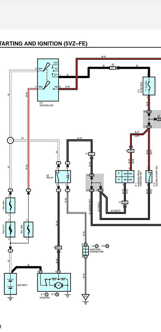

    Here is the wire schematic for the ignition circuit if it helps anyone. Might start a new thread for intermittent no crank no start in the first gen section...
    thumbnail_Screenshot_20200421-115538_Dri_450df150cec17b4db9da3b30126c5f358793f66f.jpg

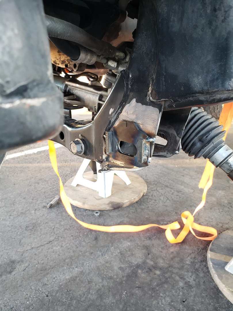

    My lazy ass did it with the steering rack unbolted but still connected to the rag joint. Ratchet strapped it out of the way as much as possible. Definitely wished I would have done this a couple of years ago when I did the front. O well, some of the front needed cleaned up anyways. Swapped out my LBJ's like it was 1968. Vatozone limited lifetime... Both LBJ's were loose as a goose. Boots not torn, no grease leaking. Just sloppy play. Tie rods are brand new. Did notice the driver side uniball on the upper has more play/looser than the passenger side. Passenger side is still really tight like it was brand new. Any guesses what that may be due to?
    Need to get everything buttoned up so I can start to diagnose this high idle issue by taking DALANDSER steps to test voltage at the connector. I feel like the MAF readings may be off too. Is there a reference anywhere on the net for Tacoma ECU readings??? What is a normal MAF reading at idle? The only other thing that I did was clean the MAF with parts cleaner and not electrical cleaner. The MAF used to read like 5g/s at idle and now it's near 8 or 9g/s... Thinking this may be effecting my idle more than the shitty throttle body butterfly or IAC... It is absolutely amazing how many people have IAC/high idle issues on the Toyota 5vzfe. The internet is LITTERED with stories of high idle, no fix. Shit kind of pisses me off.

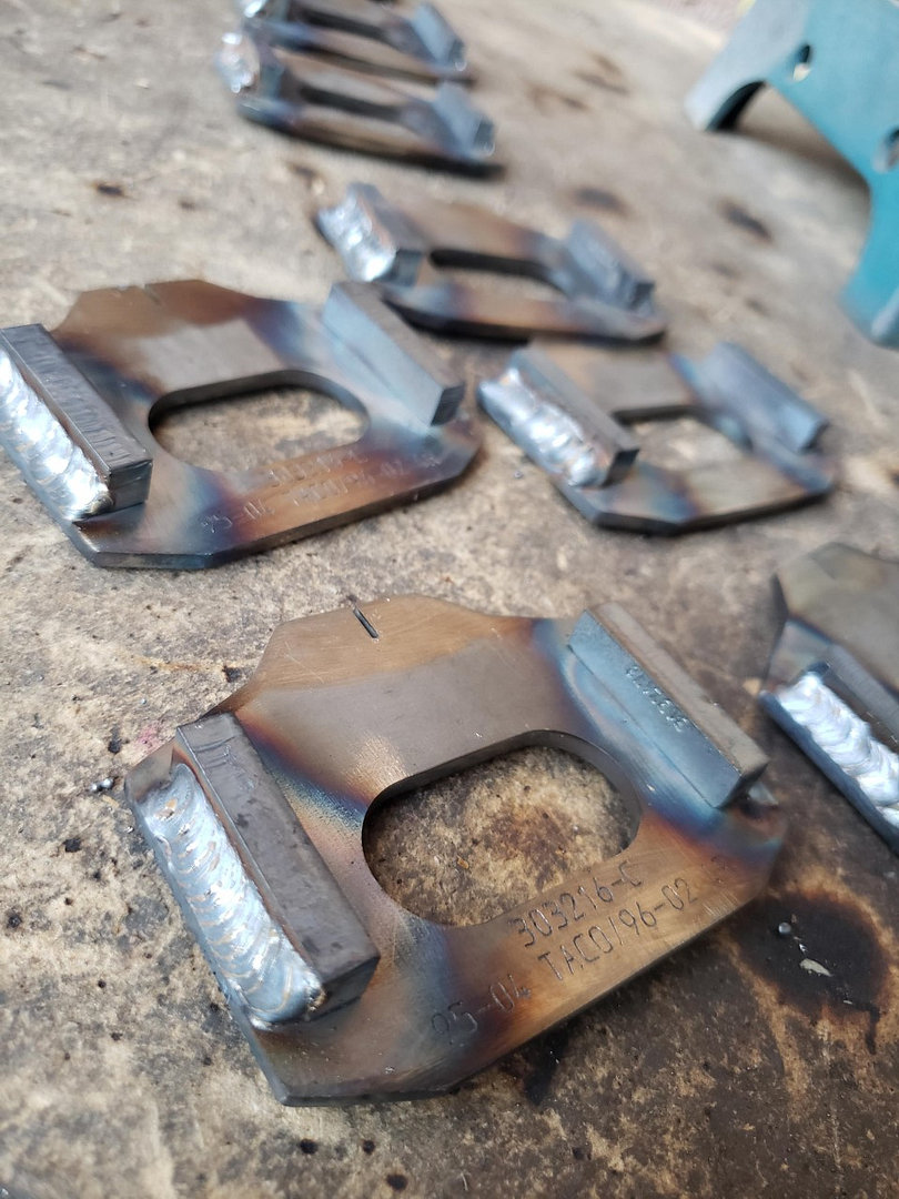

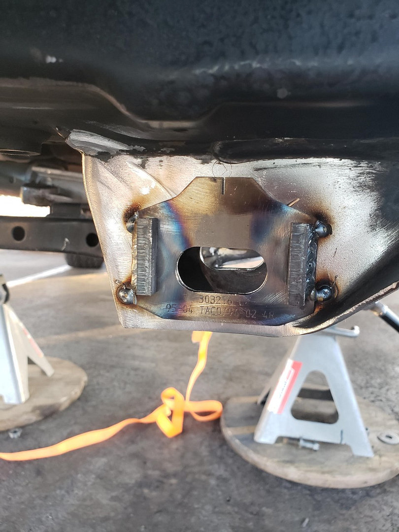

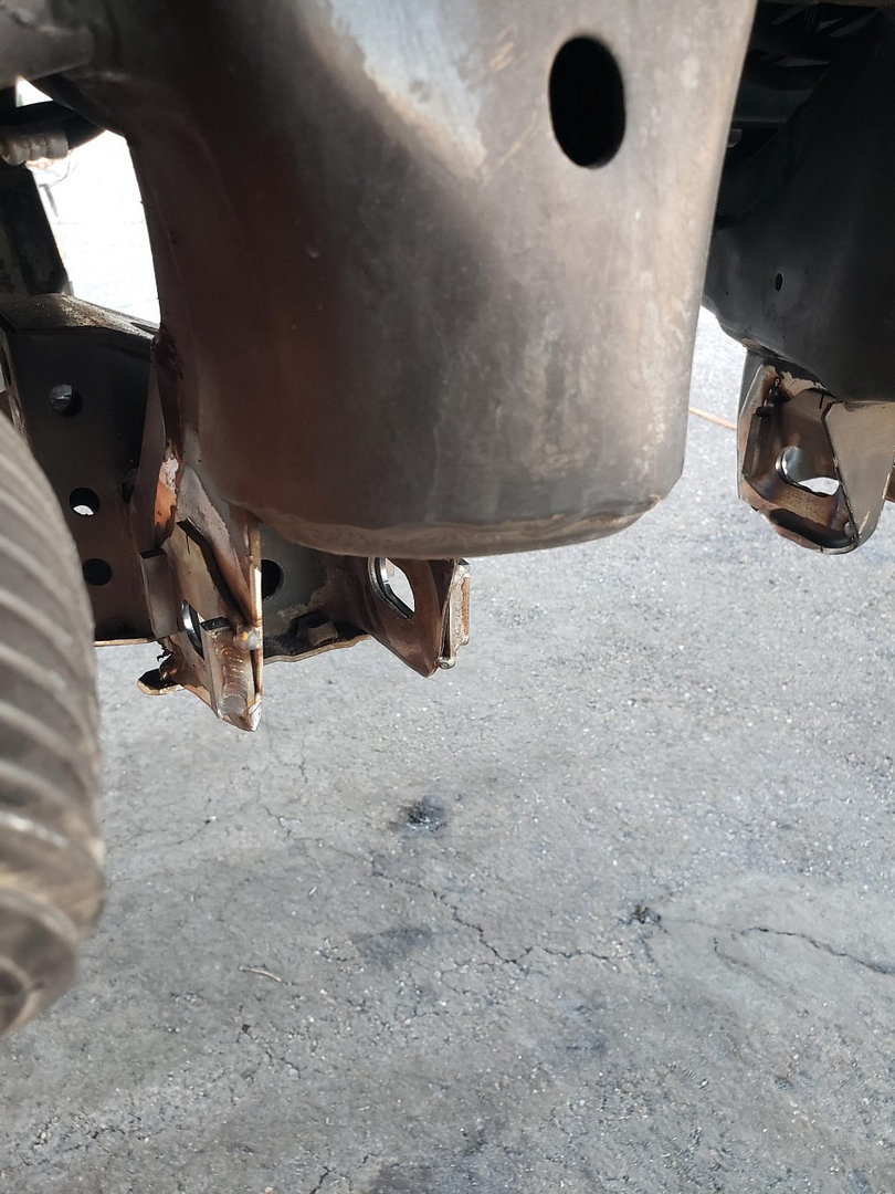

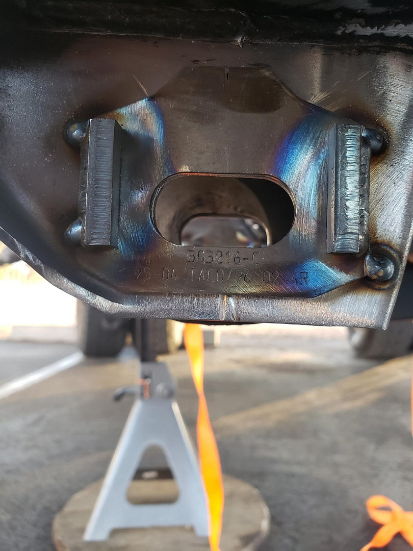

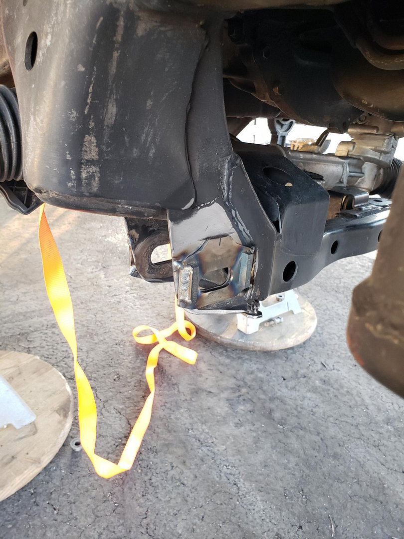

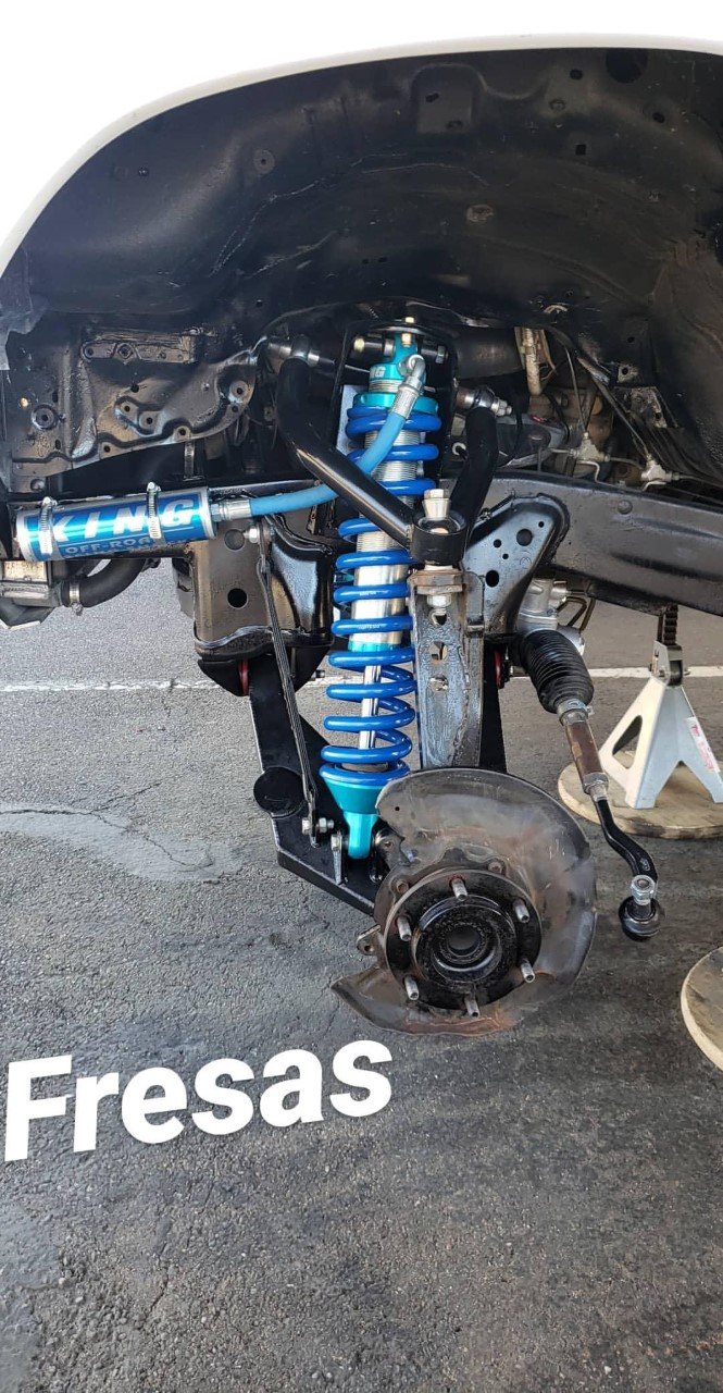

    Last few days of work. Welded the 1/8 chromoly cam tab gussets. Got the alignment cams back on exactly where they were or +-1mm. Got new LBJ's in and cleaned the whole area up. Made some resi mounts out of angle iron that I welded to the frame. Before I just had the resis ghetto hose clamped to the frame. Put some new stickers on the resis too. Everything looks clean right now. Just waiting for these red powder coated Tundra 13wl calipers, rotors and pads. Got my alarm situation figured out. Just deleting the starter kill completely. Getting all that organized and zip tied neatly under the column. Another win today, I got my DVD working on the Pioneer for the first time in 3 years. It was just the simple ground switch so you can watch while driving. The only time I really use it is when we're waiting to get back into the US from Mexico.
    One love to the survivors!
