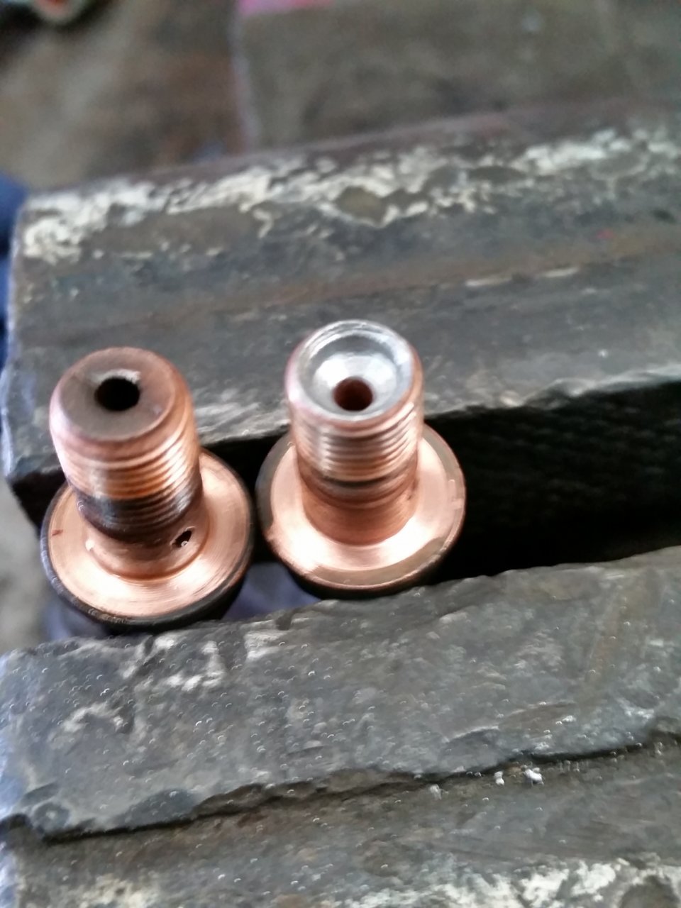

    Having the toughest time right now with these brakes. I had to play around with the thickness of the copper crush washers I got from Oreilly because the caliper wasn't filling up with oil. Or at least that's what I thought. Cracked bleeder on both new front calipers and definitely getting brake fluid into my 1 man bleeder bottle. The problem is, the passenger front caliper's pistons haven't pressed in yet to seat the pad. Driver side caliper's pistons have actuated and pushed the pad in a couple of MM and both sides are seated against the rotor. Not getting any fluid loss at the reservoir either... I kept pumping and pumping thinking somehow there is air in the passenger caliper. Then I notice a big pool of fluid under the rear driver side drum. Keep pumping and the puddle was growing... FML! I didn't want to do the drums today... I guess not tomorrow either as it is going to be 107 degrees in PHX tomorrow. FUCKKKKK!!!!! Good thing I bought the rear rebuild kit a couple of weeks ago!!!! LOLOLOL jesus christ this never ends.

    @mechanicjon has info about the banjo bolt may be applicable here

    Did you drill the end of the banjo bolt out a little?

    20161029_140401.jpgpl

    YEP! Just like that. No leaks at all. At first I thought the hole wasn't lining up with the middle of the banjo fitting but I think everything is good. I didn't get the passenger side drum done yet or I would have put more fluid in the reservoir to test that new passenger front caliper. I bet all will be good tomorrow after I get that other wheel cylinder put in and can actually pressurize and bleed the system.

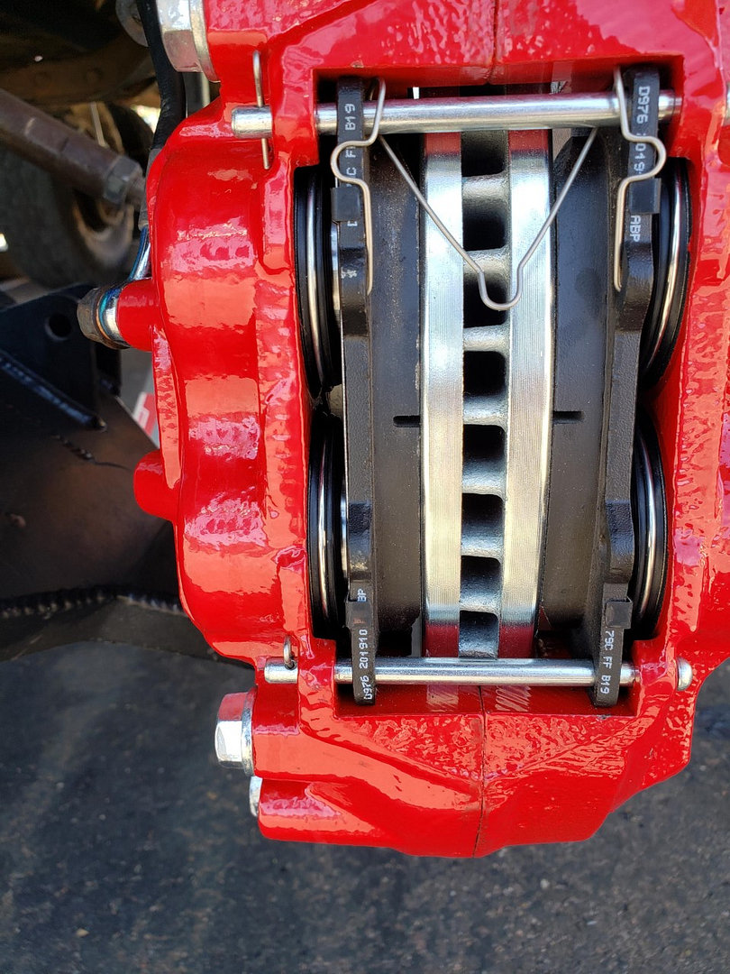

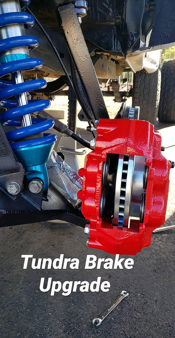

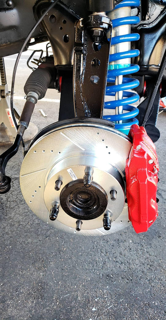

    Full rebuild
    LukeCC likes this.

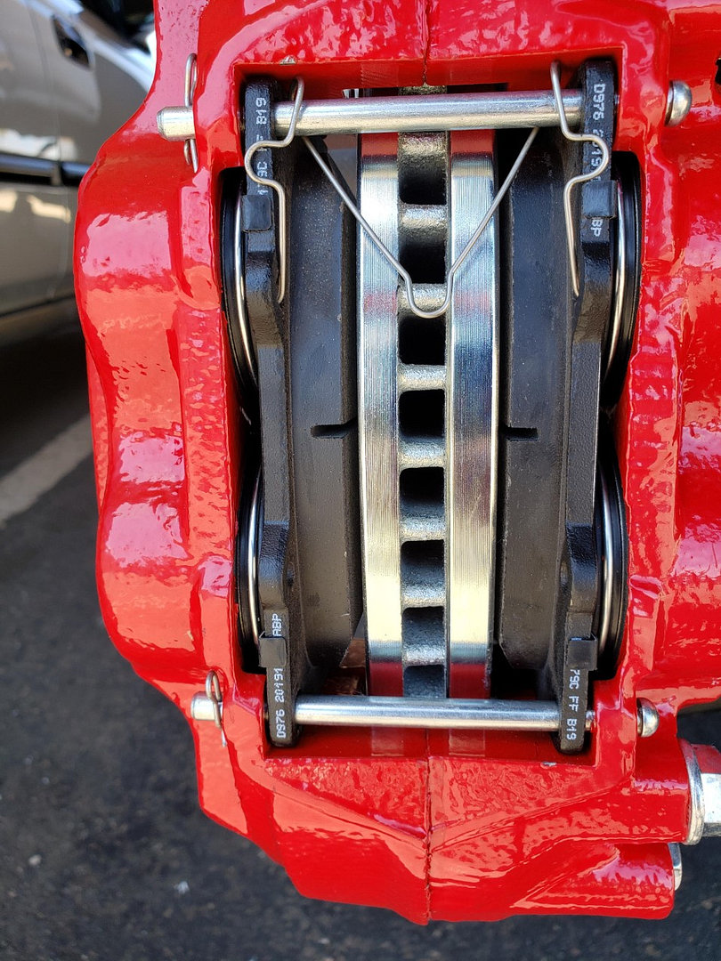

    Driver side caliper
    LukeCC likes this.

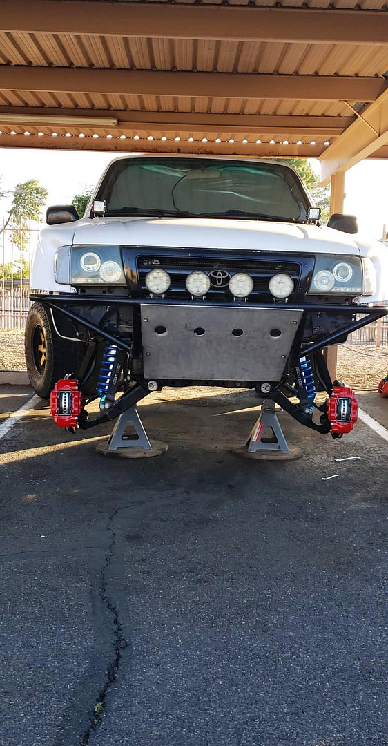

    Passenger side caliper
    LukeCC likes this.

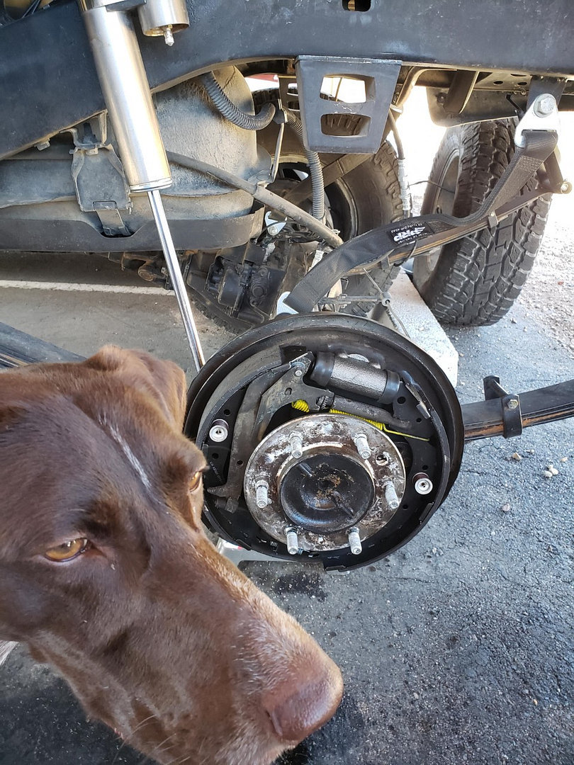

    Notice the gap? Hopefully it has to do with brake fluid traveling from front driver side to back drum before returning to passenger front... or at least hopefully it's due to the massive pressure leak at the driver side drum wheel cylinder. That thing was so shot it was just pissing everywhere. You can pry see the stain on the ground and how big the puddle was.

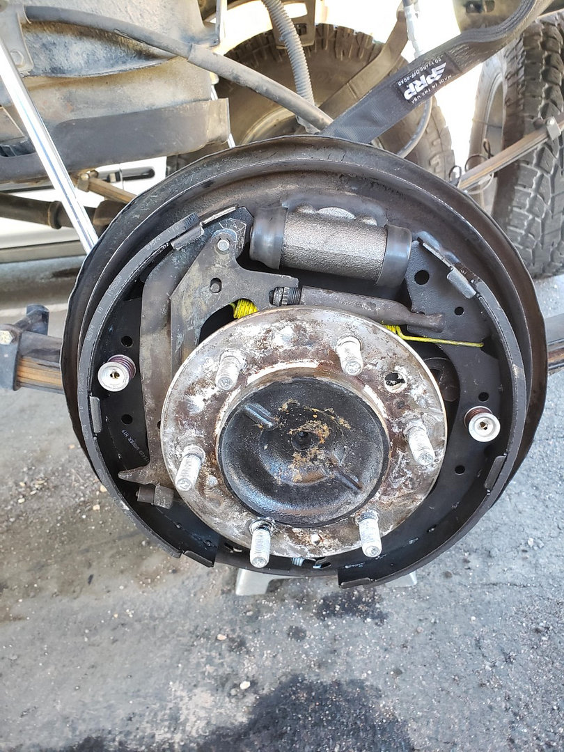

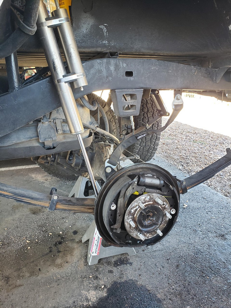

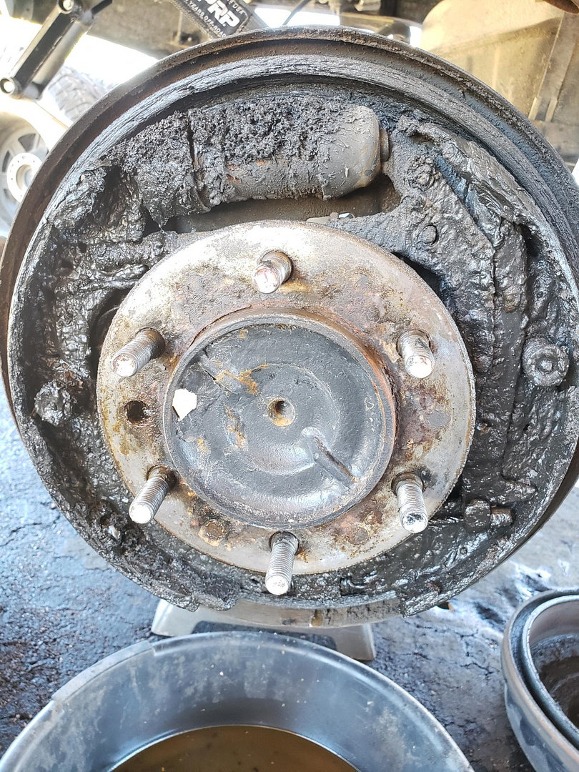

    HOLLYYYYYYYYYYYYY FUCKKKKKKK!!!!!!! This passenger drum is LOADED with OIL. Smells like diff fluid. That rotten stank associated with gear oil. There is no amount of brake cleaner that will take care of this!!! WHAT A NIGHTMARE! LMFAOOOOOOOOOOOOO!

    Empty Wallet Mod
    Dealt with that on a Tundra axle I was putting under my truck - gonna have to most likely replace the wheel bearing and axle seal if the oil washed the grease out from the bearing.
