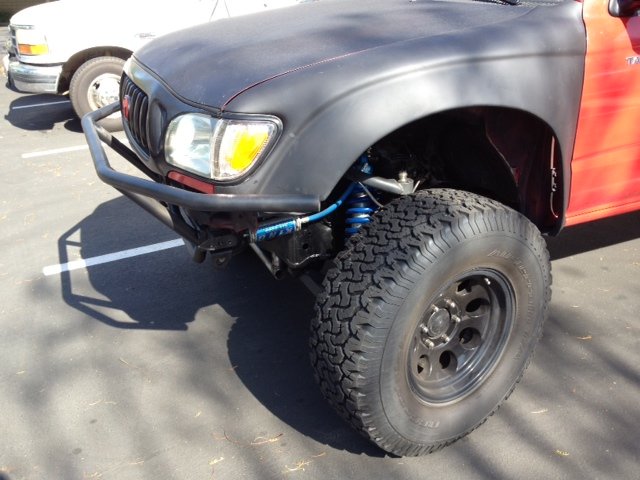

    Getting closer! Lower part is pita with the diff and add a 1"diff drop don't help :)

    Need close ups. :)

    Lookin good. If anything, I'd try and tie the bumper into the upper part of the frame to keep it from folding in on a mild to medium impact. I learned that the hard way. :eek:

    X2. Maybe a crossbar or weld pieces of plate standing up like they do on the inside of aftermarket lca's.

    Ya it's getting side supports, center for the skids, and connected to the crossmember. Plus gussets gussets and maybe some gussets :)
