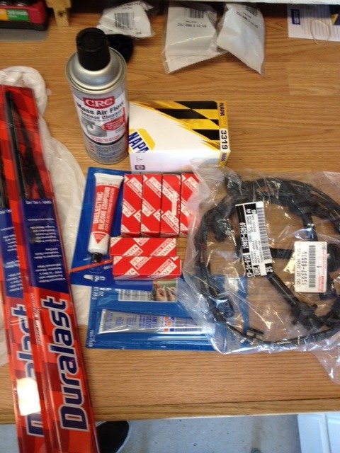

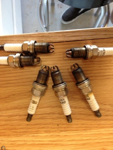

    She started to have a little stutter or misfire at hard acceleration, so did some work. New wipers, plugs, plug wires, fuel filter, cleaned maf sensor, throttle body and corded battery. She runs great again!
    Had over 80k on these....it was time!
