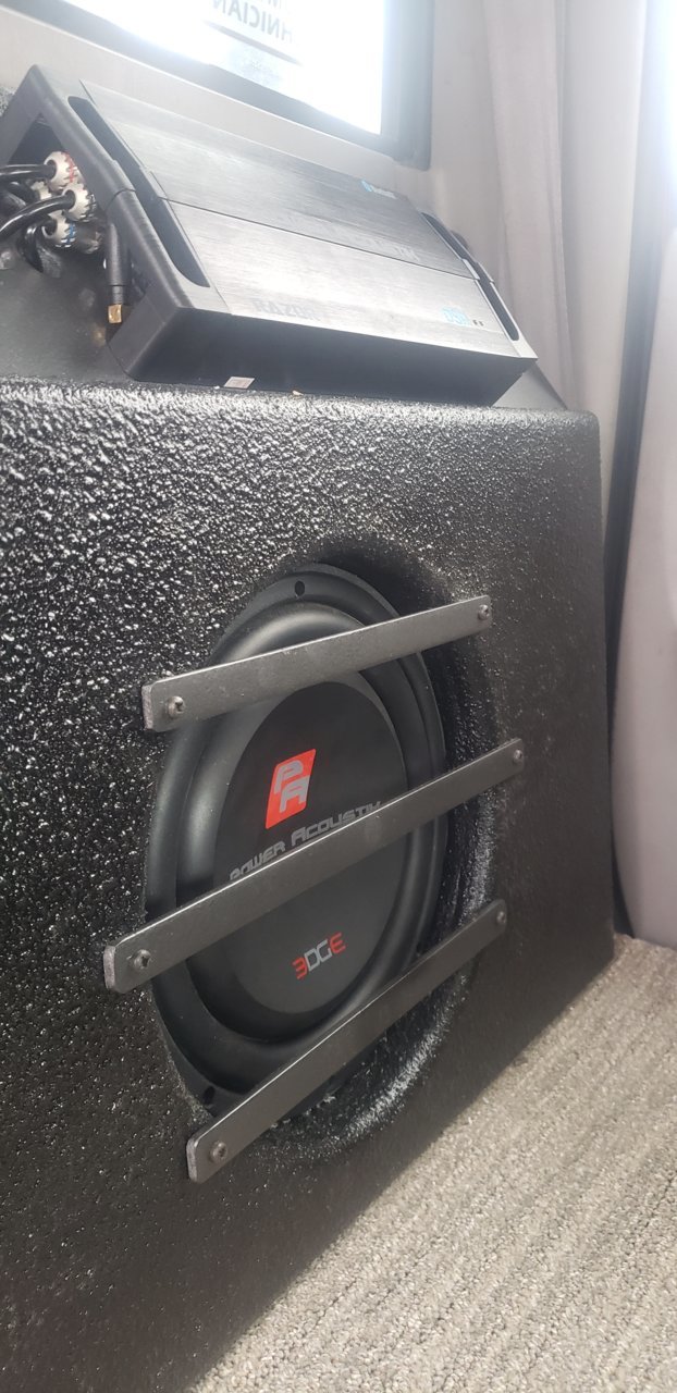

    Ended up ditching the subwoofer grates, and fabricating my own out of 3/16 x 3/4 flat bar. The grates were too close to the subwoofers and they were hitting the back of the grate when the sub hit.
