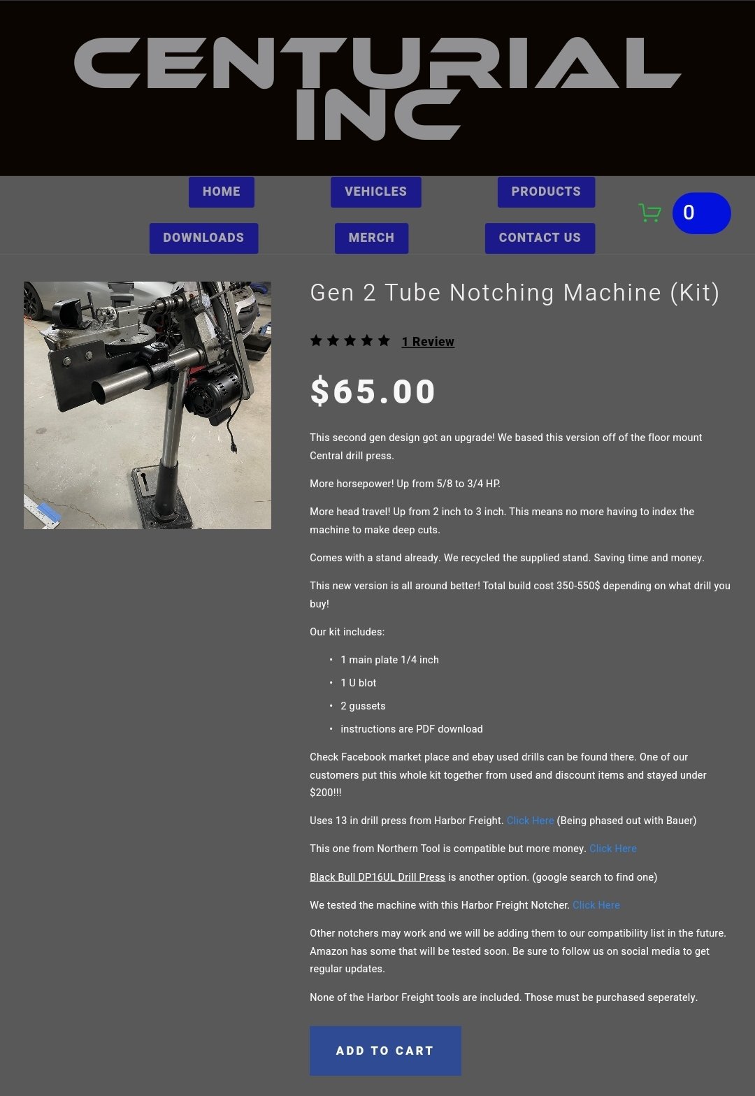

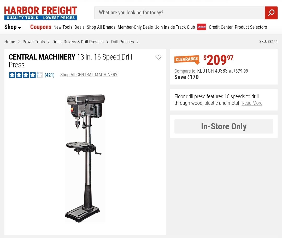

    TOOLS
    Roll bar fabrication (I guess I'll start figuring this shit out one way or another)
    Ordered these today
    Screenshot_20240221_185945_Chrome.jpg Screenshot_20240221_190022_Chrome.jpg Screenshot_20240221_190045_Chrome.jpg Screenshot_20240221_190102_Chrome.jpg Screenshot_20240221_190123_Chrome.jpg
    Picking this one up tomorrow.
    Ordered
    Picked this one up the other day. Was on FB market. Brand new, for 200 bucks. Will leave this one as a drill press. Should be a better option than the bench drill press I've been using.
    Picked this one up on sale today. Believe it or not I haven't really been running any pneumatic tools. Never really had a compressor to speak of.
    Looking for a used JD Squared Model 32 bender. We'll see if one comes up.

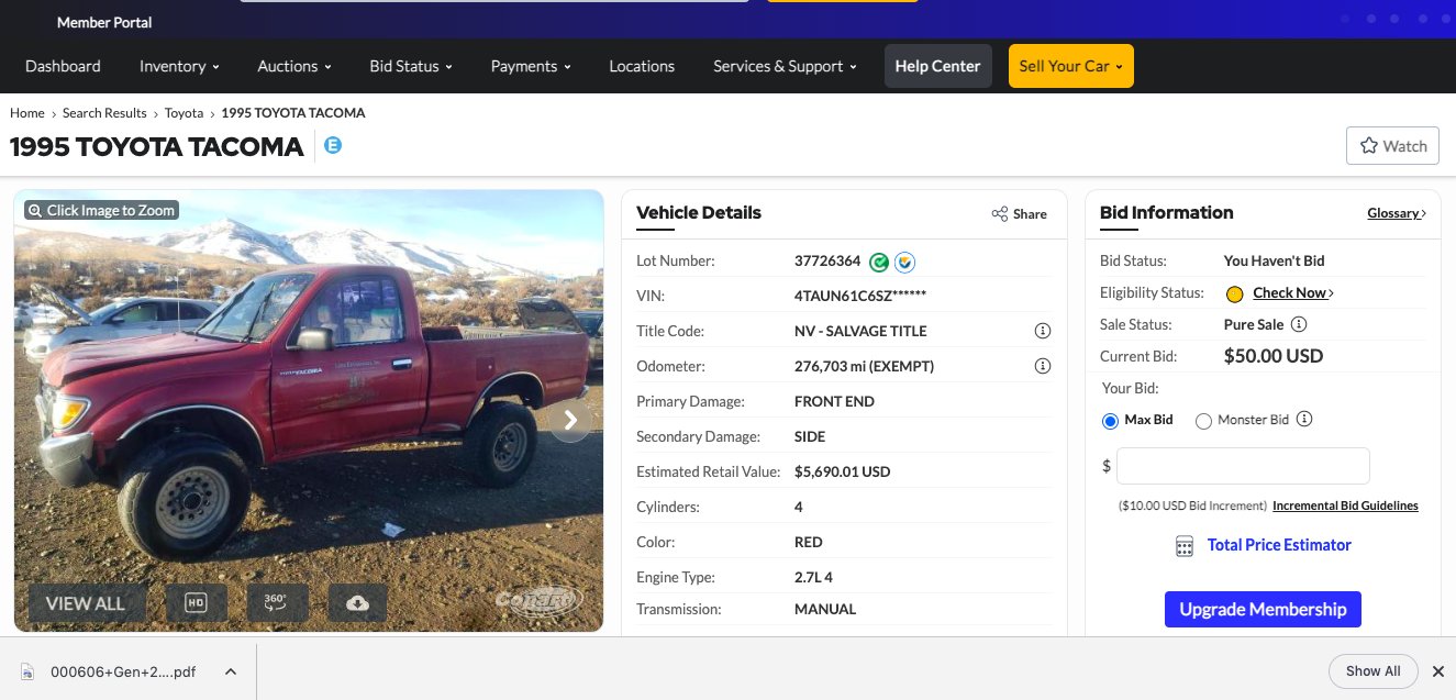

    The search (in earnest) begins. This could take a bit.
    I know everyone bitches about the price of used trucks. But some of the prices you see are just plain stupid. Like 11.5 for the 2nd one (below). I mean, what on earth makes someone think 11.5 for that p.o.s.? > We'll let this one sit for a bit and see if the price drops > LMFAO at that price! > This one has been listed a couple weeks. But it's not 95.5, 96, 97 > Another one that isn't old enough
    I'm looking for 95.5, 96, or 97 because the regular cab came from the factory with a 5VZFE. (6 cyl)
    Most of the classes listed above (as my targets) don't care, but I don't want to chance having a problem with a motor that didn't come in the make, model, and year. I think I'd be ok with a 5VZFE in any year 1st Gen Tacoma Regular Cab because:
    Make = Toyota
    Model = Tacoma
    I don't think the regulations consider cab size... But again, I'm not sure.

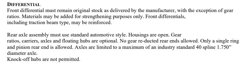

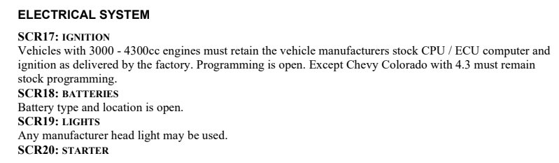

    If I'm going to try and satisfy all of the above Classification/Regulations I can't run a stand alone.
    BITD - Class 7100 - Ignition:
    On an another subject that is problematic with the same Class
    Which is f'n stupid seeing as the Class can be 2wd or 4wd.
    My plan is to explore 8 or 9 inch front diff. And just remove the diff and run 2wd if I run Vegas to Reno.

    This one is promising. I'll let it sit for a whole before reaching out. 7800 is more than I want to spend... and, honestly, more than it's worth.

    Easy 6500 with cash in hand. Will make things easier for ultra 4. Btw, count me as part of your chase crew. Salud :cheers:

    I am knee deep in my 1993 xcab project which came about from some supposed 'friends' at Fire Guys Racing who made me an offer I couldn't refuse on a pile of Total Chaos LT parts :) That suspension is coming up next, I just barely got it running after the 1UZ swap.
    I have watched them pour a medium size fortune into this truck through the decades, through so many changes. It makes them happy so its money well spent. They did well this year at Hammers till the steering broke.
    Like others have said above, once you start throwing money at racing the initial purchase price becomes trivial. But from my cheap ass perspective $7-$8k is a LOT of money for what will basically be a chassis you remove everything from.
    If the truck does not need to be registered for the road . . .
    Salvage? This one is in Nevada.
    https://www.copart.com/lot/37726364/salvage-1995-toyota-tacoma-nv-reno
    Also, how tall are you? Once you put a race seat and cage in the regular cab it gets very tight. I am only 5'10" its a struggle to fit in the race truck even on the navigator/winch/tiremonkey side.
    Watching and excited for you Diablo!
