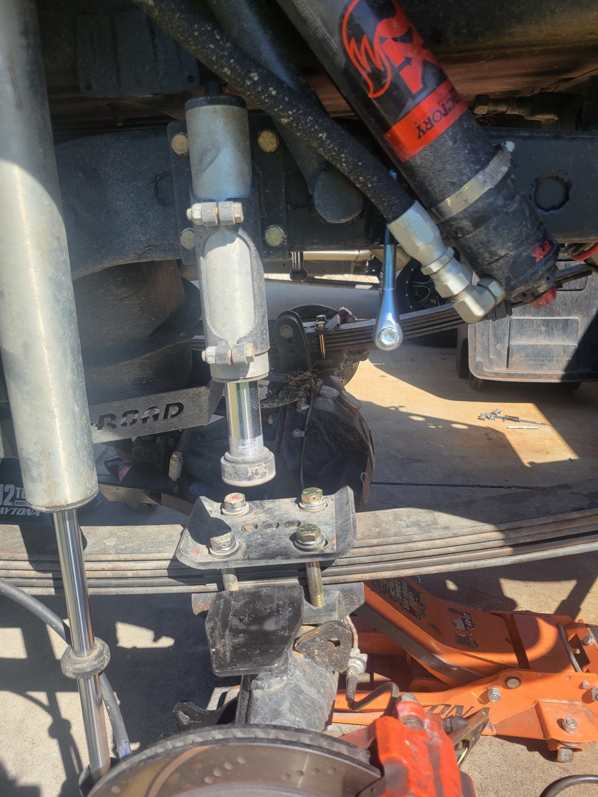

    How do you like that U-bolt eliminator? I just won an Archive Garage shock relocation kit and now I'm looking up what I need from Ruffstuff to do a 63 swap at the same time.

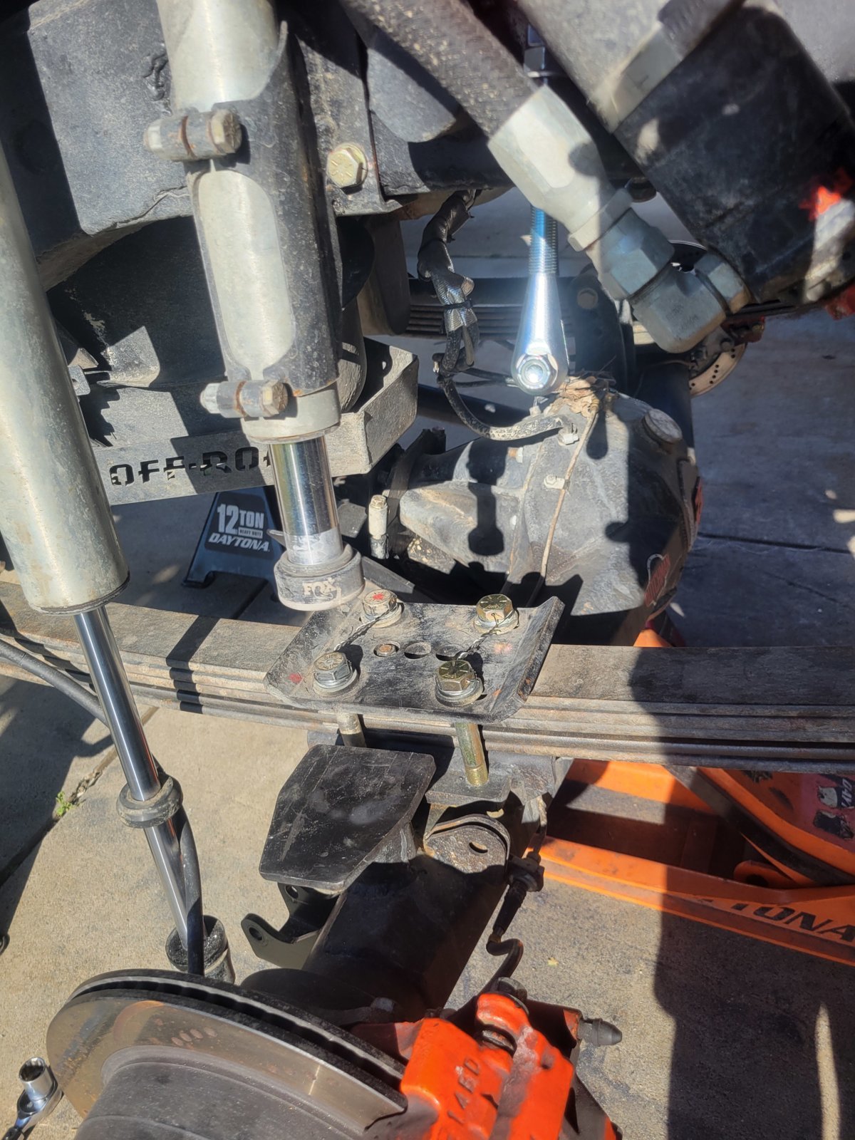

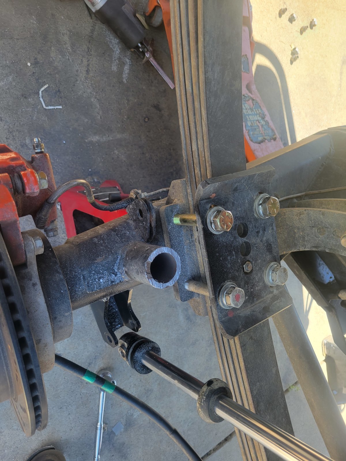

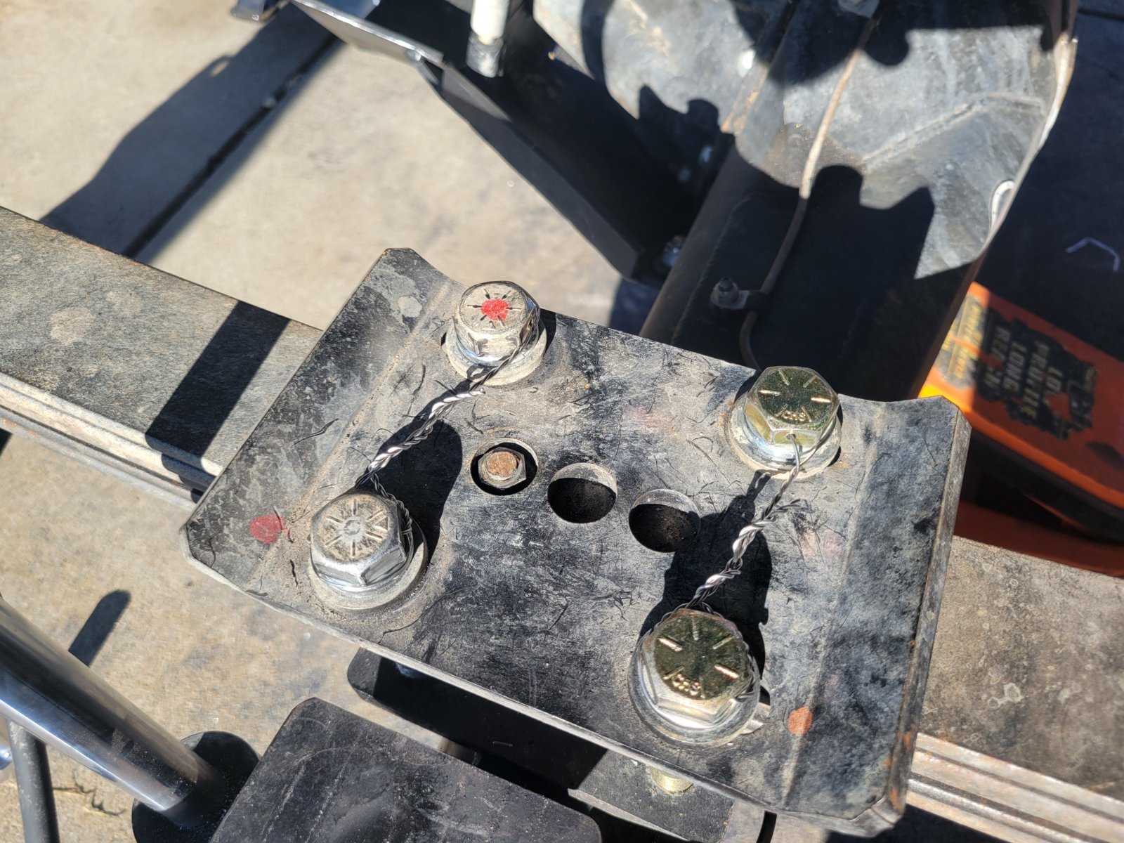

    So far, it's be good. Just need to make sure it's welded well to the axle because you don't have Ublots as a back up. I also chose to do both split washers and safety wire so I had an absolute mechanical connection so the bolts can't back out. With the truss in the back, I also had to make sure the bolts were short enough they didn't bottom out on the truss before they were tight.
