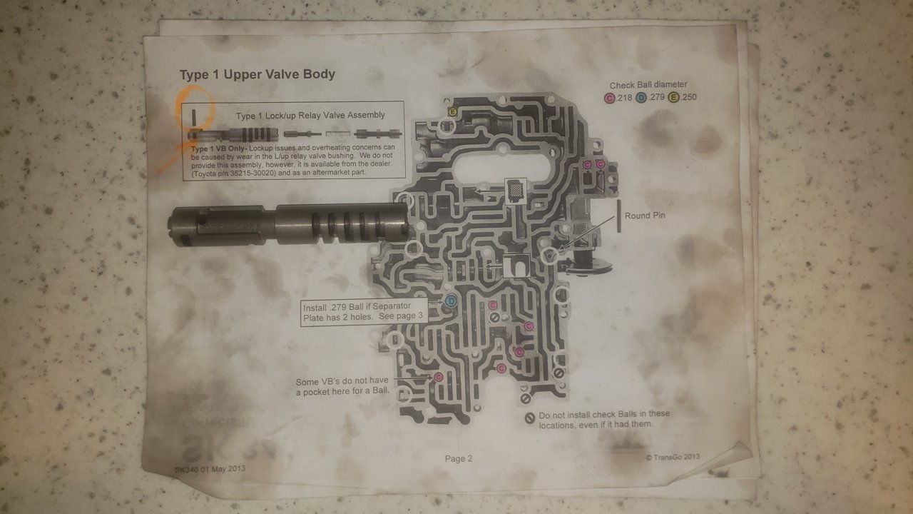

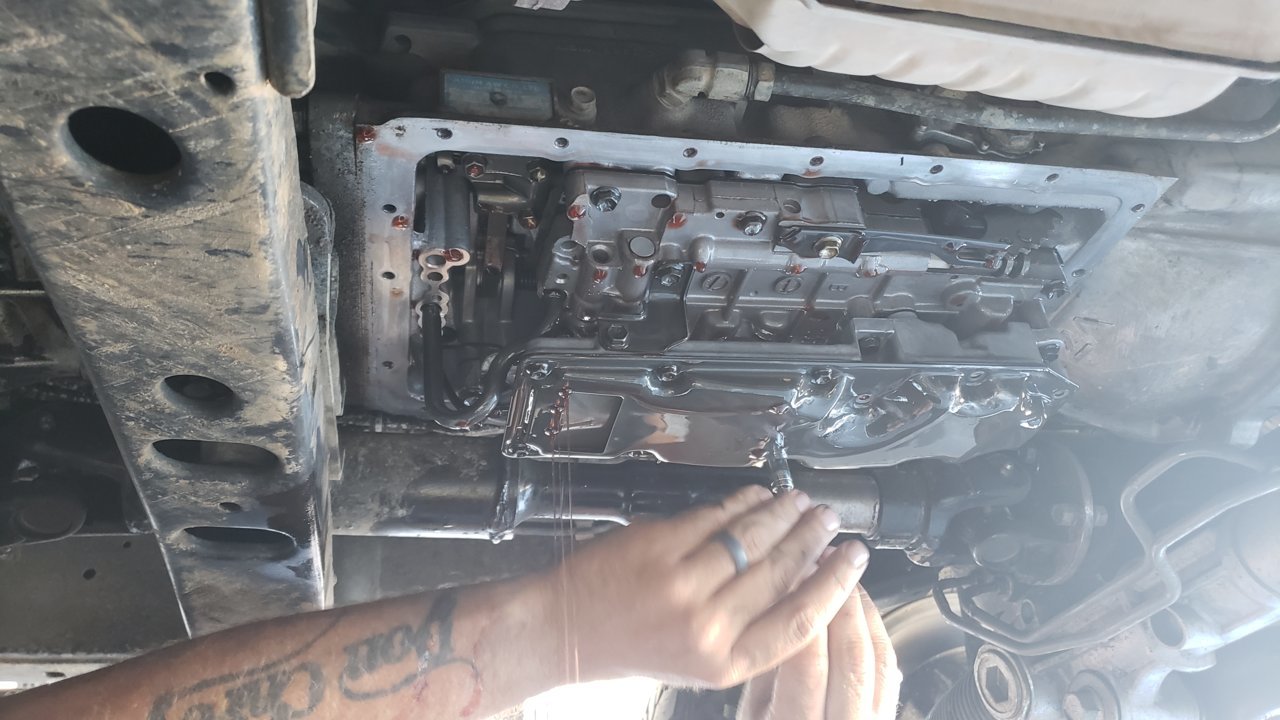

    Then it was on to the transmission.
    I noticed, when I did the shift kit, that the instructions mentioned a bushing that may need to be replaced. It said this bushing, if worn, can cause additional heat because the lock up on the torque converter can be delayed.
    So I dropped the valve body and opened it up to replace the bushing.
    Do yourself a favor if you do a shift kit... replace this bushing if applicable.

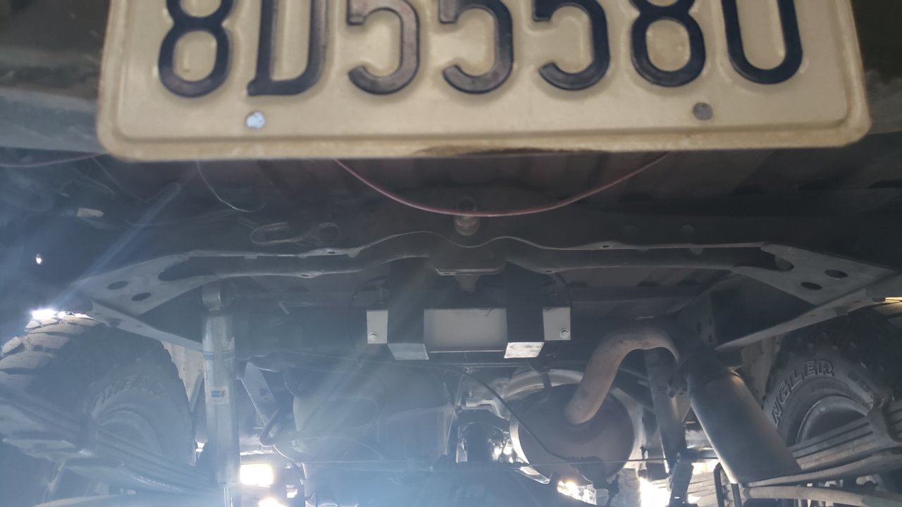

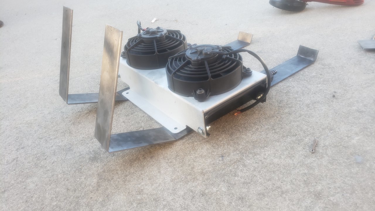

    Then I fabricted some brackets for the new trans cooler.
    And installed/wired it

    Was it difficult to remove the valve body? I read you had to be careful when removing the valve body as small parts can fall out. I was thinking of dropping the pan and cleaning it up. Also wanted to see if anything was affecting the high trans temp.
    Got a Hayden oil cooler I’ll be putting in soon.

    Not difficult to remove valve body. But there are accumulators and springs that can fall out. I would suggest having a service manual or something handy to tell you where/how they go.
    You can drop the pan and strainer without dropping anything else.

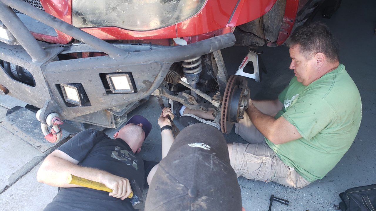

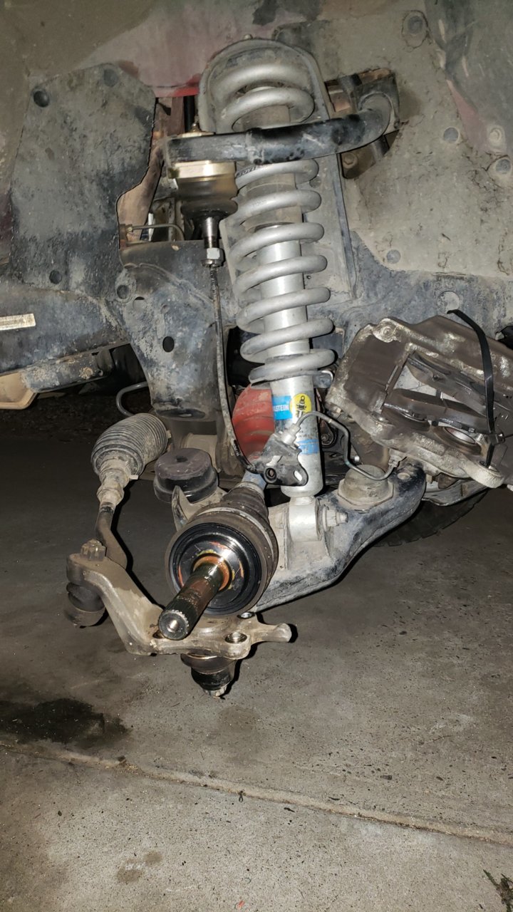

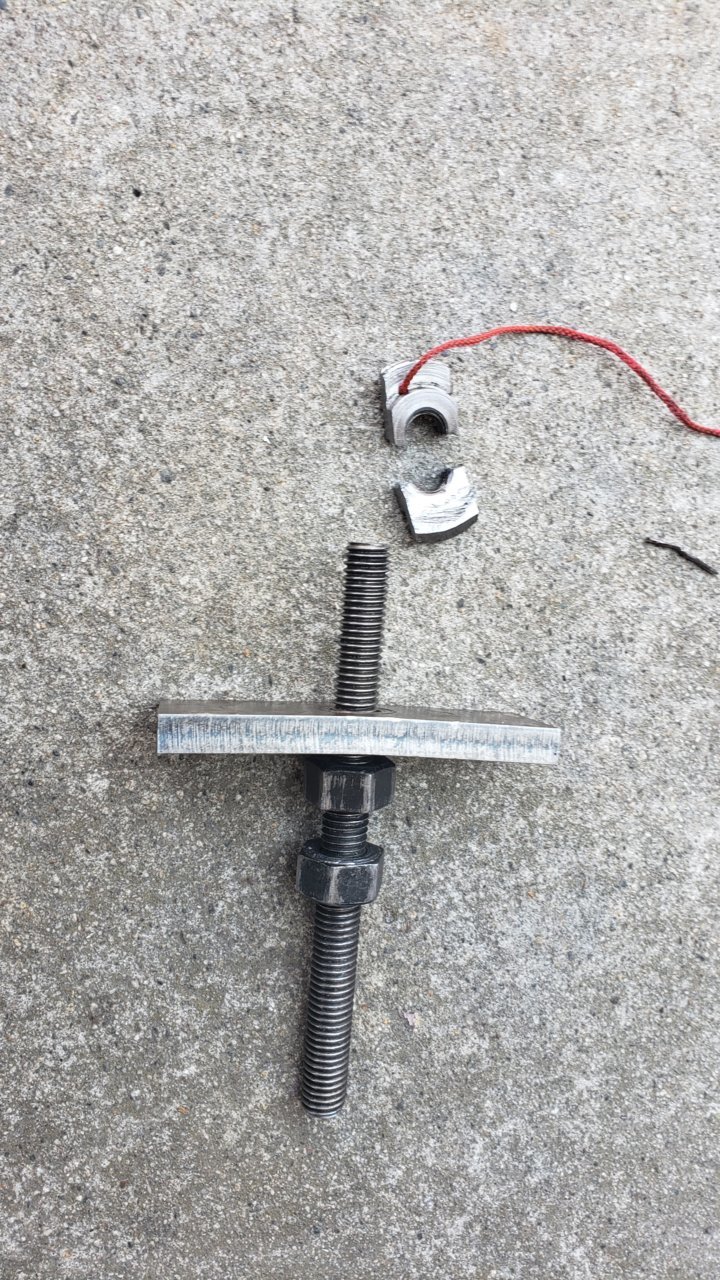

    So, I tore the front passenger side apart. @foxrcing07 and I pressed the bearing on Sunday. The bearing was shot.
    Everything went back together as it was supposed to. Now that it's replaced I can tell I was dealing with a bit of slop in the steering... much tighter now.

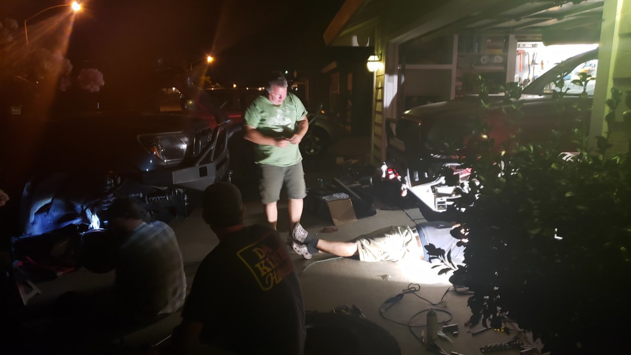

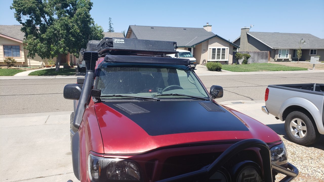

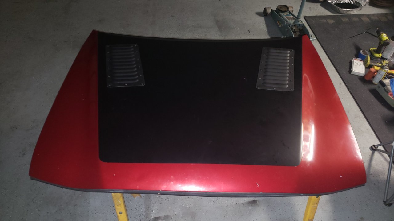

    Saturday was spent with a few good friends working on taco trucks. (Believe it or not, it was the 10th Mod Day we've had in the 209... read about some of those escapades here)
    @MattJakobs did some snorkling
    @CalTacoma09 did some ECGS replacing
    ECGS bushing took a bit longer than expected because things didn't go exactly as planned.
    @Sharkfrog replaced his 600# coils with 700# coils
    And I did some badassecorizations to my hood.
    @foxrcing07 hung out, helped, provided advice when neccesary and healthy doses of sarcasm and bullshitary.
    It was a pretty damn fine day.

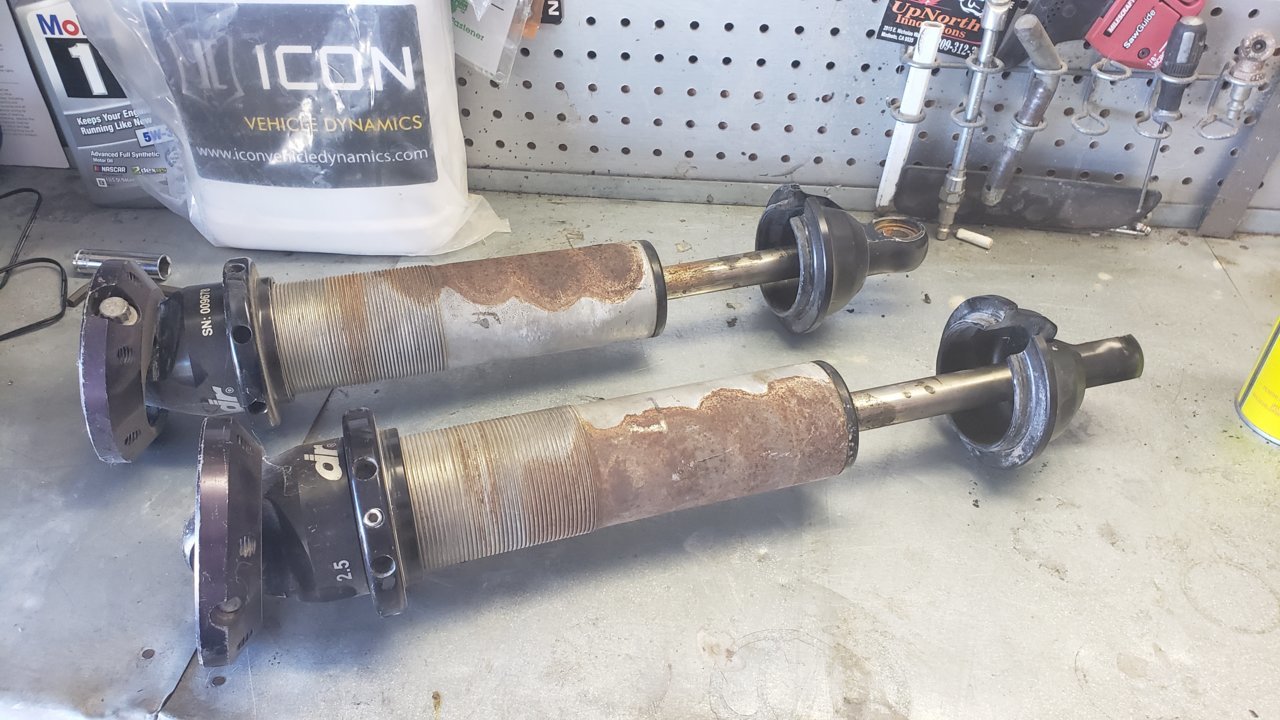

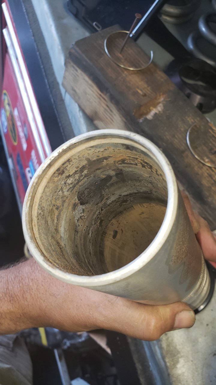

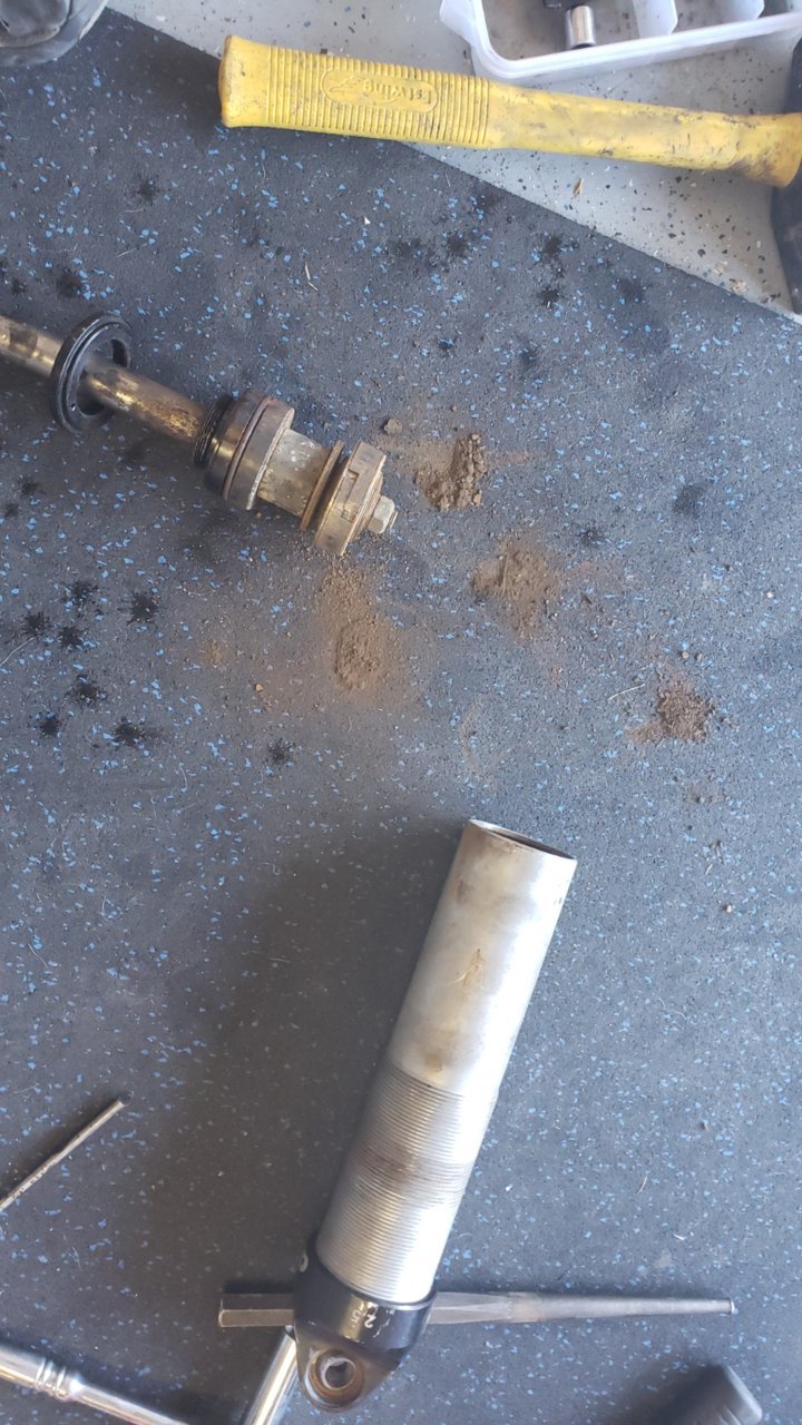

    20190825_134219.jpg 20190825_133518.jpg Started re-building some dr coil overs today. One of the shafts is bent, so hopefully I can source a new one. We'll see how well I can clean them up and get them up and running. I've never re-built shocks before, but now is as good a time as any to learn.
    The shock with the bent shaft had some suprises inside lol.
    Looks like the rubber seals have deteriorated inside and left a coating... I ordered a cylider hone to clean up the inside, so I'm kind of on hold for now.
    Will order the replacement shaft this week.
    Big thanks to @foxrcing and @CalTacoma09 for the hand me downs though. I'll get these things trail worthy and I'll be rockin them soon... with a bit more knowledge in the tool box to go with them :thumbsup:

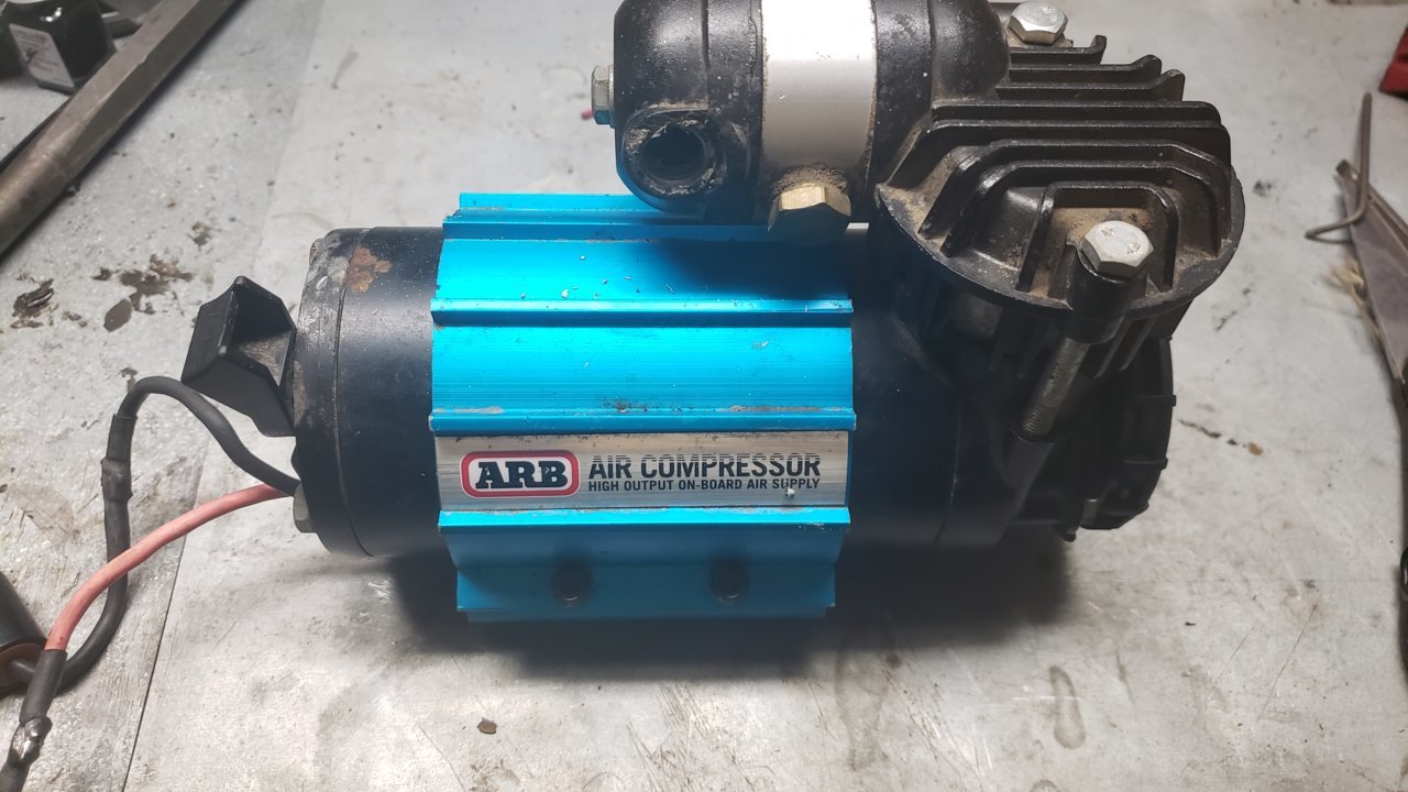

    @foxrcing07 put me on to a deal on a used compressor. For 80 bucks, I couldn't pass it up.
    Just have to buy some fittings etc and I'll have some on-board air
