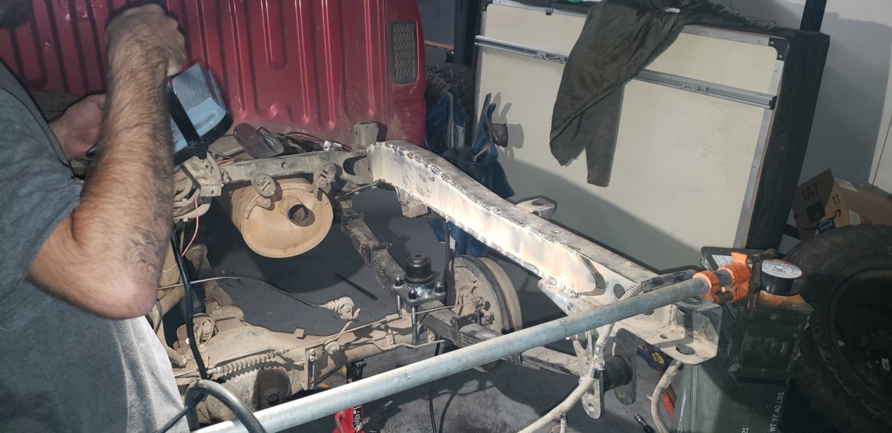

    Burned in both reinforcement plates 100%
    Also put in the superbumps and flip kit.

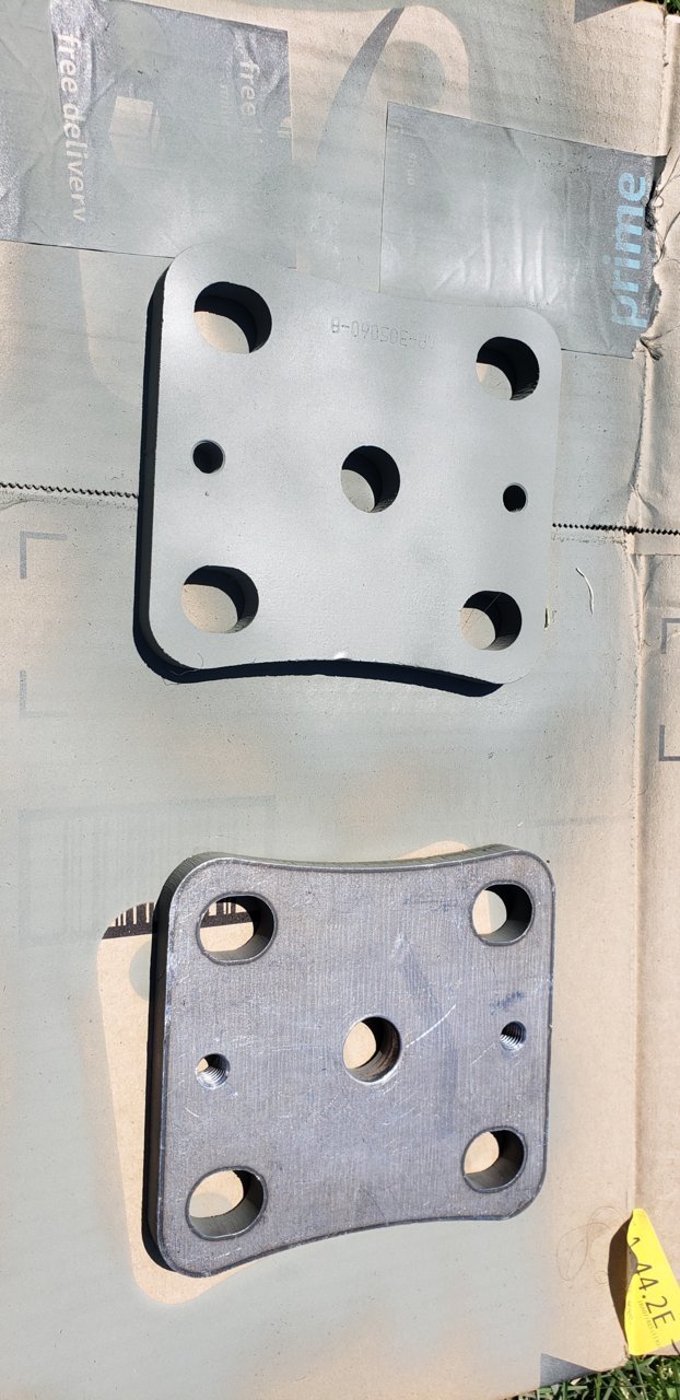

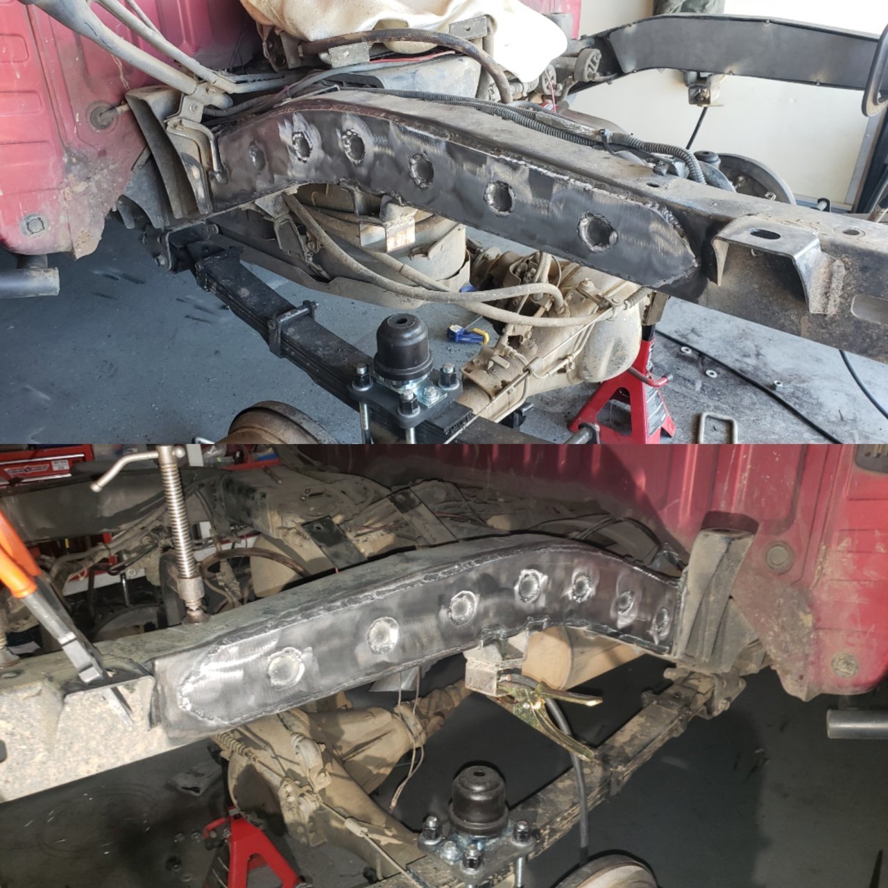

    Burned in the passenger box plate 100%
    And ended the day with getting the driver side box plate fitted and tacked.

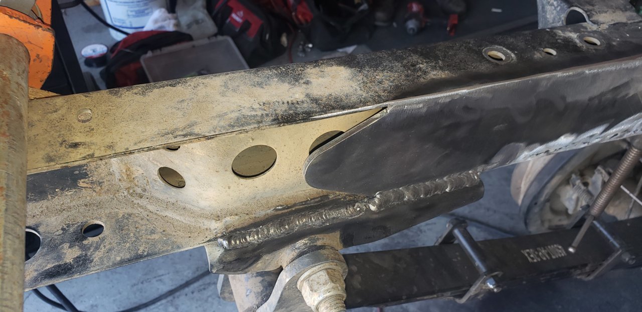

    Ran the welds from the box plates to the end of the rear sackle hangers. Not sure if it makes a big difference, but it looks beefier.

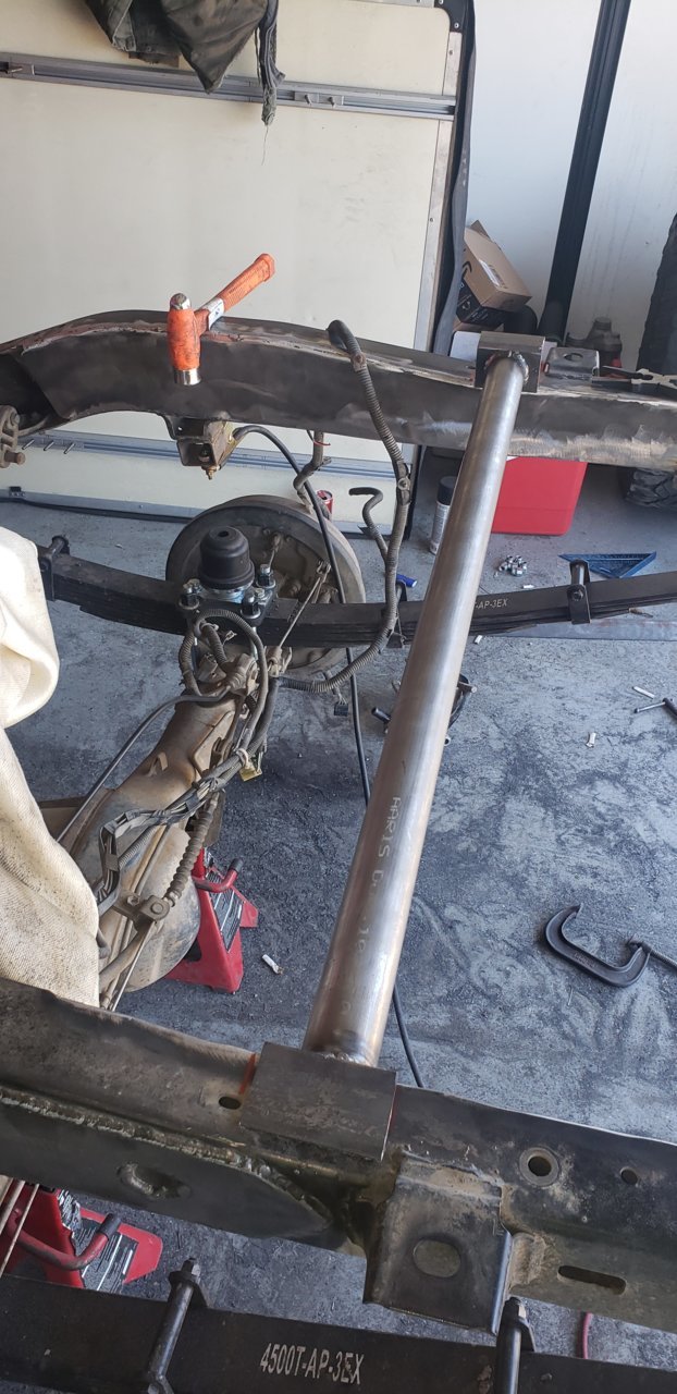

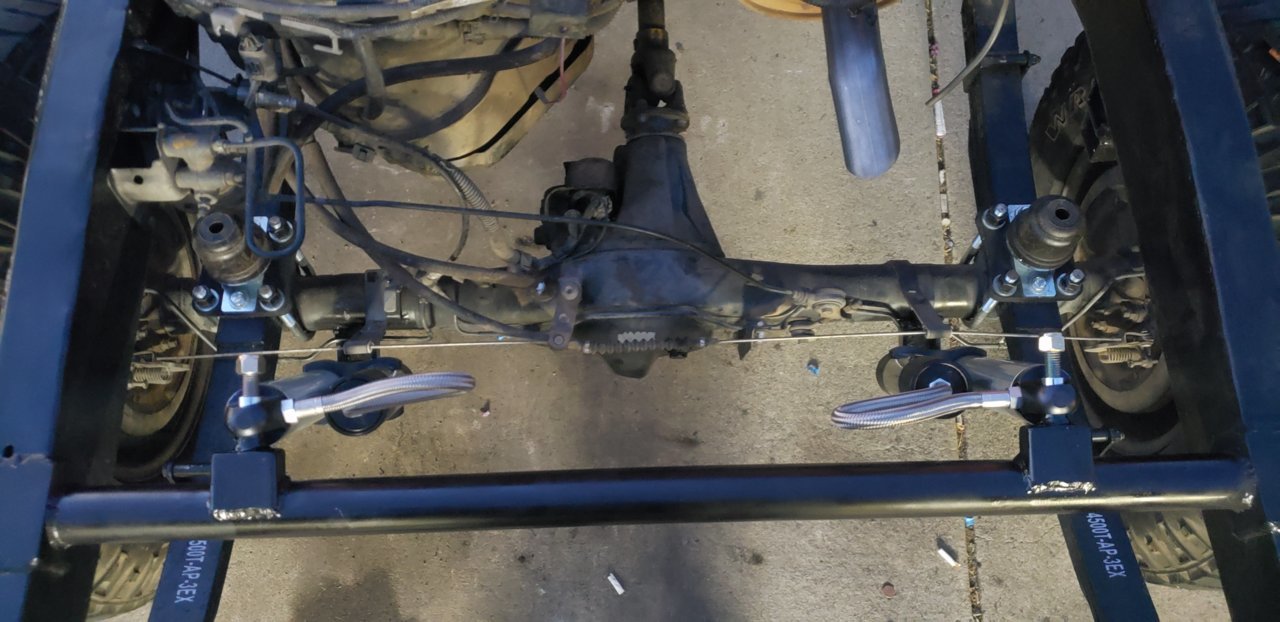

    Assembled the cross member for the upper shock mounts.

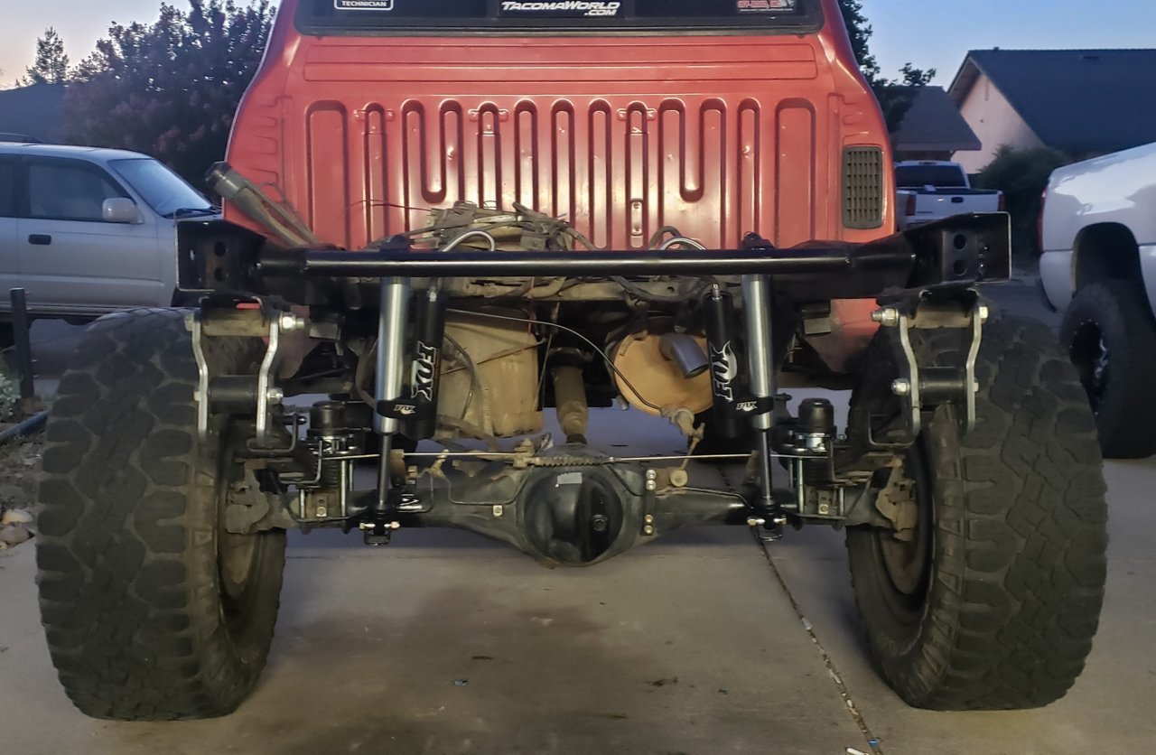

    (Almost) Full droop

    3.5 inches of up travel seems good :thumbsup:

    What are the specs for those fox shocks?

    Part number 983-02-036
    2.0 Smooth body resi with 7/8 shaft. Can't remember the body dimensions, but it was the best fit Fox had. 2.5 - 10 inch bodies are too long.
