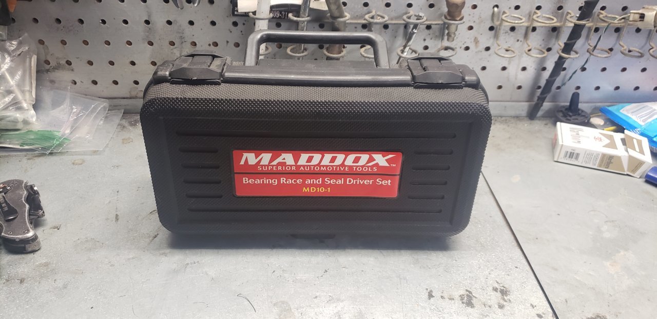

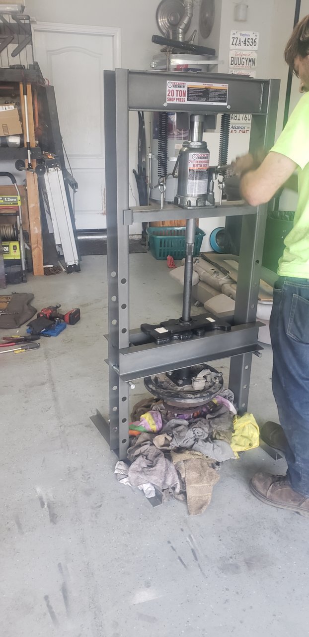

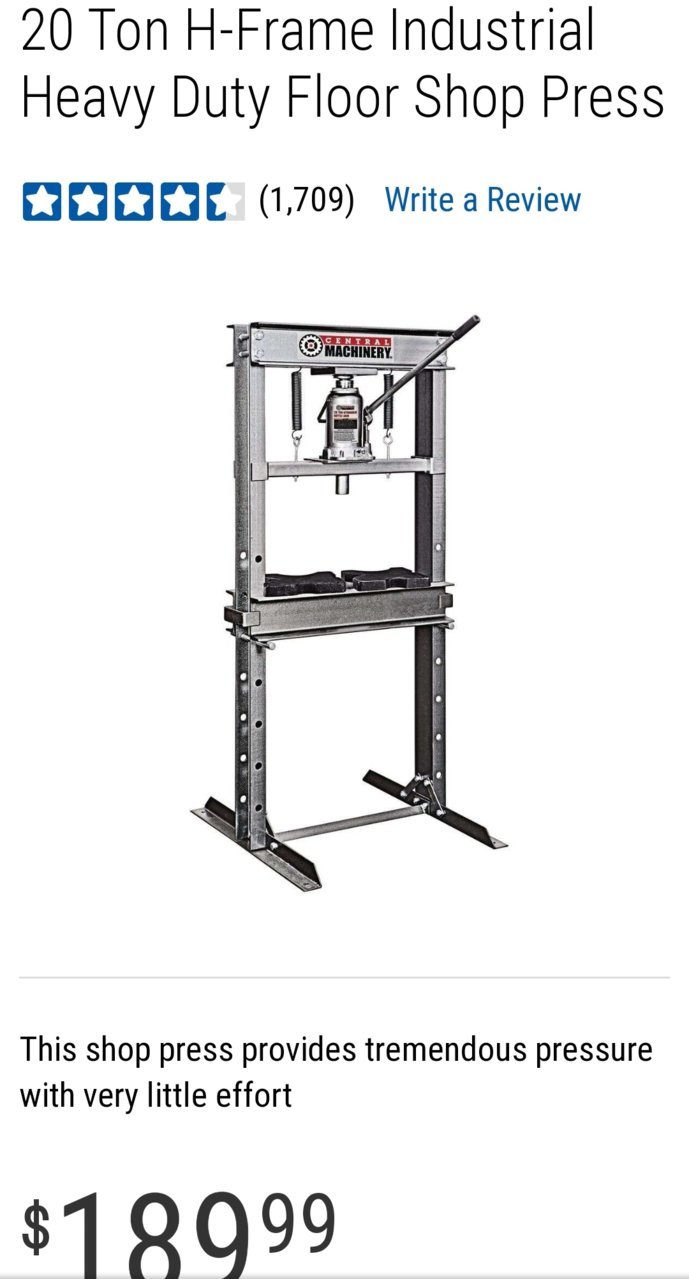

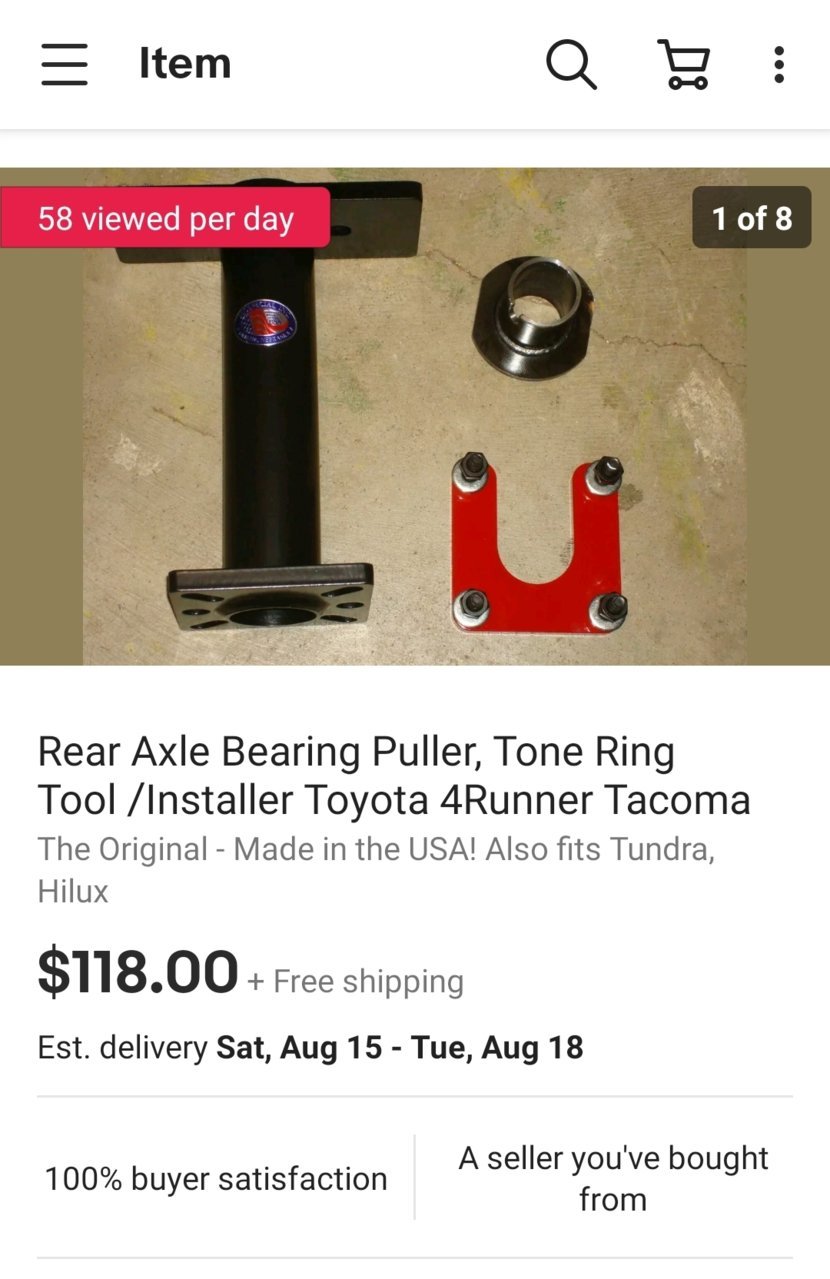

    Rather than pay to have the wheel bearings done at the shop. I decided it's time to get a press. I also ordered the press tools needed for the bearings.

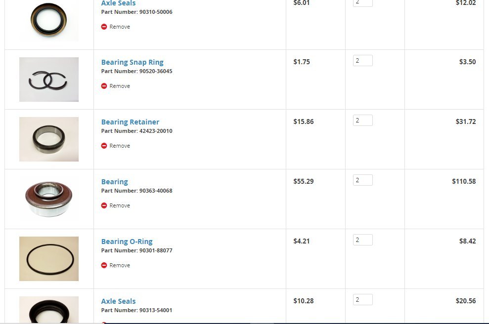

    Ordered all the bearings, seals, retainers, and clips as well.
    Here's the list

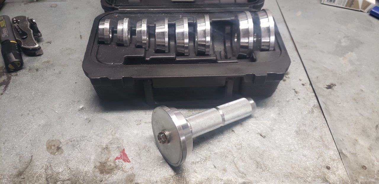

    While waiting for the axle parts to arrive, I did some refurbishment to @foxrcing07 Strut Tamer.

    100% lubed and done.

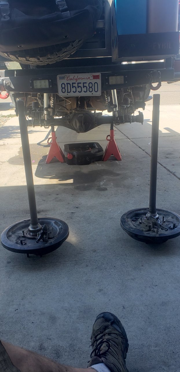

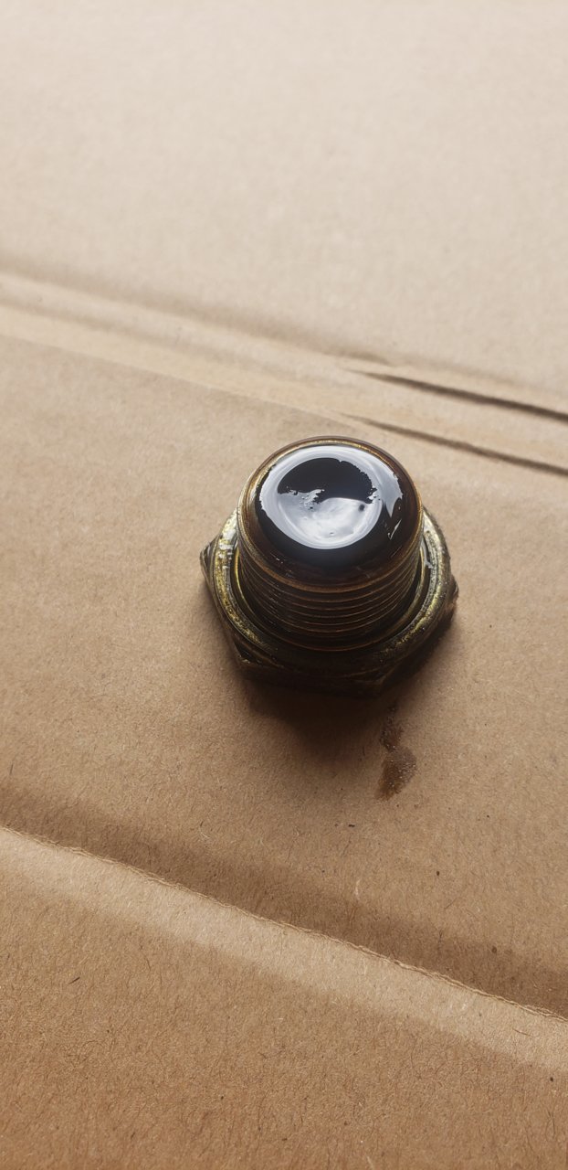

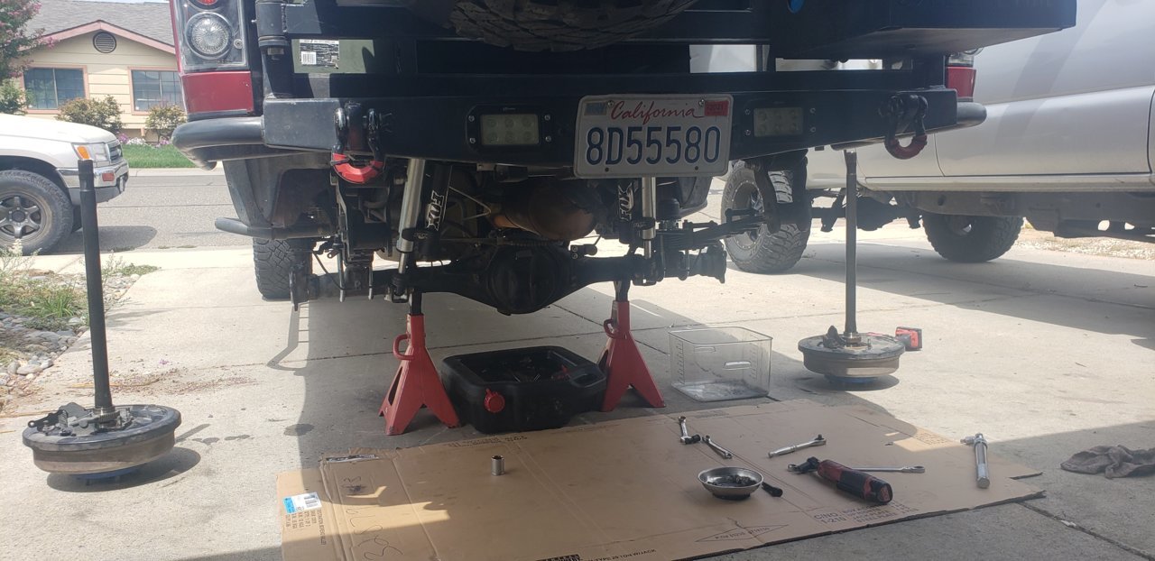

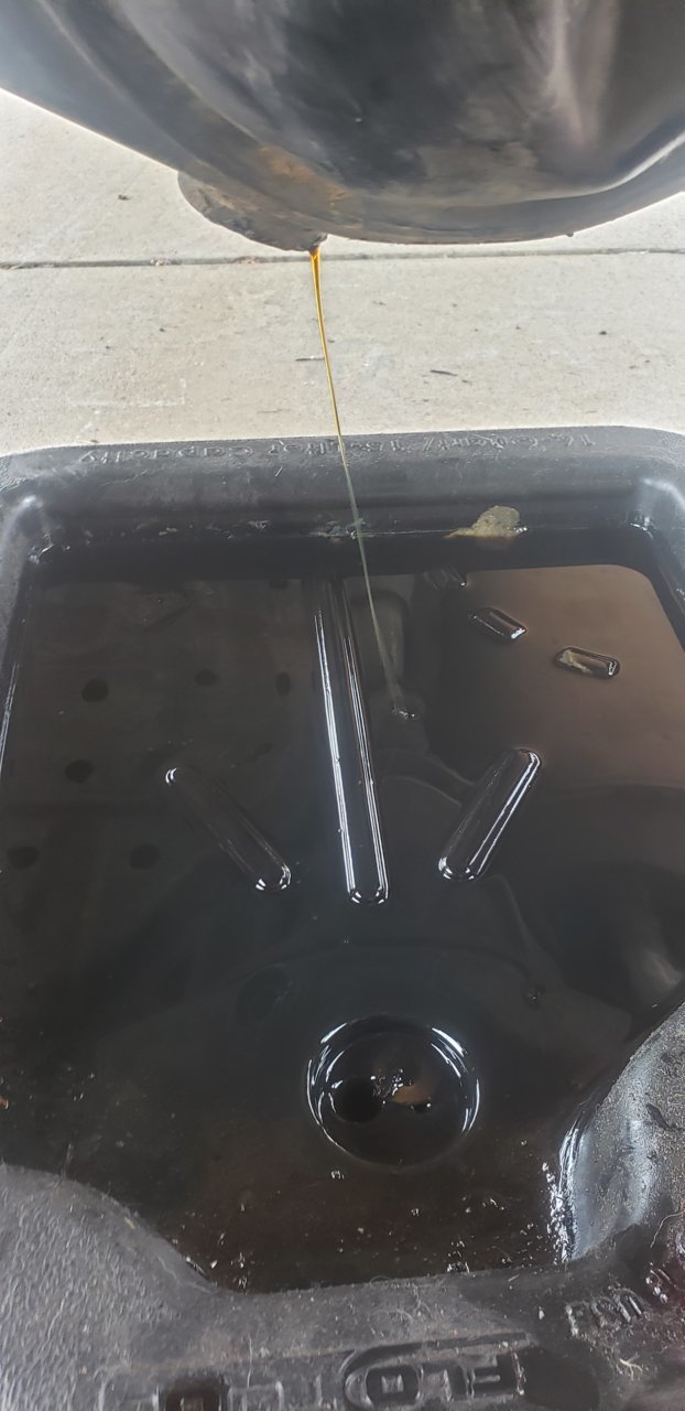

    The parts got in here in time to do the bearings over the weeked. (McGeorge Toyota is THE place to go for OEM parts)
    Of course it was hot as balls

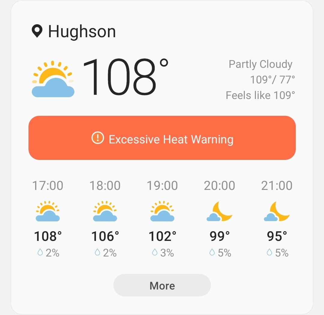

    But we went ahead and did the work... It took Saturday and Sunday, due to the heat, taking breaks, not working as late into the evening as I normally do. If the temps were somewhat normal, this repair probably would have take 5-6 hours... it really wasn't that bad.
    Good signs... no major metal on the magnet, and the oil looked pretty good coming out.

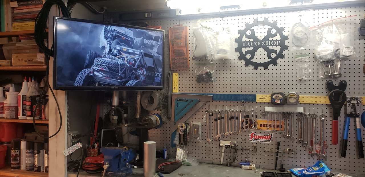

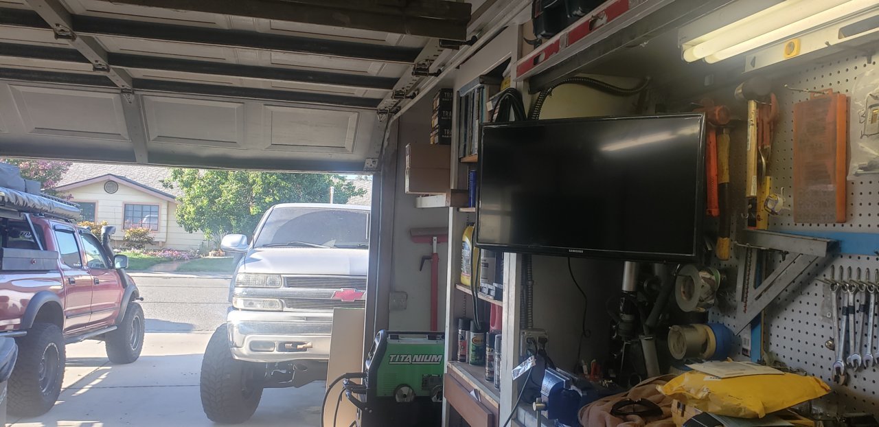

    Daughter got me some cool "art" for the garage. For my Birthday :thumbsup:
    And also finally added a TV to the garage... will make watching @Timmah! videos so much easier.
    Re-organized the peg board, and worked in the Taco Shop art... things are really lookin pretty good.

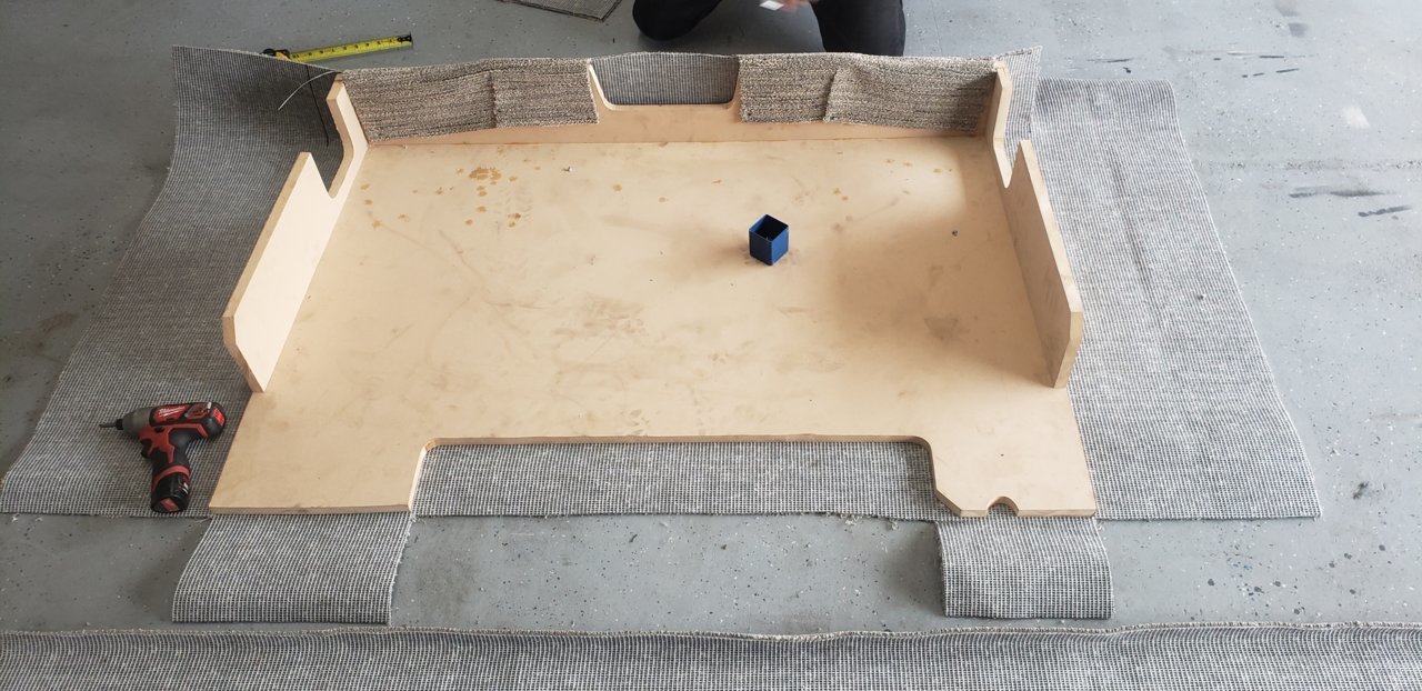

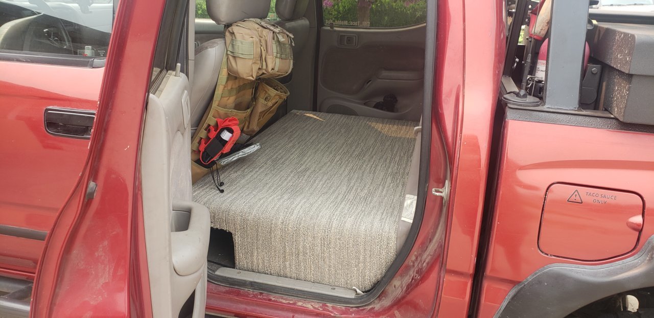

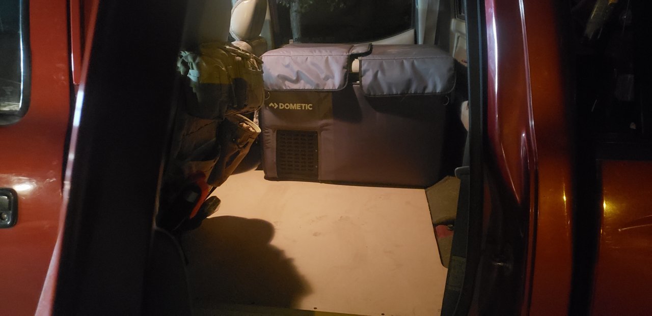

    Finished up the doggo / fridge platform for the backseat.
    Started this a couple weeks ago, by building the platform. Got some nice carpet, from a house I'm building, that should work pretty nice and hold up well.

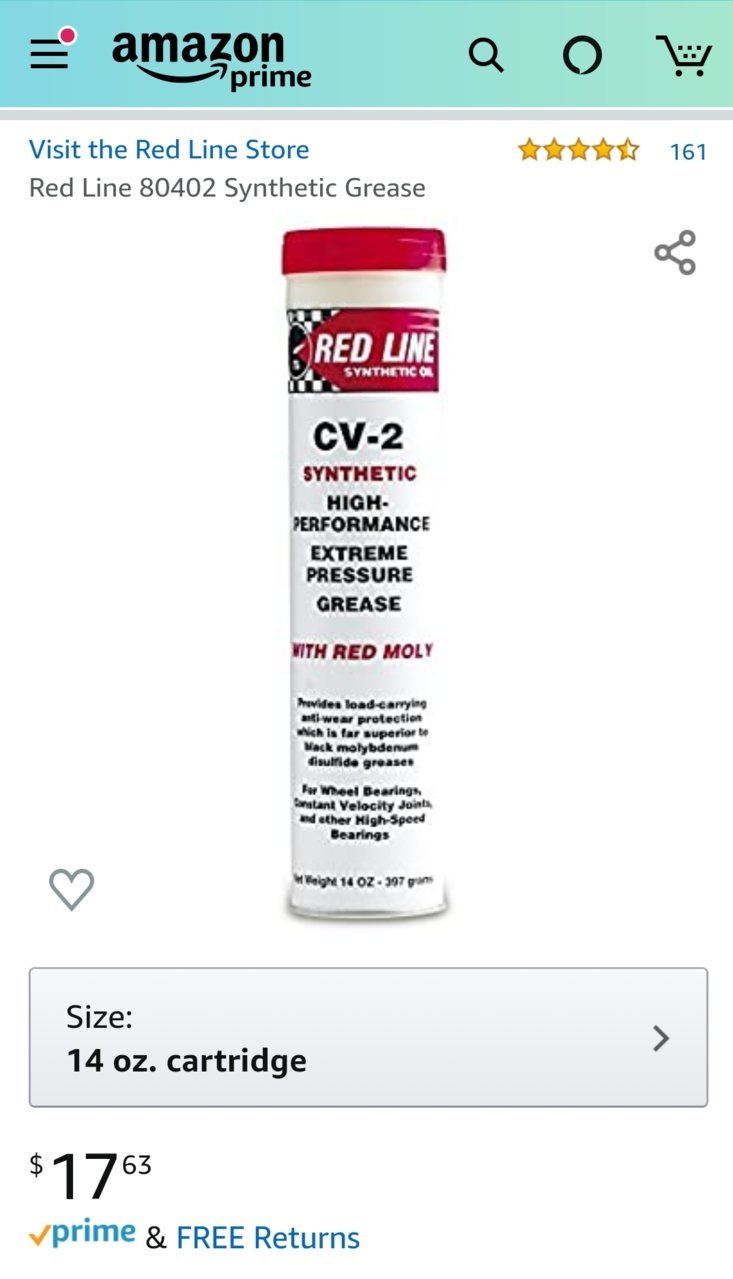

    Tomorrow, it looks like I'll need to talk myself in to rebooting my CVs. I noticed one of the outers has a slight tear in it. I think I nicked it when I was putting in the lower shock bolt at some point. It isn't really "bad" especially with manual hubs (not spinning unless I'm in 4wd). But I didn't like the outers I have on there or the (screw type) hose clamps that on them.
    Ordered some AllPro longer travel outer boots.
    And Ordered some new grease. I use one tube per side. Half in the inner boot, half in the outer boot.
