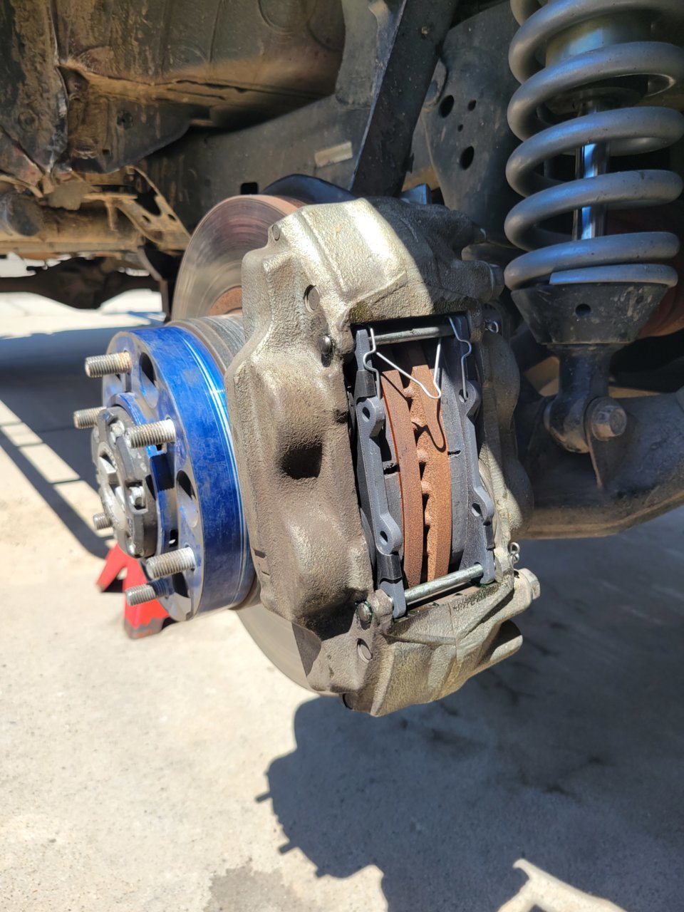

    ...continuing with the maintenance theme of the day.

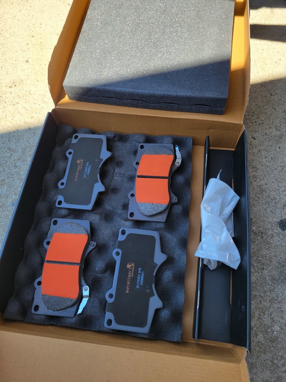

    Bought these fancy schmancy pads from O'Reilly.

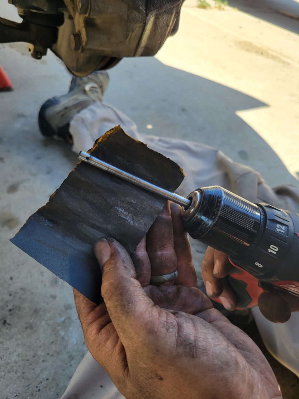

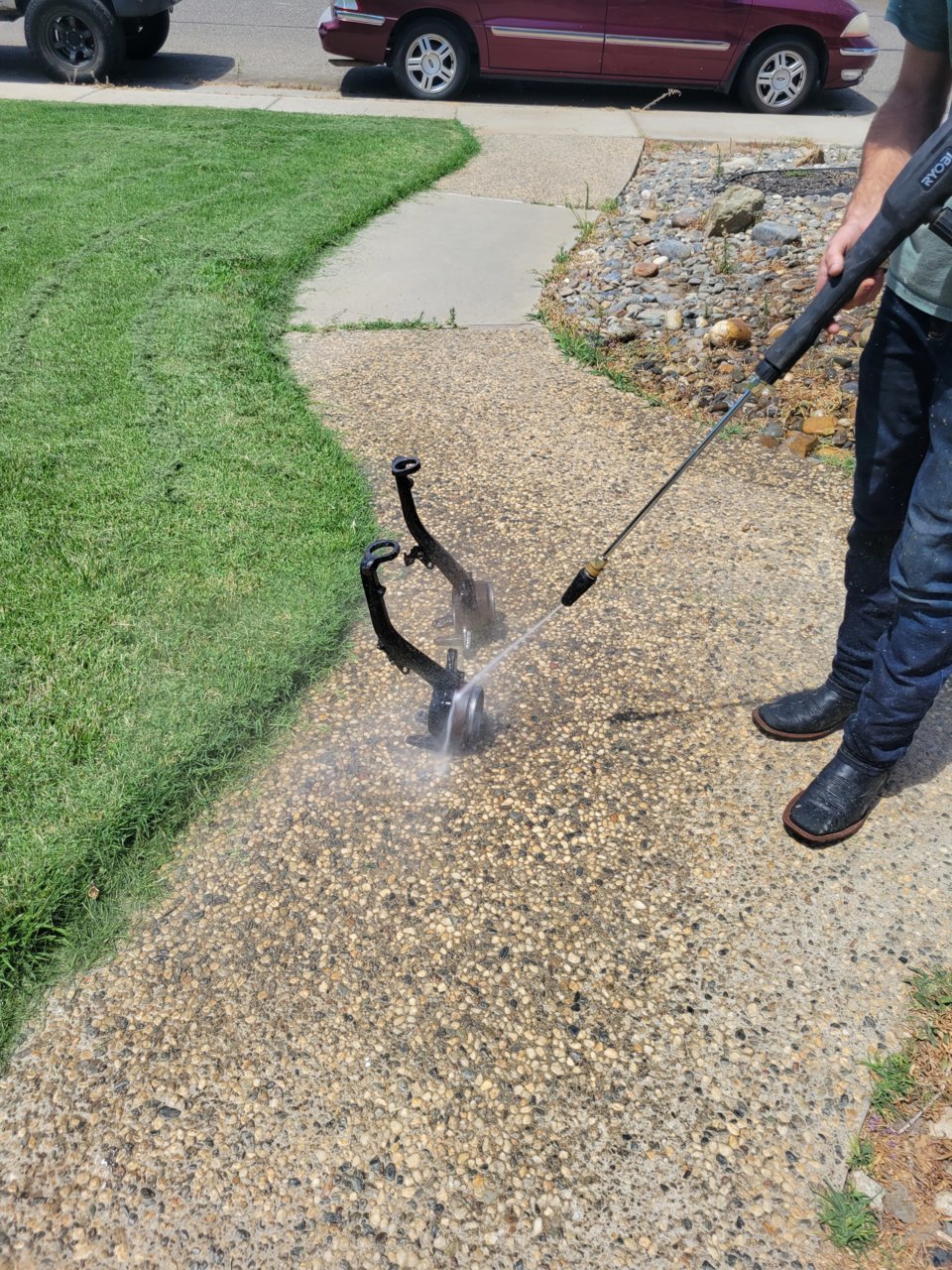

    Here's my trick for cleaning the brake pad pins.
    Also pulled the driver side coil over and adjusted it 4 turns down. Truck still leaned annoyingly to the driver side. One day I'll get that where I want it.
    Did an oil change and repaired a ground wire under the bed (for my rear facing lights) must have gotten caught in some brush. Rerouted it as well.

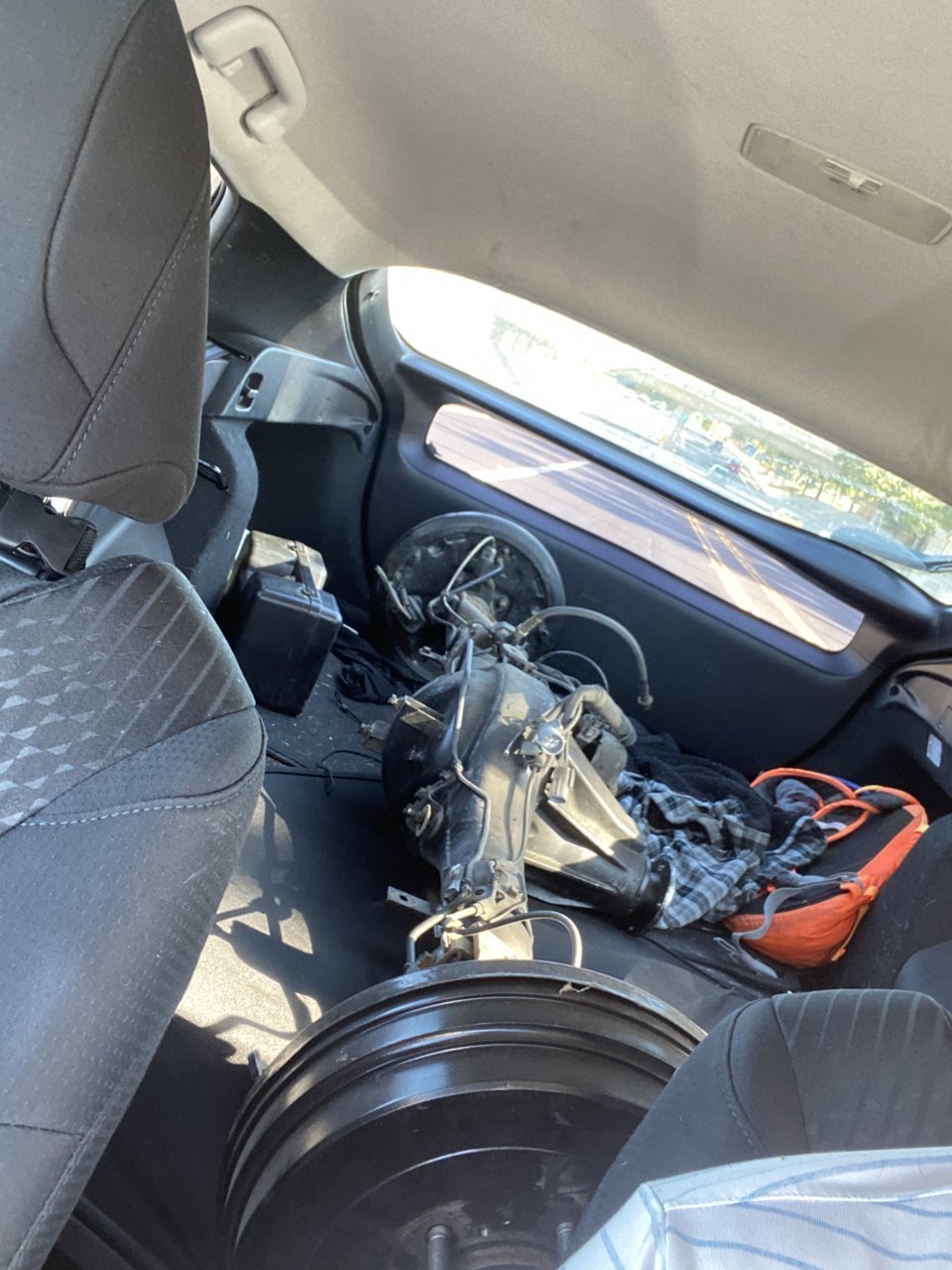

    And it also looks like @MattJakobs is in on the action getting me going with a regear.
    Shoved this bitch in the back of his friggen Prius to score it.
    We got square up on that soon brotha.

    Damn near. Not a spec of even surface rust, 100 miles on a fresh set of 5.29s w/ elocker, new brake drum, new bearings, etc

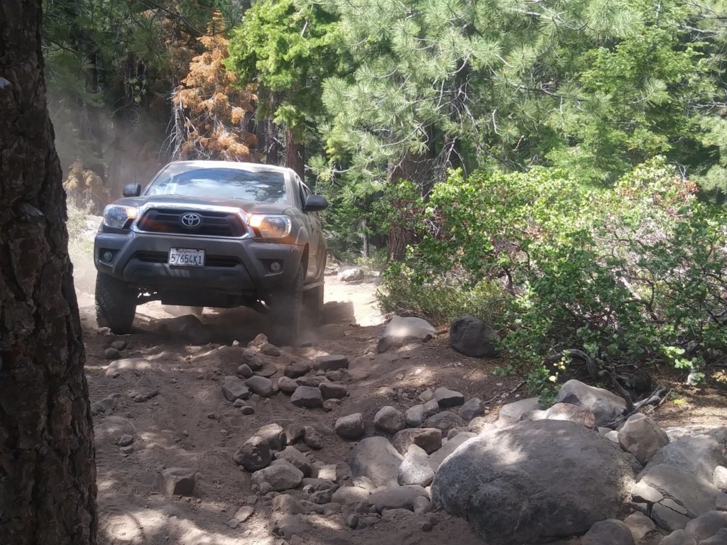

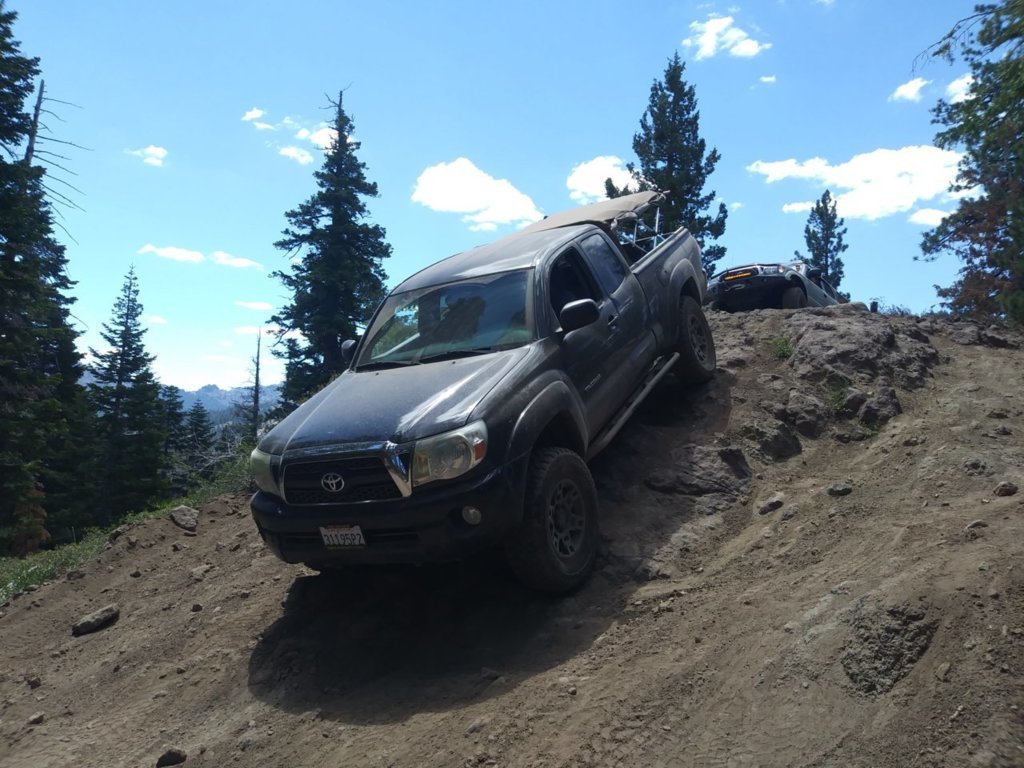

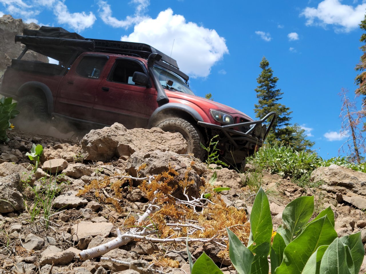

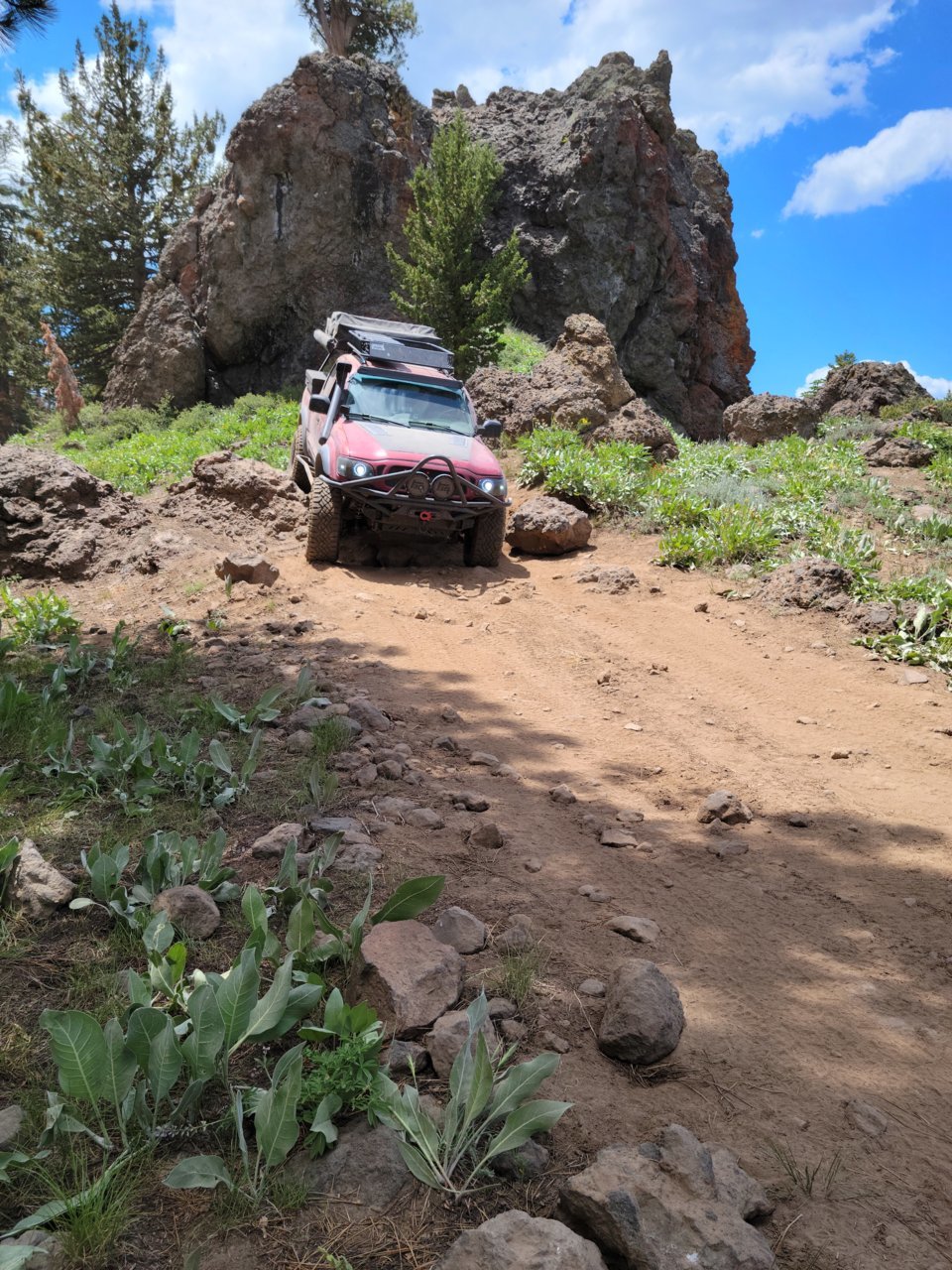

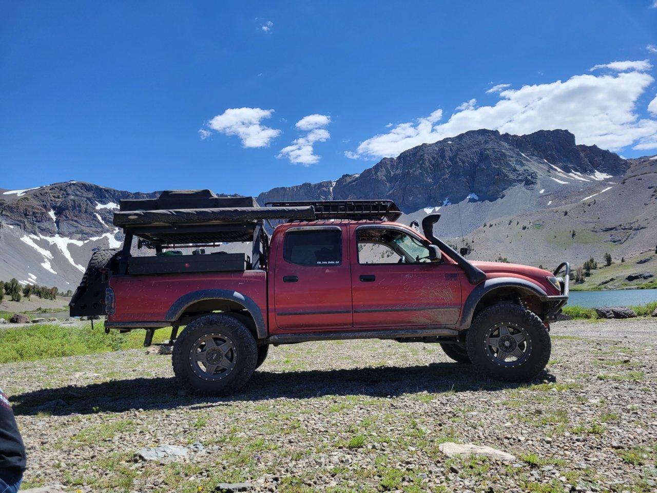

    What a badass weekend! (Pic heavy post)
    Started out Friday afternoon with my wife and my good buddies @Blue Canary @Motofox and @essjay. Headed up the hill and found a pretty epic spot.
    @CemenTRDgen met up with us Saturday morning and we set out to explore Long Valley. The area we were camping in.
    Headed out back to the highway, to run over Sonora Pass towards Leavitt Lake.
    On the way back to camp, we stopped off and supported the Dardanelle Resort (decimated b the Donnell Fire a couple years ago) by getting some snacks, ice cream, beer (and Jen got herself a sweatshirt)
    @TacoJohn4x4 met up with us Saturday night, and we chilled around the camp fire.
    Then Sunday was a big day... Niagara Rim Trail was waiting for us to run it.
    20210627_105821.jpg20210627_112945.jpg 20210627_113025_HDR.jpg 20210627_112955.jpg 20210627_113322_HDR.jpg 20210627_120735.jpg 20210627_113024.jpg 20210627_112634.jpg 20210627_125229.jpg 20210627_125318.jpg 20210627_130904.jpg 20210627_131302.jpg 20210627_140551 (1).jpg 0REdF3e (1).jpg 20210627_144035.jpg 20210627_142603.jpg
    And run it we did... all with minimal damage to rigs
    Wrapped it up by airing down and talking a little shit about the day.

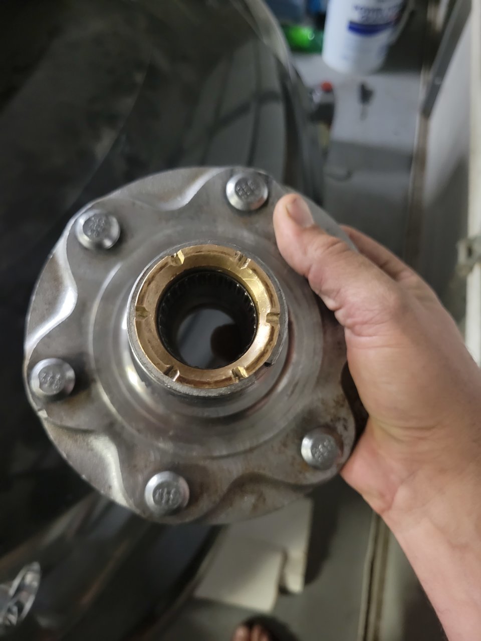

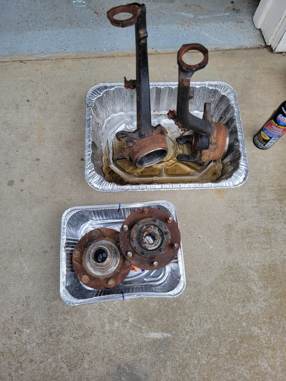

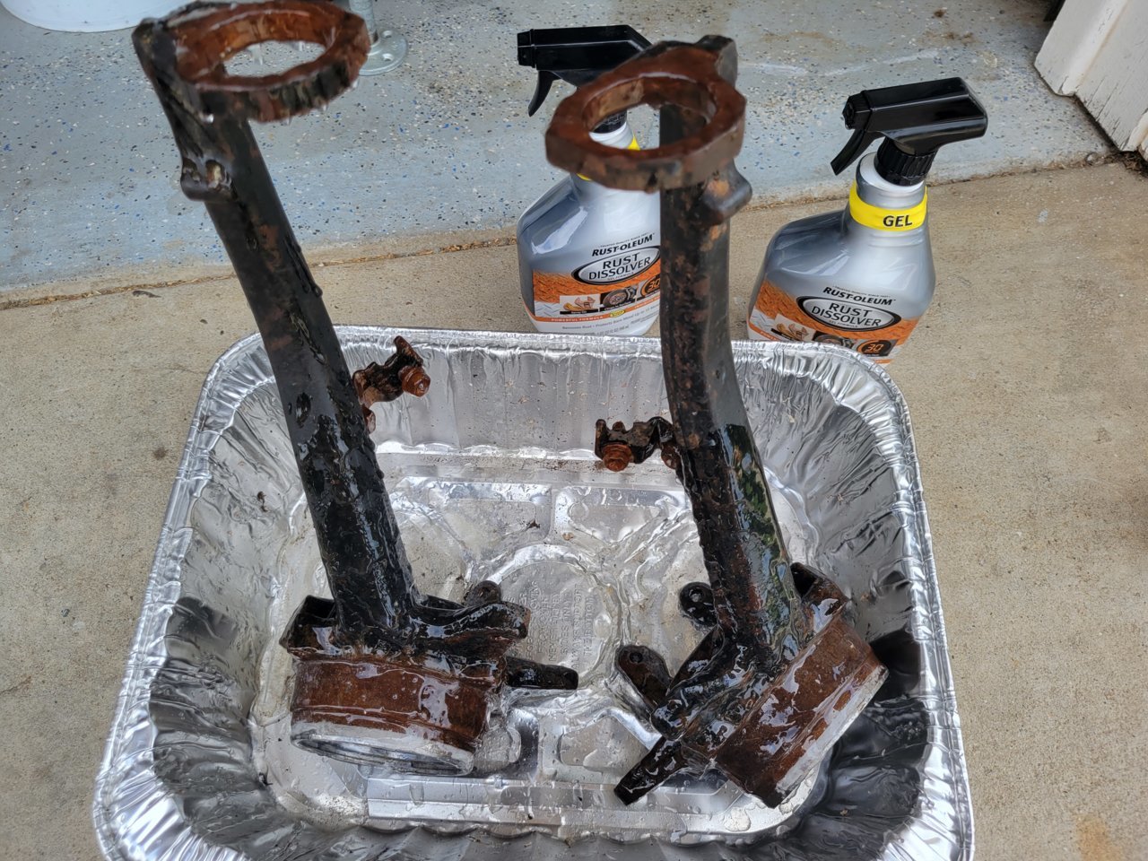

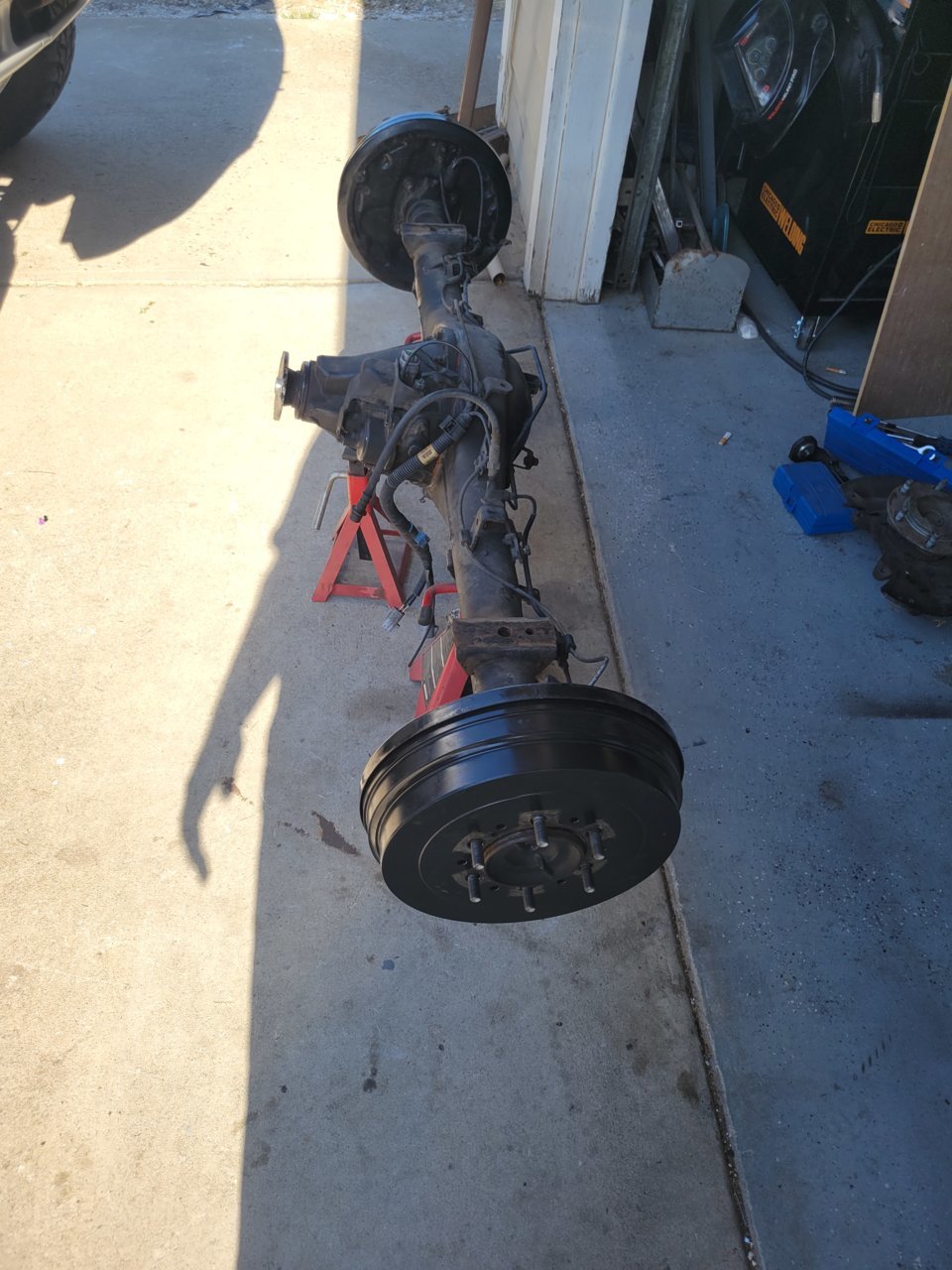

    Operation Rusty spindle :thumbsup:

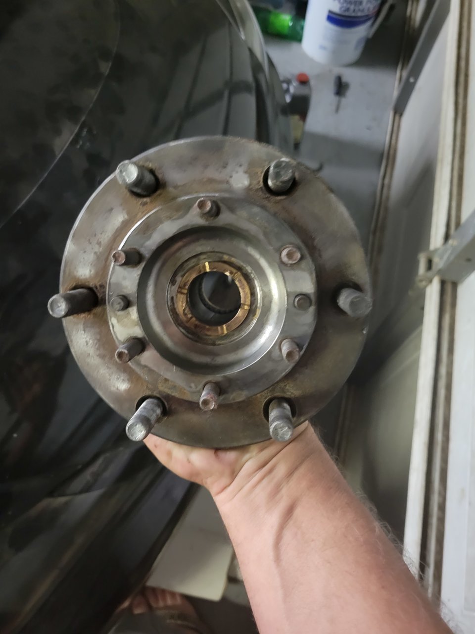

    To make it easier to deal with bearings going out, I'm refurbishing a second set of spindles. That way when I have a bearing go out I can just swap in the other set and replace the bad bearing when I have a chance.
    These spindles will get a freash set of bearings, dust seals, etc after we get everything cleaned up and weld in the gussets.
    unstpible and POSTacoMike like this.

    My brake pads don't com in a fancy schmancy box like that!
    unstpible likes this.

    The guy at the couter said they are brand new items they carry. They hadn't even gotten a chance to stock them yet.
    I saw the box, and said damn, how much are these things? They were around 50 bucks so I said sure why not.

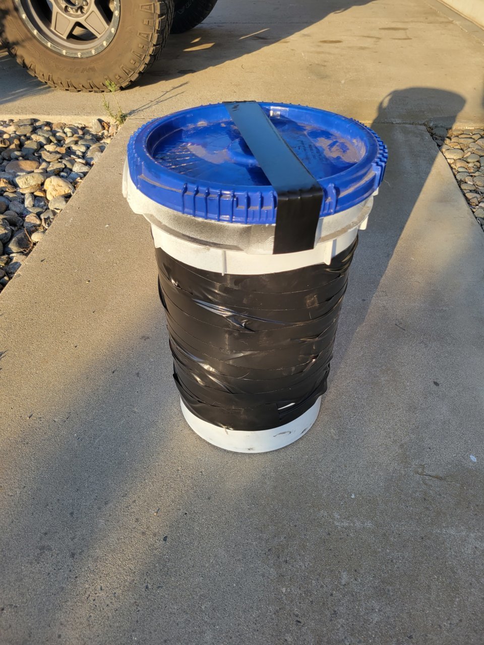

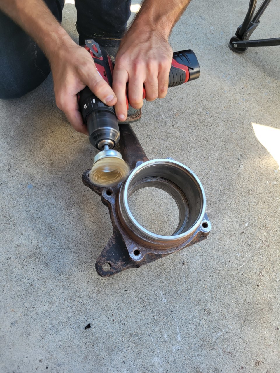

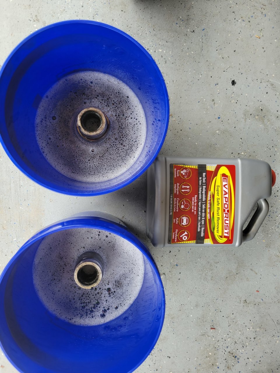

    Spindles soaked in rust remover most of the day. We wire brushed them to remove everything loose. We brought the mating surfaces back to bare metal. They are all prepped and ready to weld gussets tomorrow.
    Then we'll tape em up and paint em.
    Hubs soaked all day too. I'd say they came out nicely.

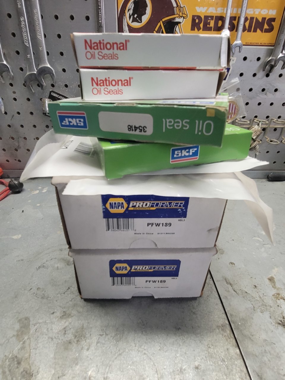

    And then we have the pile of parts:
    Bearings
    Retainer clips
    Inner dust seals
    Outer dust seals

    Operation: Rusty spindle (Continued)

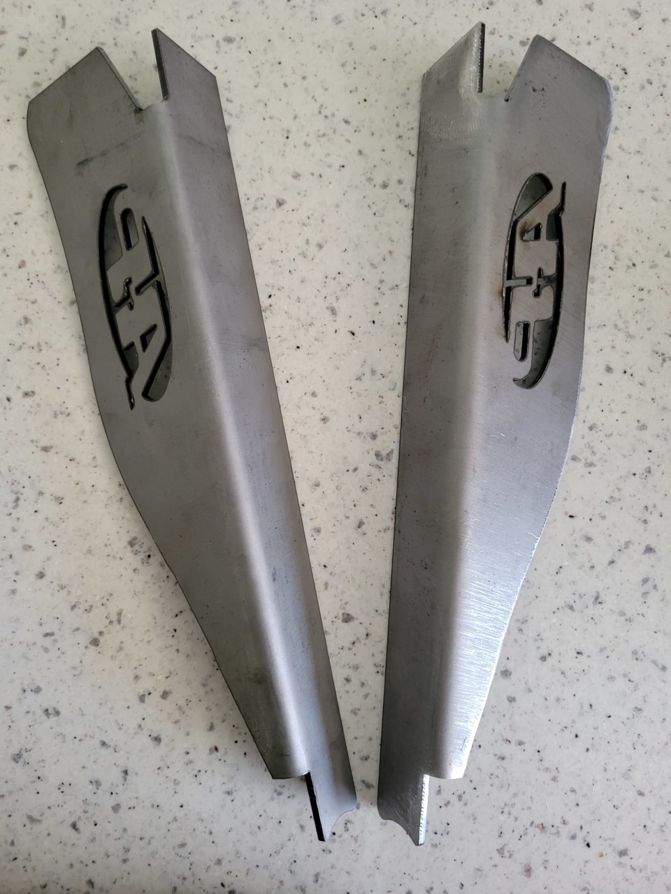

    I bent the top tabs inward to get a better fit.
    Also, Beveled the edges where the gussets are welded under/inside where the UBJs are. If you run SPC or similar, that needs a clip to go around the UBJ sleeve, you don't want the weld to build up in this area. It will make it so the clip doesn't fit.
    Robert started the 4th off early, by running some sparklers :thumbsup:
    I think they turned out just fine
    All taped up and first coat is on.
    Jen loves it when I get overspray on the lawn

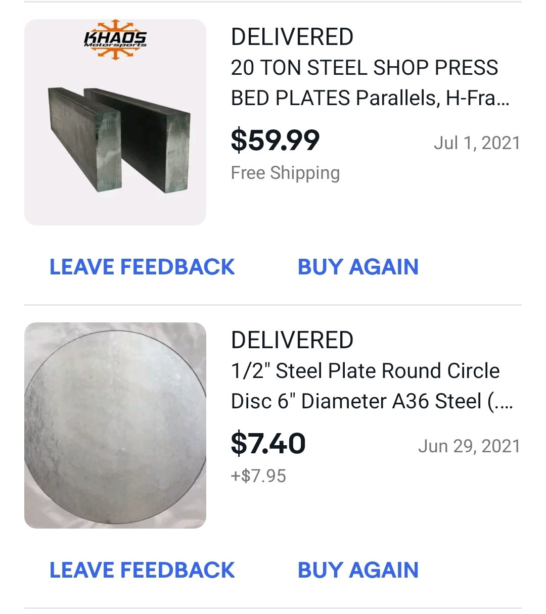

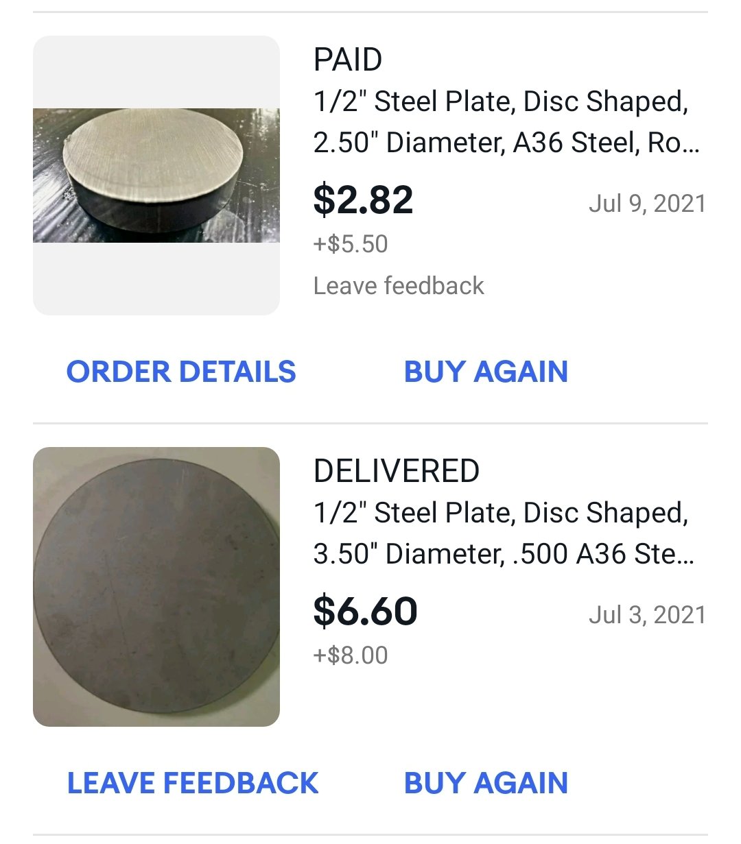

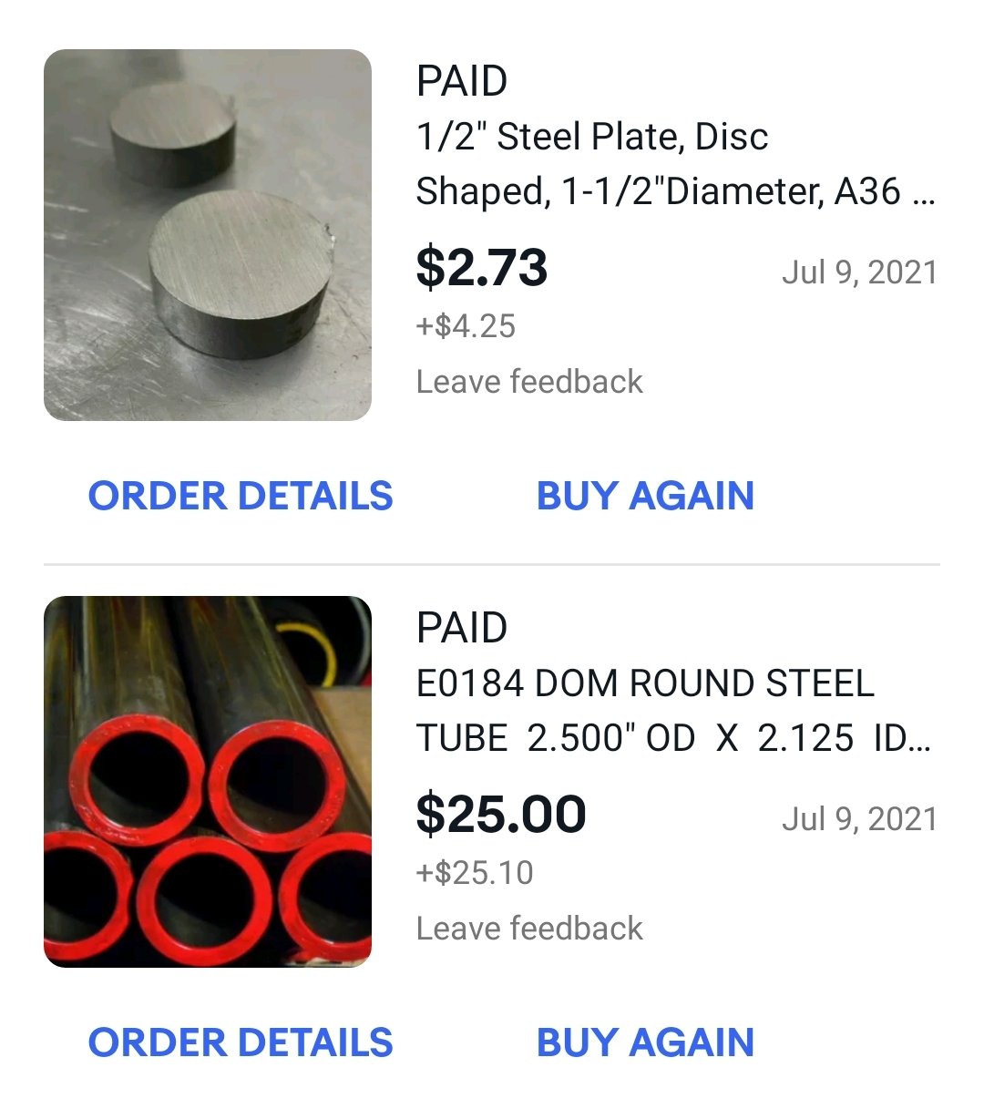

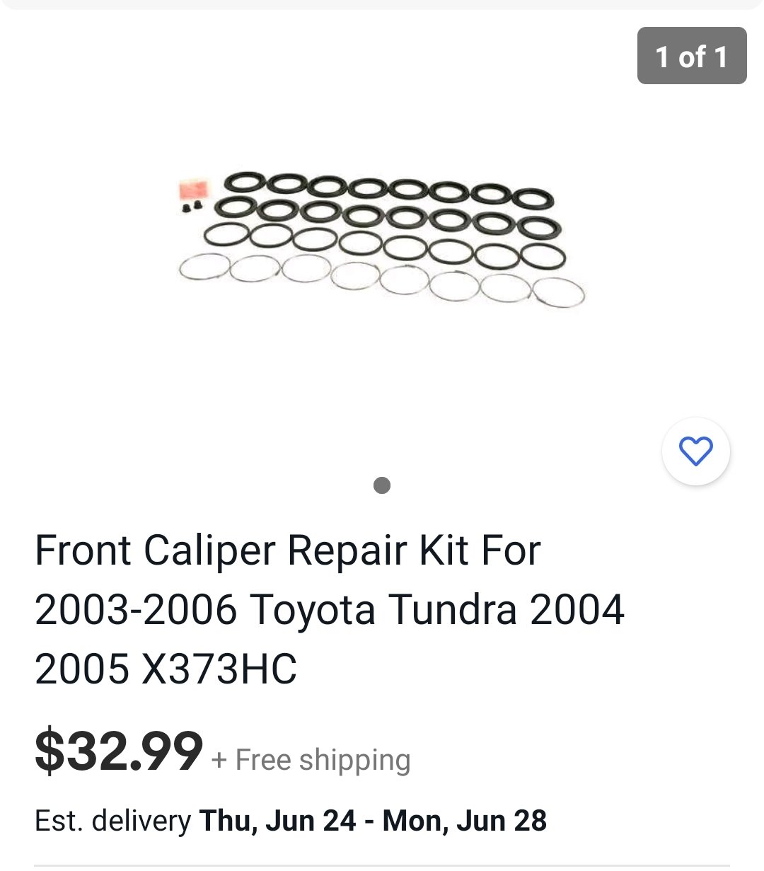

    Since it looks like I'll do doing these damn wheel bearings every year, or so... I decided to buy some materials to make dedicated press fixtures for it.
    I know I could have just gotten some press plates and sleeves, but once I've got this all together, I think it's going to make the job a lot easier.
    Screenshot_20210710-163419_eBay.jpg Screenshot_20210710-163403_eBay.jpg Screenshot_20210710-163347_eBay.jpg
