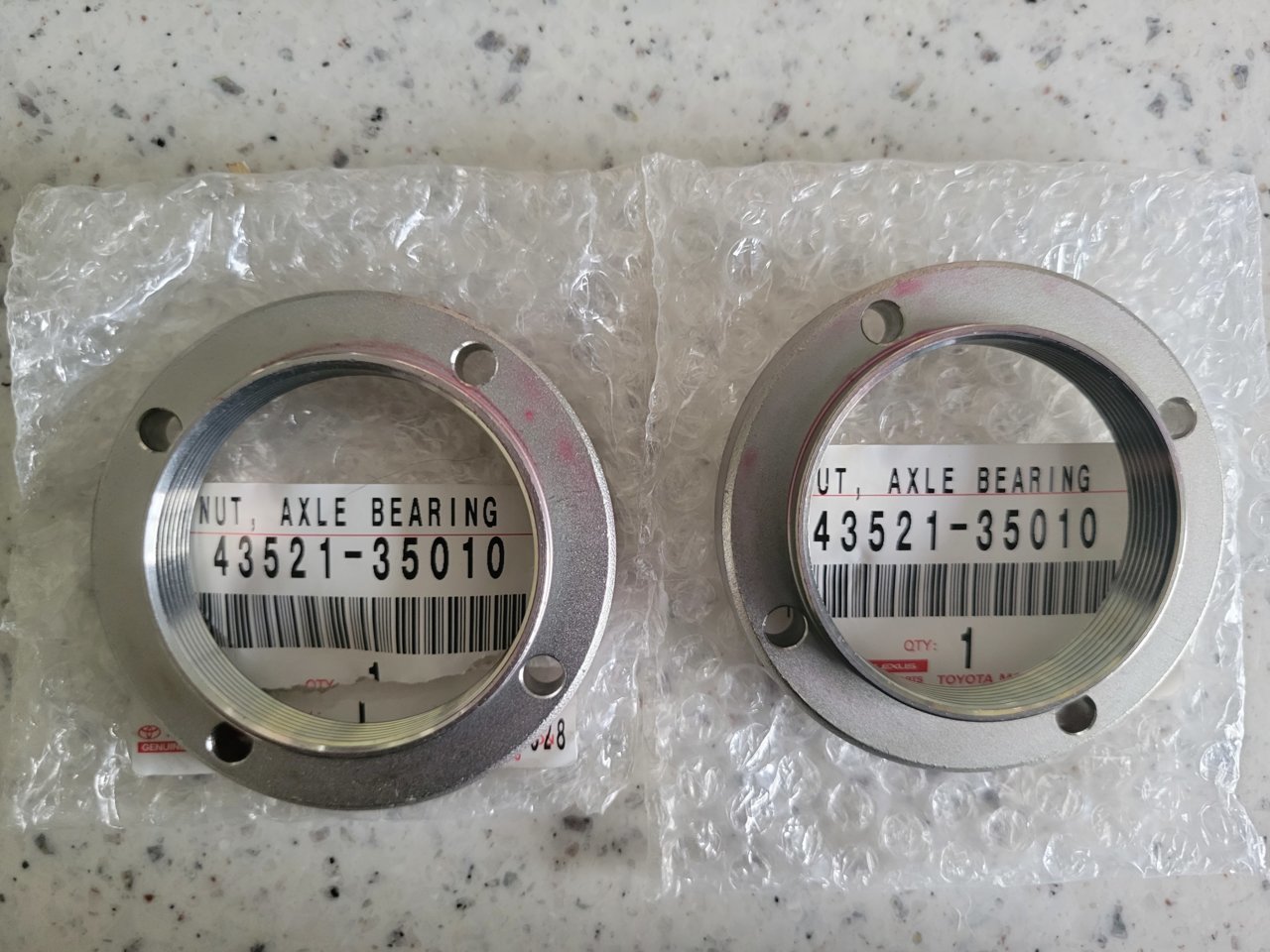

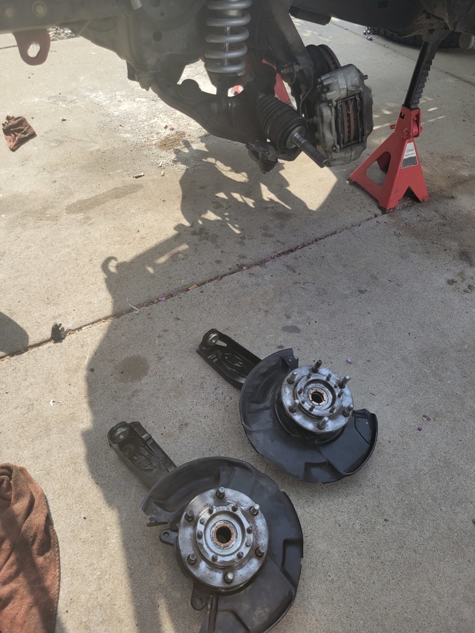

    Throwing this here so I can make sure to keep the part number.
    Hub nut for Manual hubs
    These should be the last parts I need for the bearing replacement. Now I'm waiting for the press plates and the DOM tube I ordered to finish the press fixture I'm making (for pressing hub through bearing)

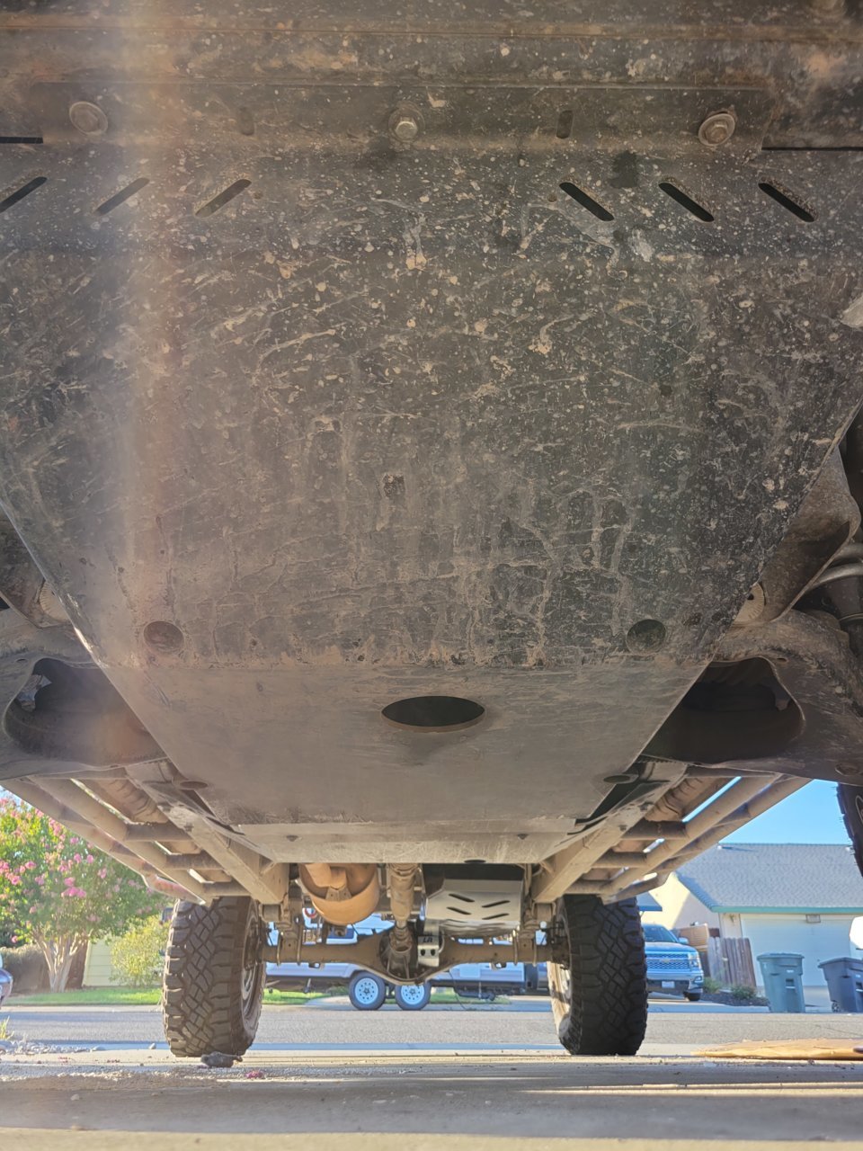

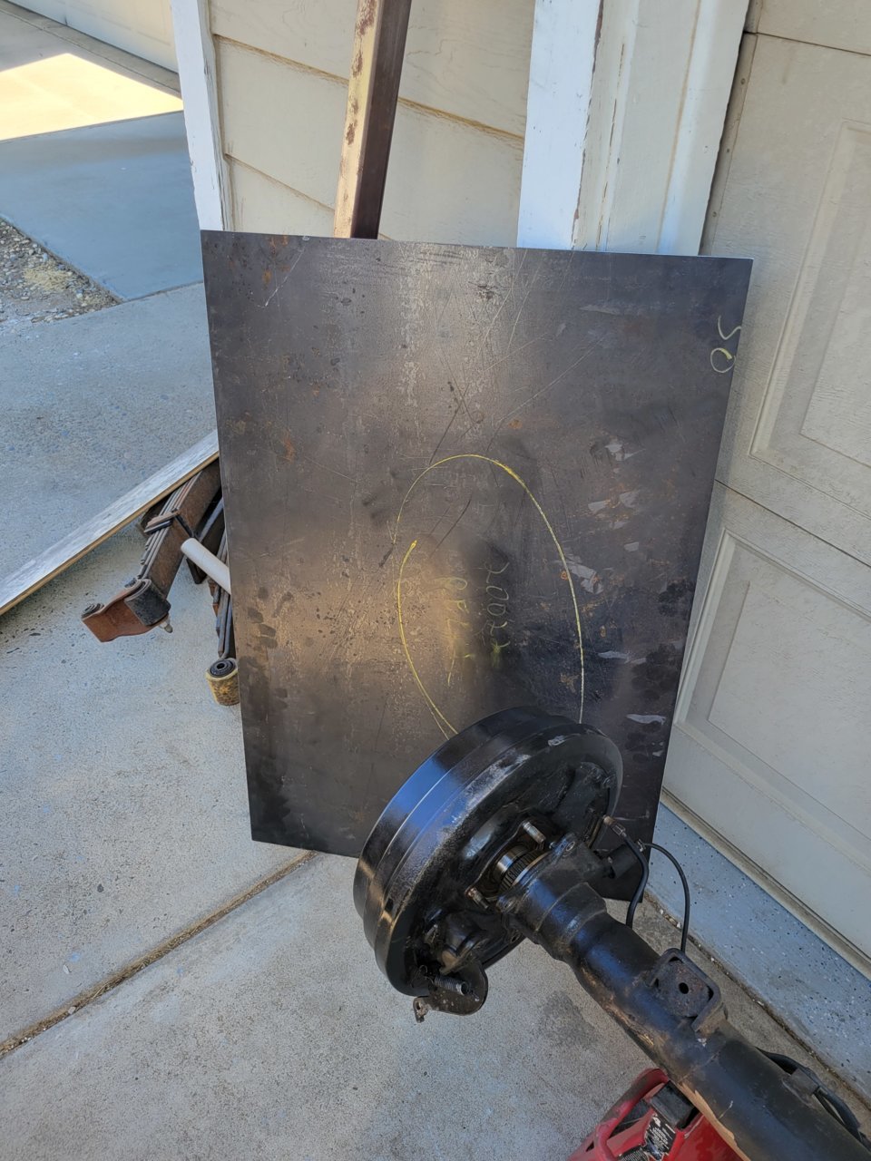

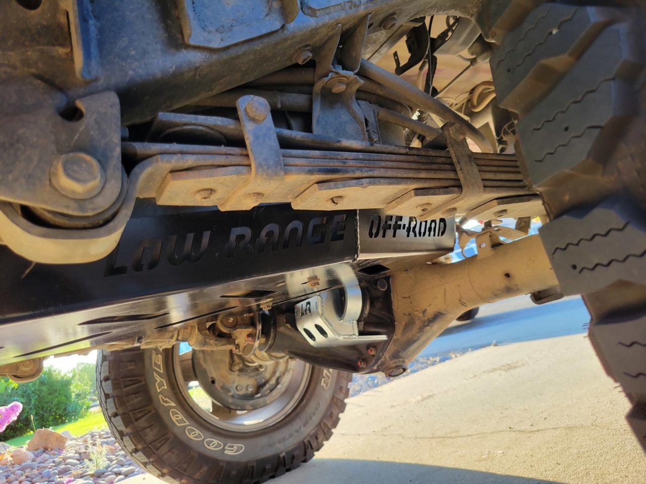

    Got a sheet of 3/16 steel. I guess we're going to figure out a way to fab a rear diff skid... eventually.

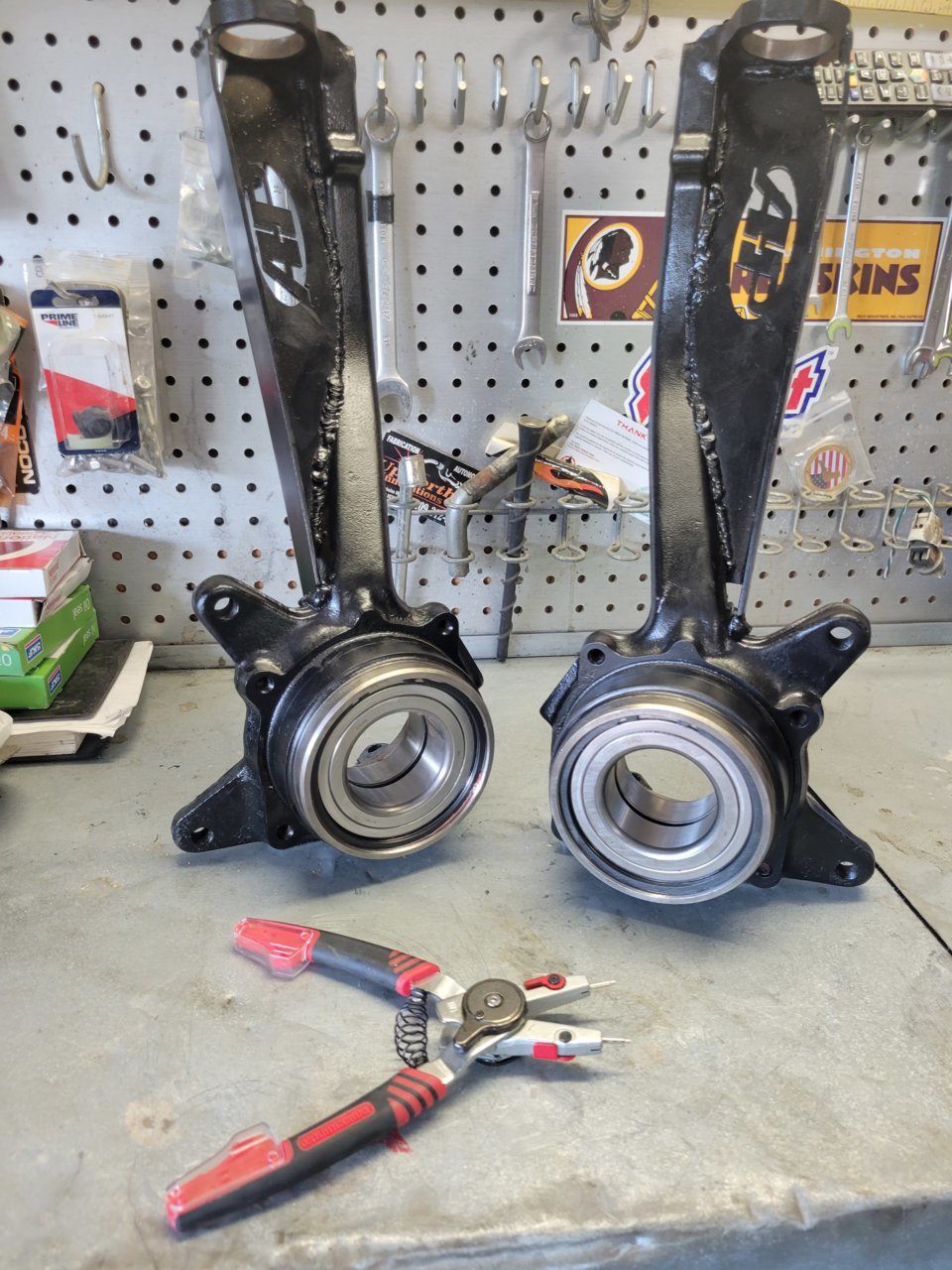

    Pressed the bearings in to the spindles. Still waiting to finish fabbing a press fixture for pressing the hubs. That might get done today, who knows.
    waldeeeeen and unstpible like this.

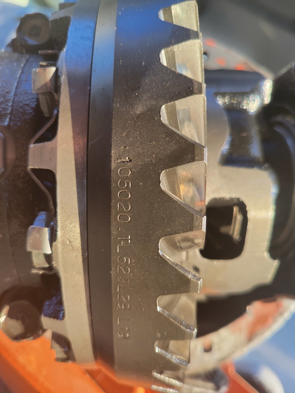

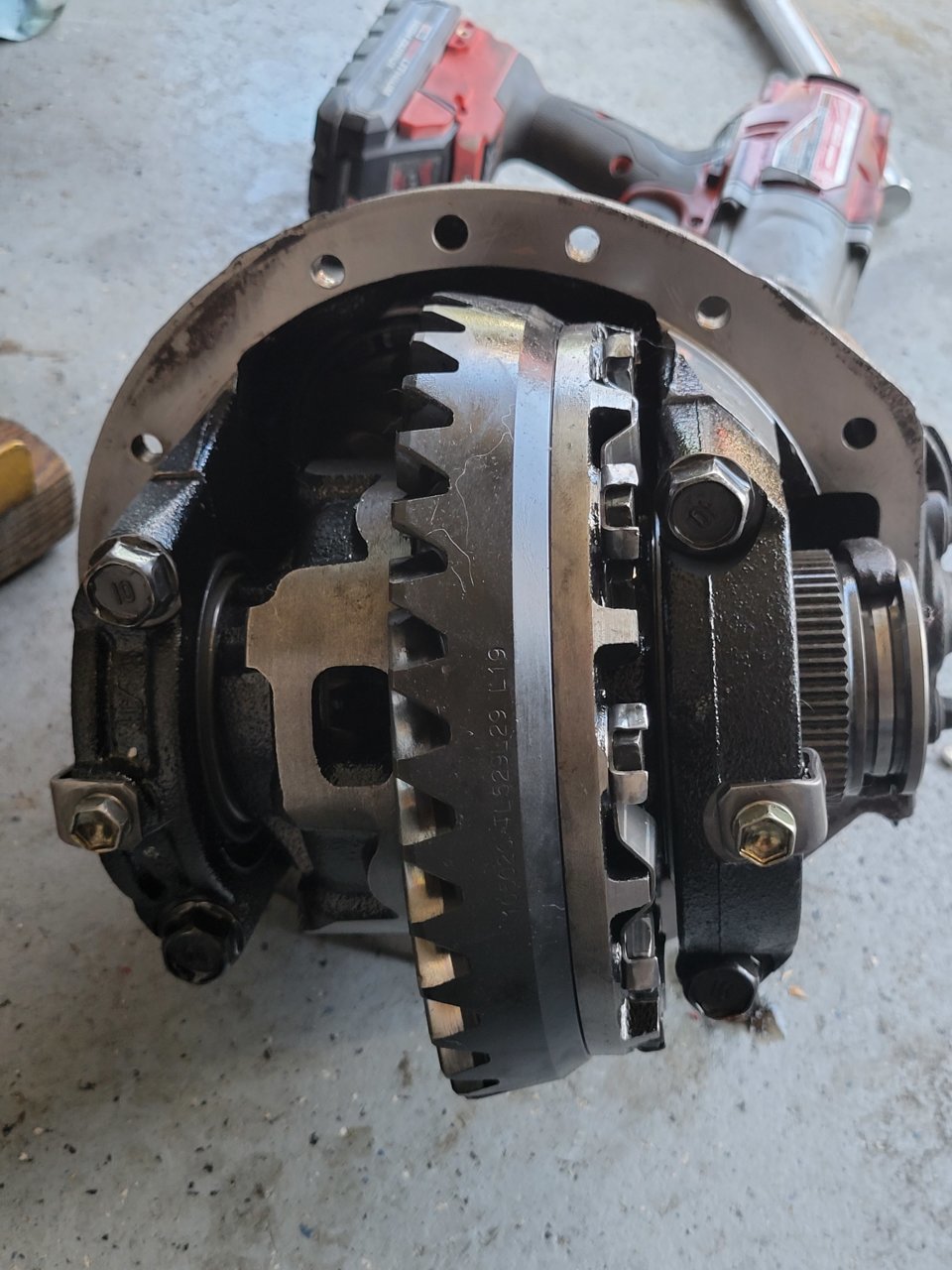

    Tested the 5.29 3rd member elocker by hooking it to the truck...
    She's good to go :thumbsup:

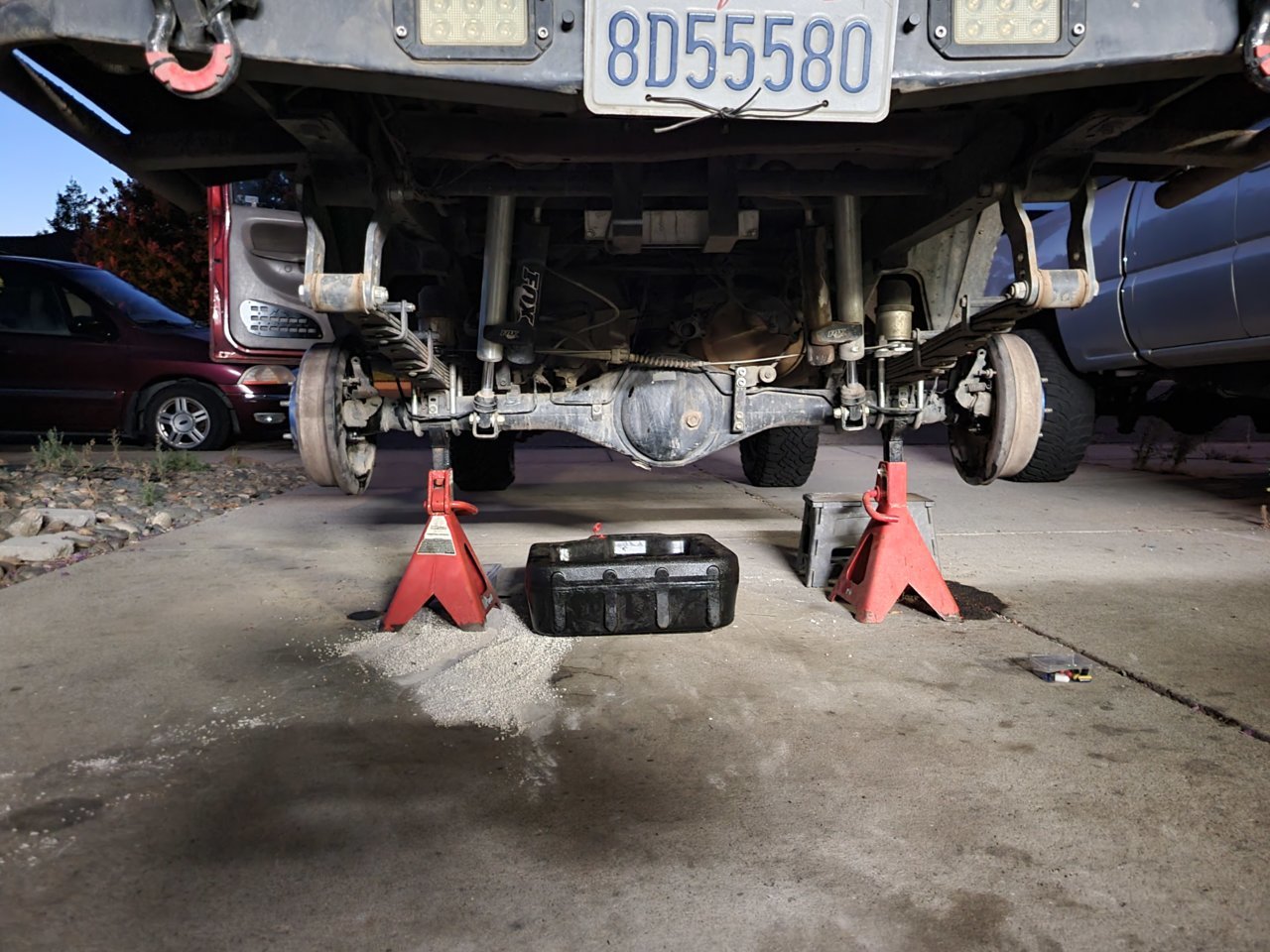

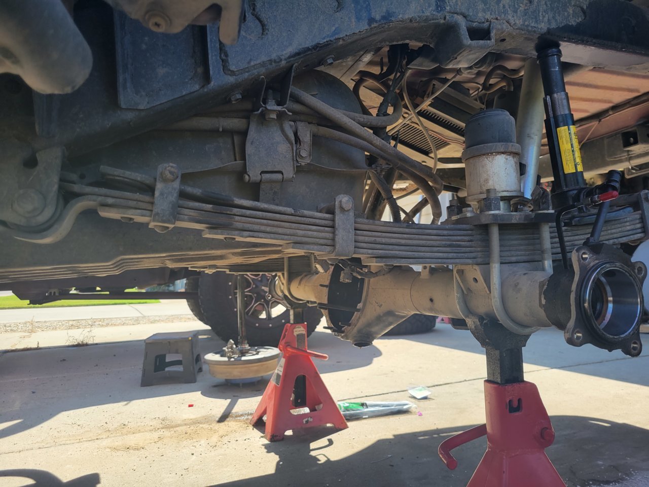

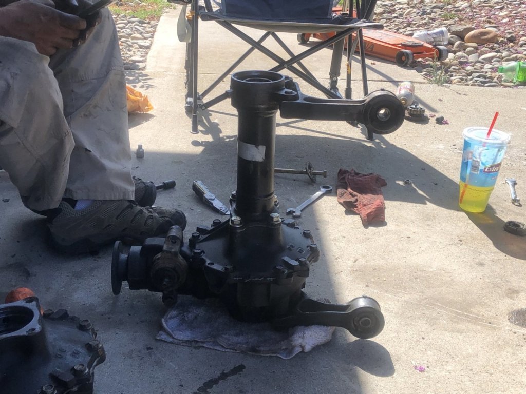

    Started tearing everything down last night.
    Disconnected the elocker, driveline, brakes and got the axles ready to slide out.

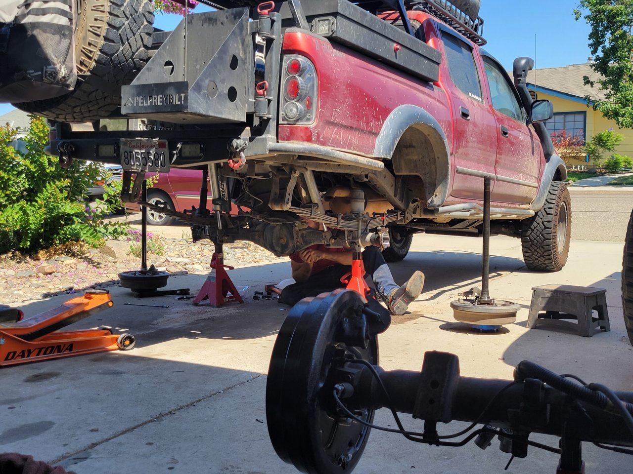

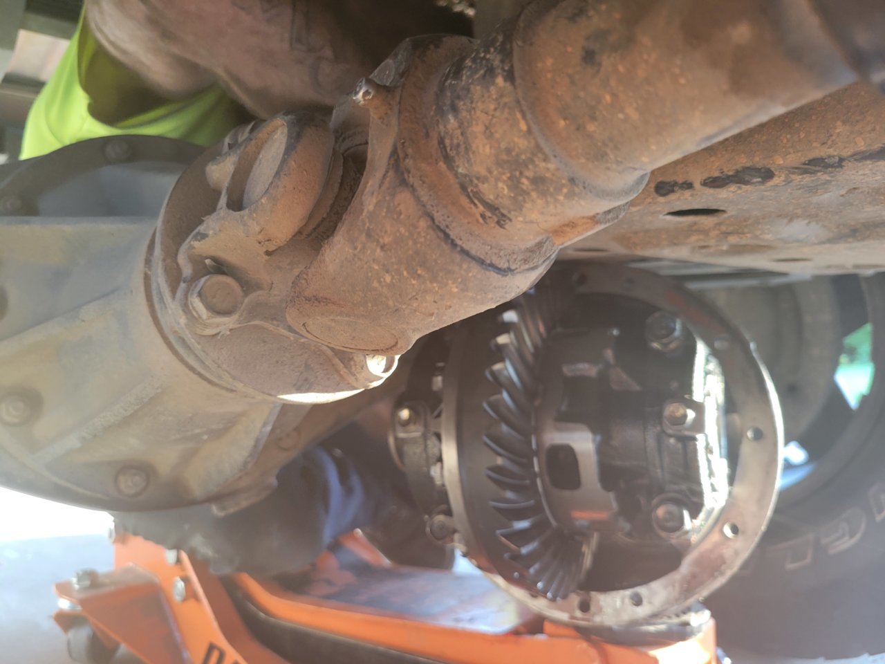

    Back at it this morning
    Out with the old...
    Cleaning gaskets sucks
    Glad I don't have to do it :rofl:
    Actually... I did mine, I'm just better and faster at it.
    In Robert's defence, he's having to do that stupid cork OEM gasket. Mine was just Permatex.

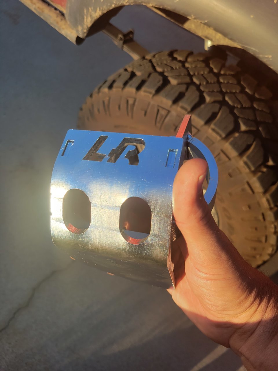

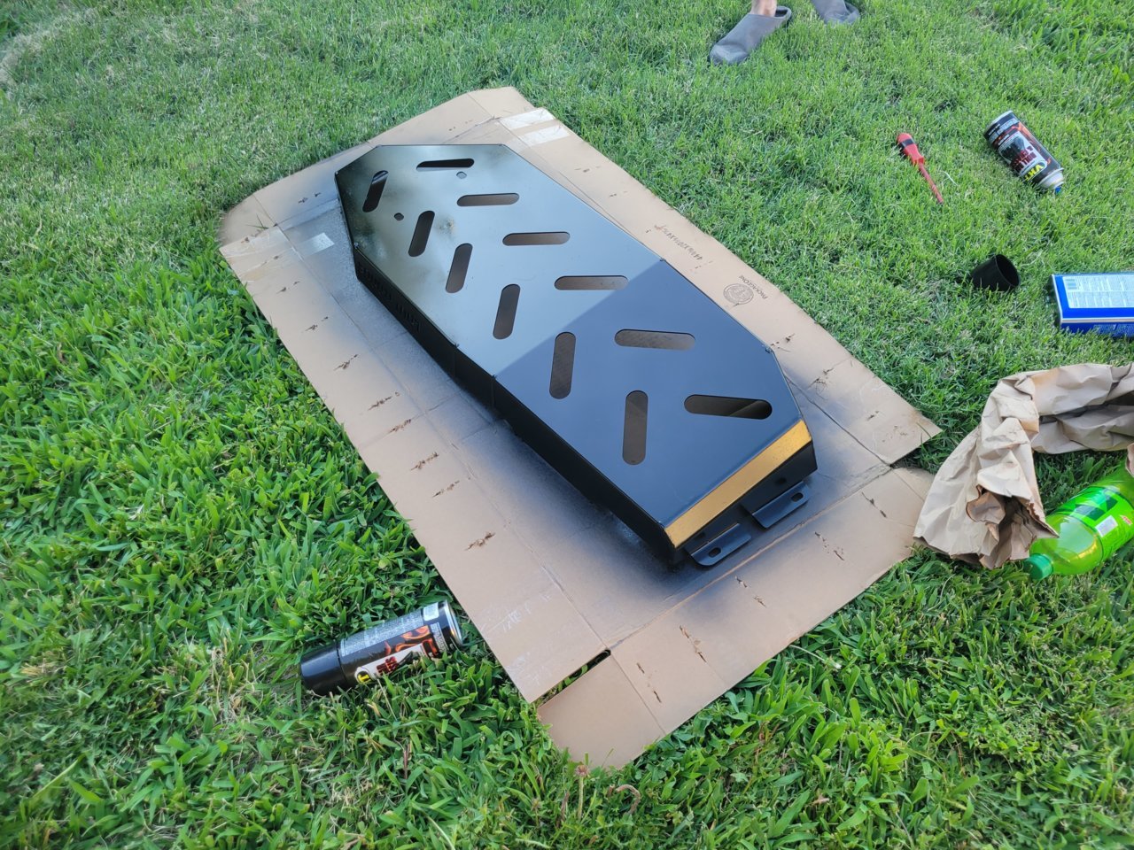

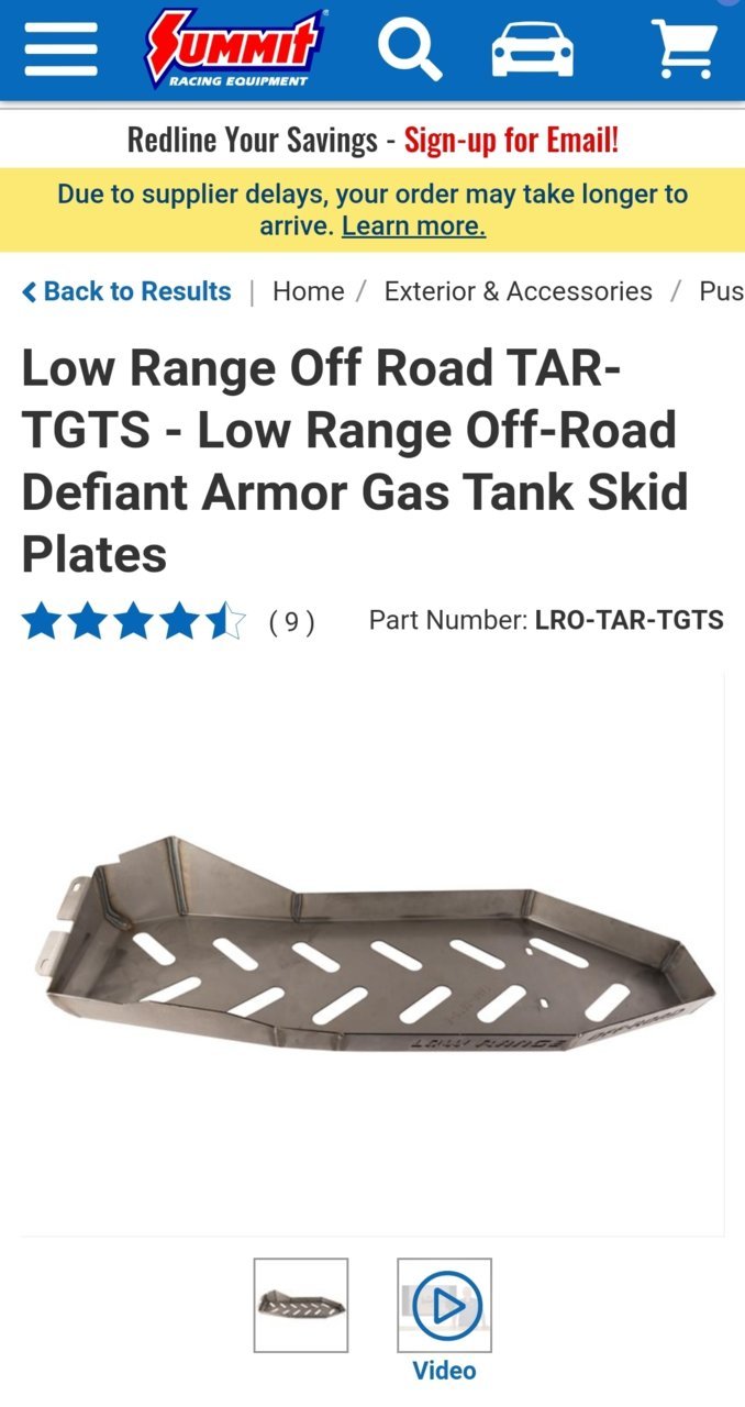

    Gas tank skid and elocker motor guard are here :thumbsup:
    Getting the paint on the gas tank skid tonight so we can put these on tomorrow after work. Not going to paint the motor guard.

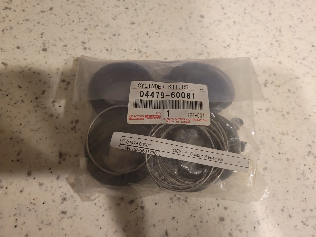

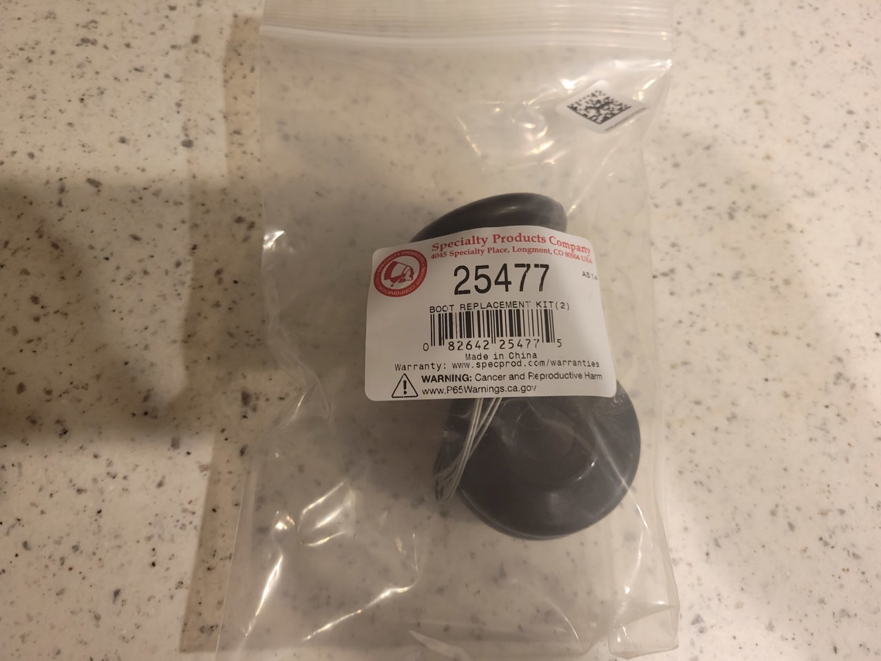

    Ordered and recieved:
    New dust boots for the calipers.
    Boots for the Upper Ball Joints
    Picked up some rear shoes
    And I'm going to borrow a trick from some of the old schoolers. I'm going to clean the grease out of the manual hubs and start using some high quality PTFE spray grease instead. Less likely to collect grime and will hopefully solve the pgantom squeeking I can't seem to find.
    Looks pretty obvious what I'll be doing this weekend. :rofl:

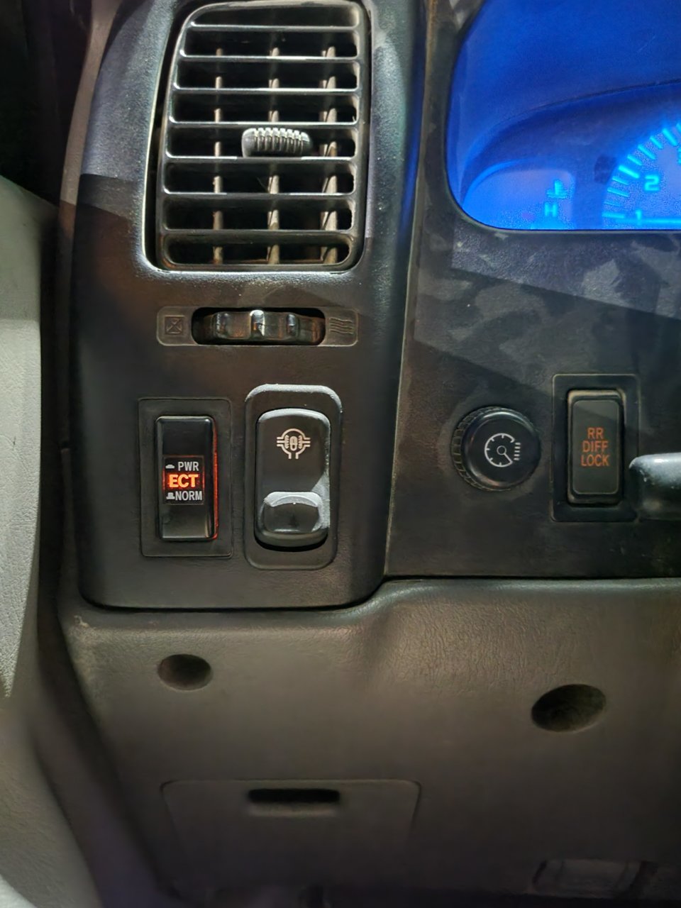

    Wired up the front locker

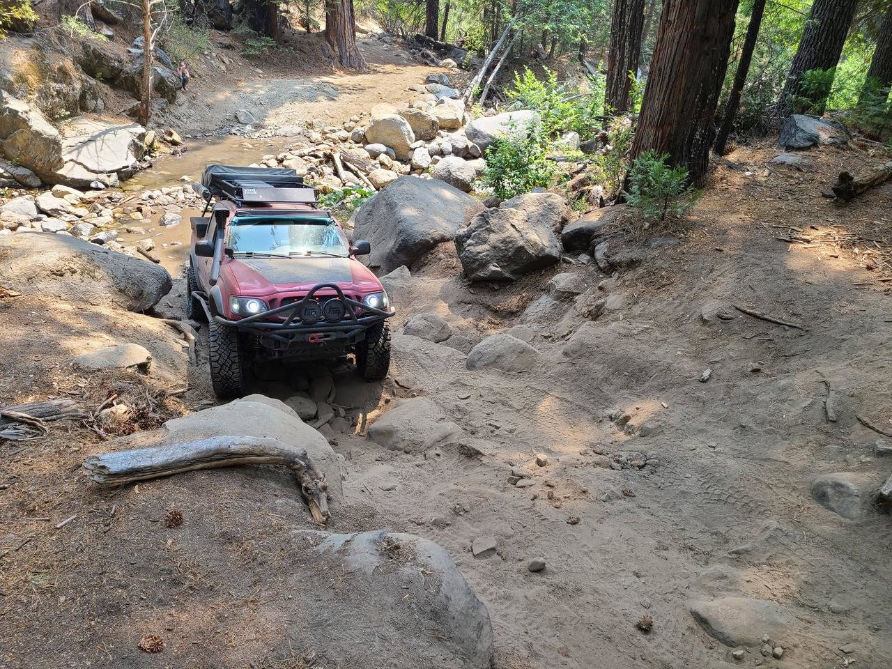

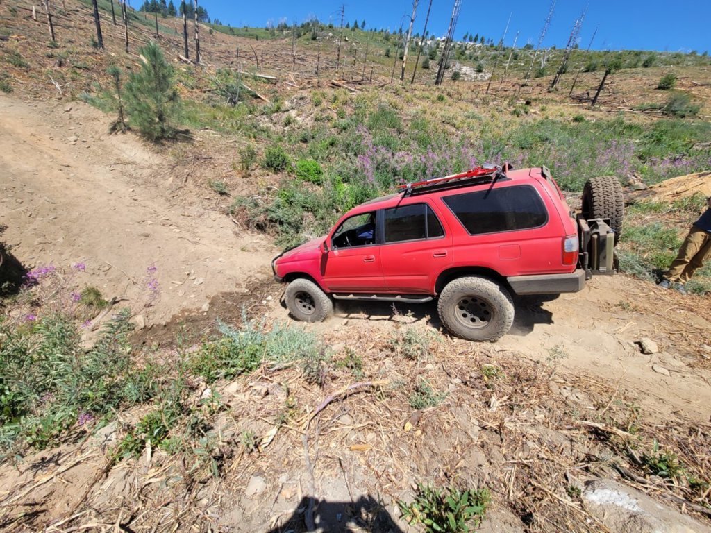

    This passed weekend we did a day trip... started the break in on the front diff... and had some fun in the process.
    20210801_104830.jpg Resized_20210801_125212.jpg Resized_20210801_111915.jpg Resized_20210801_112757.jpg IMG_1063.jpg 20210801_165333 (1).jpg 20210801_162552.jpg 20210801_115334.jpg 20210801_181743.jpg Resized_20210801_114949.jpg Resized_20210801_195355.jpg

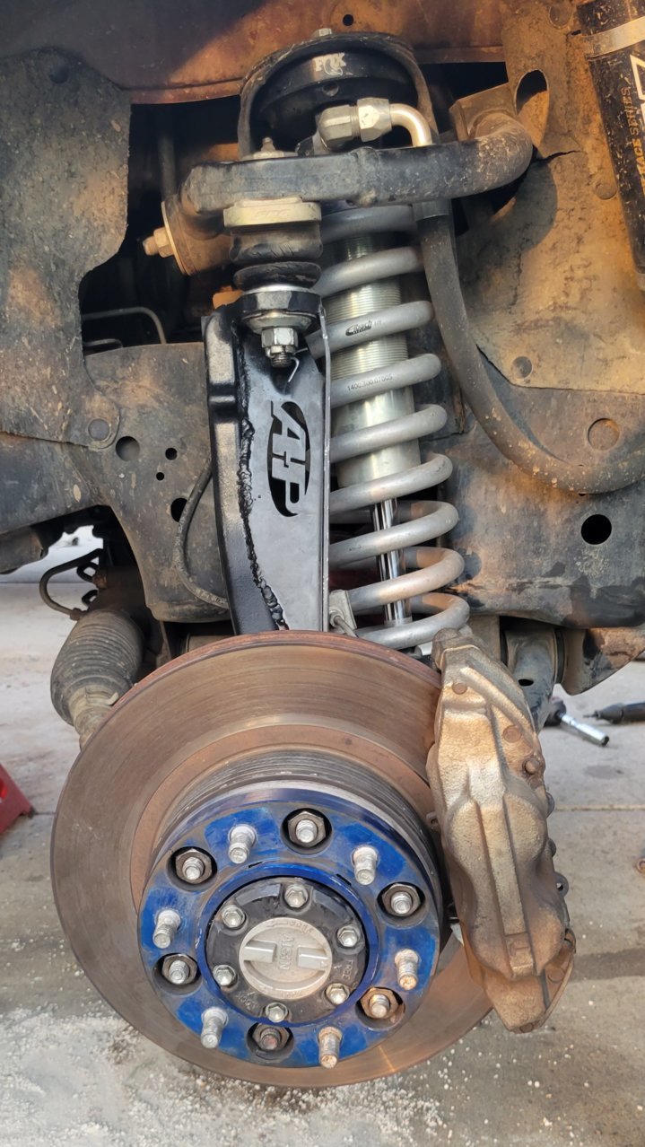

    Replaced:
    Front brake piston boots
    SPC upper ball joint boots
    EDIT *** For the record, grease guns, are fucking stupid. I hate them.
    Cleaned:
    Cleaned manual hub bodies, and lubed with PTFE lube instead of grease
    Fixed:
    Both of the hub end dust covers on my CVs were a bit out of shape. Fixed them and greased where they come close to the dust covers on the back of the hubs.
    Chasing a wheel speed squeek that is driving me nuts.
    Thought it was brake pads... replaced, nope.
    Thought it was a wheel bearing... replaced, nope.
    Hopefully something I did today fixes it, or I'm stumped.
