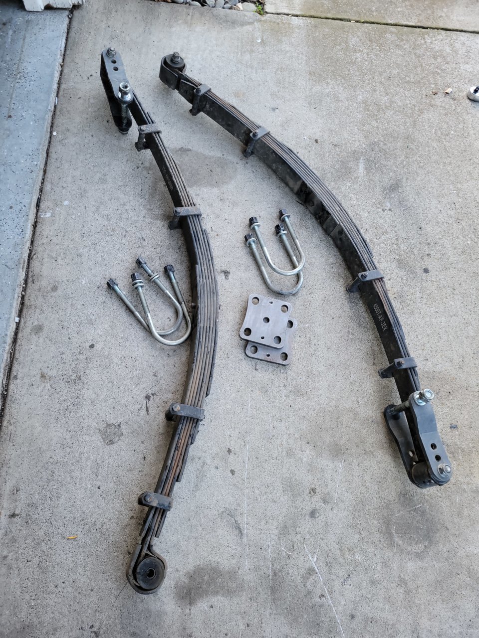

    Alcans are installed. Wow, what a difference. This should fix my ride height issue 100%
    Too dark for pictures, I'll take a couple in the morning.

    Curious on the new stance with the alcans.
    How's the ride?
    what ride height issue were you having

    Don't know how they ride yet. Have too much taken apart to drive it tonight.
    The ride height issue was the Expos sagged too much with my weight. I also never liked the fact the second spring didn't meet the main spring eye. THAT is where they sagged the most.
    From unloaded to loaded with what I carry normally... Roof top tent and rack, tools, tool boxes... the weight dropped the rear 4 inches.
    For someone who doesn't carry much weight, these are probably great. But my load out weight is close to 6K. The Expos weren't enough.

    Yea I'm sure the Alcans will do the trick for you. Mostly curious about the ride height with the 4" spec.
    I've had a similar experience with my Dakars. Don't drop too much loaded, but would blow through all the travel at any bump in the road when loaded down. 6k would def be too much for them though. I'm 5160 loaded. I've got a set of alcans on order to replace them

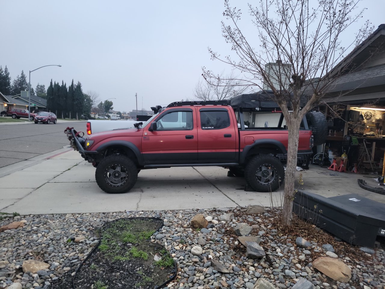

  13. Dec 19, 2021 at 4:48 PM
    #693
    El Taco Diablo
    El Taco Diablo [OP] Professional Pinstriper
    Nov 6, 2017
    #235223
    13,979
    Matt - KN6DZP
    Hughson, CA
    Impulse Red DC, 5vz-fe, 4wd swap, LT, dual case, F/R locked
    Just 3 tons of fun!!!
    2 inches of rake.
    With the tent, the awning, and the Hi Lift... AND 410 pounds of concrete in the bed.
    5 inches of available up travel with that load.
    THAT is where I wanted to be.
