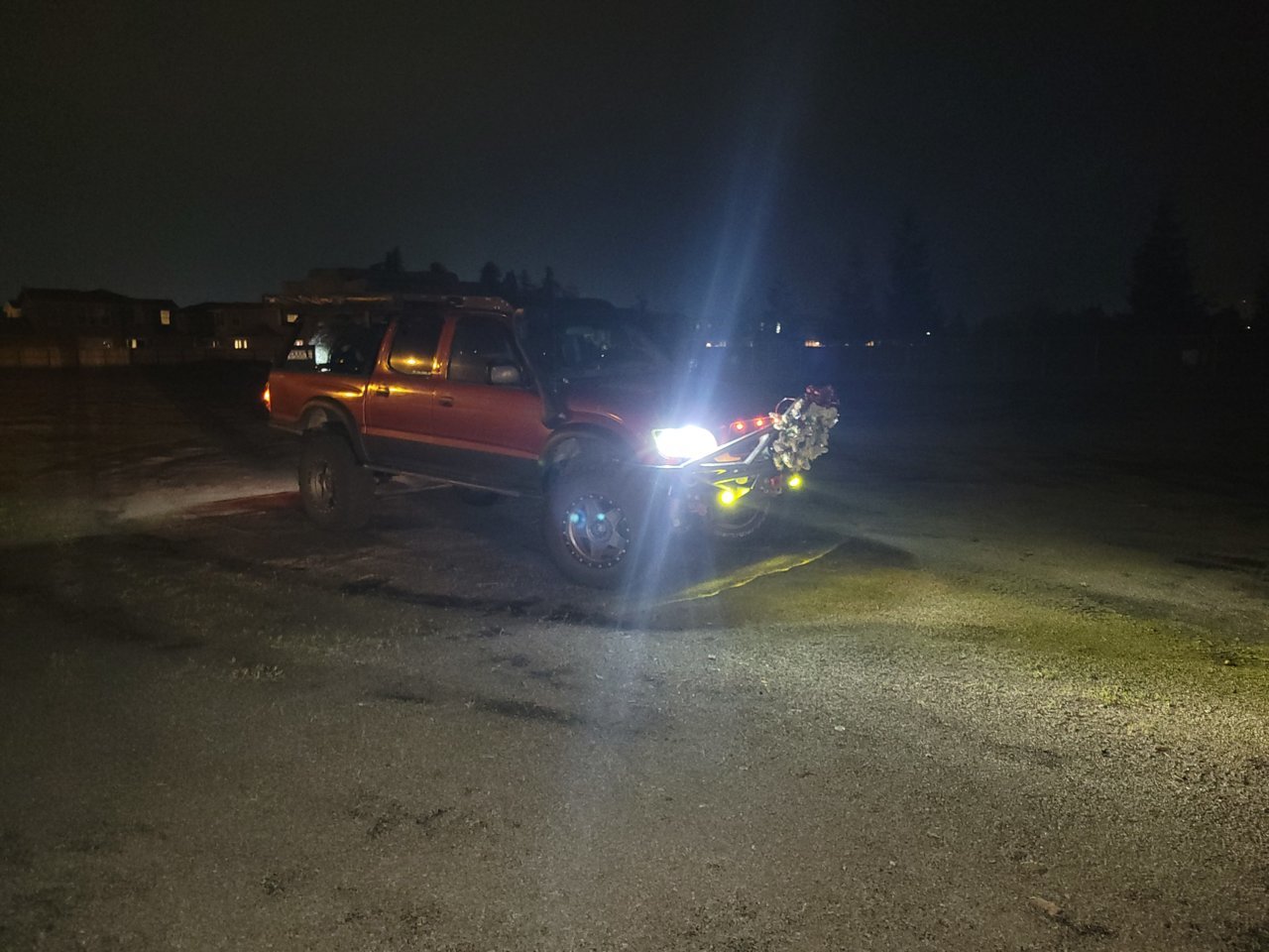

    MOAR LIGHTS
    Because why the hell not?
    Switchable from white to amber :thumbsup:

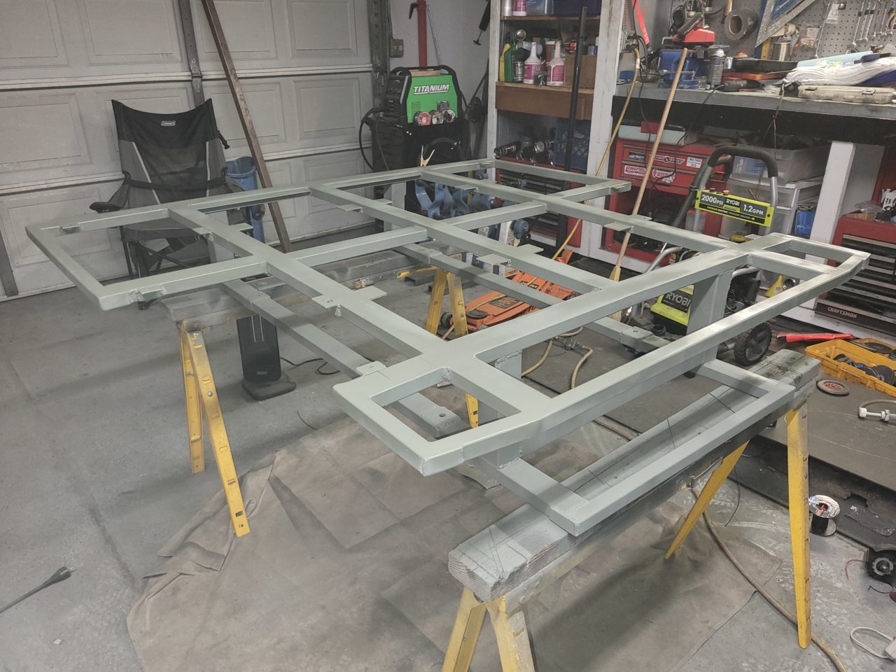

    Bed rack got some primer.

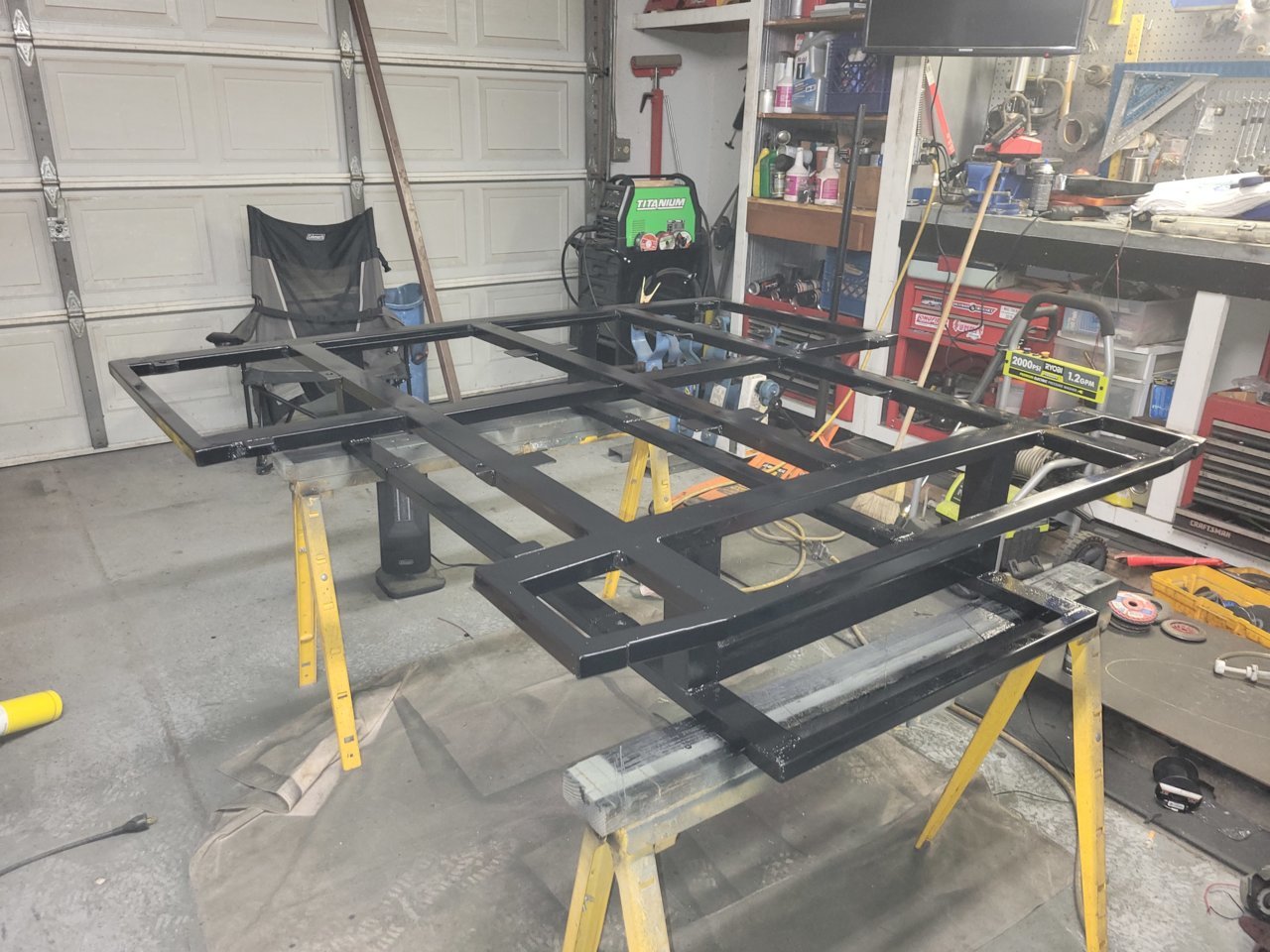

    And paint

    How do you switch between amber and white lights, that's a pretty cool feature. Are these the ones you used to fill the holes in your bumper?

    Yes, the fogs are the filling the holes in the bumper.
    They have a yellow lead for yellow lights, and a red lead for the white. I wired them to an on-off-on switch. Up is yellow, white is down.

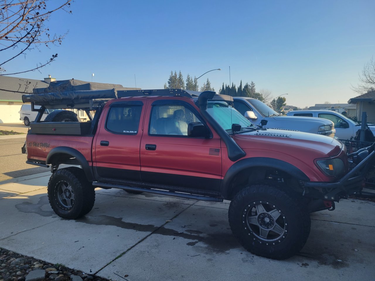

    Speaking of slick
    New decals have been applied

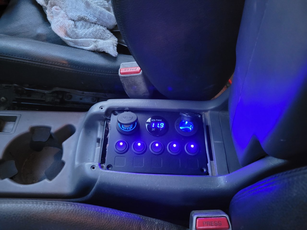

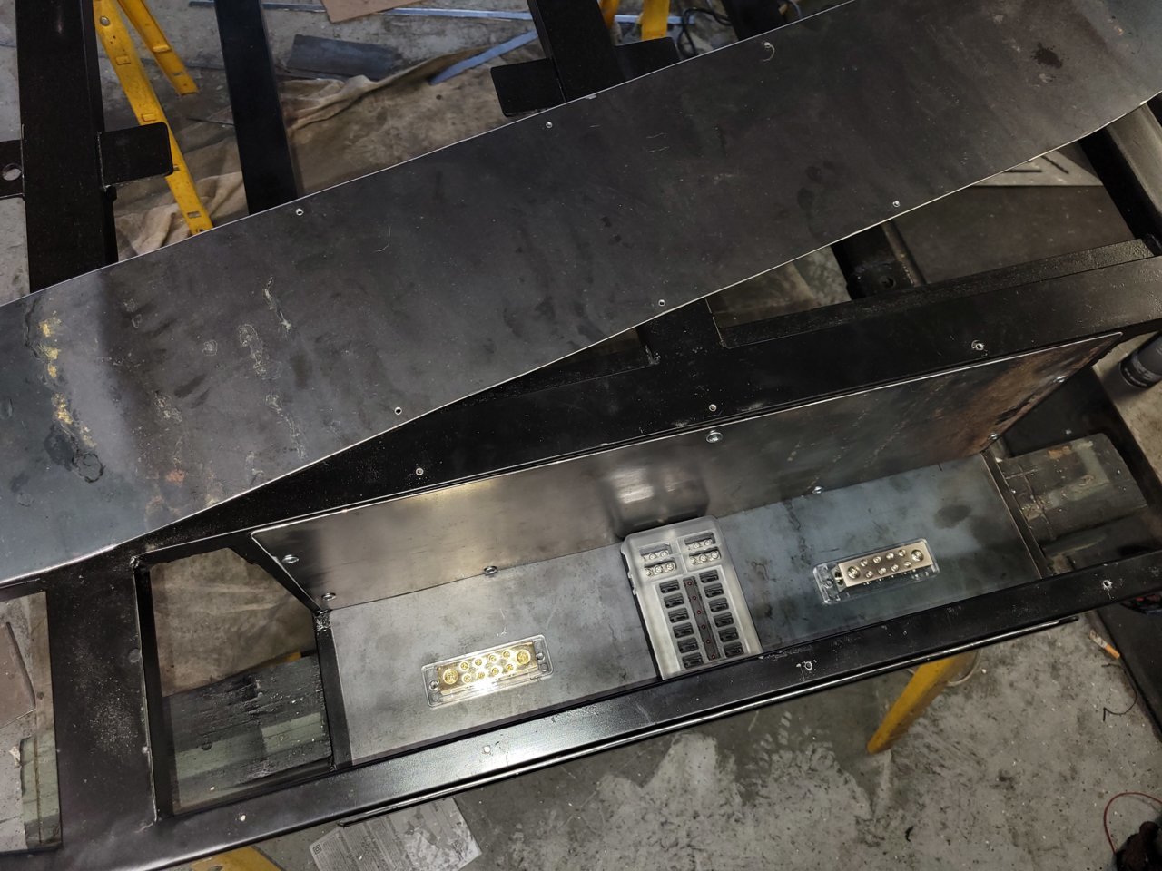

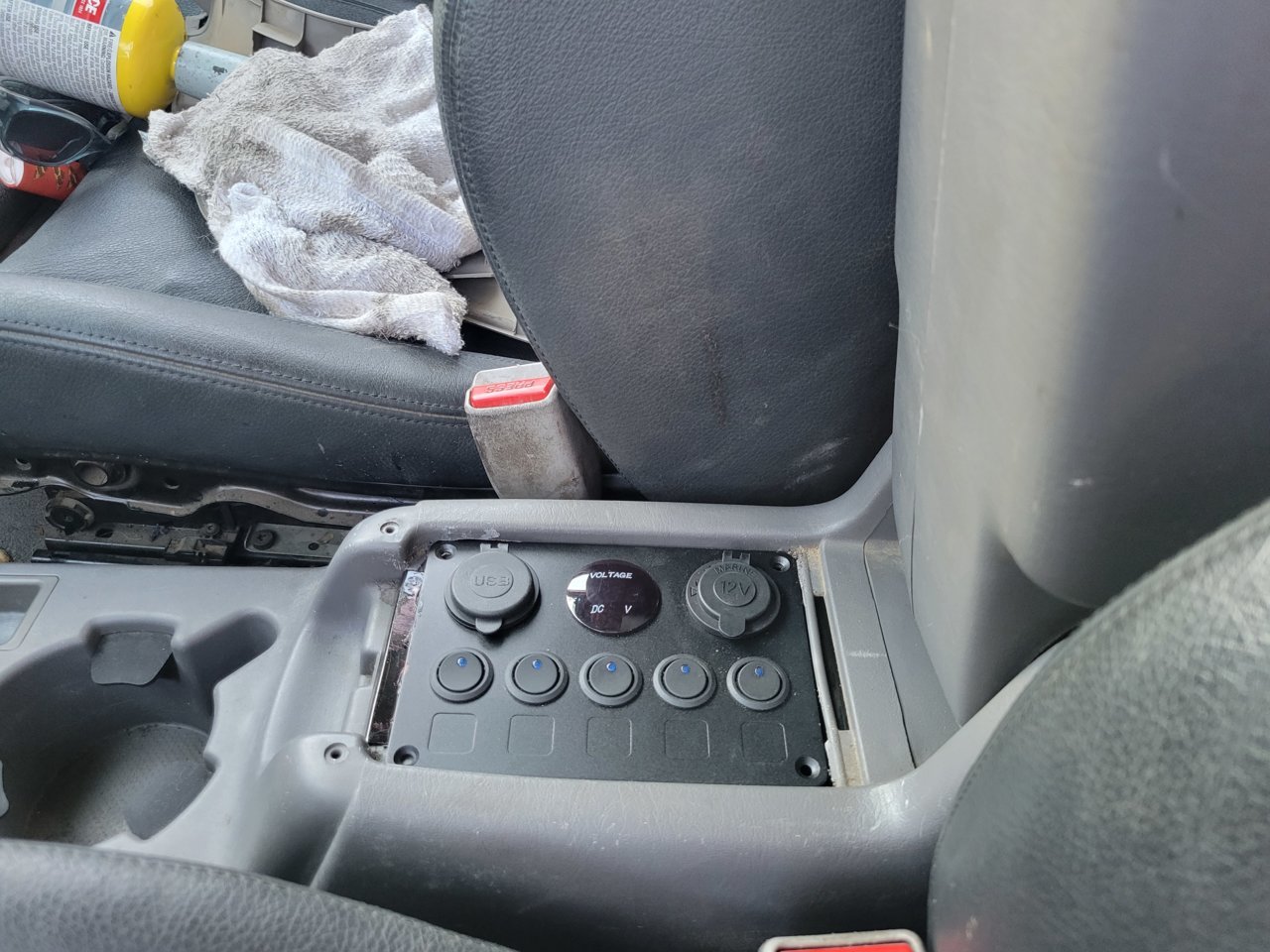

    Got the side boxes back in yesterday
    Got a ton of wiring finished. Compressor rewired, new switch panel installed.
    All of the wiring is complete. Camp lights, cargo light all work. Also ran wire in to the box on the other side to eventually install a second single lung ARB.

    It looks like a pretty good setup and I can't deny the lights will come in handy. Your setup in the console looks sweet too

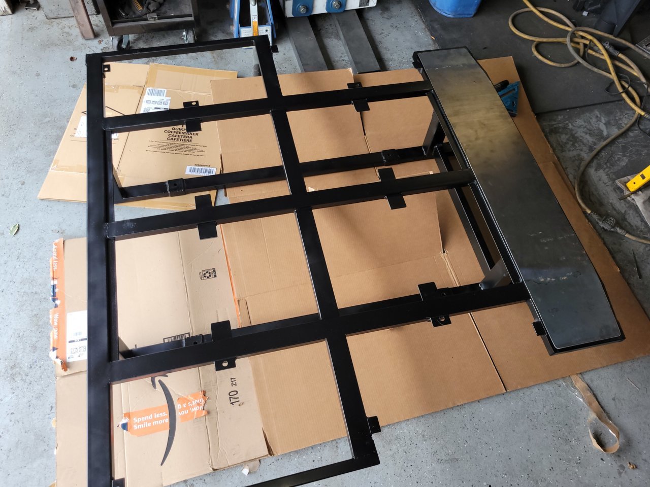

    Can finally get my tools back in order!
    Ordered the ABS sheets to finish off the bed platform today. Should have them Wednesday.
