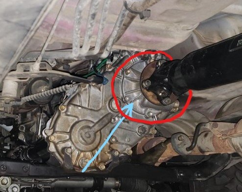

    I still may need to crack it open. I've had a squeak that is almost a wheel speed related squeak. I kept searching for the cause and was stumped. I took it to a good friend's shop and he was able to narrow it down to right at the shell that is removable (with 5 bolts) around the seal and flange where the rear drive shaft is. He put a stethoscope on the shell and was able to determine this is where the squeak is coming from.
    I ordered that shell/cover, it comes as an assembly with that seal already in it. I'm going to replace that this weekend. Hopefully it cures this squeaking, because if it doesn't, that seems to mean to me it's the rear output shaft bearing... in which case, I will need to rebuild this T-case.
    Here is the shell/cover I'm talking about.

    Gotcha.
    Yea that rear cover isn't that bad to take off and do. Should be able to do it while still on the truck no problem.

    Well... the cover was pretty simple.

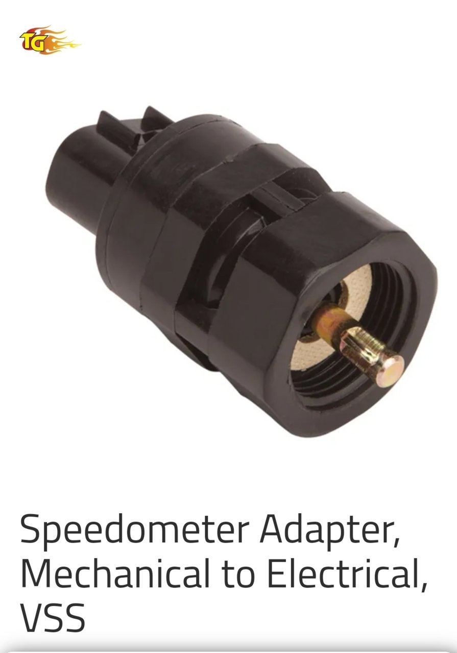

    Dropped the drive shaft and pulled the cover. Found that the output bearing is good to go. Perfectly smooth, no resistance.
    The problem was also not the cover or the seal. The problem turned out to be the Vehicle Speed Sensor adaptor I used to convert the mechanical Tcase to the Electric senor on the truck, when I did the 4wd swap.
    Ordered a new one from Trail Gear, should be here in a few days.

    Got the transfer case finished, for now untill we get the new VSS adapter. Just wont have a speedo for a few days. Test drove it, was definately the source of the squeak.
