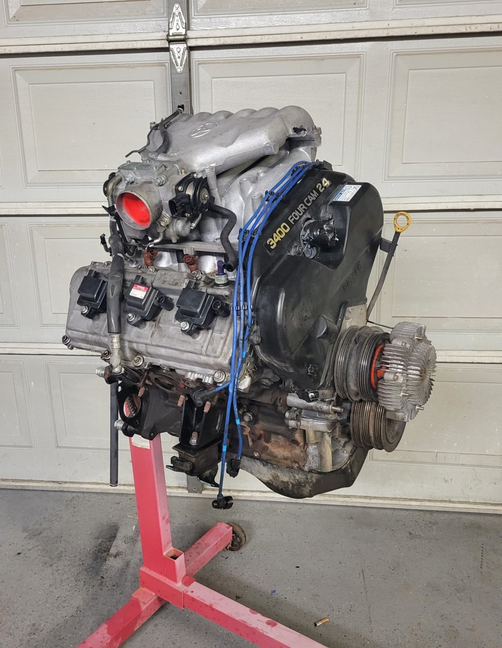

    The build it'll be for will end up being a:
    Standard cab
    5vzfe
    Auto
    Not sure if it'll be boosted. I've sent 2 unanswered emails to Ultra4, for clarification on if I can supercharge it for 4600 Class.
    The 5vzfe didn't come factory equipped with an SC, but I'm hoping the TRD SC being a factory part will give me a loop hole.

    Wondering if there is a better way to get the answer. I'm following the instructions to submit a tech question, but no answer.
    I'm ready to start tearing shit apart. But I'd really like to know what direction it's going to go, so I can start making plans on parts.
    It'll make a difference on the crank, the pistons, and more.

    For racing at constantly higher rpm the forged crank would actually be beneficial. Will a cast crank fail? Un likely at stock rpm. But it will be pretty taxed racing

    That's what I'm thinking. High (speed) RPM as well as possibly bouncing rev limiter in rocks.

    That is where the forged crank would be beneficial. My buddy endurance races and he’s had a few cast cranks fail (4 cylinder non Toyotas mind you) he started using forged crank cranks and the most recent engine has been running for 20k miles. Mostly 8-16 hr races.

    Ok... SC or not... you convinced me. Gunna have to pay the piper for a forged crank.

    I would not hesitate to run a used one if you have it checked over. Cranks on the 3vz are pretty stout.
    The 3vz cams do fit too. I had them in my heads. Still haven’t gotten one running with them yet. But maybe this summer.

    Hell... it'll be a used block in a (most likely) salvage 95.5 - 97 truck.
    95.5 - 97 because they were available with the 5vzfe.
