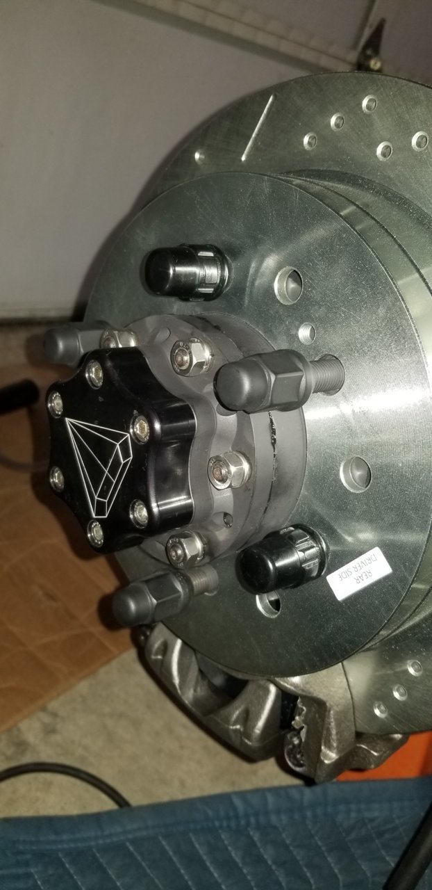

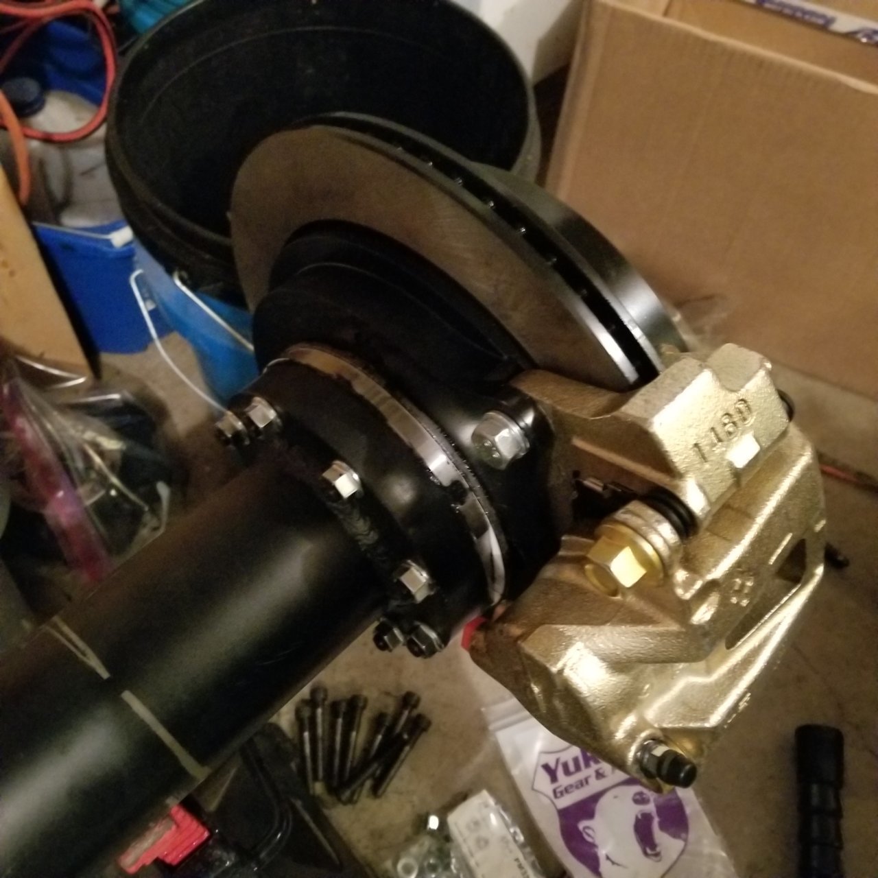

    Those flanges are what Diamond use without the ears. I run the Drotor as mentioned as it's a better overall package with the ability to run newer vented 4runner rotor/calipers with p.brake.
    Bolts on as shown in the picture. Caliper instead of having the ears on the axle flange, are milled into the Drotor that bolts on.

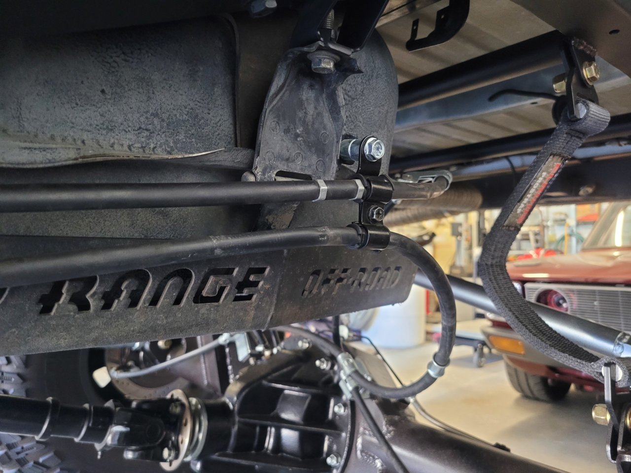

    Nice pics of those p.brake cables :thumbsup:

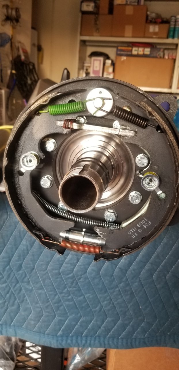

    Took me weeks and sh1t ton of stress to figure how to "make" it function. Bought a bunch of parts and stuff just to scrap it. But in the end, I went back with all toyota crap.
