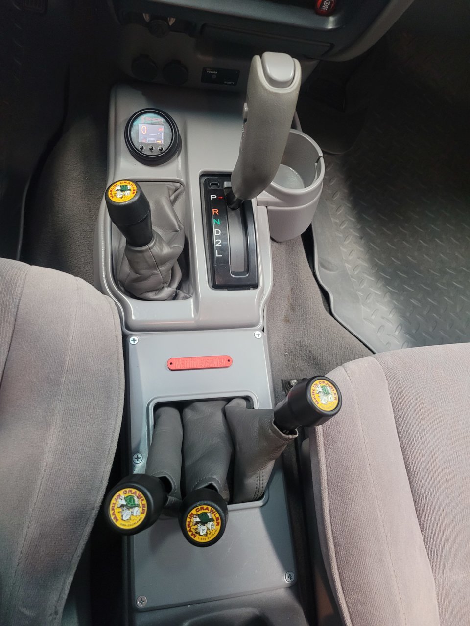

    Got any pics of the Daves ORS triple sticks? I haven't been very impressed with the RAD ones so far.

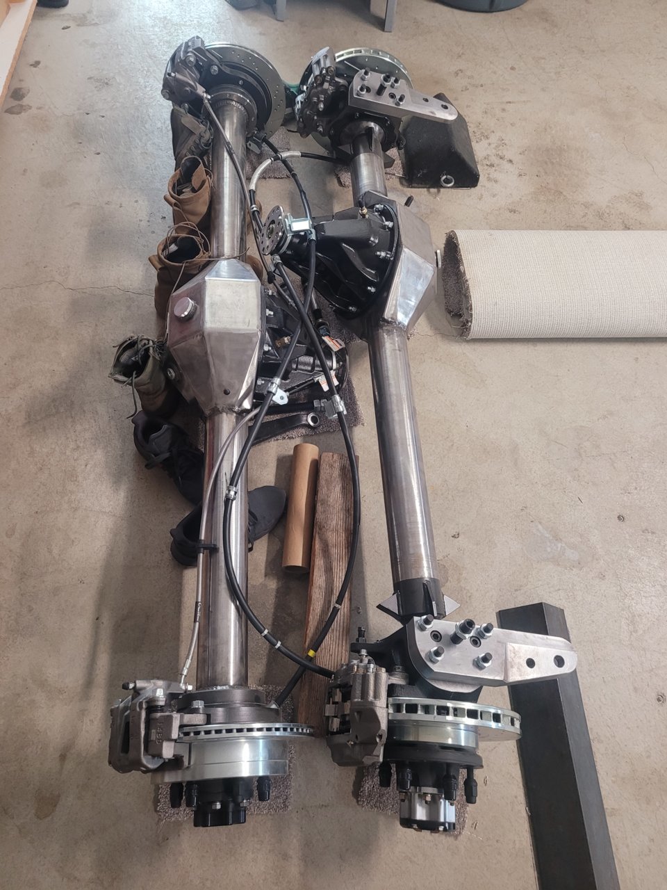

    Ya, Front Range quoted me $350+ on shipping. But that may have been factoring in the weight of the 3rd member.
    I am starting to consider having them build the housing with the flanges and do the D-rotor kit. I want to do some more investigating and see if I could possibly trim the Ruff Stuff truss to fit the Diamond housing. (I may be bing nit picky with that, but if I'm going to spend a few grand on an axle, by god, I want an f'n truss :rofl:)
    100% for sure will be full float. I'm done doing the rear axle bearing replacements every year. My truck weighs A LOT.

    Ah ya a third member makes sense why it would be higher. Those are heavy SOBs.
    I looked into a ruffstuff one and a TG builder housing, but didn't want to go through the hassle of cutting the housing and possibly messing it up. Not to mention welding the ends on correctly.
    3/8" wall 3.5 tubing is way more than enough beef and adding a truss will just be adding more weight with not much benefit other than looks I guess.
    Any idea what it weighs these days?

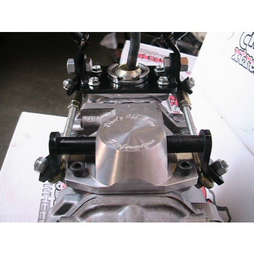

    Dave's offroad performance, my bad. Not Dave ORS.
    I don't have any pictures but a buddy of my had Dave's triple stick in his tacoma years ago. I like his designed more than RAD. No major deformation of the tunnel needed because it's designed with tight clearance in mind.
    Picture shown is for an rf1a.

    Can't say for others but I would guesstimate my rear 9.5 diamond axle fully dress weighs every bit over 250lbs. The front weights more for sure because of the knuckles etc.

    Hm ya I like the design, but they both have their tradeoffs.
    Def better vertical clearance on the rear case shifter
