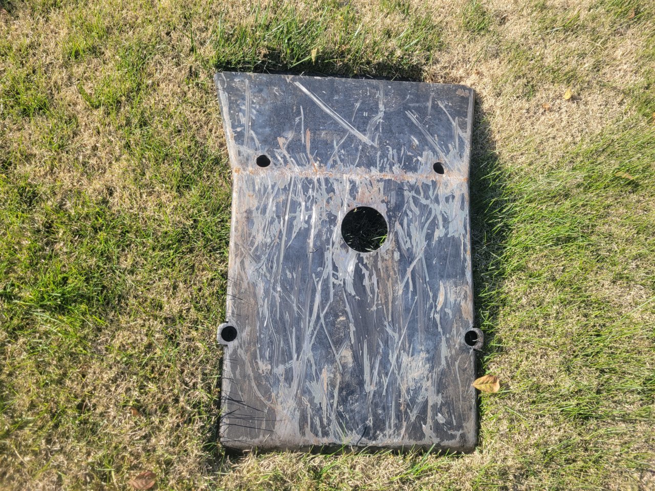

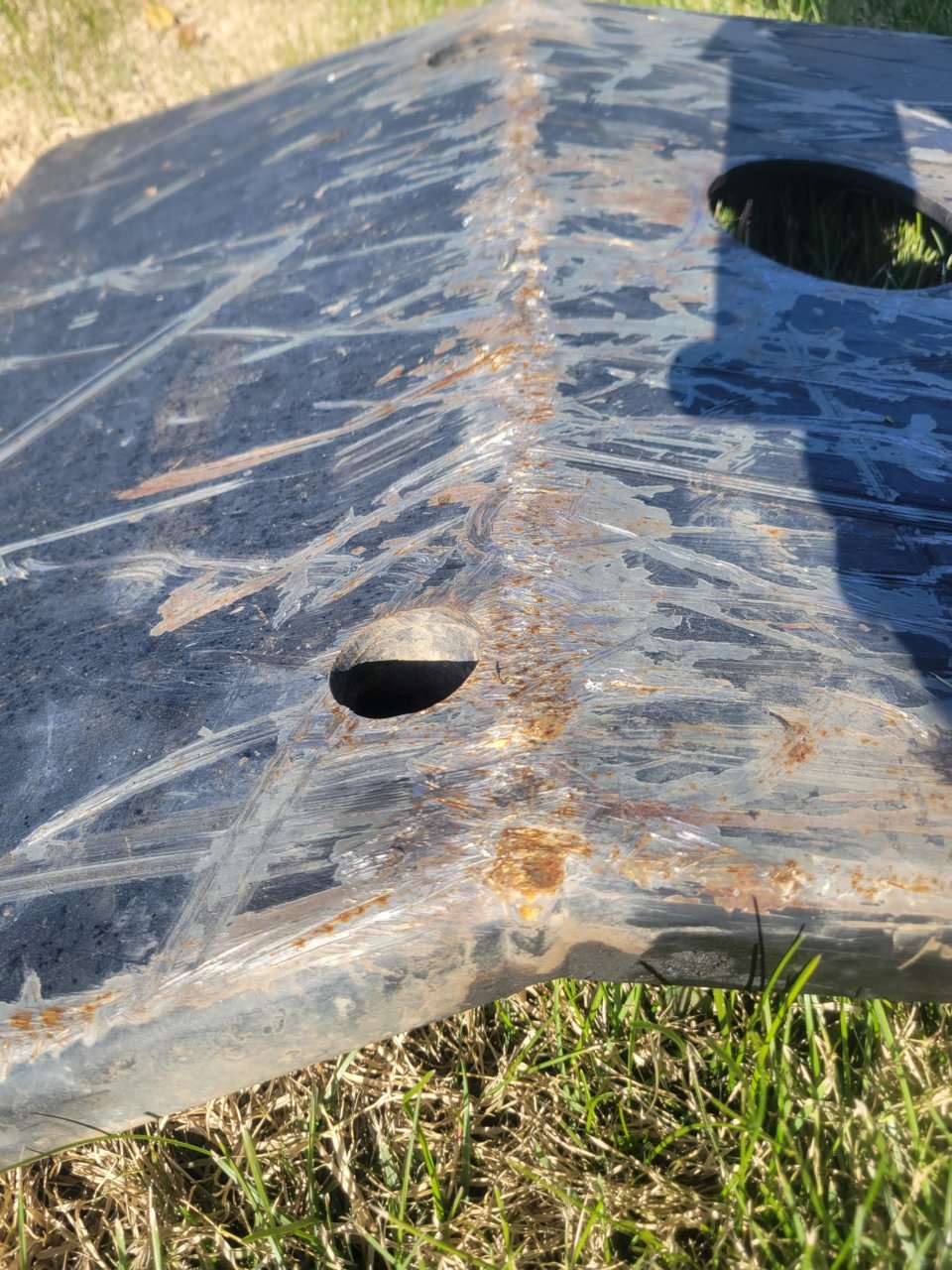

    Pulled the skid plates... I know my truck is heavy, and one of the reasons is quarter inch skid plates. Tell me I don't need quarter inch skid plates.
    This is one season. They were basically smooth and just painted last winter.

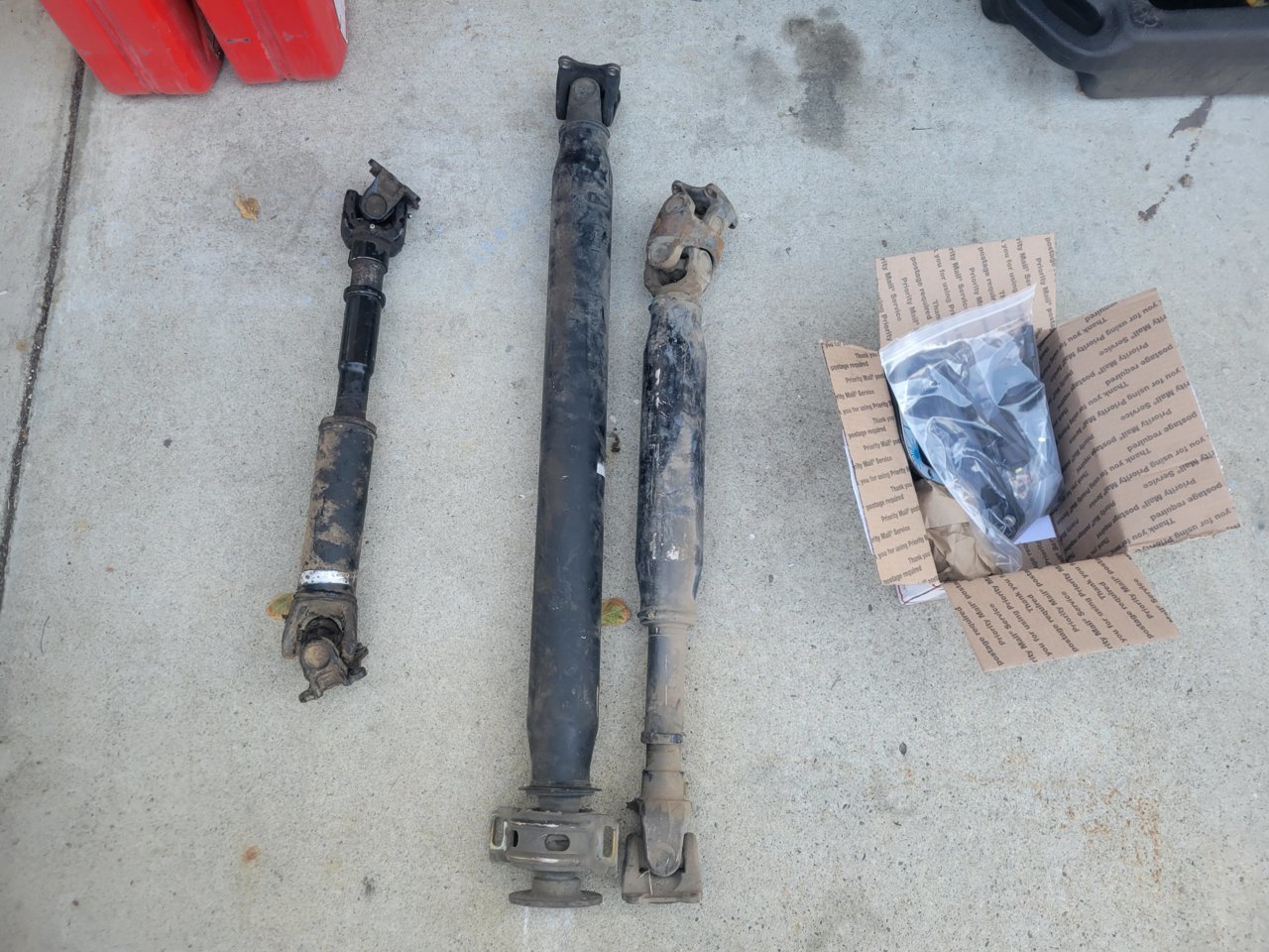

    Found the front section of my Pre-Runner rear driveline under a pile of parts. My rear section was in the truck for a spare.
    New center bearing should be arriving later today. I'll replace it before I take the DL to get cut and balanced.
    Pulled the front driveline so it can be lengthened.

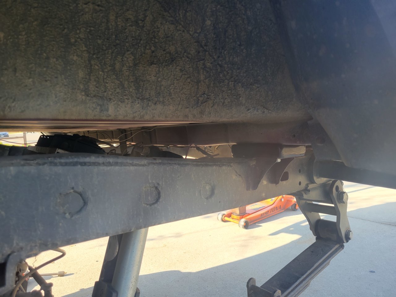

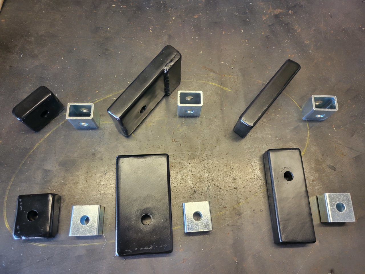

    Progress on the body lift.
    The blocks for the bed were just 1.5 x 1.5 holly squares. These will be a lot beefier and spread the weight a lot better.
    Just need to drill the holes for the bushing sleeves in the middle and front blocks, clean everything up, then weld everything together.

    So, here's the difference between the bed blocks the came with the body lift, and the one's I made.
    The bed blocks, I made, make better contact between body and frame than there was without them.
    Ran out of daylight, but the body lift is mostly done. Just need to tighten everything and install the steering shaft spacer.
    Wasn't sure what I would think about it... but actually, I don't hate it.

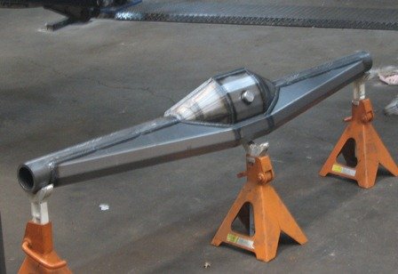

    Ruff Stuff already sent a notification that the axle housing is ready for pick up.
    That was quick! Pretty stoked.
    This is a "Ruff" idea how it will look when we start making progress. Going to have to get creative with leaf perches and U-bolts.

    Do u bolt eliminators. Don't need u bolts that way

    What about a leaf spring elimination all together package?

    Not everyone can "afford" the leaf spring elimination :bananadead:. I see plentiful of owners complaining about their $800 pack costing too much and it didn't include the shock. :crazy:
