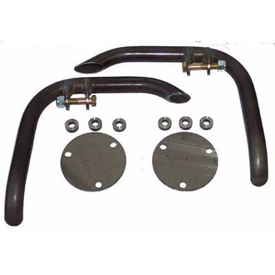

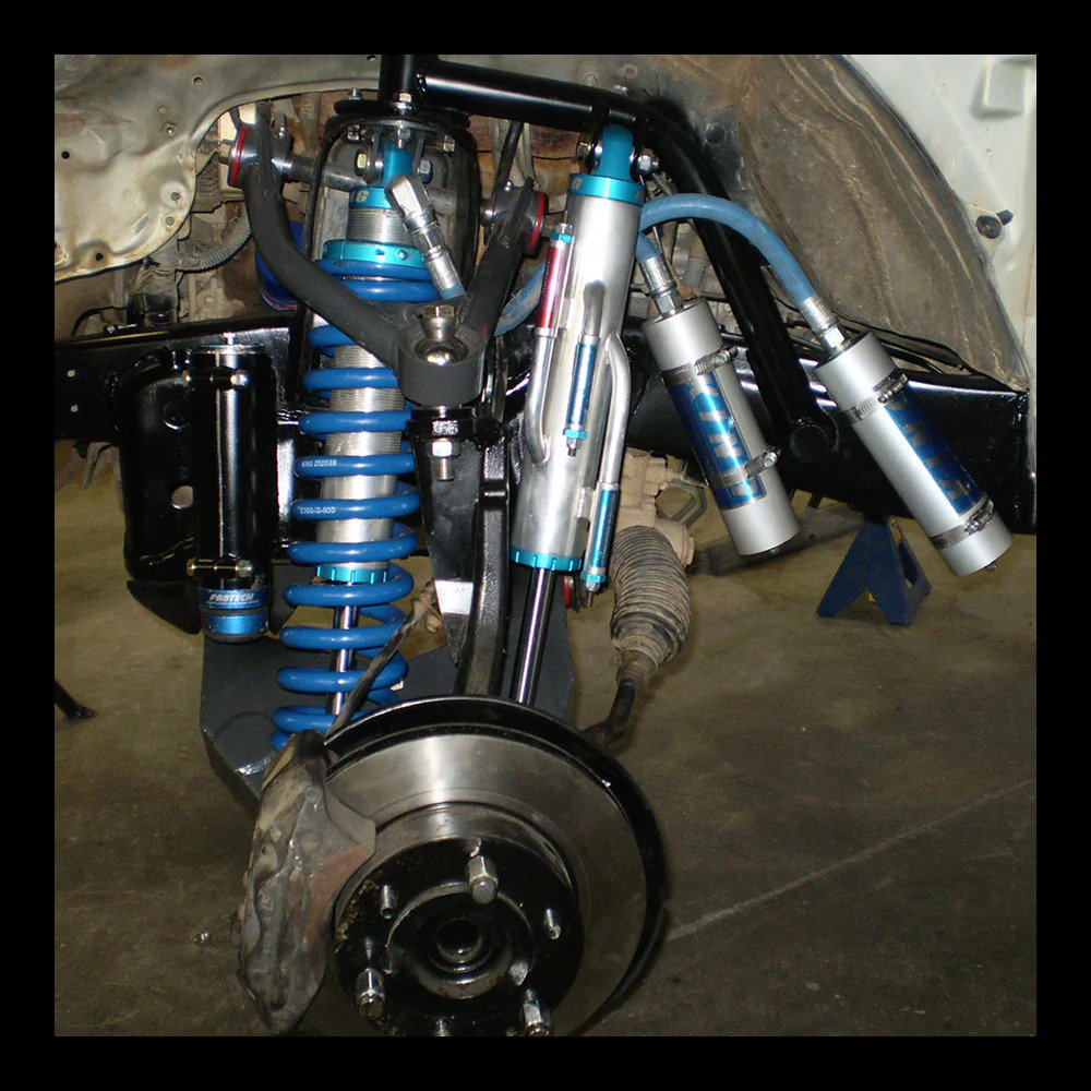

    What are some thoughts on these? (Using a secondary shock hoop as coil bucket reinforcement)
    https://jdfabrication.com/collectio...ta-tacoma-95-to-04-weld-on-bypass-shock-mount
    Or these
    https://www.polyperformance.com/total-chaos-96-04-6-lug-tacoma-00-06-tundra-secondary-shock-hoop
    Same principle either way. One is just by JD Fab the other is Total Chaos.
    Going off what happened to @theesotericone I'm wondering if this would add additional strength to the coil bucket. I'm already looking in to ways to reinforce the coil bucket while I'm in there this time, doing the LT install. I already ordered the Solo UCA double shear reinforcement. But I'm looking for other way to get in front of a catastrophe on the bucket.

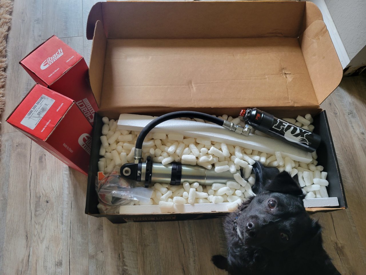

    Tucker approves of this delivery.

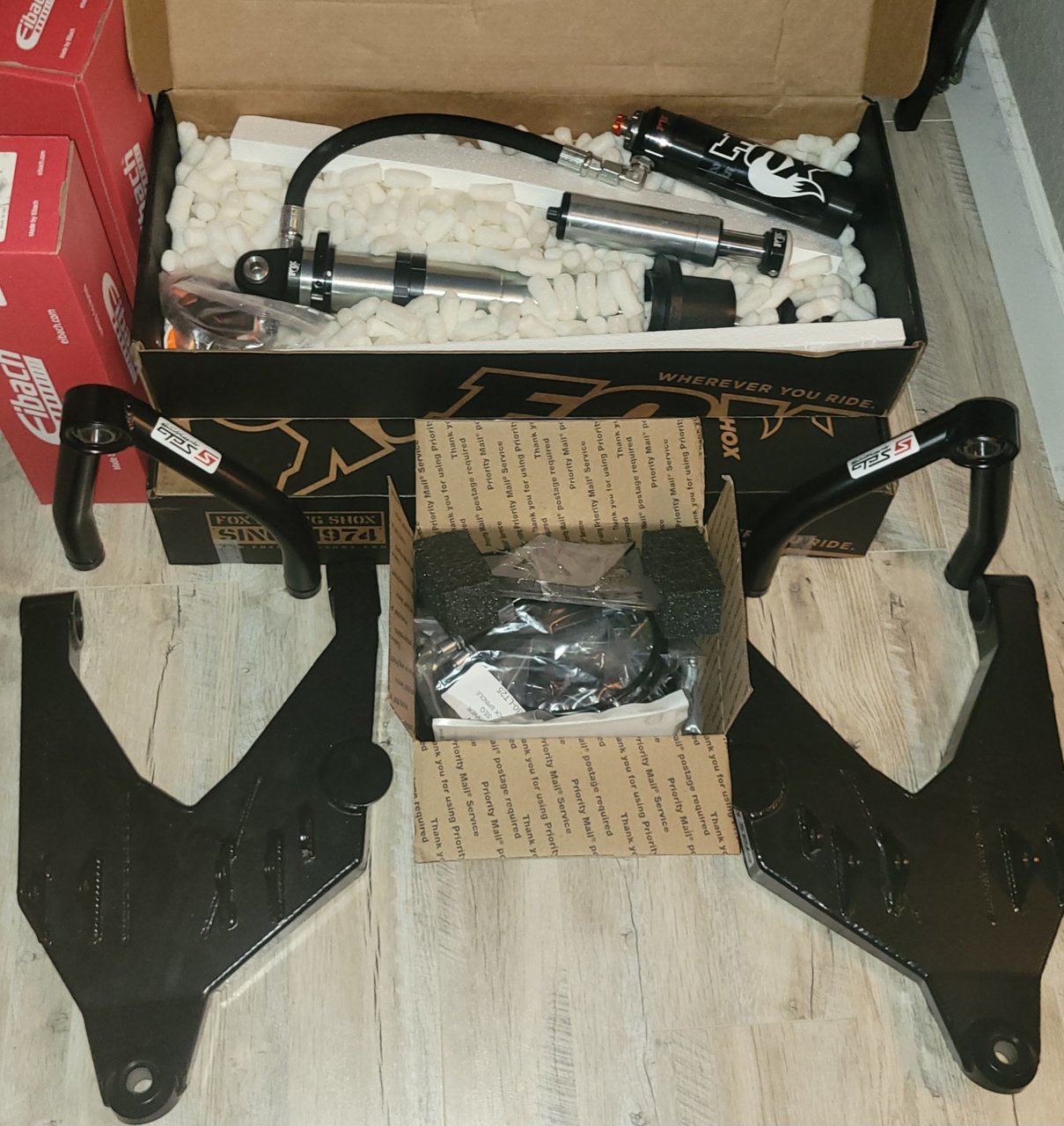

    Said fuck it, and ordered them.
    I just want to get all the welding and fab work done in one shot.
