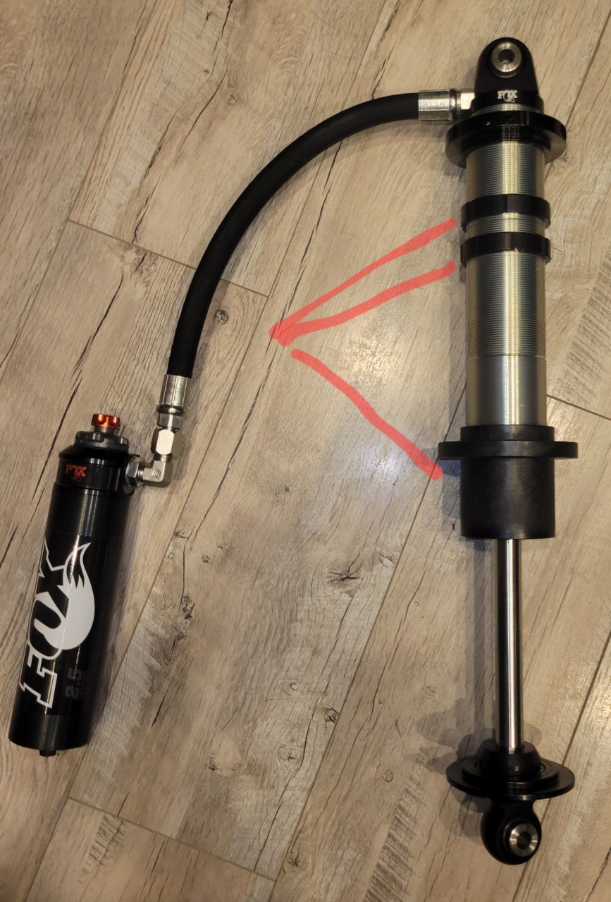

    Just 3 tons of fun!!!
    Ok... maybe this is a dumb question.
    The 3 items with red lines on them. Do I just remove these?

    Thats a spring slider right? Are you running a dual spring rate?

    I'm just running a single 16 inch 650 pound coil. (at least for now... I'm new at all this fancy shit)
    The big one is called a spring separator in the diagram, so I figure that's for if I'm running a second coil.
    The 2 small ones are threaded and I don't see them on the diagram.

    I'm assuming I lose those 2 rings and the spring separator to run it like the standard travel coil overs I'm running now.
