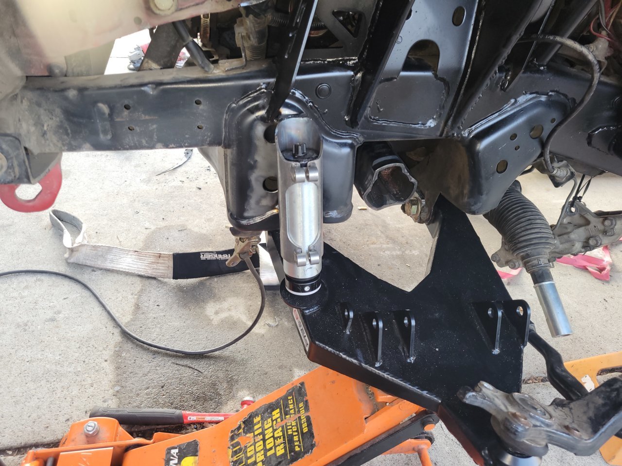

    Setting max caster with cam eliminators and cold Poly Bushings is a bitch, for sure.
    Sometimes you just have to resort to doing the stupid shit.

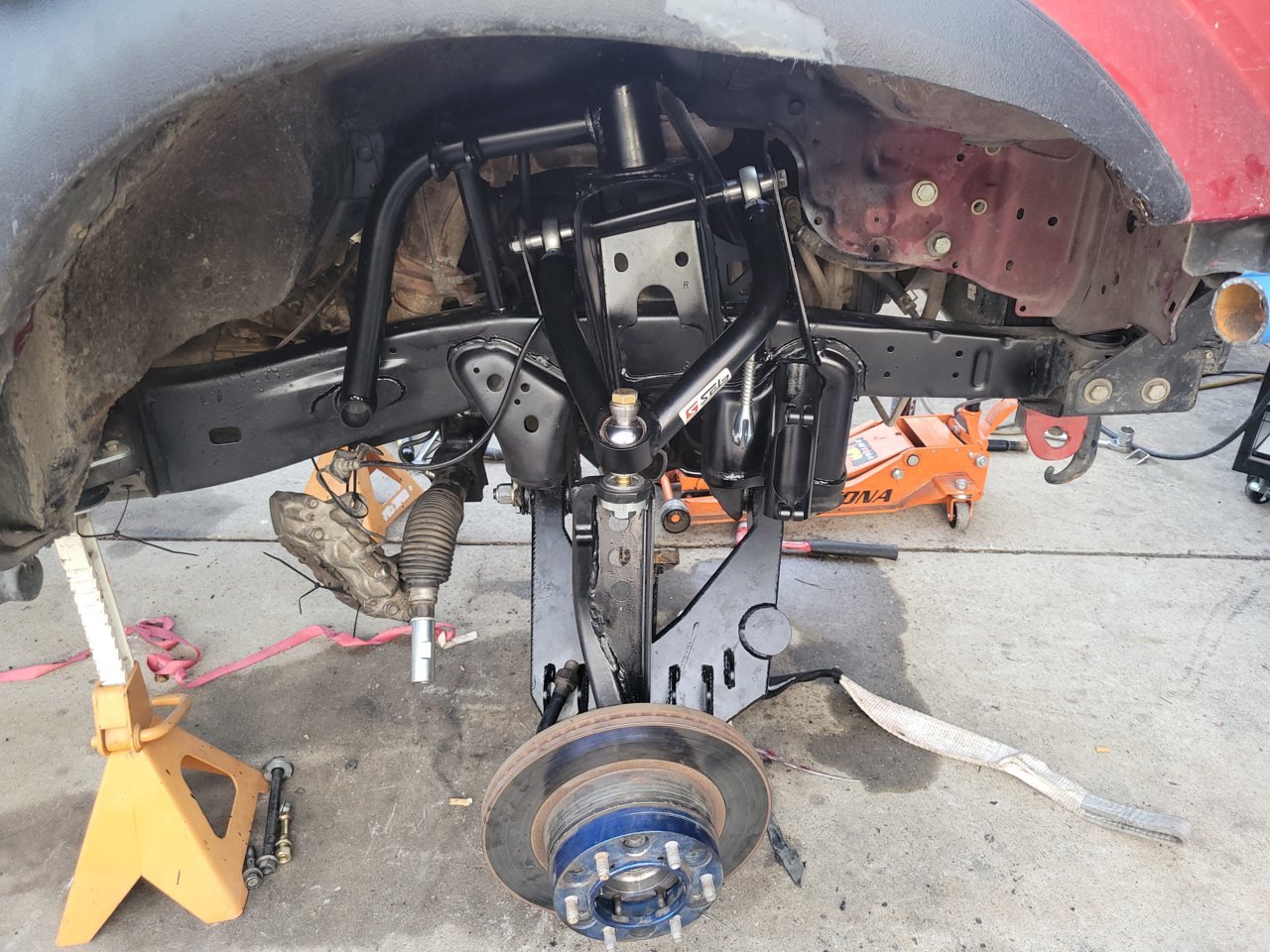

    Stuff is coming together it looks like.

    You tried 3 linking?

    Not saying LT is the only pain in the ass... just saying it's A pain in the ass.

    I guess, it could be said... this entire hobby, in general, is a pain in the ass. :rofl:
    Earlier was just a moment of frustration. I was at a stand still till I could get the LCAs adjusted forward. They would absolutely not cooperate lol
