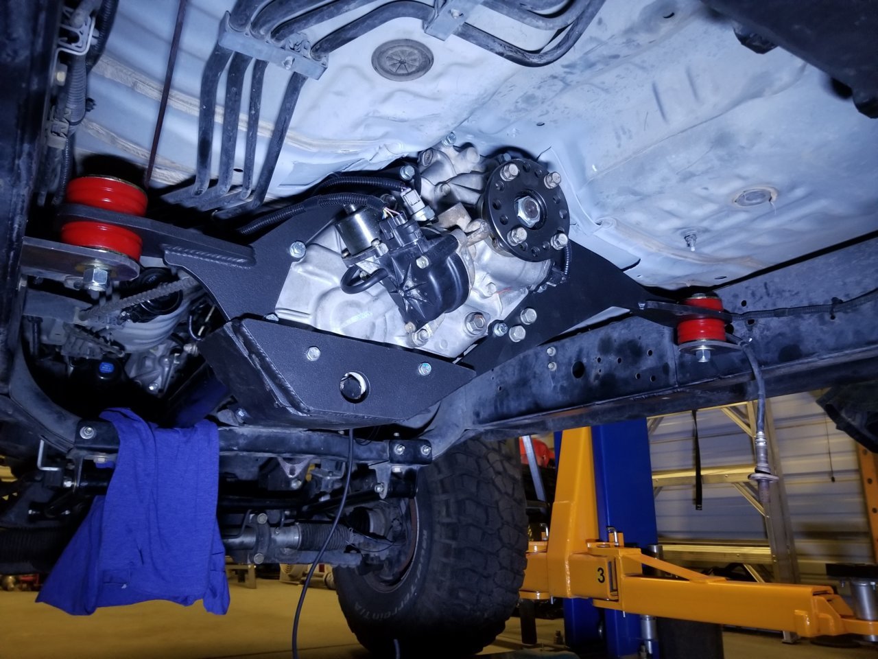

    Cool... that just simplified things.
    Next... Crossmember/skid plate
    Did you guys custom build? Use the TG skidplate?
    @foxrcing07 had the TG skid plate and didn't like it. I can see where building a custom cross member is going to end up being a project that takes a long time (like everything else at this point lol)

    If i were you, I would keep the factory and add a FROR. I hate the TG, pos is heavy but do provide belly a skid

    I'm not running a skid plate currently. It hangs down pretty low as it is, so skid plate would add to that.
    I just built a mount for the second transfer case mount off of my existing crossmember. It's in my BT.

    I looked at the FROR (my son actually has one on his 4 cyl Tacoma) but unless I'm reading it wrong, it says it doesn't work for V6.

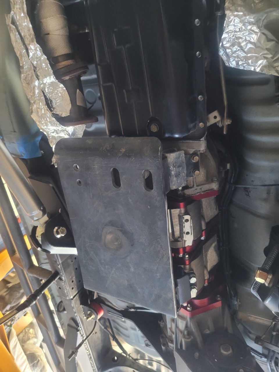

    I did this to the free TG tcase skid I got. Turned it to a skid, lol.

    Nice... looks like it allowed you to kind of lift it up in back as well... no?

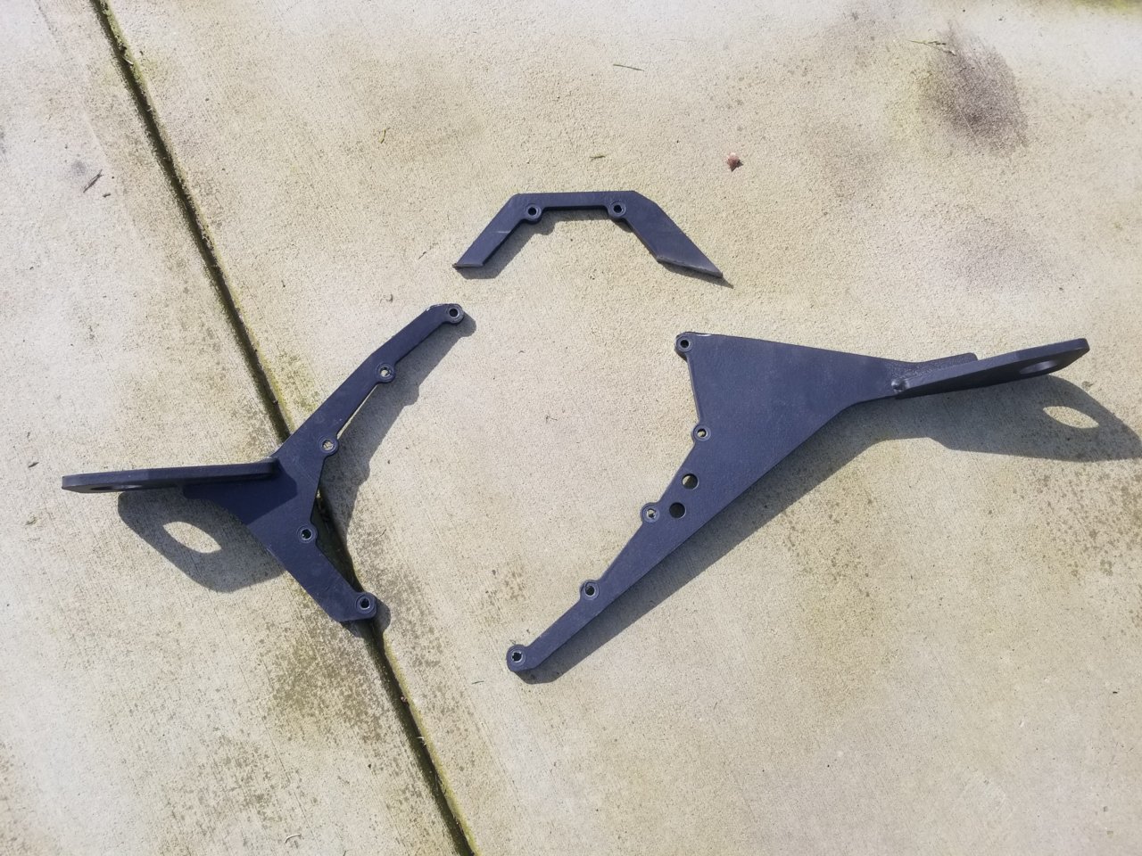

    To a certain point, yes but my setup is different from your standard dual case, lol. I shaved the factory chain case (don't have any picture) and cut the FROR xmember into 3 piece.

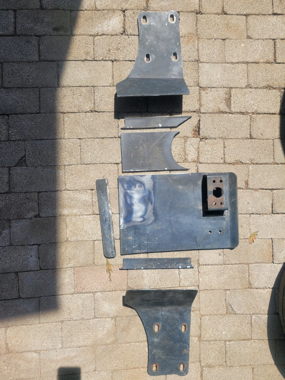

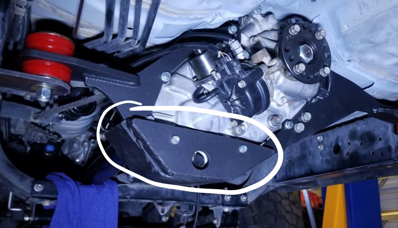

    And you built this part?

    ^ THIS is why I ended up buying the TG

    Homemade, lol

    Looks good tho :thumbsup:

    Look good in the picture, lol. Didn't even need to hole saw a hole for the tcase drain, but I was dumb before as you can see. I didn't even hole saw a hold for the oil to pour out. Haha
    Will integrate the tg skid to cover the tcase father back and built some lateral support after I finish my rear swaybar and re-do my front towers. That's not priority for me atm.
