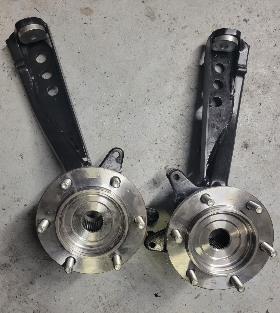

    So, I decided to just switch to ADD hubs. Pressed the manual hubs out, bearings out... pressed new bearings in, pressed the hubs in the bearings... looked down... FUCK... I didn't put the bearing retainer clip or outer dust shield on before I pressed the hub into the bearing... So, I went and bought MORE new bearings and did it all over again.
    Then I realized I don't have the bearing spacer you need for ADD hubs, because I never run ADD hubs... fortunately @foxrcing07 had them.

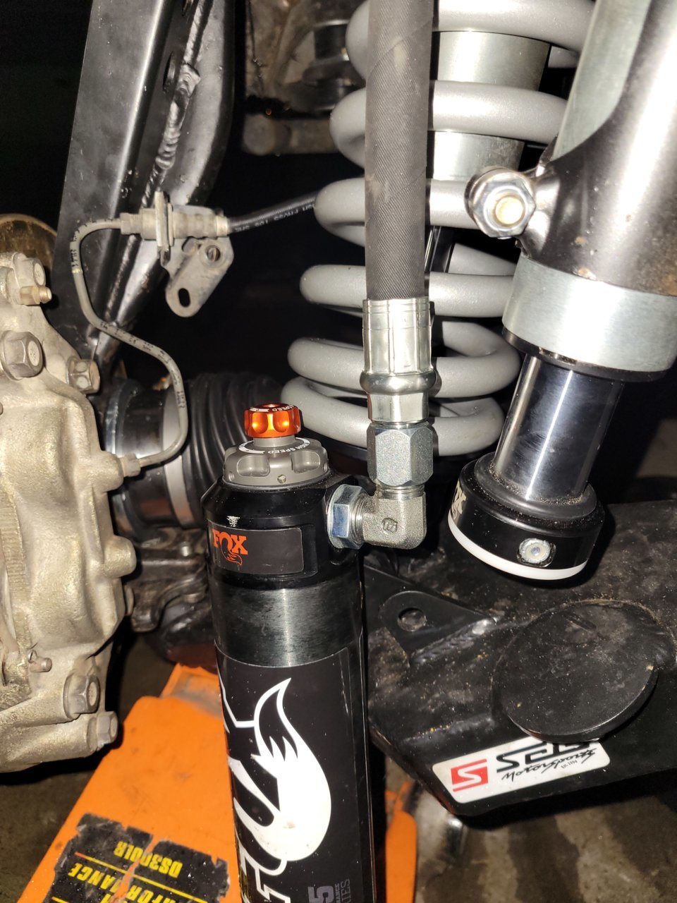

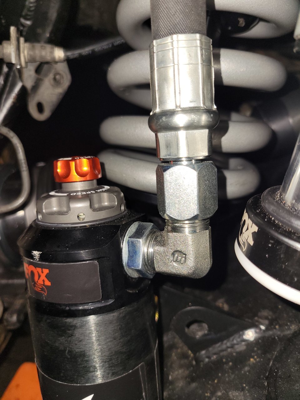

    Does this fitting look like it's the type I can adjust?
    I need the elbow to be at 180° from where it is. Meaning I need the hose to be running along side the resi when mounted instead of the way it is now. That would give me room to mount it.
    I'm not super familiar with these types of fittings.
