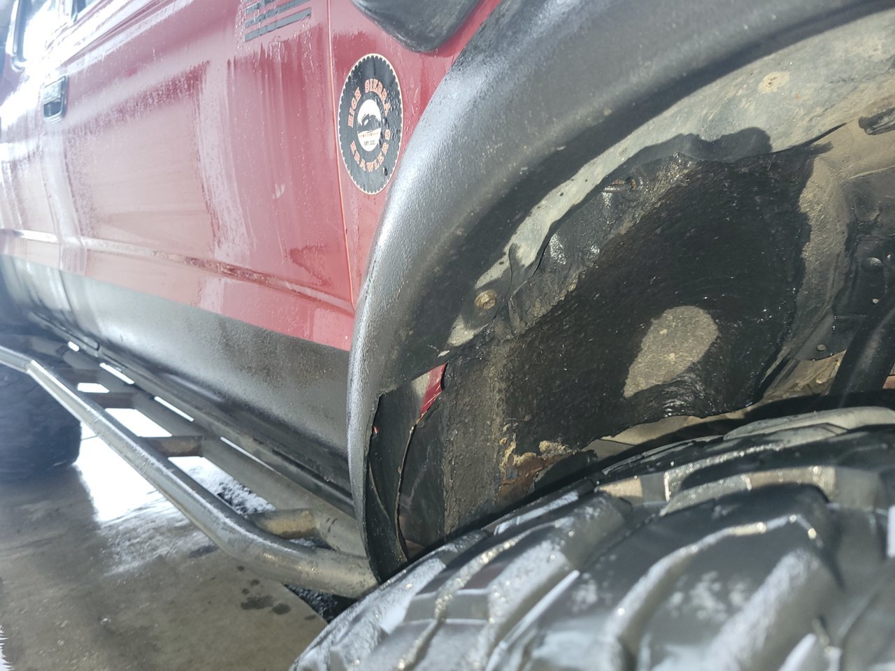

    Do you have any more pictures of how you cut your fender flares for 35s?
    It looks like you didn't have to completely gut the underside of them and we're able to keep some of the lower mounting hardware which I haven't seen anyone do before
  8. Jan 9, 2023 at 9:07 AM
    #1188
    El Taco Diablo
    El Taco Diablo [OP] Professional Pinstriper
    Nov 6, 2017
    #235223
    13,979
    Matt - KN6DZP
    Hughson, CA
    Impulse Red DC, 5vz-fe, 4wd swap, LT, dual case, F/R locked
    Just 3 tons of fun!!!
    I can try and snap some pictures if it stops raining lol.

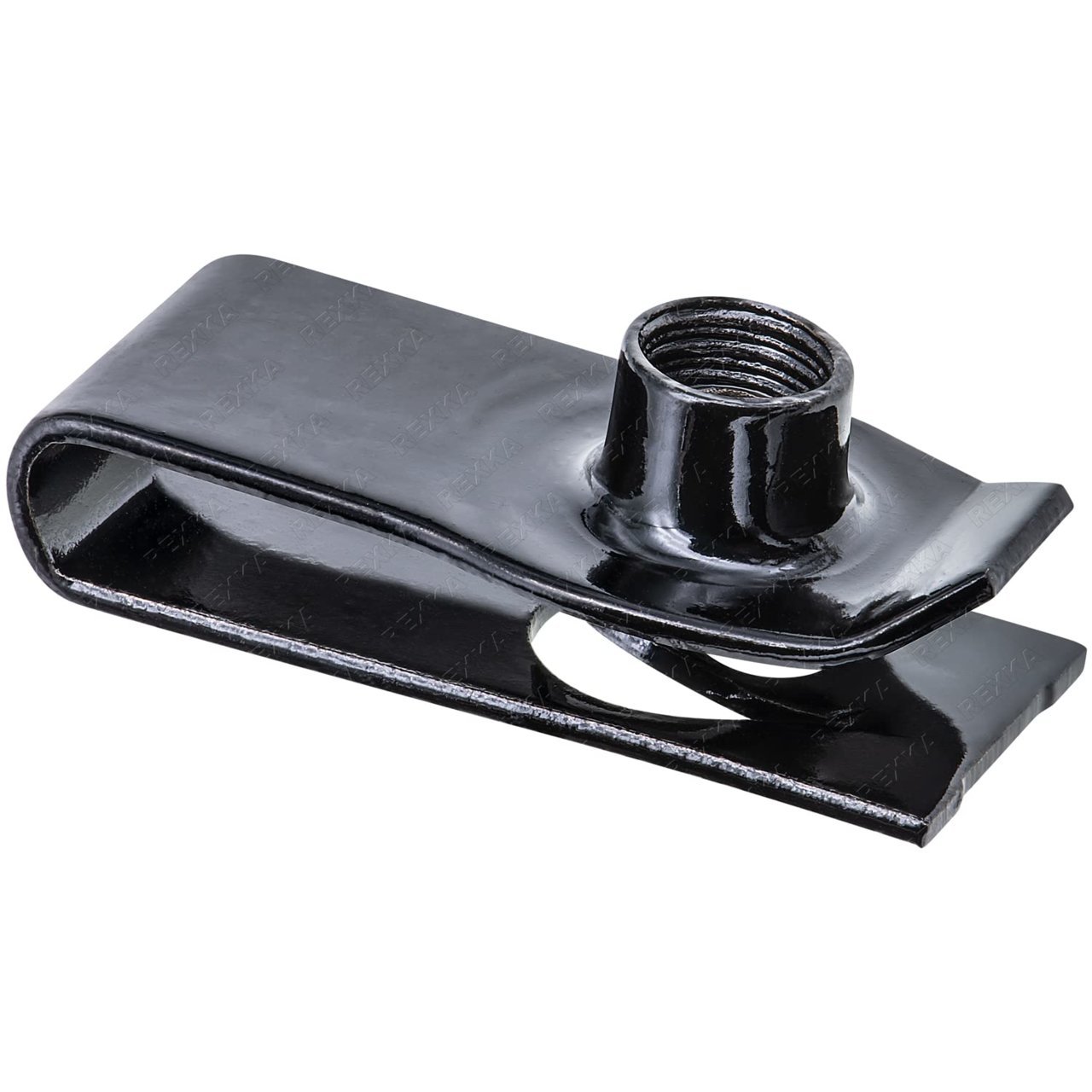

    But yes I was able to keep a lot of the mounting hardware. The front most clip had to be cut this last time to clear the 35s with LT but I just bought some of these style clips to retain the plastic fender to the metal fender (there was a bit of the tab I was able to leave on when I made my cut.
  9. Jan 9, 2023 at 9:35 AM
    #1189
    betterbuckleup
    betterbuckleup Well-Known Member
    Jun 26, 2017
    #222483
    4,795
    Ian
    Concord, CA
    2000 Tacoma SC 2.7 4x4 5spd
    Sweet. I don't have holes in my fender for the upper flare mounting like on the 01-04's so I'm curious on how much of it you were able to leave.
    Is the rear of the flare closest to the door mounted at all? I assume you had to lose those bottom two bolts that hold it on on the bottom side, when you tubbed.

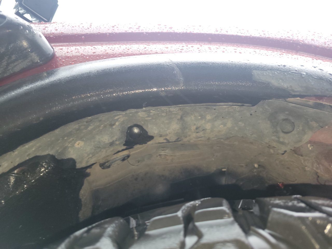

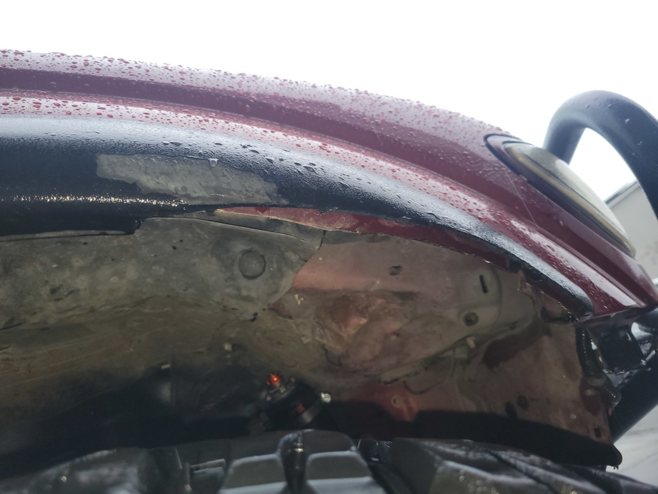

    Back - at door
    Top
    Front
  11. Jan 9, 2023 at 10:35 AM
    #1191
    betterbuckleup
    Jun 26, 2017
    #222483
    4,795
    Ian
    Concord, CA
    Awesome thanks!
