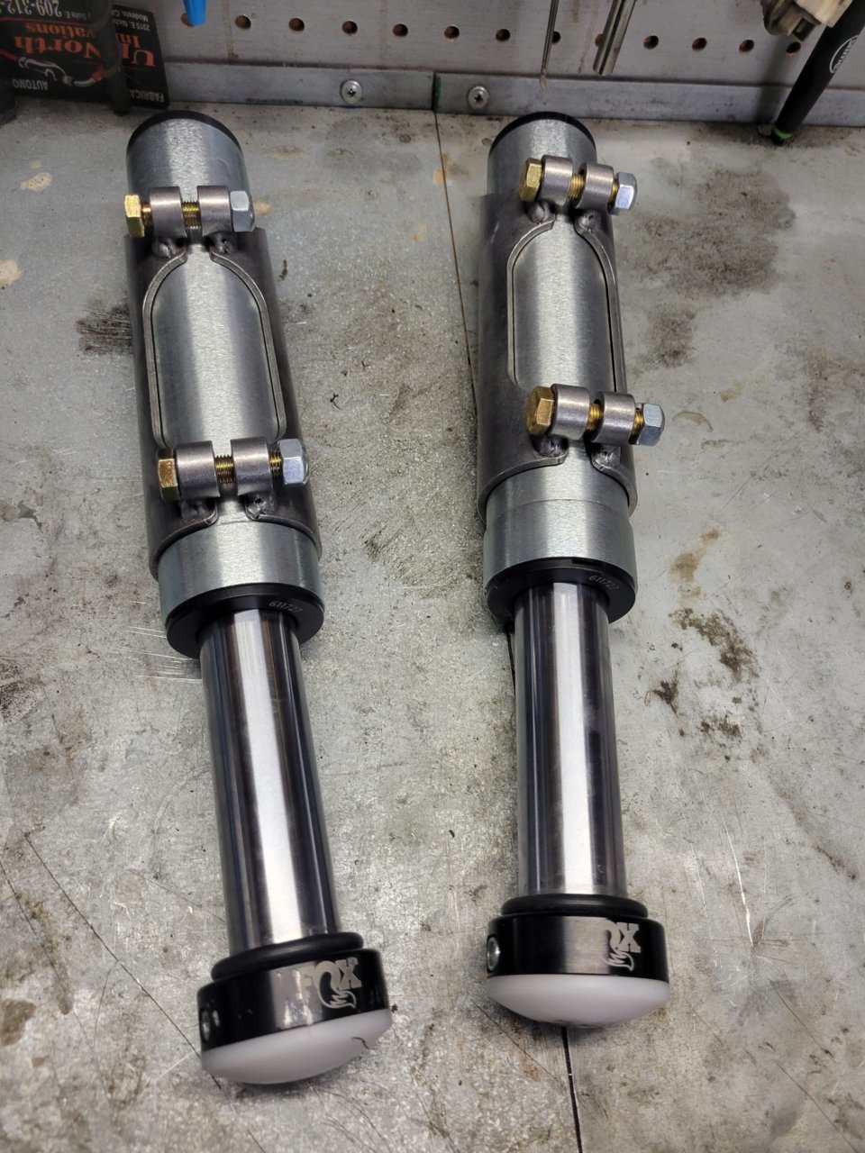

    Is the CO bottoming out before the bump stop?
  4. Feb 14, 2023 at 9:33 PM
    #1224
    El Taco Diablo
    El Taco Diablo [OP] Professional Pinstriper
    Nov 6, 2017
    #235223
    13,979
    Matt - KN6DZP
    Hughson, CA
    Impulse Red DC, 5vz-fe, 4wd swap, LT, dual case, F/R locked
    Just 3 tons of fun!!!
    no...it looks like it but the body passes through the coil seat.
    I never bottomed out the shock.
