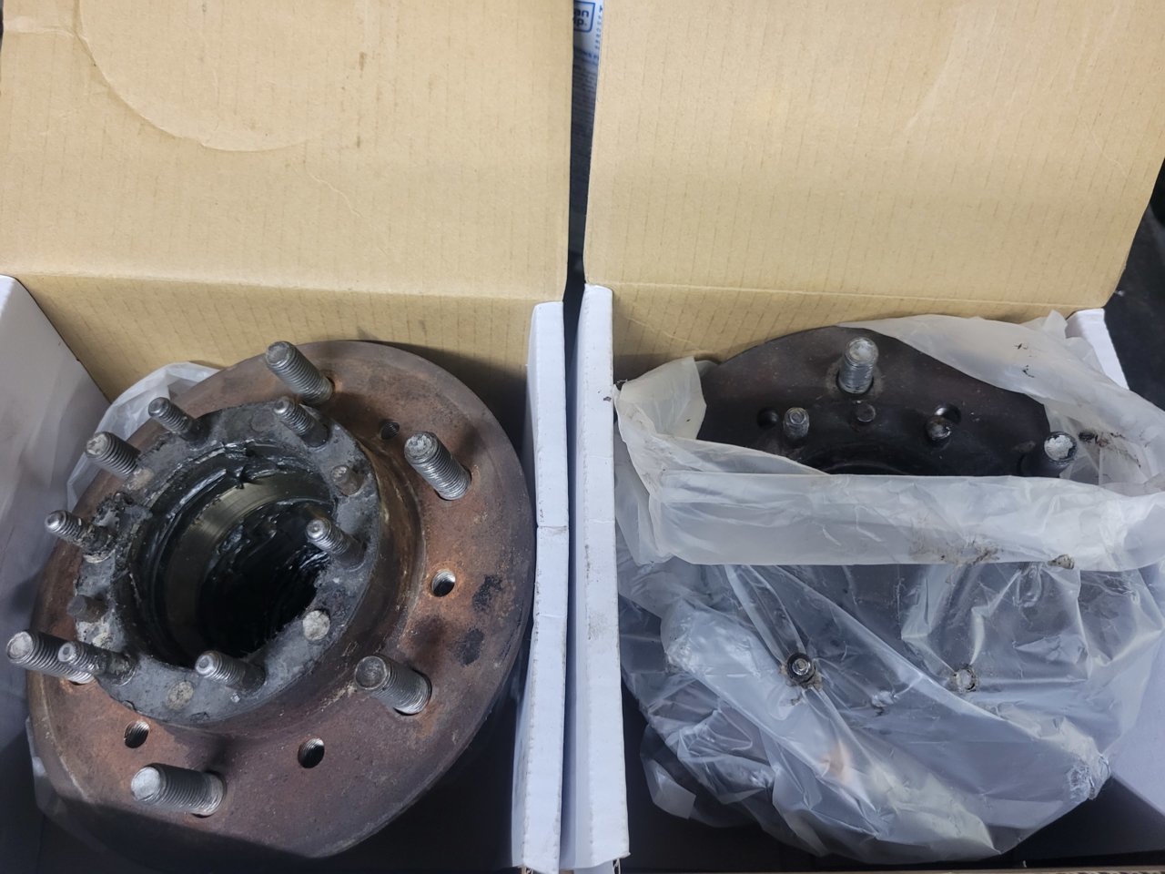

    Getting more stuff accumulated

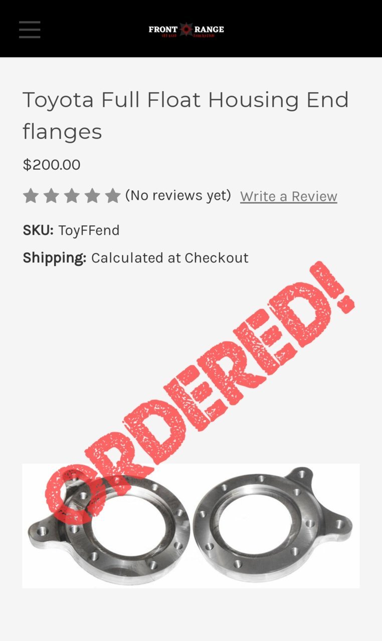

    Spoke to Front Range. The housing end flanges will be milled without caliper ears because the D-rotor kit already comes with caliper mounting brackets that bolt to the housing end flange.
    Also confirmed the rear brakes will be 03-09 4 Runner brakes.
    Also found 86-95 IFS hubs on FB Market. Really cool dude in Lake Havasu already got my tracking number, they are on the way.

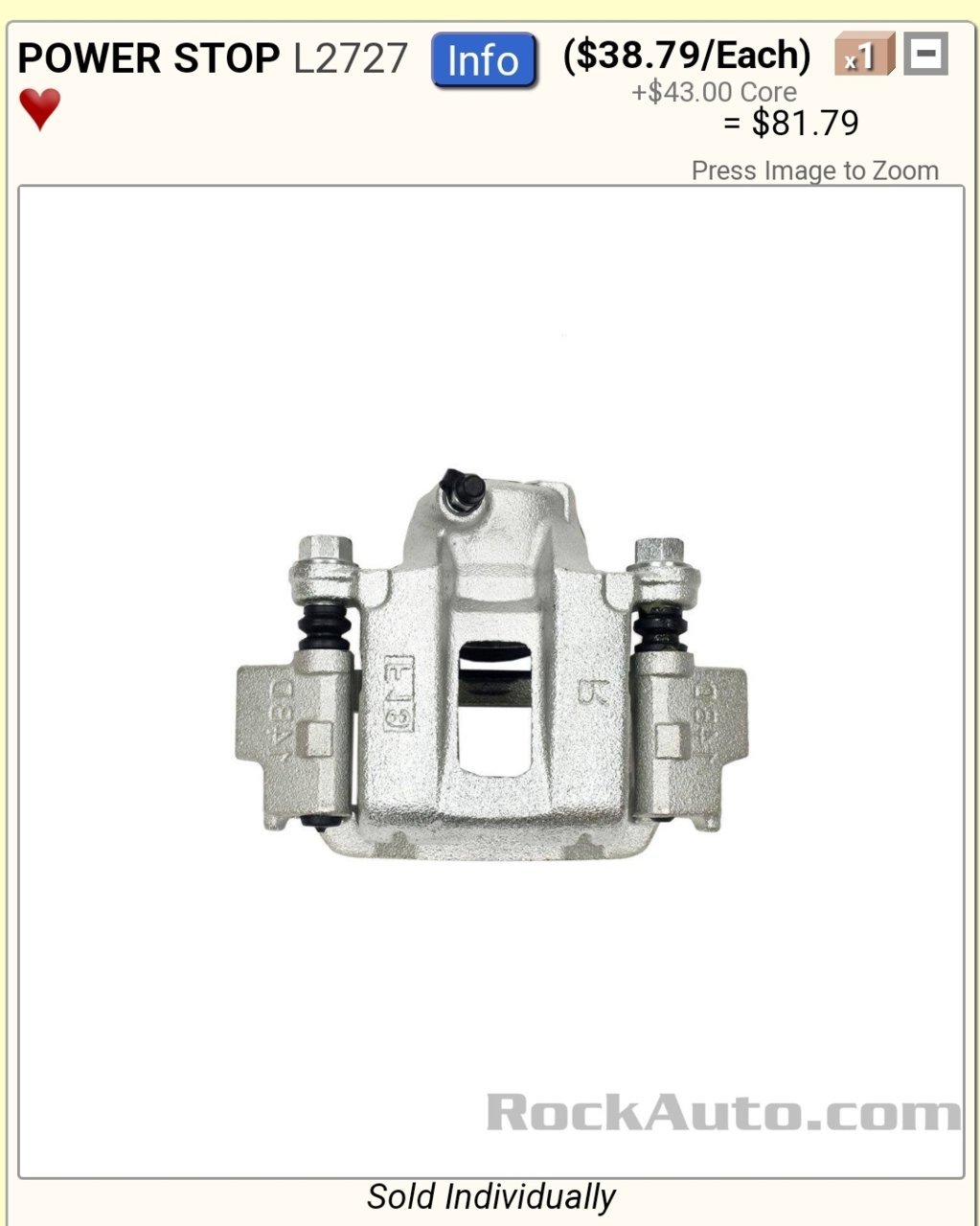

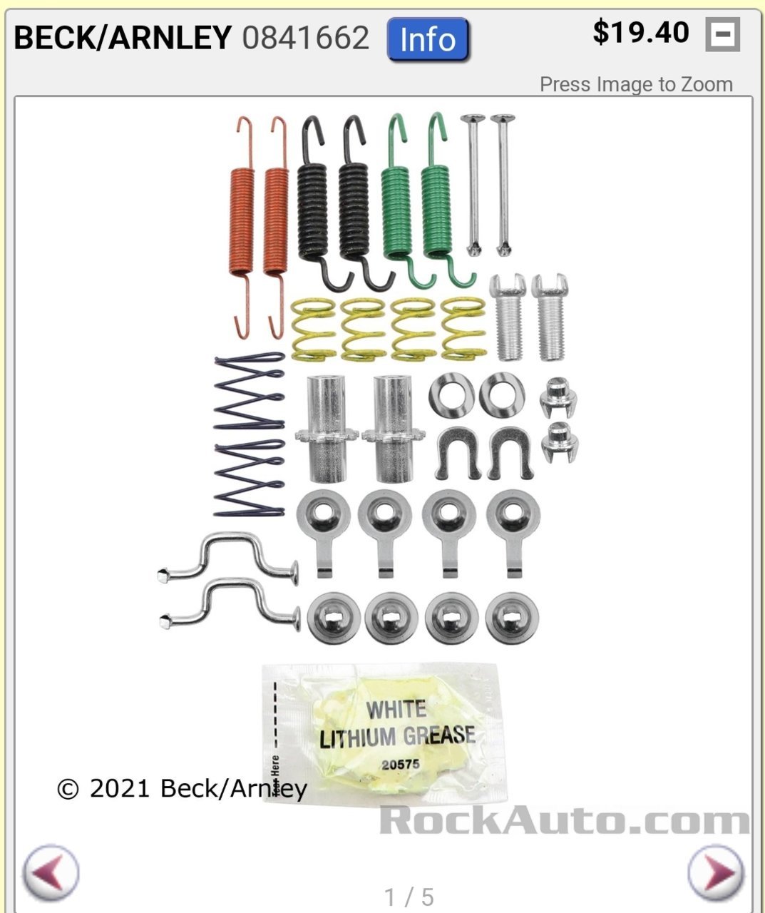

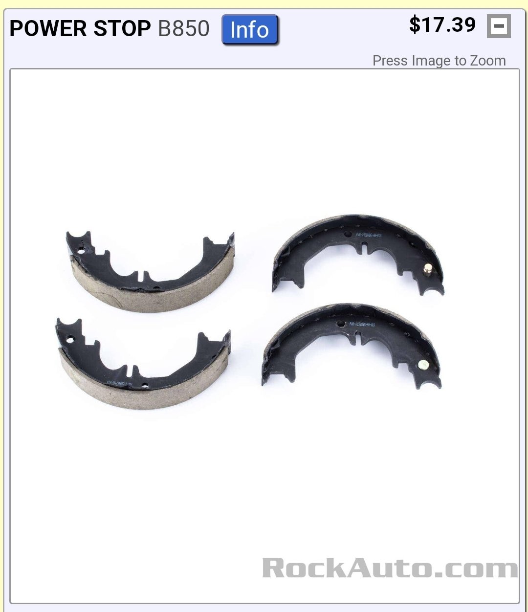

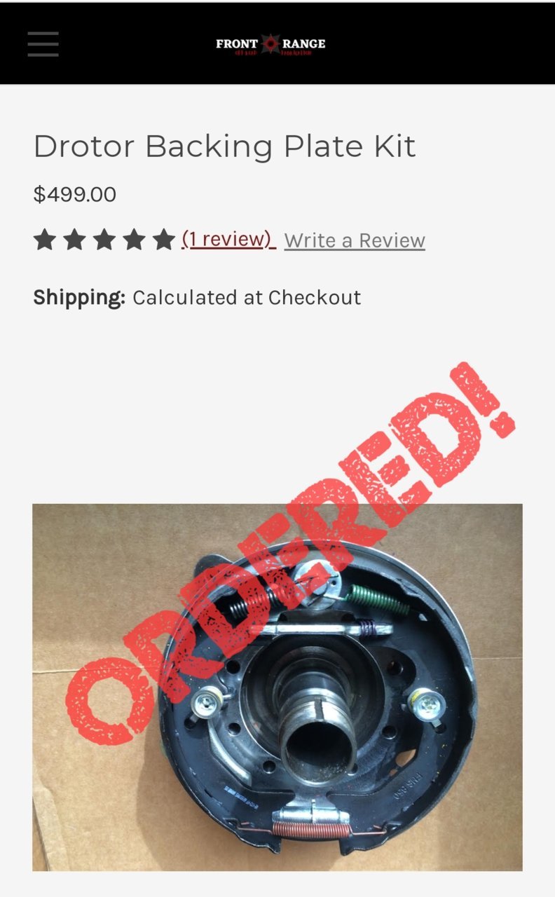

    Doing some more collecting. Man, the Nicole and dime stuff adds up! But I think this thing will be worth it in the end.
    E-brake hardware and shoes are coming.

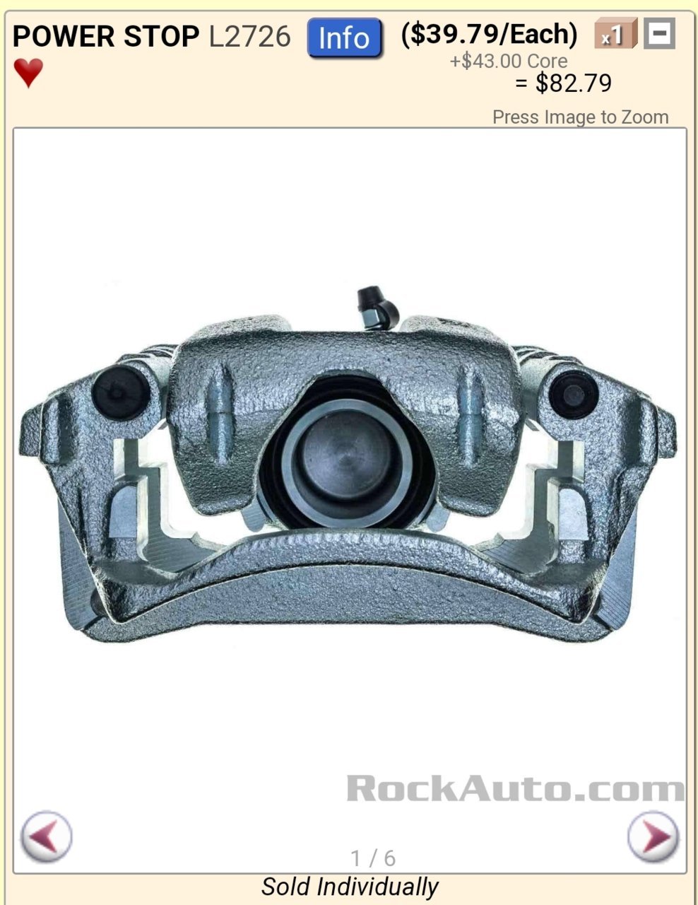

    Rear calipers are coming. I ordered them uncoated because I'm going to paint them myself.
    RockAuto didn't have the rotors and pads I'm wanting so, those will be ordered from elsewhere soon.
