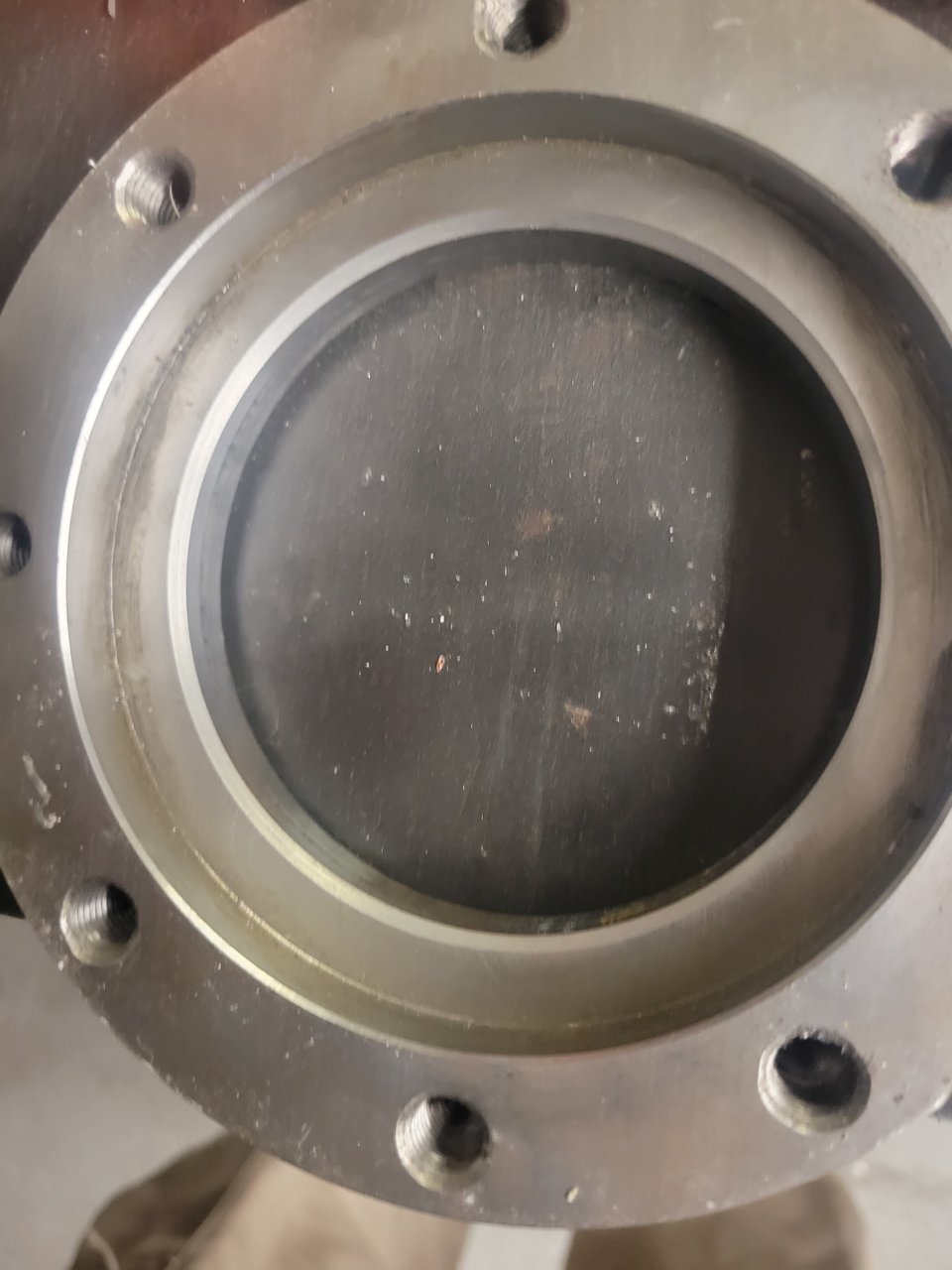

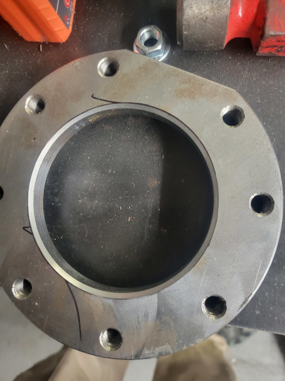

    20230428_203843.jpg 20230428_203920.jpg 20230428_203925.jpg 20230428_203944.jpg

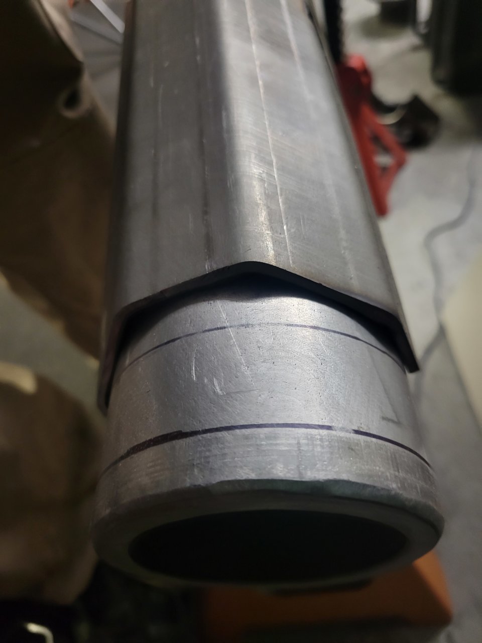

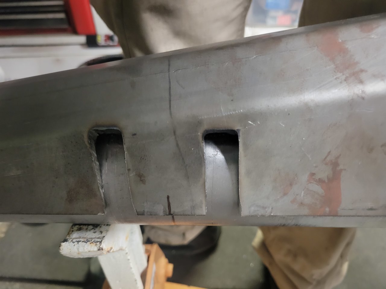

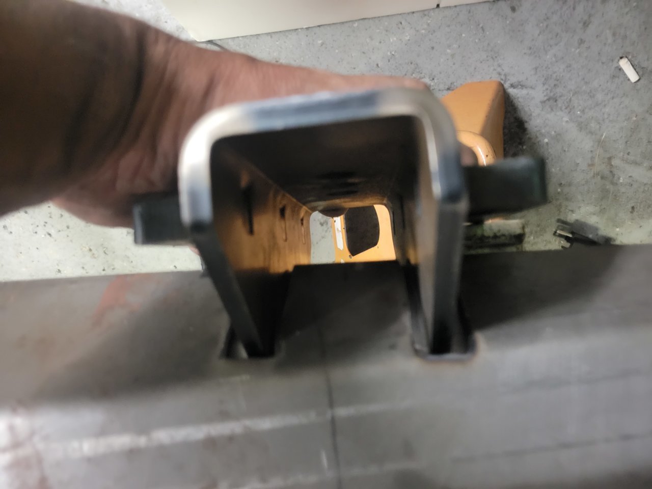

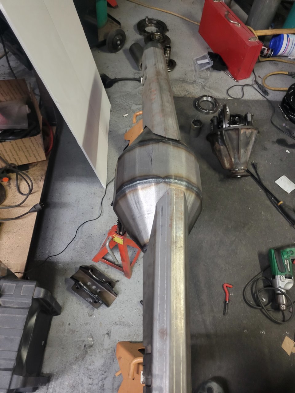

    Just dinking around, made some progress on the axle today. It's cut to length. The trusses are cut to length and fitted as well. Notched the trusses for the Ubolt eliminator perches they will need to be fine tuned when I get the perches set at the angle I want them at.
    The neighbor beveled the inside and out side of the flanges for me on his lathe, so the root weld can get in deeper and not build up so much (especially important on the outside where the spindle needs to nest in to the flange).

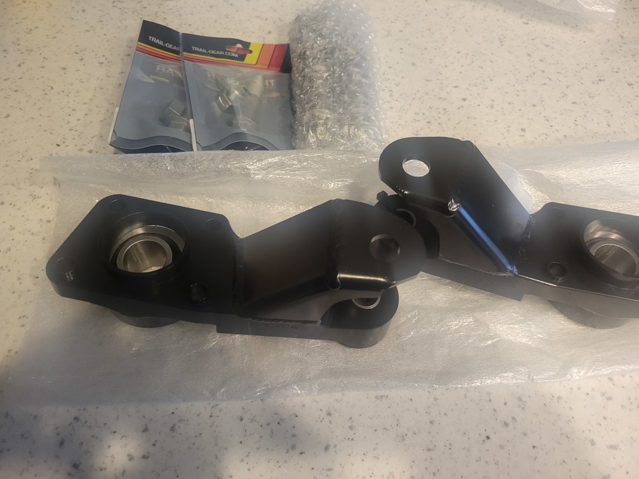

    Some good stuff arrived

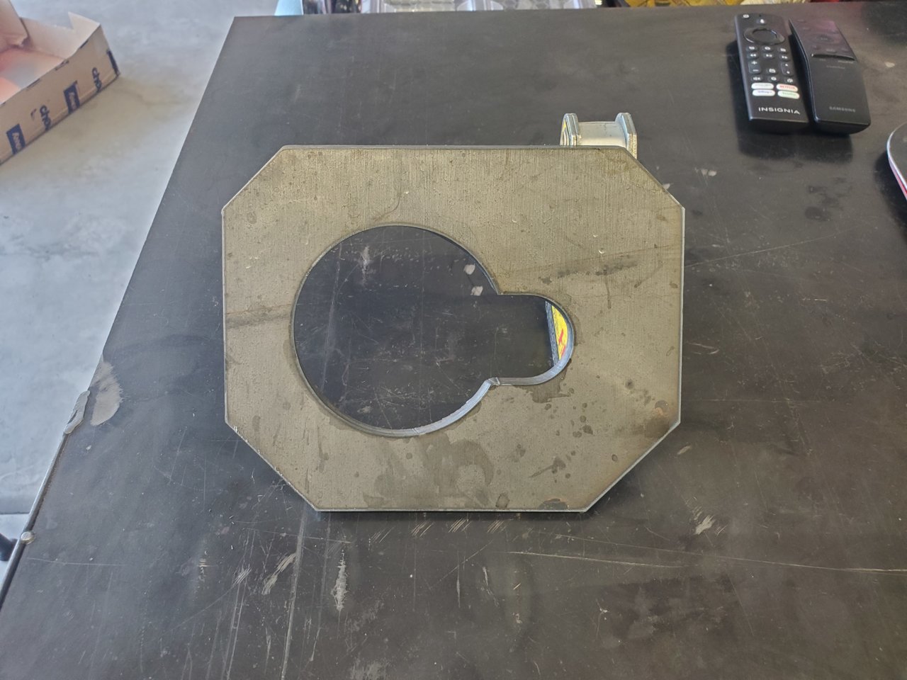

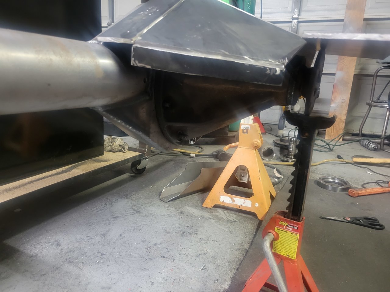

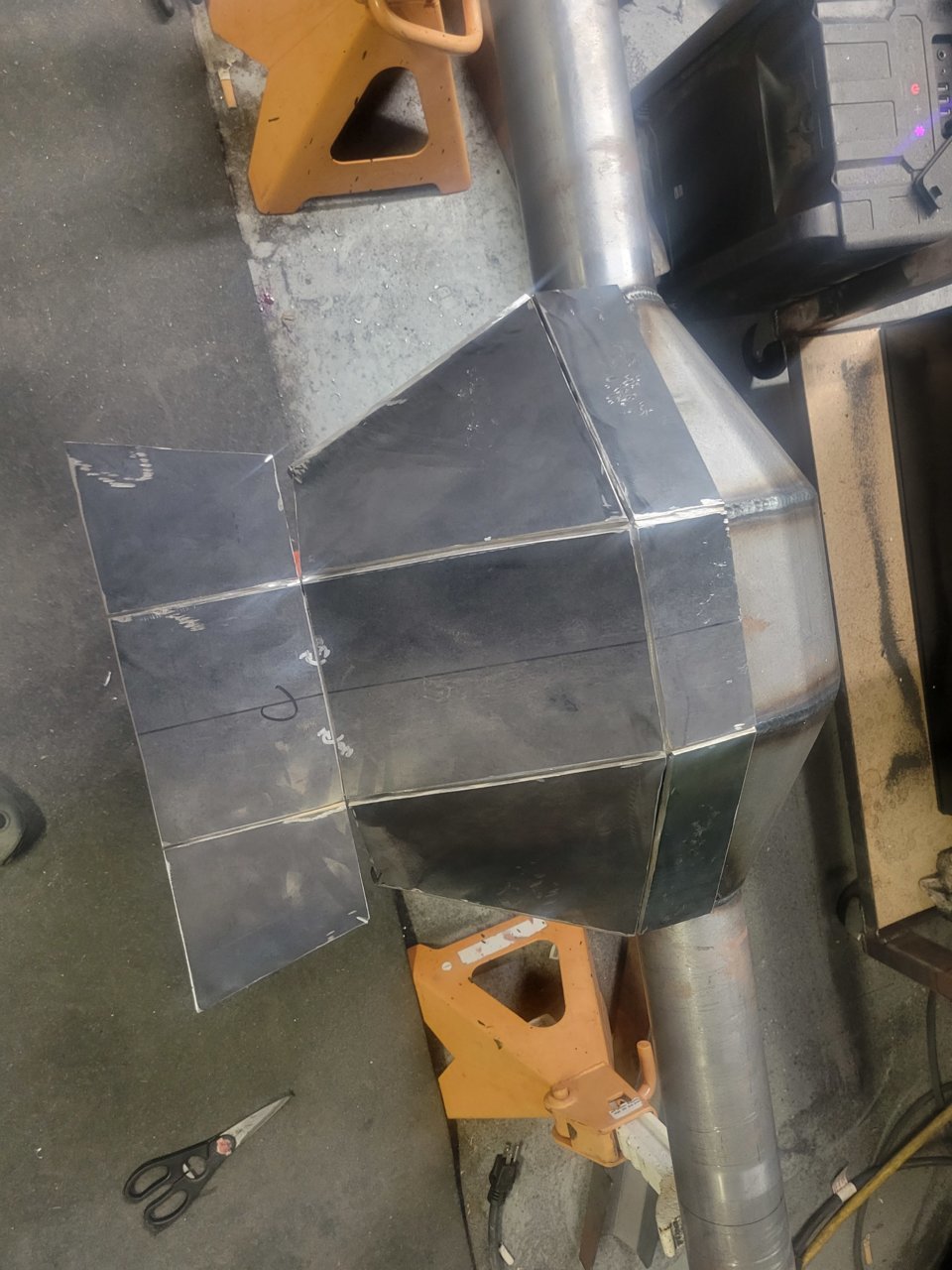

    Made some progress on the diff skid.

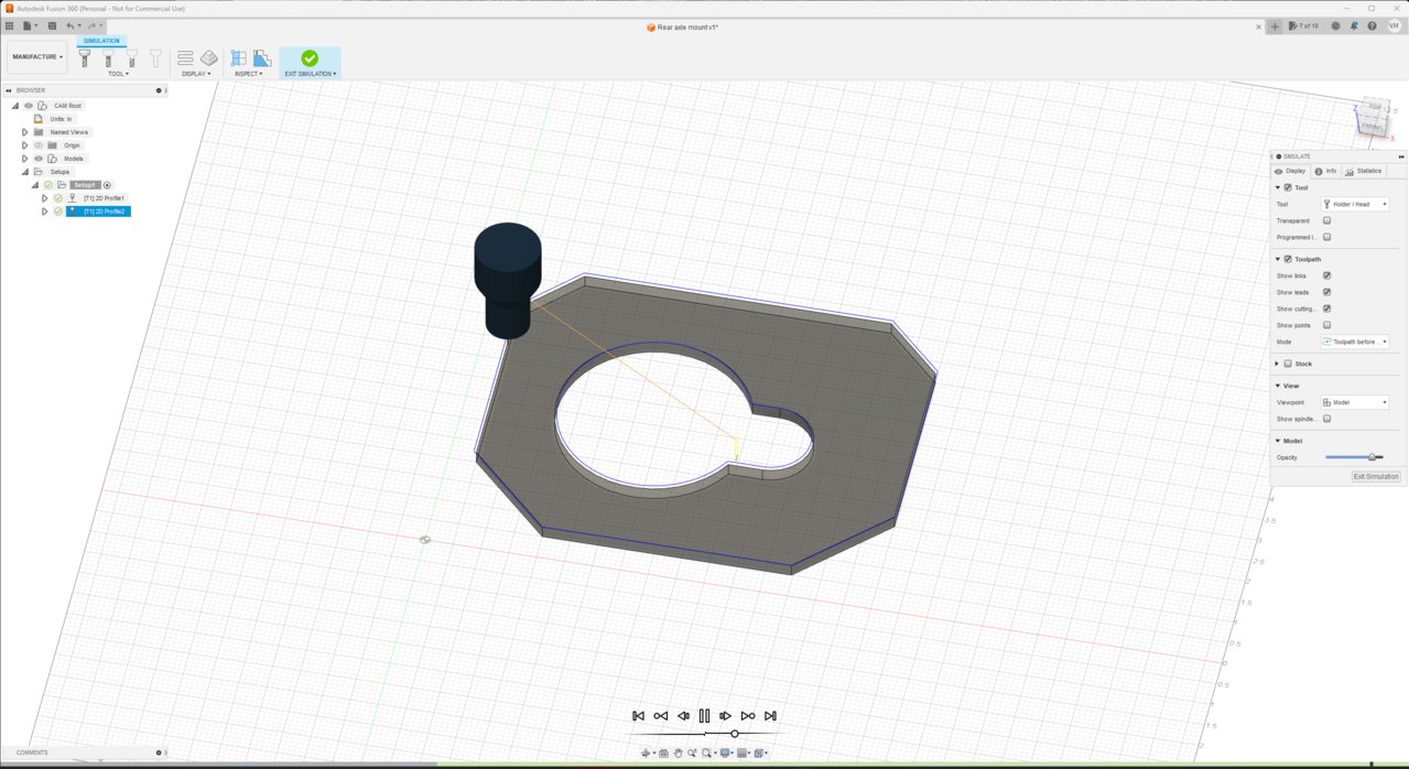

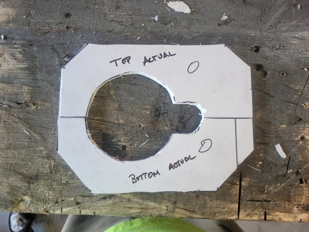

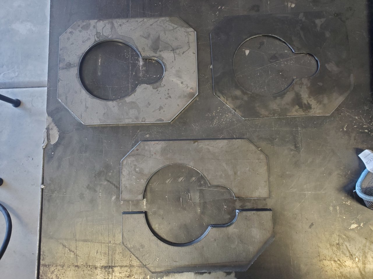

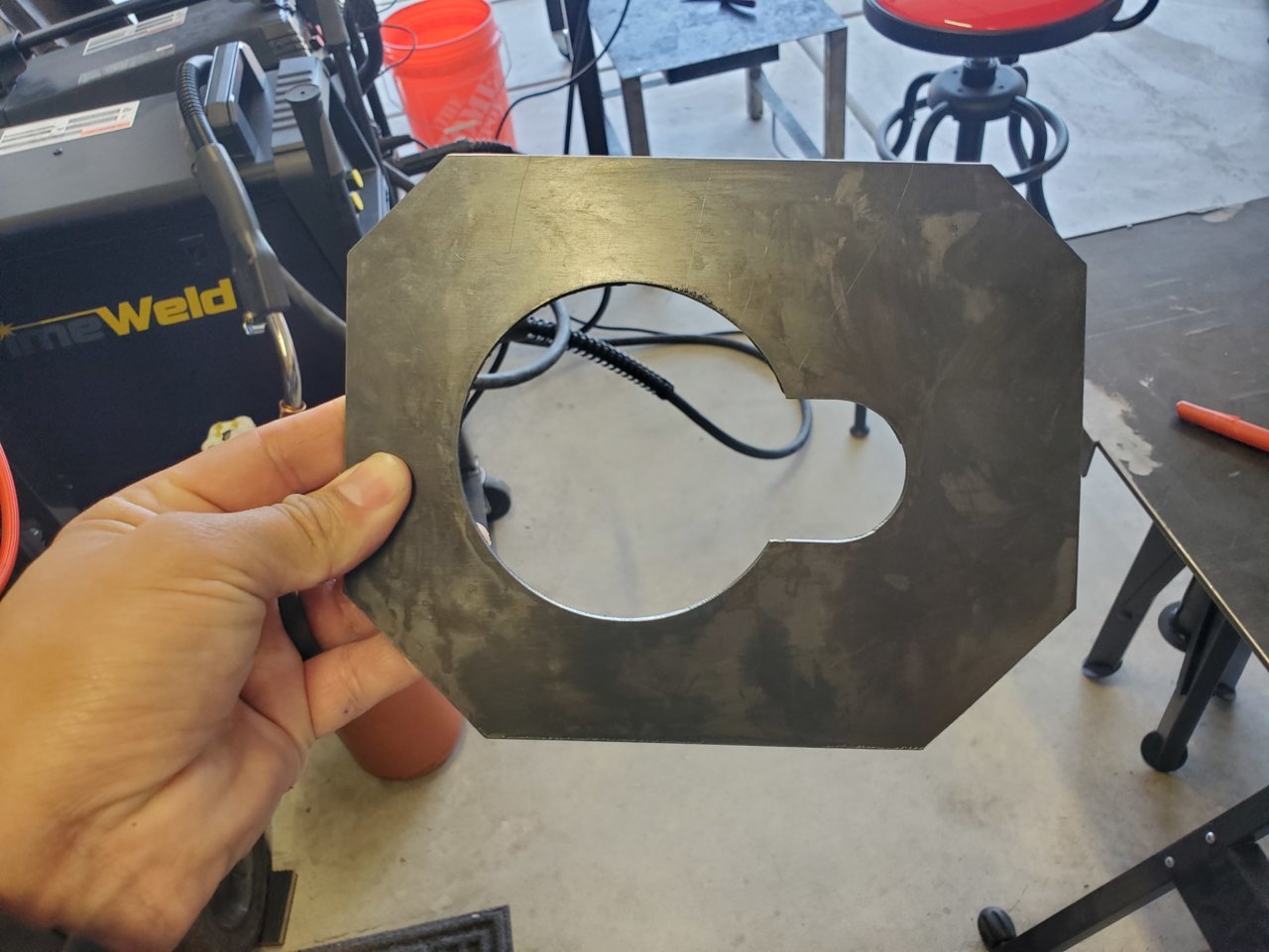

    That rear end is coming out real fucking beefy :muscleflexing:; glad I can be a part of it and get this cut out for ya.
    Your template -
    Quick drawing -
    Test piece, cut in 16 gauge -
    Actual piece will be in 1/4".
    You forget how heavy it is until you're lifting a 4' plate -
    Second try, first try failed cutting fully on the bottom part.
    Unfortunately I'll have to square up my table again but that's for later.
    Since I had *mostly* cut that first one, got it cut in half since that's the plan anyway -
