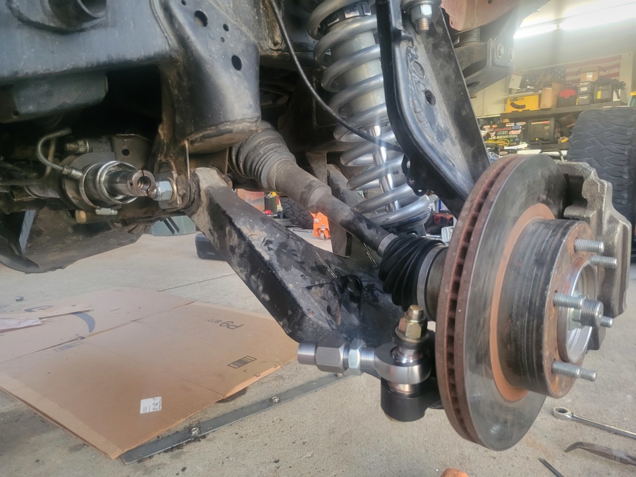

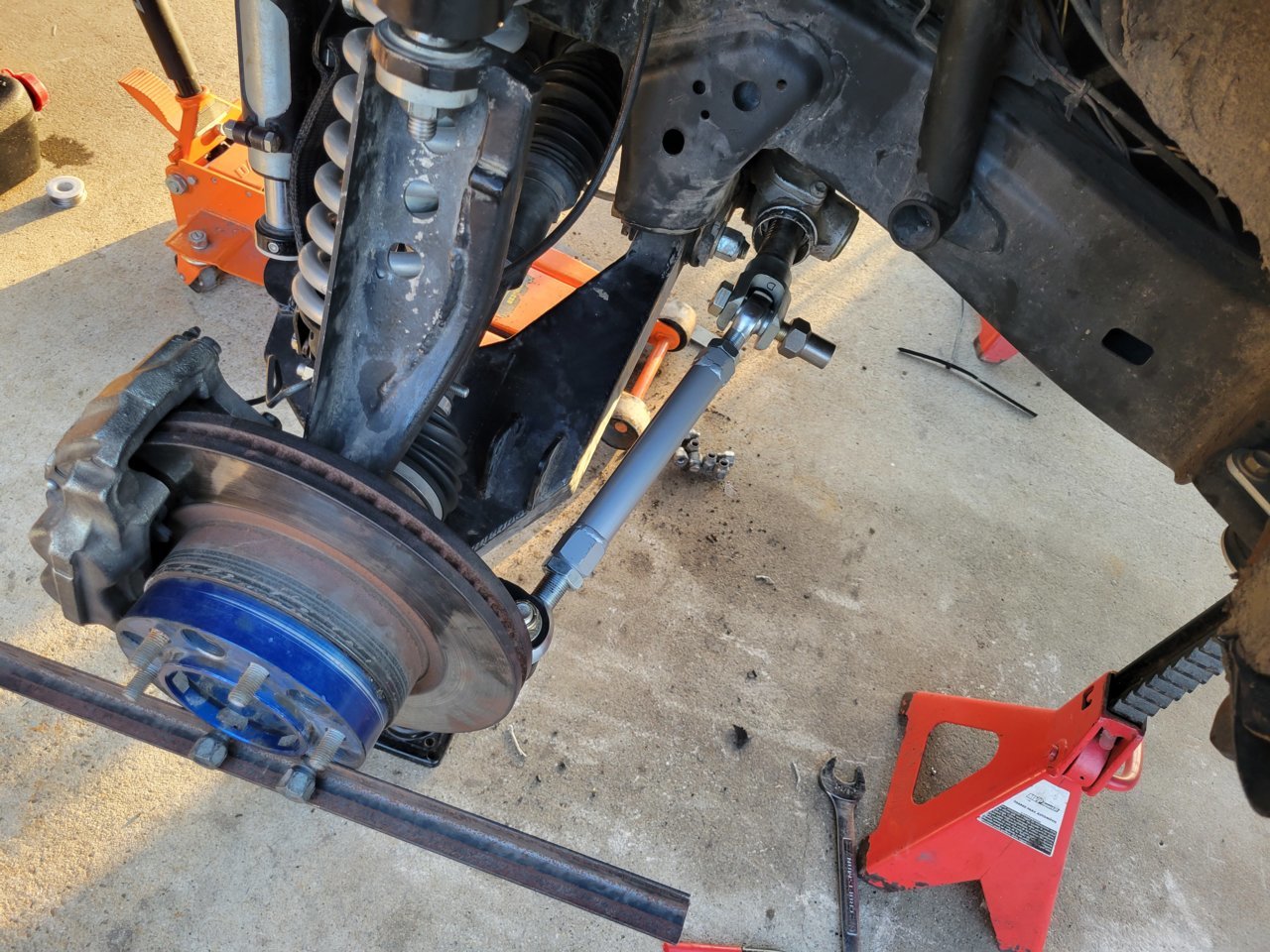

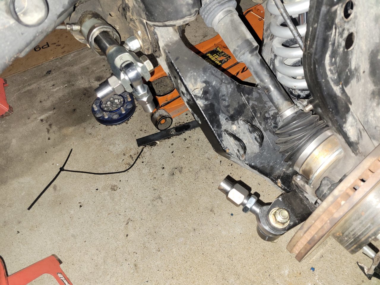

    Made it this far (on both sides) on the new LBJs this evening after work.
    rob1208, CemenTRDgen, Littles and 3 others like this.

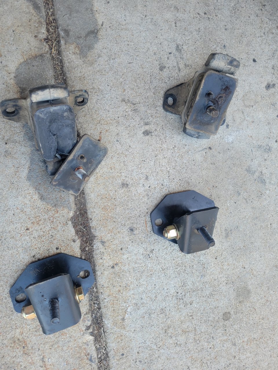

    For the record... Motor mounts are a pain in the ass.
    Thank you @Kwikvette and @essjay for the help
    Replaced with Ruff Stuff Specialties motor mounts. Was intended to be preventative maint, but found out my driver mount was broken anyway, so glad I did it.

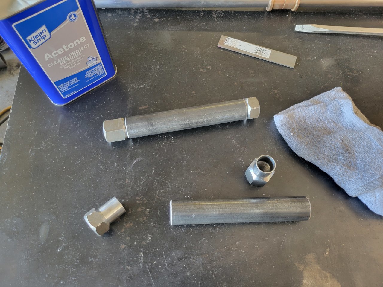

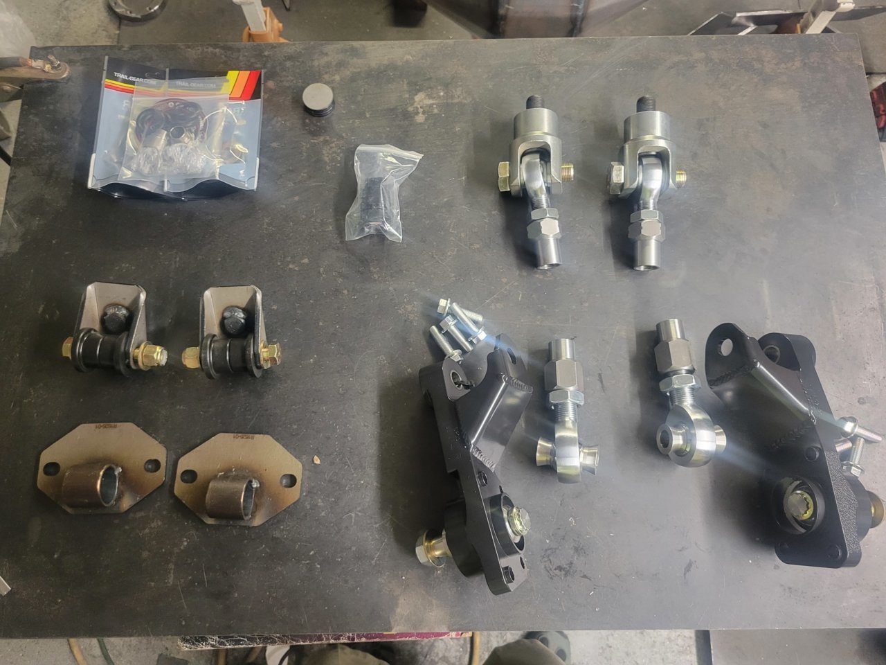

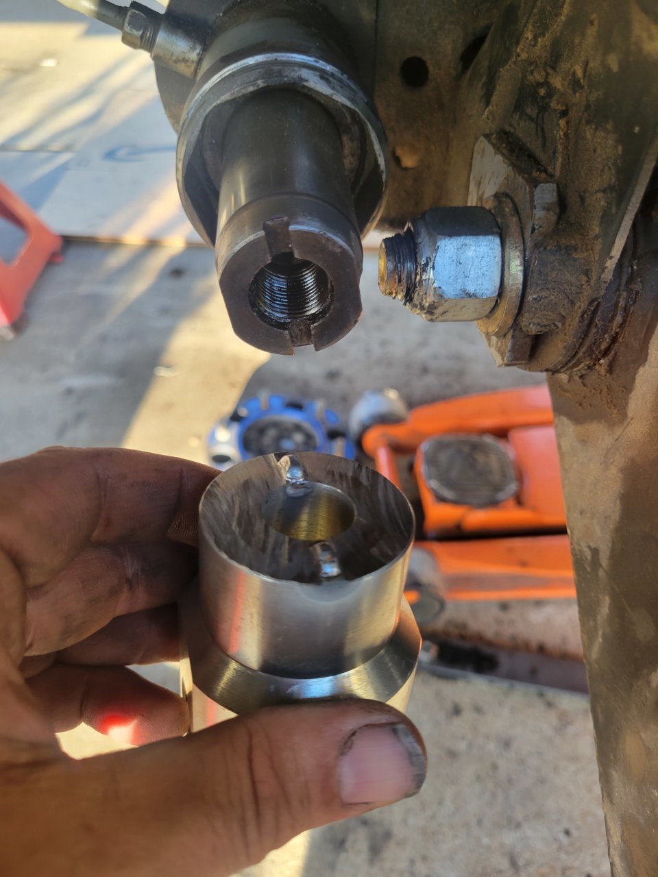

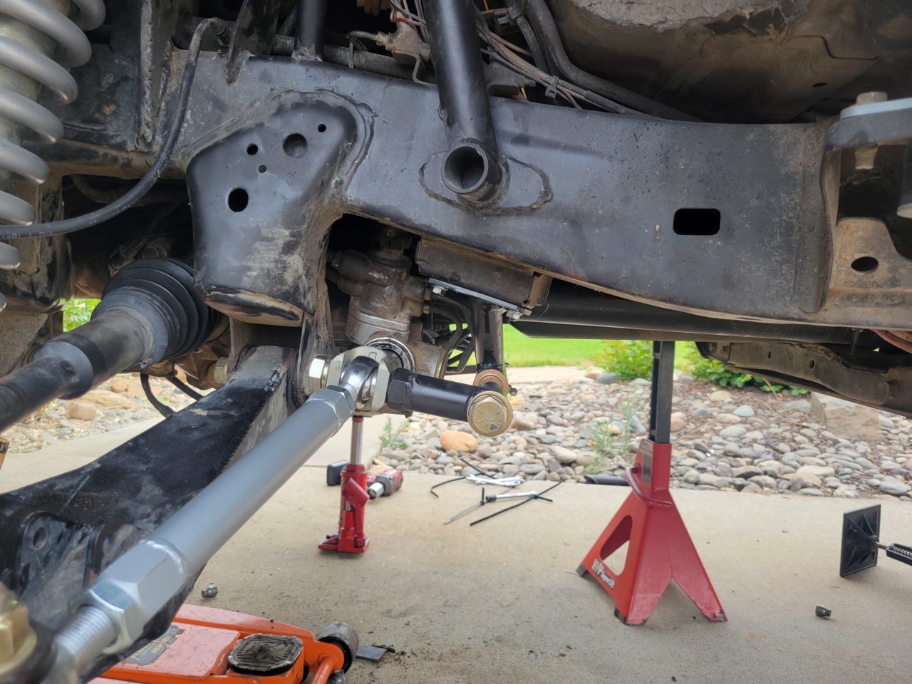

    The new bolts to attach the clevis to the steering rack ends arrived today. I set the angle I'm looking at having the rack slider at, then I welded locator tabs to make the clevis not be able to turn on the rack end, and possibly start working loose.
    I drilled in the the back of the clevis so the root of the weld is about 3/16 below the surface, and rises up about 3/16 as well.
    The I was able to start assembling things... Tomorrow I'll probably work on getting the wheels straight (toed) and then cut the links for the steering.

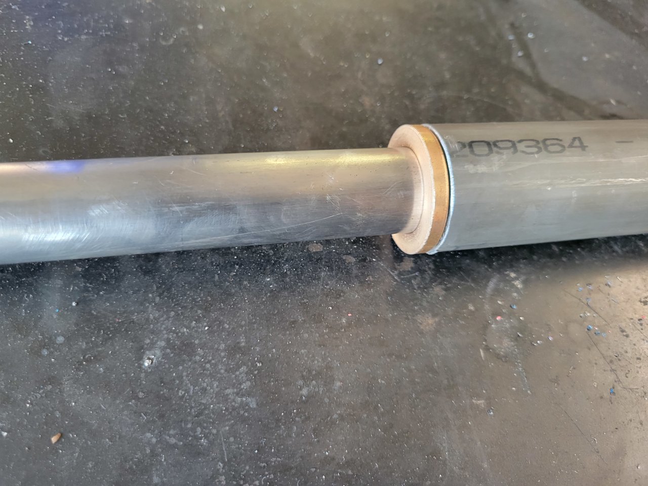

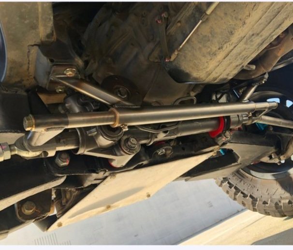

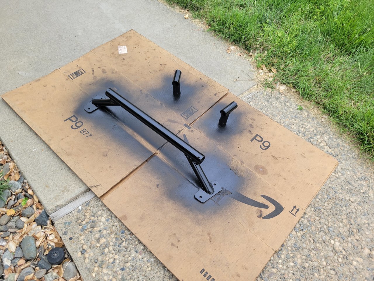

    Rack slider will be similar to this.
    unstpible, theesotericone and essjay like this.
  8. May 23, 2023 at 5:12 AM
    #1328
    cynicalrider
    cynicalrider #NFG
    Jul 25, 2012
    #83399
    17,160
    Jersey
    01 SR5 TRD 4x4, '23 Bronco Wildtrak, 2017 HSQV FE350
    Drop bracket lift and booger welds
    :popcorn::popcorn::popcorn: Is there a bushing material inside the slider or is it tight tolerance metal on metal?
  9. May 23, 2023 at 6:04 AM
    #1329
    El Taco Diablo
    El Taco Diablo [OP] Professional Pinstriper
    Nov 6, 2017
    #235223
    13,979
    Matt - KN6DZP
    Hughson, CA
    Impulse Red DC, 5vz-fe, 4wd swap, LT, dual case, F/R locked
    Just 3 tons of fun!!!
    It'll be bronze bushings. The fit will be just a schosh less than tight.
    cynicalrider[QUOTED] likes this.

    I just noticed it uses the old sway bar mounts too... that's a great idea and makes me regret cutting mine off. :cookiemonster:

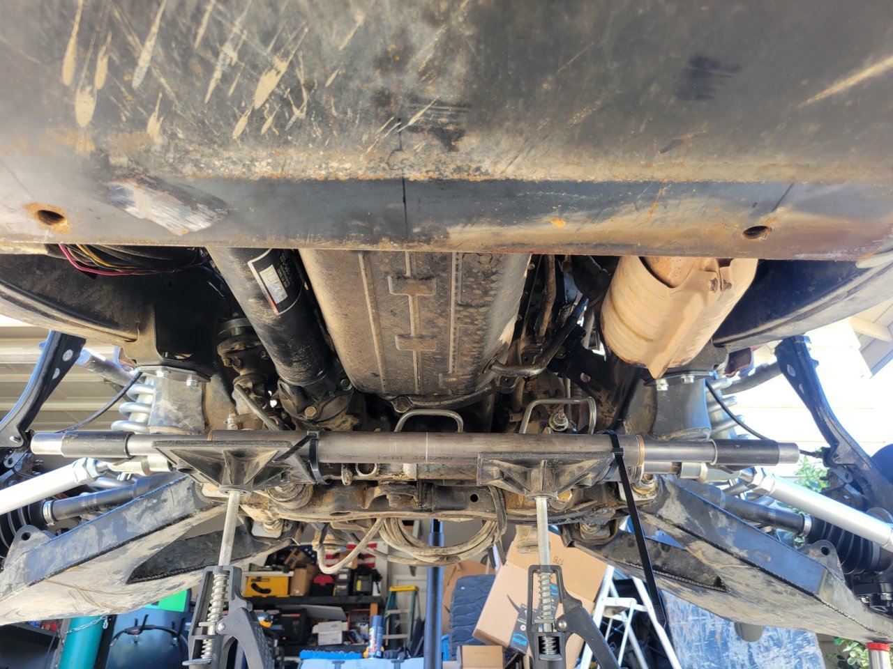

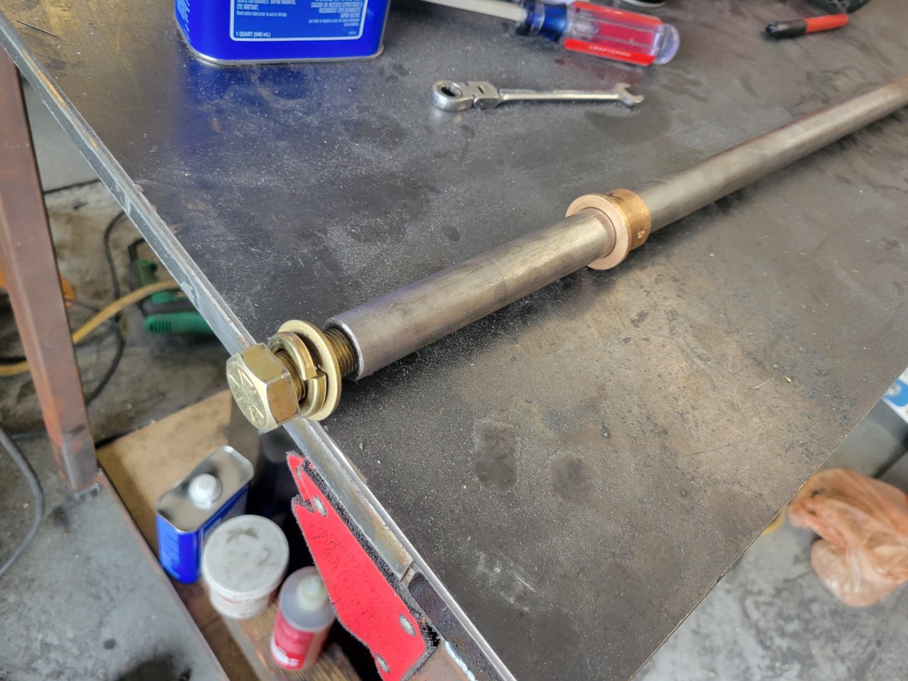

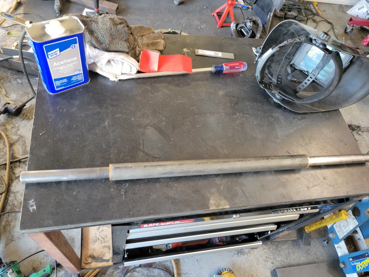

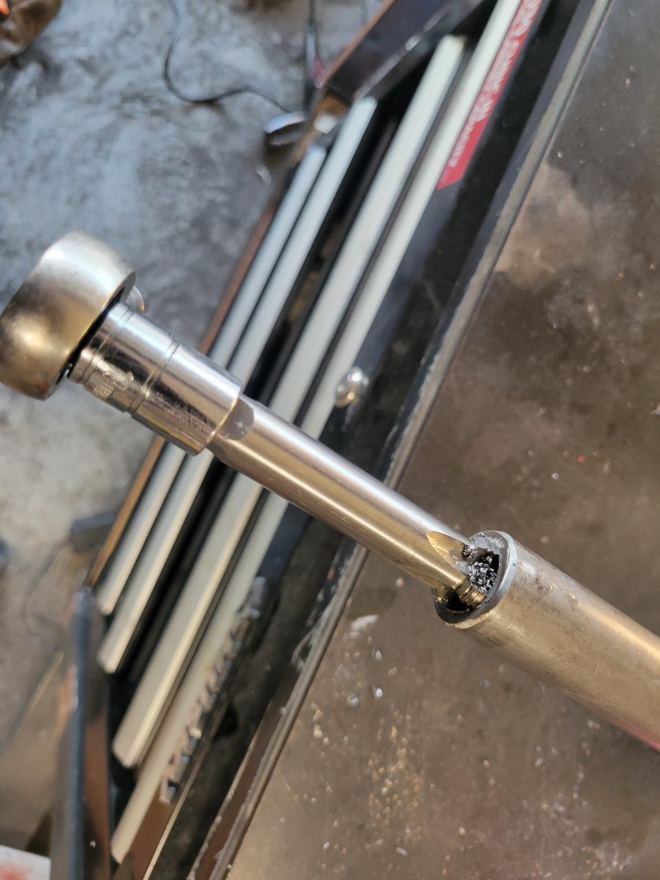

    Links are done
    Making progress on the rack slider

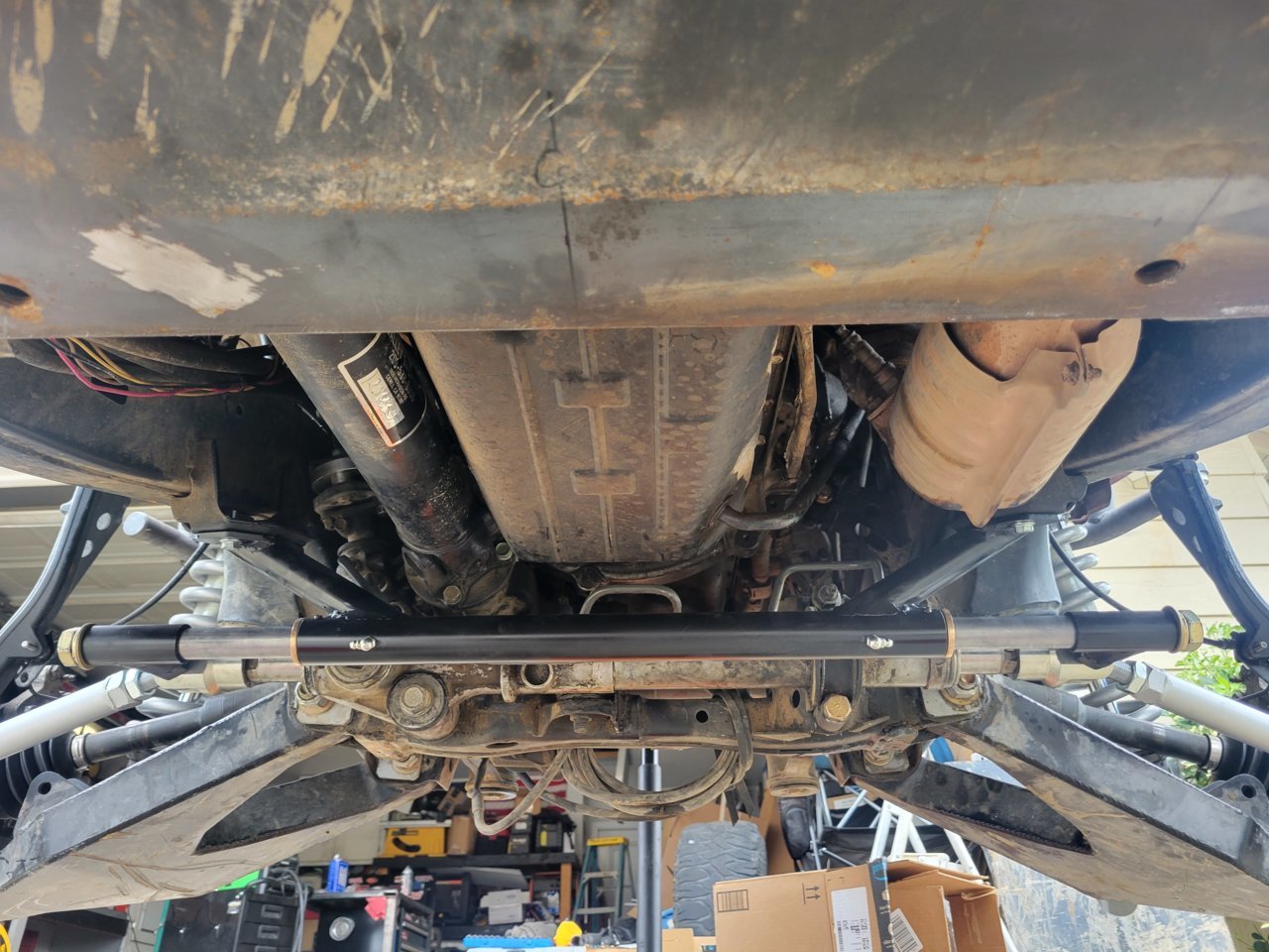

    Mocking it all up and getting ready to tack.
