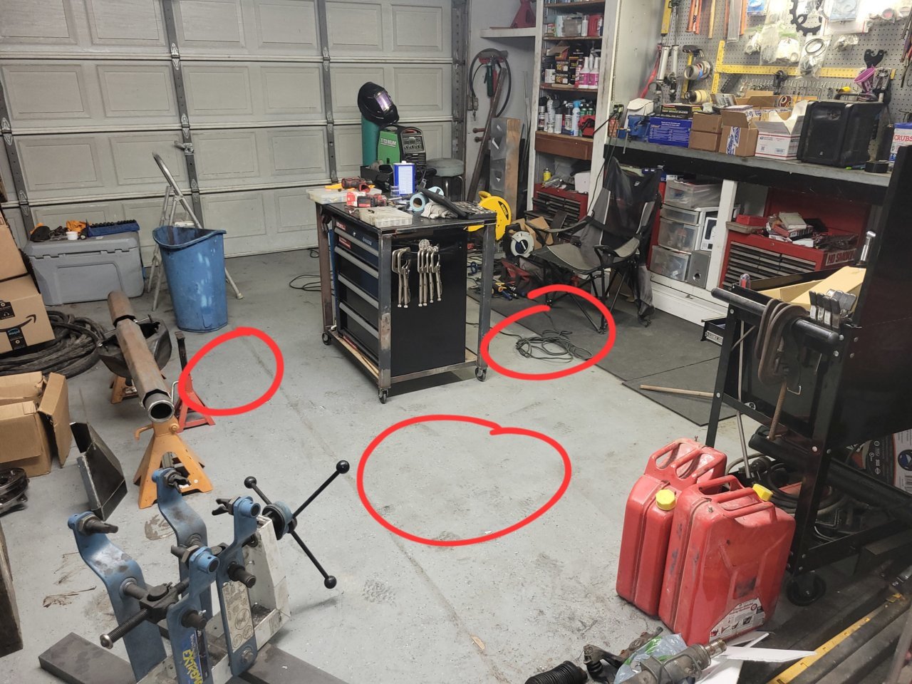

    Think my last visit consisted of 3 "almost" incidents as noted below :laughing:

    Was just keeping ya on your toes bro.
    Gotta be agile.

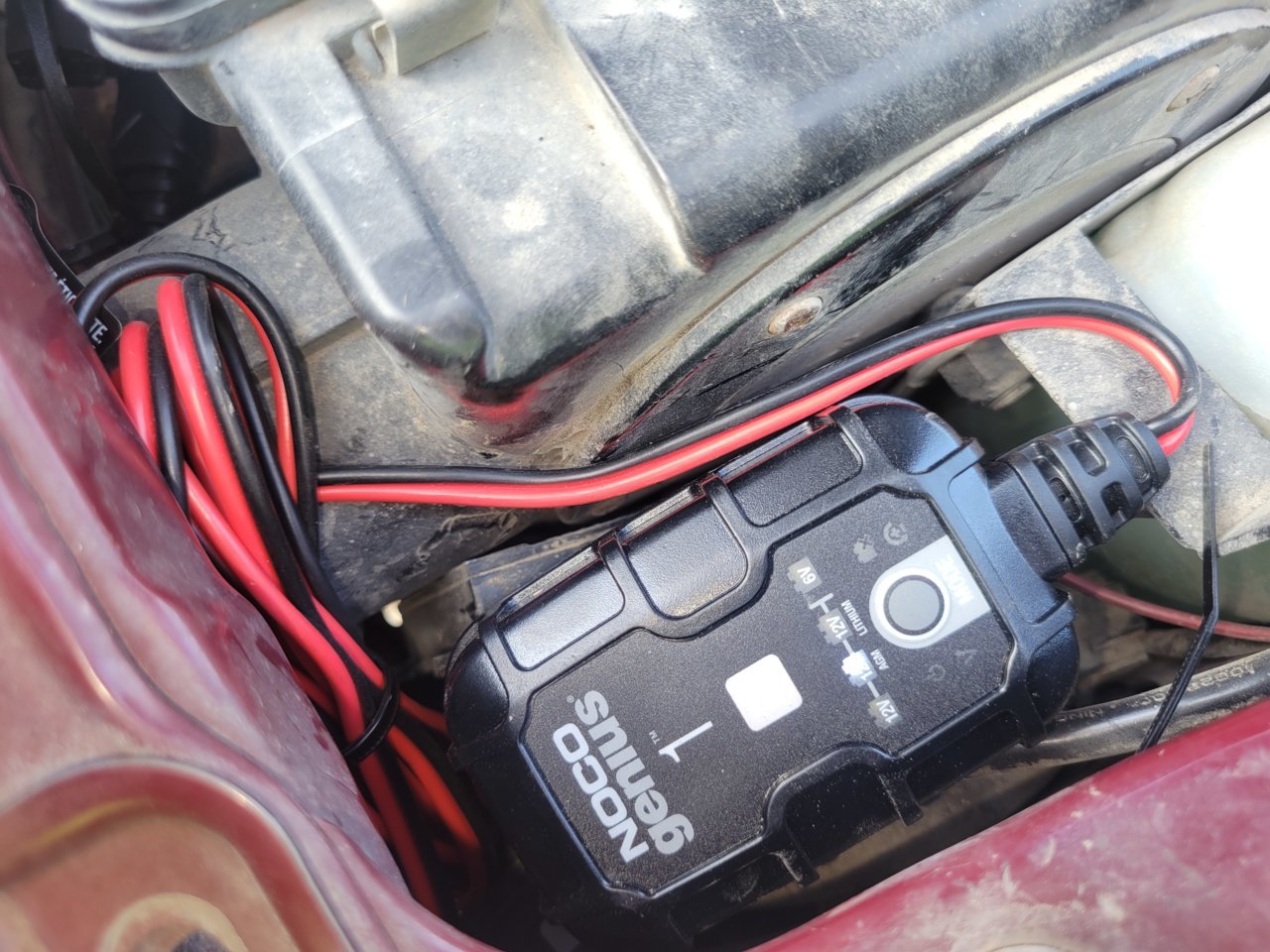

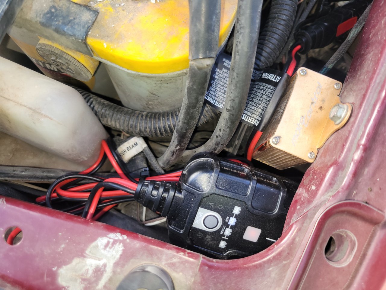

    Plug in 1st Gen Tacoma?
    Yes
    Driver side (starting battery)
    Passenger side (aux battery)
    Was going to make fancy brackets to hold them... but... nah, they'll ride there just fine. And I have way too much other shit to get done.
    The float chargers will be a good investment now that the truck isn't a daily anymore.

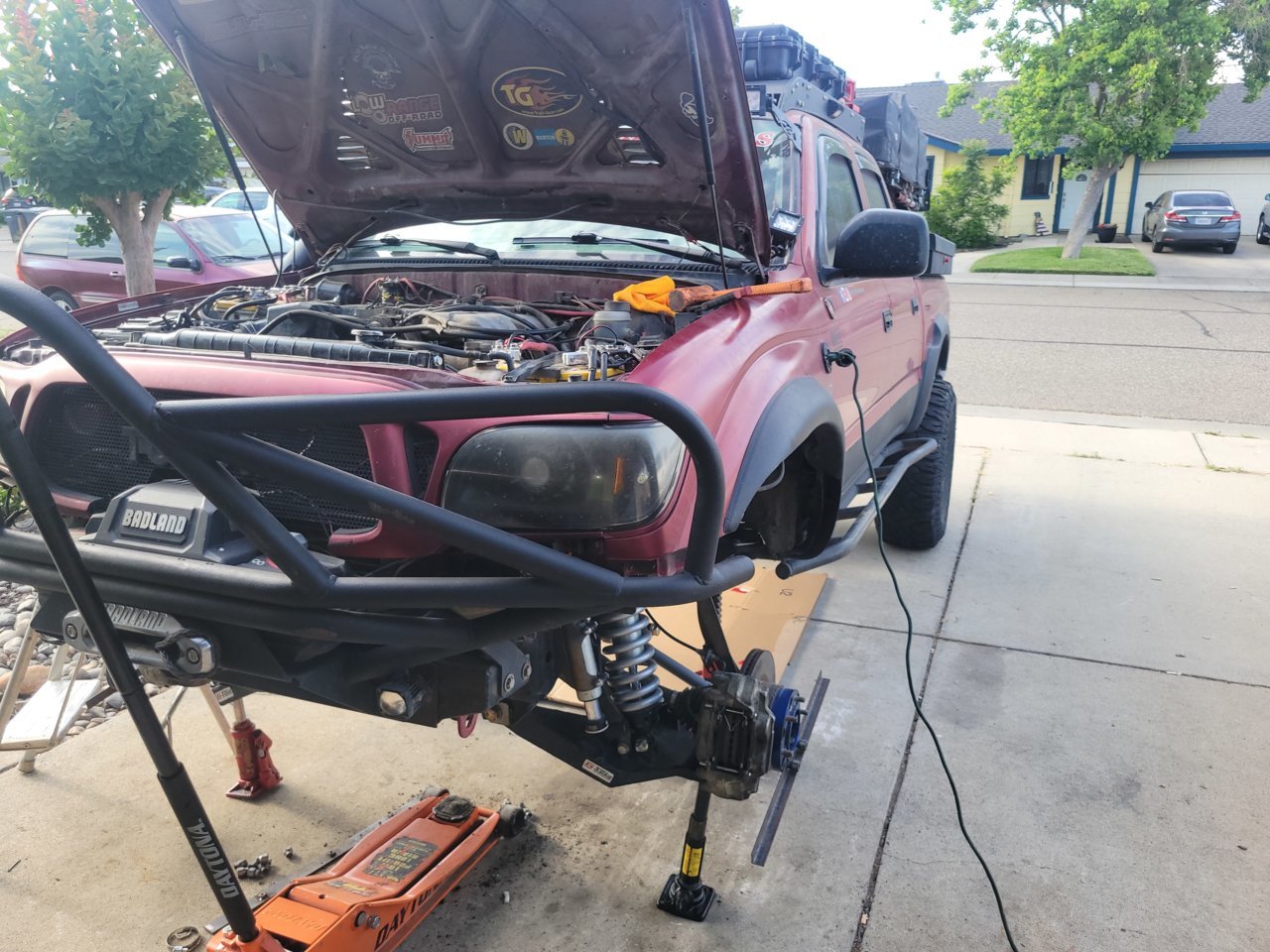

    @cbechtold or @Robmonster117
    Curious... when you installed the TC LBJs, where they hella stiff? I mean HELLA stiff.
  10. May 30, 2023 at 7:13 PM
    #1350
    betterbuckleup
    betterbuckleup Well-Known Member
    Jun 26, 2017
    #222483
    4,801
    Ian
    Concord, CA
    2000 Tacoma SC 2.7 4x4 5spd
    @chrslefty ran into that with his
  11. May 30, 2023 at 7:18 PM
    #1351
    El Taco Diablo
    El Taco Diablo [OP] Professional Pinstriper
    Nov 6, 2017
    #235223
    13,979
    Matt - KN6DZP
    Hughson, CA
    Impulse Red DC, 5vz-fe, 4wd swap, LT, dual case, F/R locked
    Just 3 tons of fun!!!
    Ok... Just making sure I hadn't fucked something up.
    They were REEEEEALY stiff BEFORE the rack saver, so I know it wasn't that. I just forgot to ask when I installed them.
    I torqued them to TC spec... but holy shit they are stiff. Like stiff enough to make steering noticeably stiffer (on jack stands with no wheels)
    I guess they'll work themselves in.

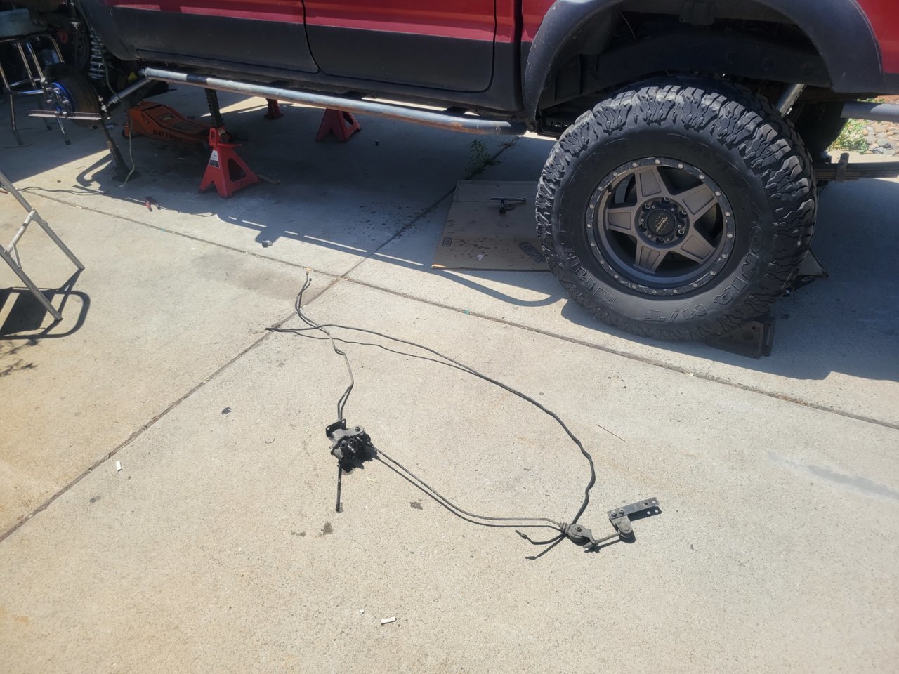

    Updating the list and adding
    Re-do my front Lower shock mounts DONE
    Replace speedometer sensor (so I actually have a speedo again) DONE
    Replace motor mounts with solid (poly) mounts. DONE
    Total Chaos Lower Ball joints DONE
    Fabricate new steering, replacing the inner and outer tie rods with Clevis and Heims. DONE
    Fabricate and install steering rack slider. DONE

    Clean up garage so you stop tripping on shit and almost dying... DONE

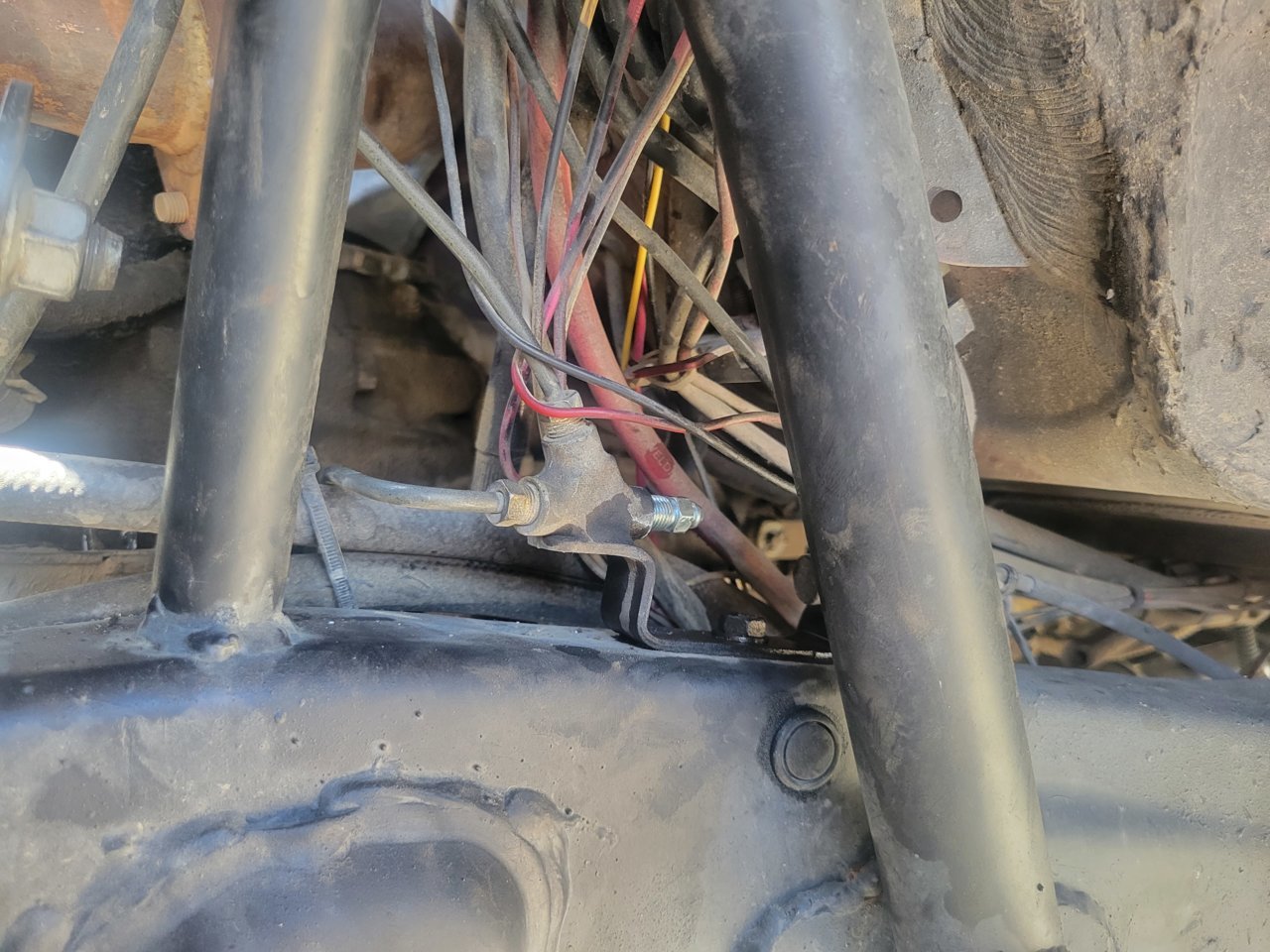

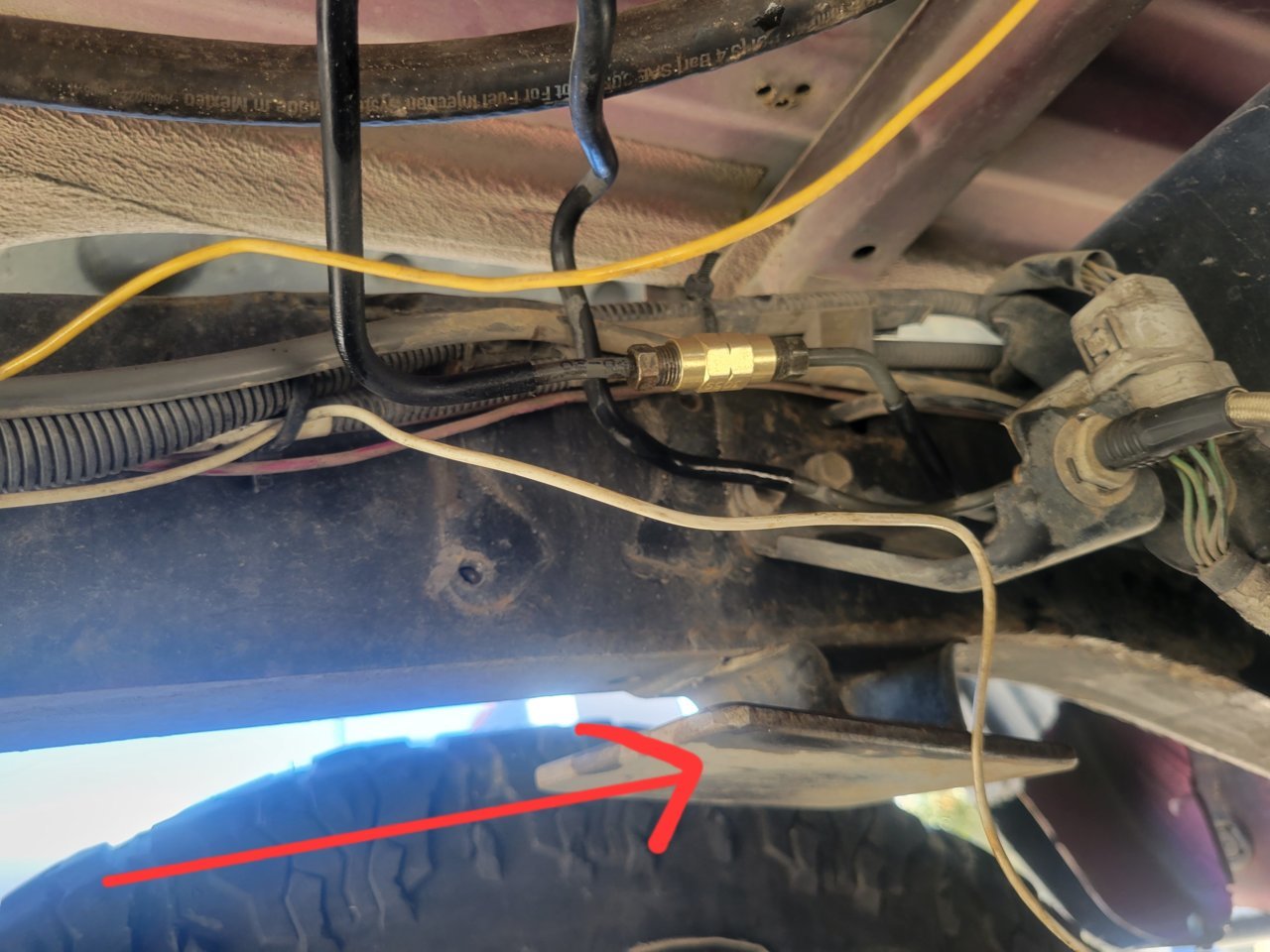

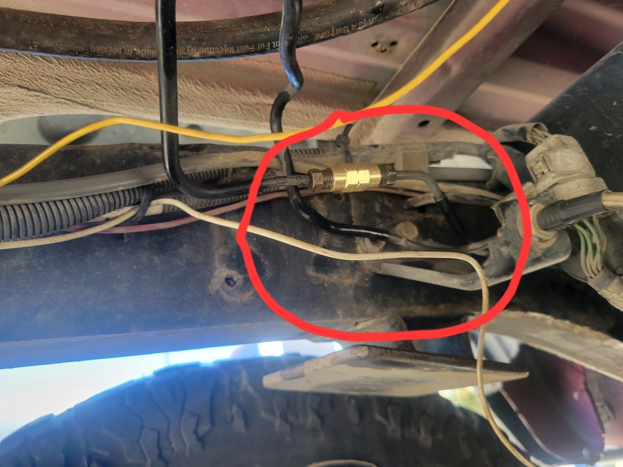

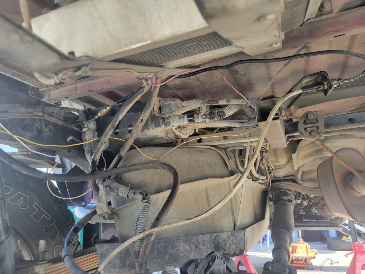

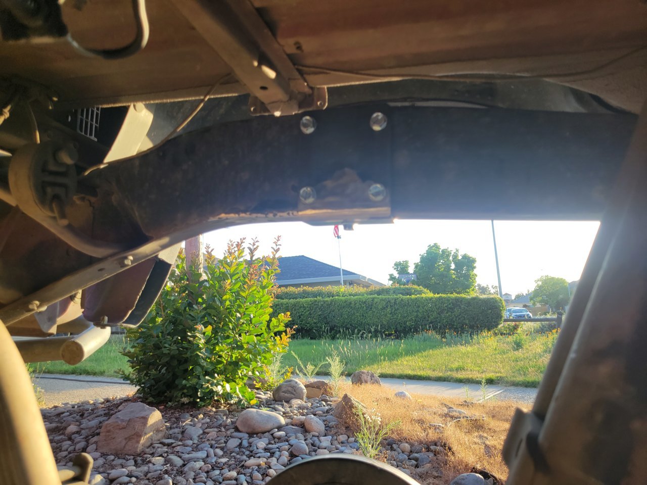

    Started working on the LSPV delete.
    I just plugged the return with a bleeder screw.
    And used a union to join the pressure line with the line that runs to the rear brake T while I figured out what else I need to do.
    I needed to get the area, circled in red, clear so I can mount the hydrobumps. So I ran relocated the brakes for the hardline/softline connection to the middle of the truck.
    I'll also be running an extension from the hardline T on the driver side up to the top of the diff... the new rear axle will also have the hardline T centered at the top of the diff (when it's done).
    Hacked off the stock bump pads. They were deformed and not really functioning well anymore anyway.
    Moving the proportion valve and the brake line bracket gave me space to mount the bases for the hydrobumps.

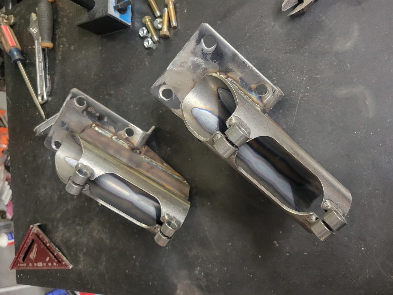

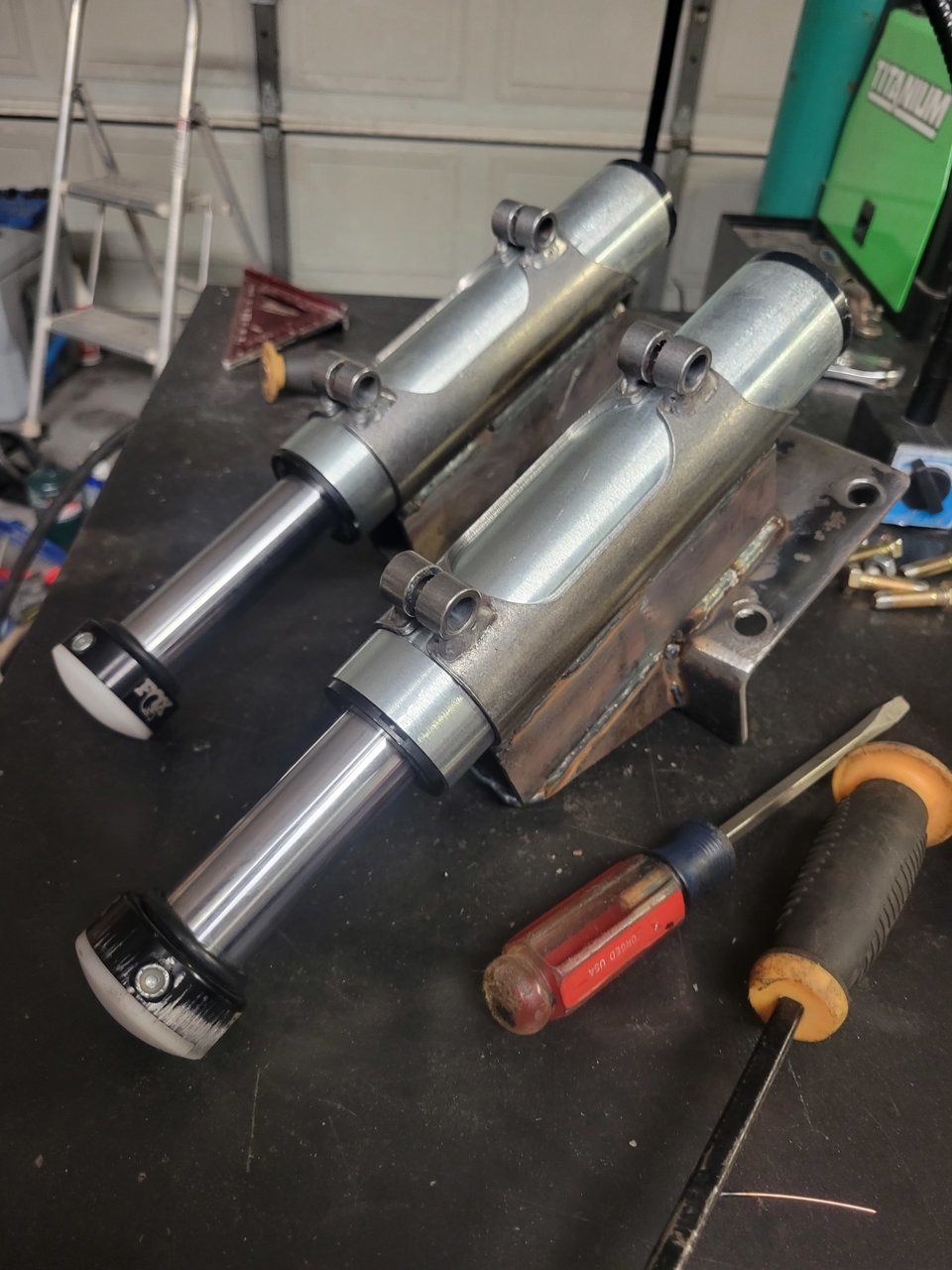

    Got the bump brackets burned together last night. We'll see how well this starts coming together this evening.
    Still need to finish up the rest of the lines in the back and mount the manual proportioning valve next to the Master Cylinder.
    Once I get the bumps in, I'll be able to get all the measurements to send to @Kwikvette so he can cut the pieces I'll need to build the strike pads, that will mount on the axle.
