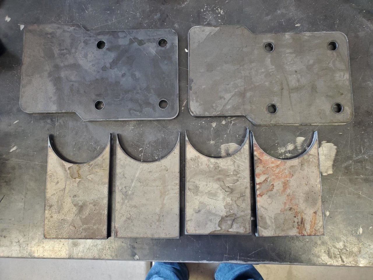

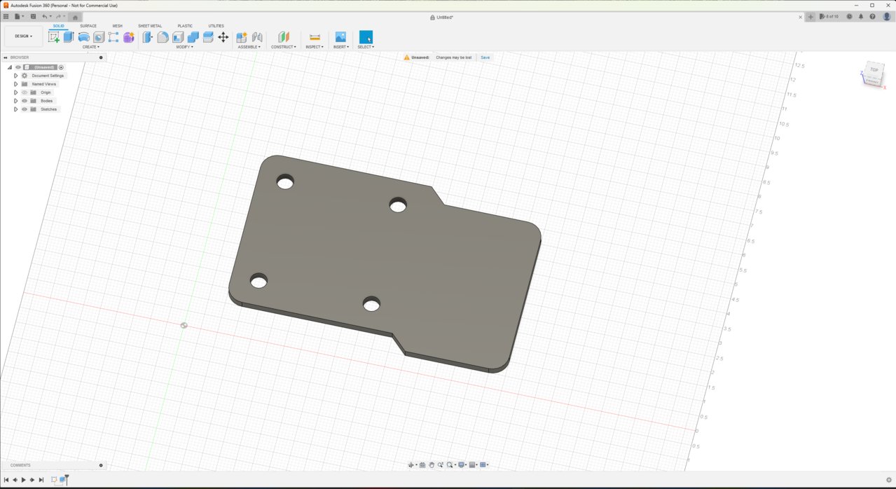

    Hydrobumps are in...
    Measurements for the pieces for the strike pads are sent to @Kwikvette
    Now we let his magic laser table do some shit.

    I swear, she's magical alright

    Magic table, activate!
    https://youtu.be/qB9P54rNNME
    Zero clean up, right off the table
    No dross on either top or bottom, just how I like it -

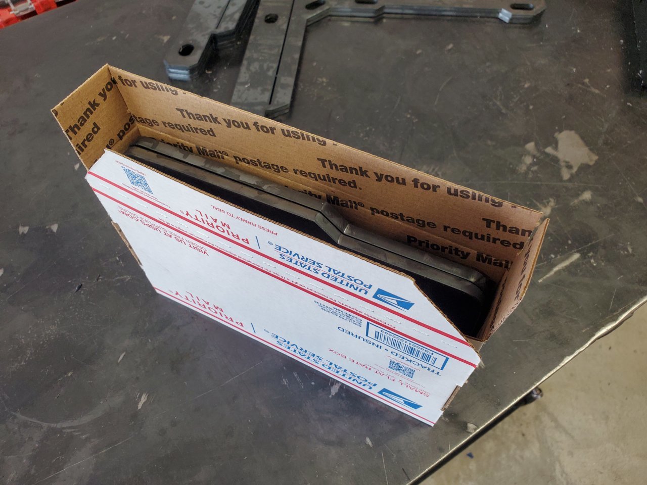

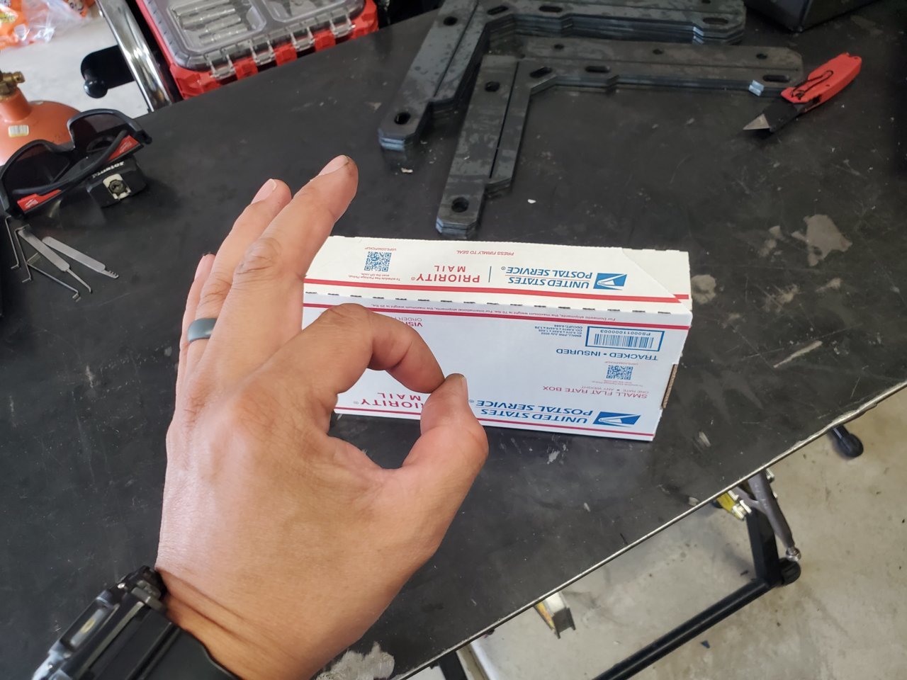

    This can't be a coincidence...
    IT LITERALLY MATCHES THE WIDTH AND LENGTH of a freaking flat rate box :rofl:
    "If it barely fits, it ships"

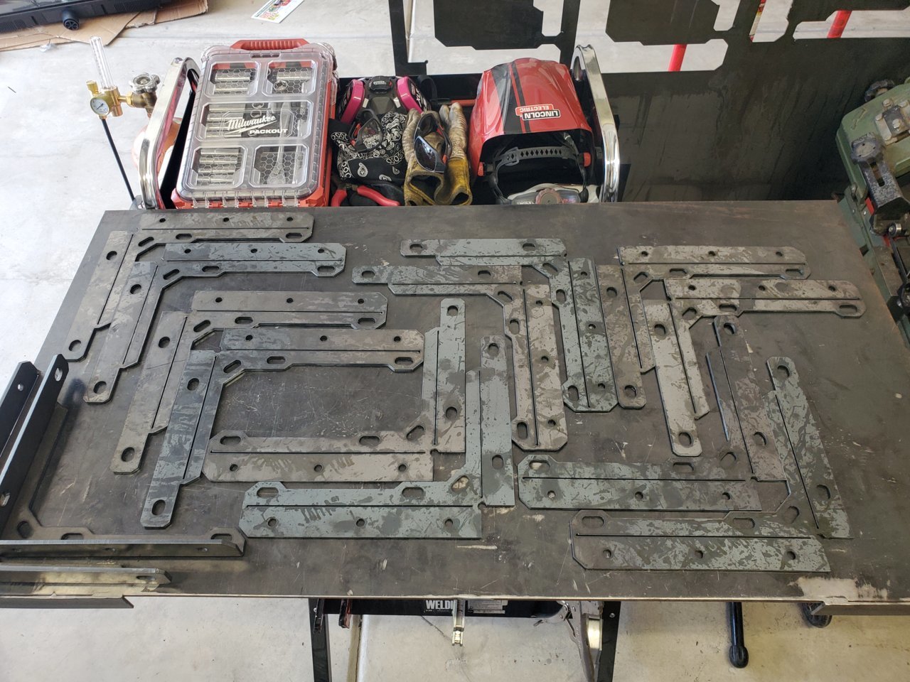

    @Bandido
    The remaining parts I almost forgot to cut :facepalm:
    I really need to remember to replace my consumables :anonymous:

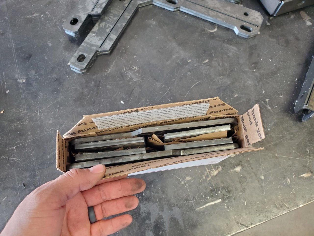

    @Kwikvette magic laser table made the cuts.
    Hopefully the stuff will be here today, or tomorrow, so I can get this stuff glued together this weekend.
